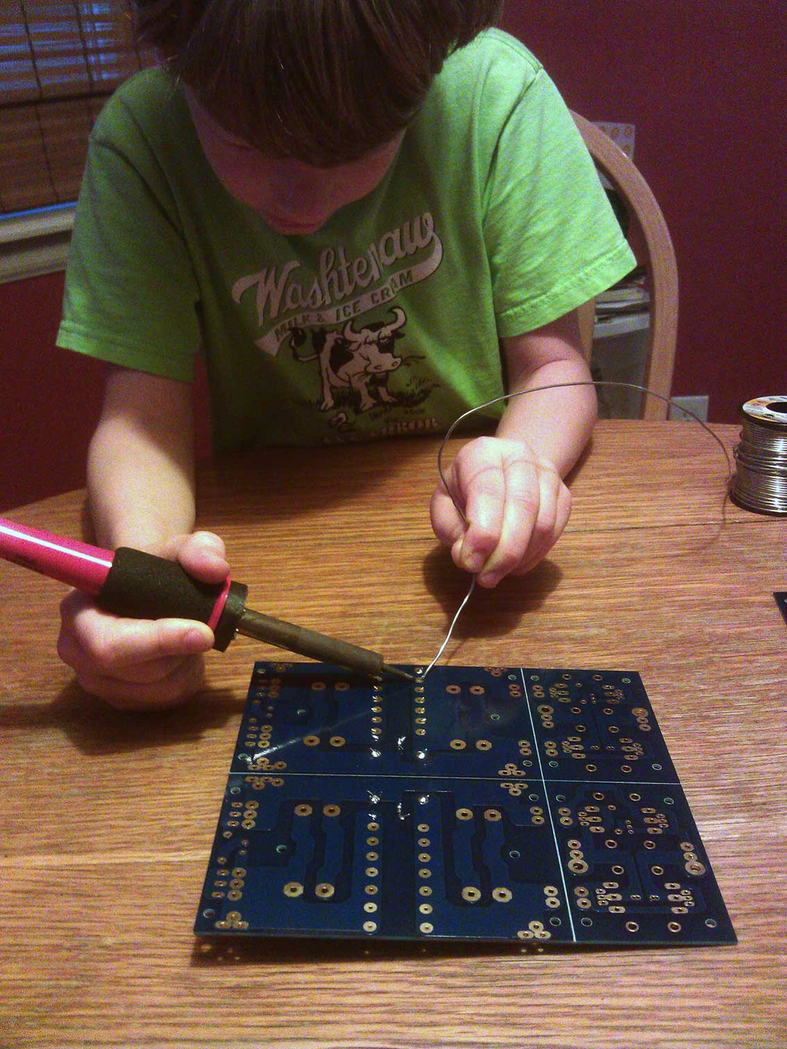

Heh... soldering in 28 jumpers to opt out of the crc filtering on a dual mono amp is a big job. I farmed it out Tom Sawyer style to my 10 year old son. He lays down some mean joints!

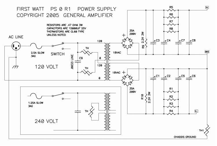

I'll be building an aleph J and have a few questions on the PS I've been collecting over the past week:
1) From the BOM, I'm not familiar with the dual diode devices. I've looked at the schematic for the PSU, and can't figure out if: both diodes in the pkg are used in parallel, both used independently, or if one just isn't used.
2) On the Pass schematics, are those thermistors? Any advice on what part to choose (digikey) would be appreciated.
3) Capacitors. I'm not knowledgeable enough to choose between: Panasonic TS-UP and TS-HA or Cornell Dubilier 380LX, 381LX, or SLPX. Or have I removed something from my short list I shouldn't have. (15000uF or 22000uF if affordable).
thanks
-david

I am about to build an amp using the universal PS board. The schematic is giving me tired head. Why are there two bridges on the board, and what are the ST_ connections for?
There are two bridges, among other reasons to allow the positive and negative supplies to be used independently. There are schools of thought that favor the use of dual bridges and those that argue against it. If you want, you can use just one bridge for both rails, but you have to know what to do with the center tap.
It looks to me like the ST connections are set up to allow daisy chaining capacitor boards to make a CCRCCRCCRCC etc. filter. ST_G1 and ST_G2 seem like they are intended to connect to the star ground.
It's a little sideways but both cathodes are connected and both anodes are connected. They are used in parallel.
Yes, he uses CL30 a lot.
thanks
-david
Any of those are fine. You'll get slighly longer life using the 105 degree versions.
I believe they are intended for stacking multiple PSU boards on top of each other.
