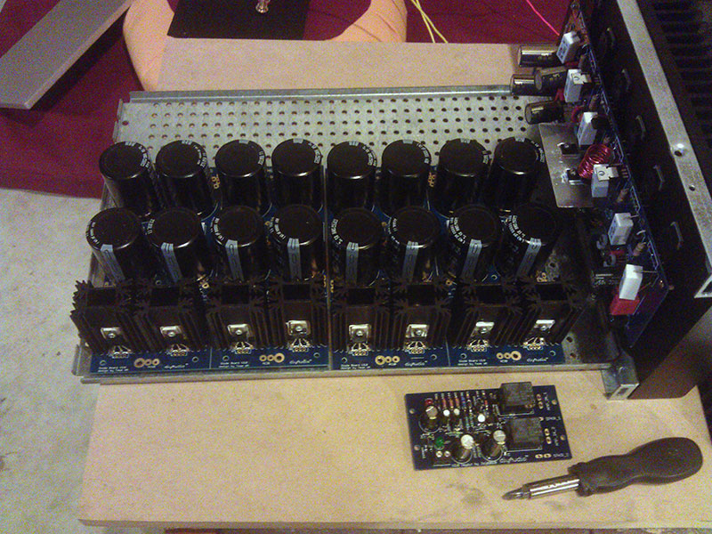

Finished my v3 boards for my Honey Badger. These boards are great, 35mm caps fit with no problems. I did have to find shorter bolts for the heat sink mount kits as the ones in the kit don't fit when back to back, but that's no issue. I could have cut them shorter too.
