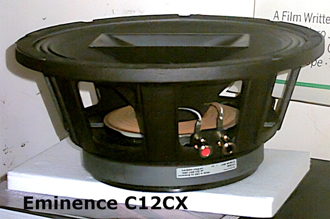

hi Sonce - for what little its worth I "thought" an LCLC allpass with my Eminence C12CX's lowpass made it snap into better subjective focus - but did not verify via any measurements,
I miss this line of Eminence - they were made with and without a protruding horn with 54-109oz ferrite magnets. This one had an 80oz magnet and edge-wound 2.5" voice coil and was nice in my Karlson12 - probably would work in the Karlsonator12 tho that one is tuned to 37Hz.

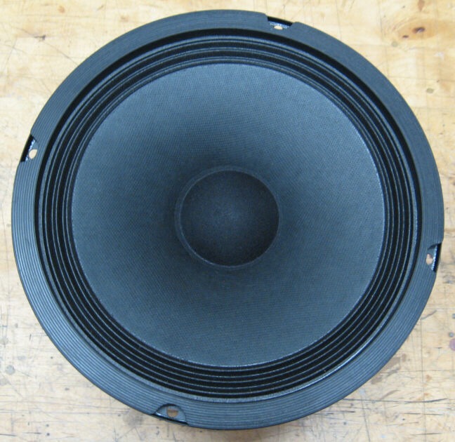

Hi (zdravo) Sonce,
I am looking to buy an 8" fullrange speaker for the Open Baffle. I wanted to try Visaton Bg20 (cheap and tweakable), but if you say that Sica is worth it, I may give it a go.
But, I noticed that it has a peak (10db?) around 10 k?

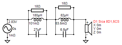

Can you share RLC values for it?
8D1.5CS may needs DSP/RLC compensation/attenuation at 2.1 kHz (high Q) and at 5.5 kHz (very high Q), if my memory serves me well. At the moment I can't find the RLC values, but I will find them later.
I am sorry, I am (a little bit) late, but here it is:
- Full Range
