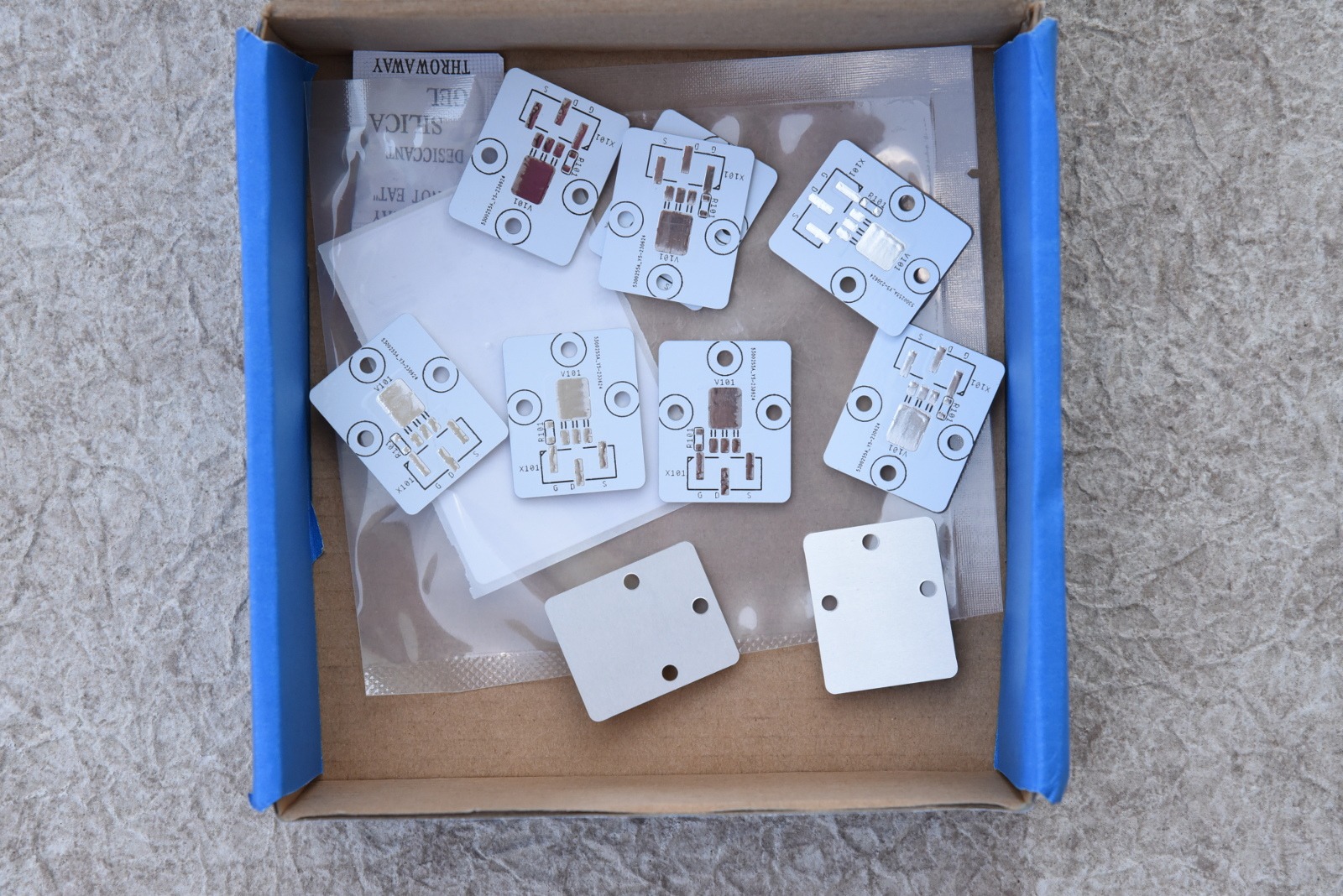

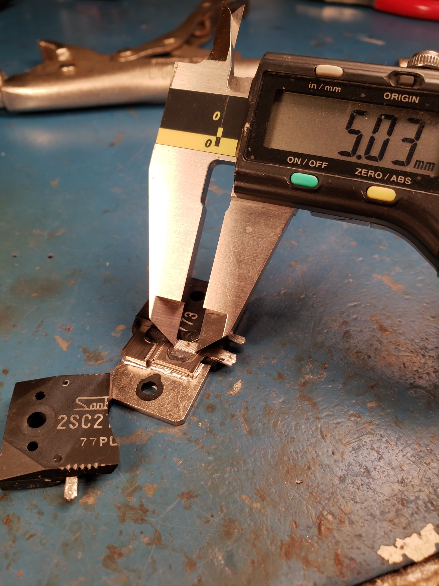

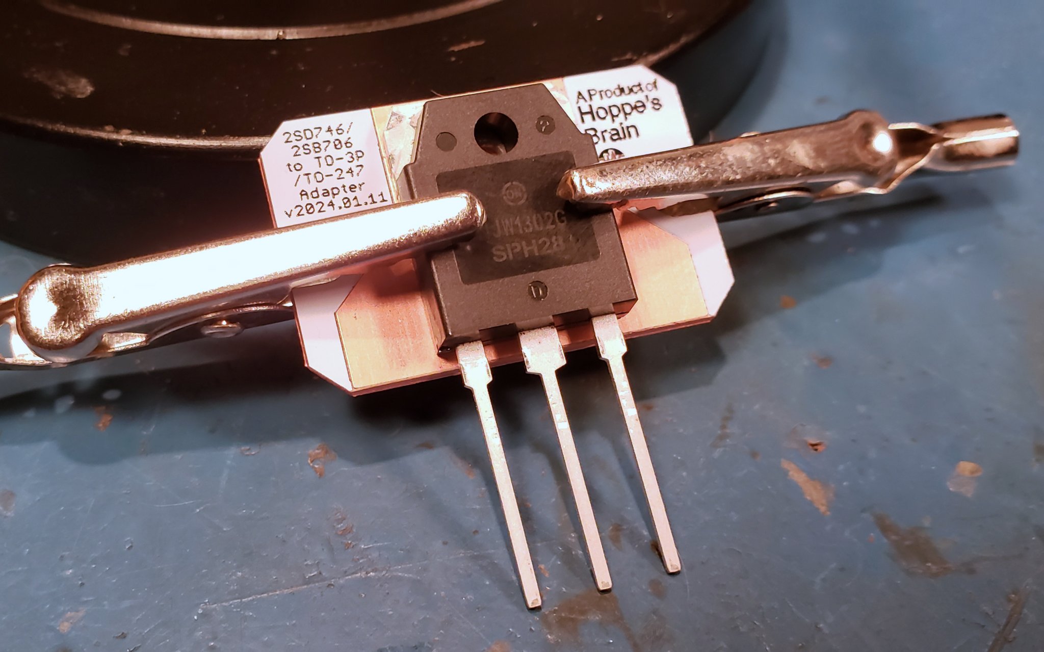

My adapter plates are made by JLCPCB, and they're 1.6mm thick, exactly the same as an MT-200. Higher-power-rated MT-200's are actually TO-3P heat-spreaders soldered to another, larger heat-spreader.
The adapters are "direct copper heatsink" PCB technology, so they are solid copper all the way through.
Voiding is prevented by applying pressure as the solder-paste melts. The alligator clips press the transistor flat against the substrate.

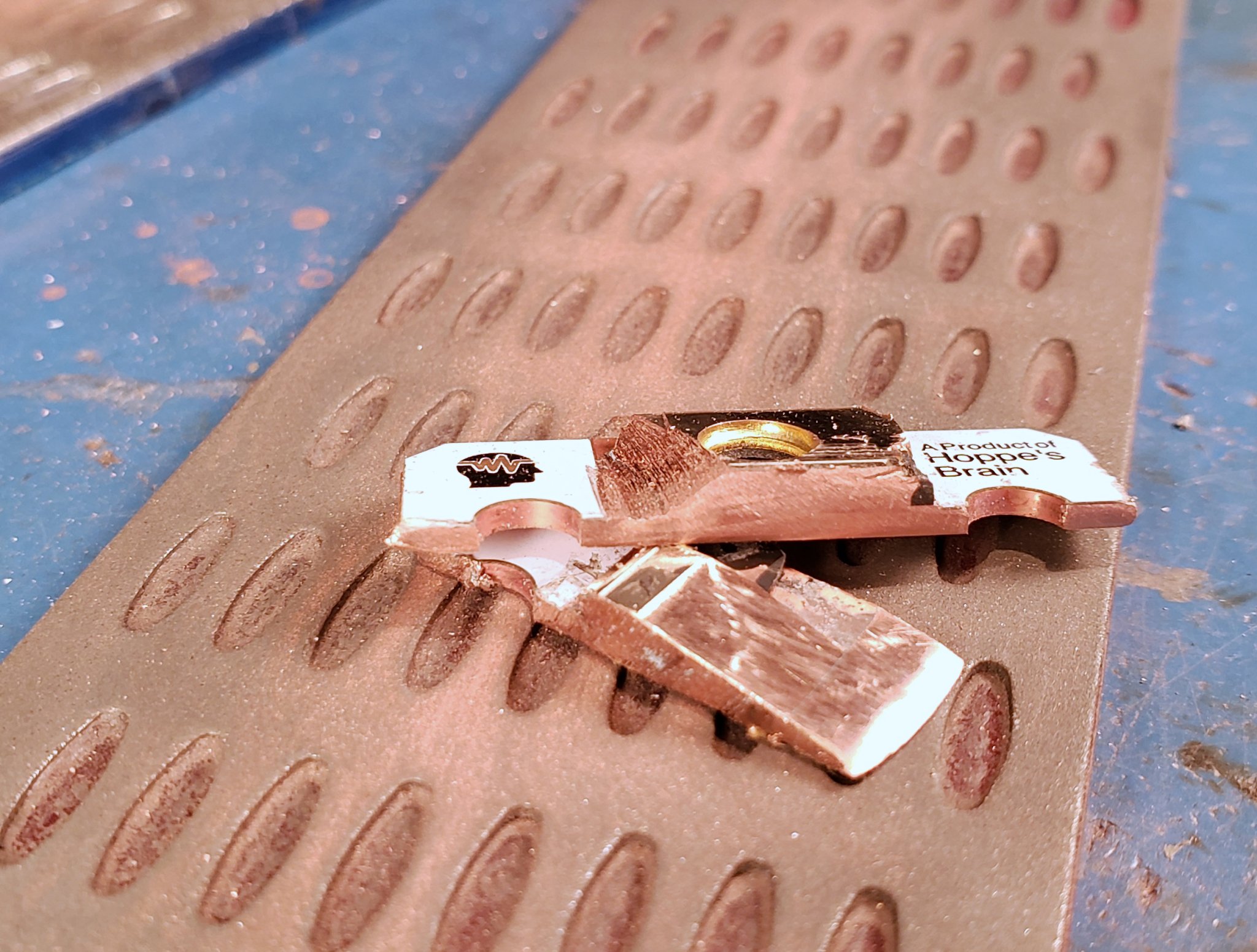

Voids are squeezed out along with a small amount of excess solder. I cut and polished one at a shallow angle and found no voids, and the layer of solder is super thin but contiguous.
I think they're reasonably priced. As simple as they are, I've been working on this projects for weeks and weeks... reading datasheets, researching different types of obscure semiconductor packages, performing thermal testing, researching mounting methods, and writing documentation.
There is a volume discount, and it you need that many we can work something out.

Actually, the soldering goes super easy, (hot air) much easier than with a fiberglass PCB, because the copper conducts heat so well and the whole surface of the adapter heats up evenly. Once it melts, it all goes at once. Remove heat as the moment that happens and you'be be easily inside the thermal profile; most transistors specify a maximum die to case temperature of 260C for 5 seconds. Eutectic solder melts at 183C.
