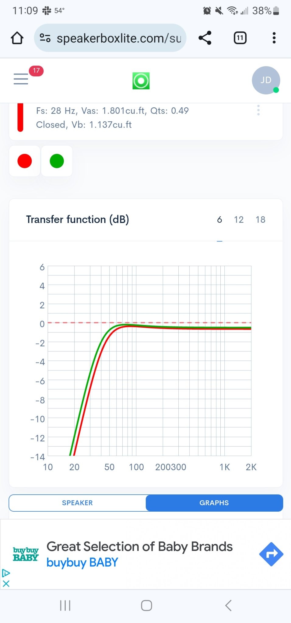

I use the Dayton's in two 25L sealed cabinets in my living room. I cross them at 80hz, so I can't say how they will sound crossed at 300hz. When I listen to music they create nice smooth bass, definitely not one note wonders. My guess from your previous designs you be using this for the bass in a 3 way design. If that is the case I don't understand why you would pay for a sub-woofer when you could do the job with a woofer like the Dayton SIG270-4 at half the price. Do you plan on getting sub 20hz out of the rss265hf-4? I use them and they really don't go that low. Here is link to my build and as you can see they drop off really quick.
