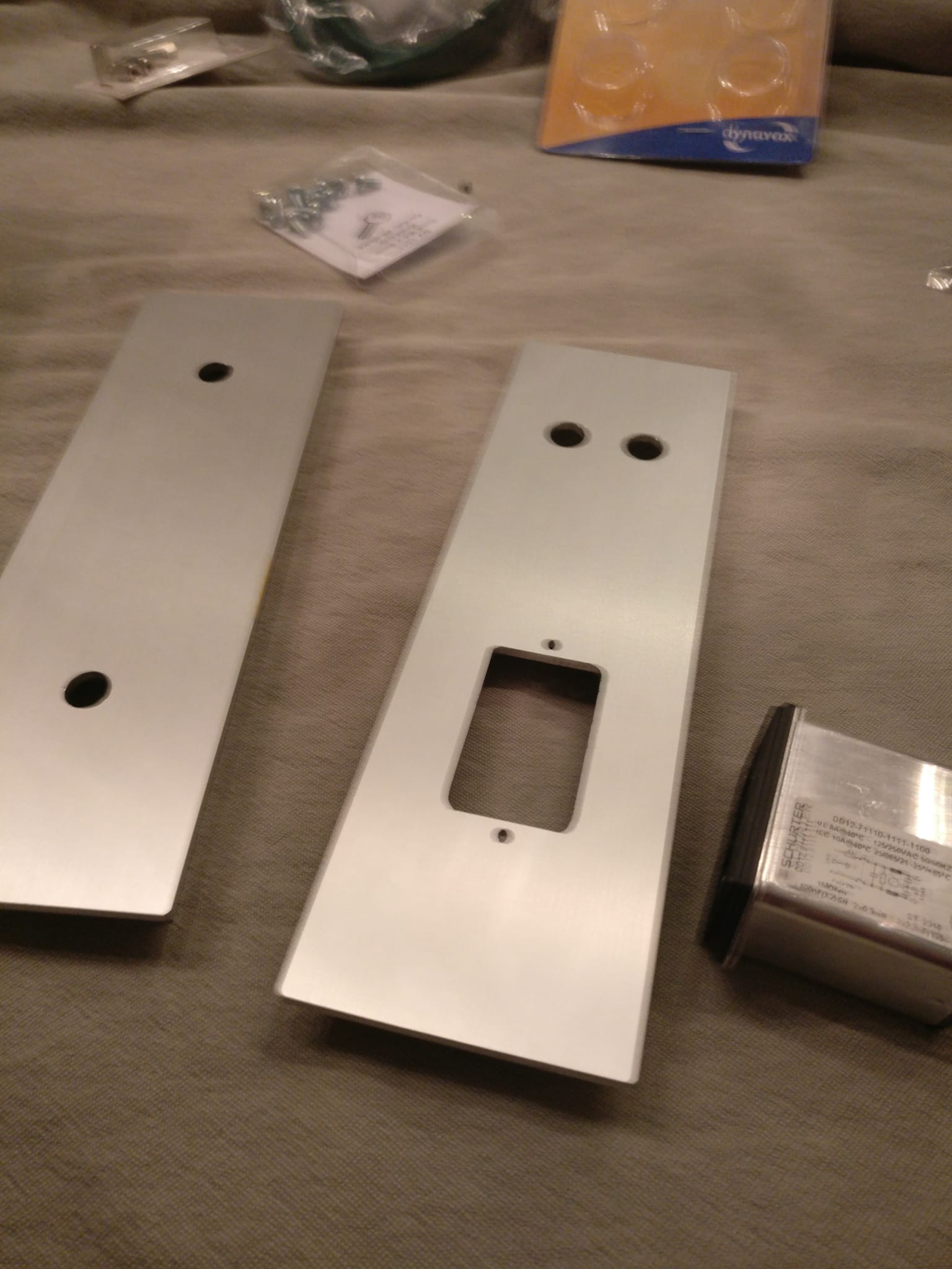

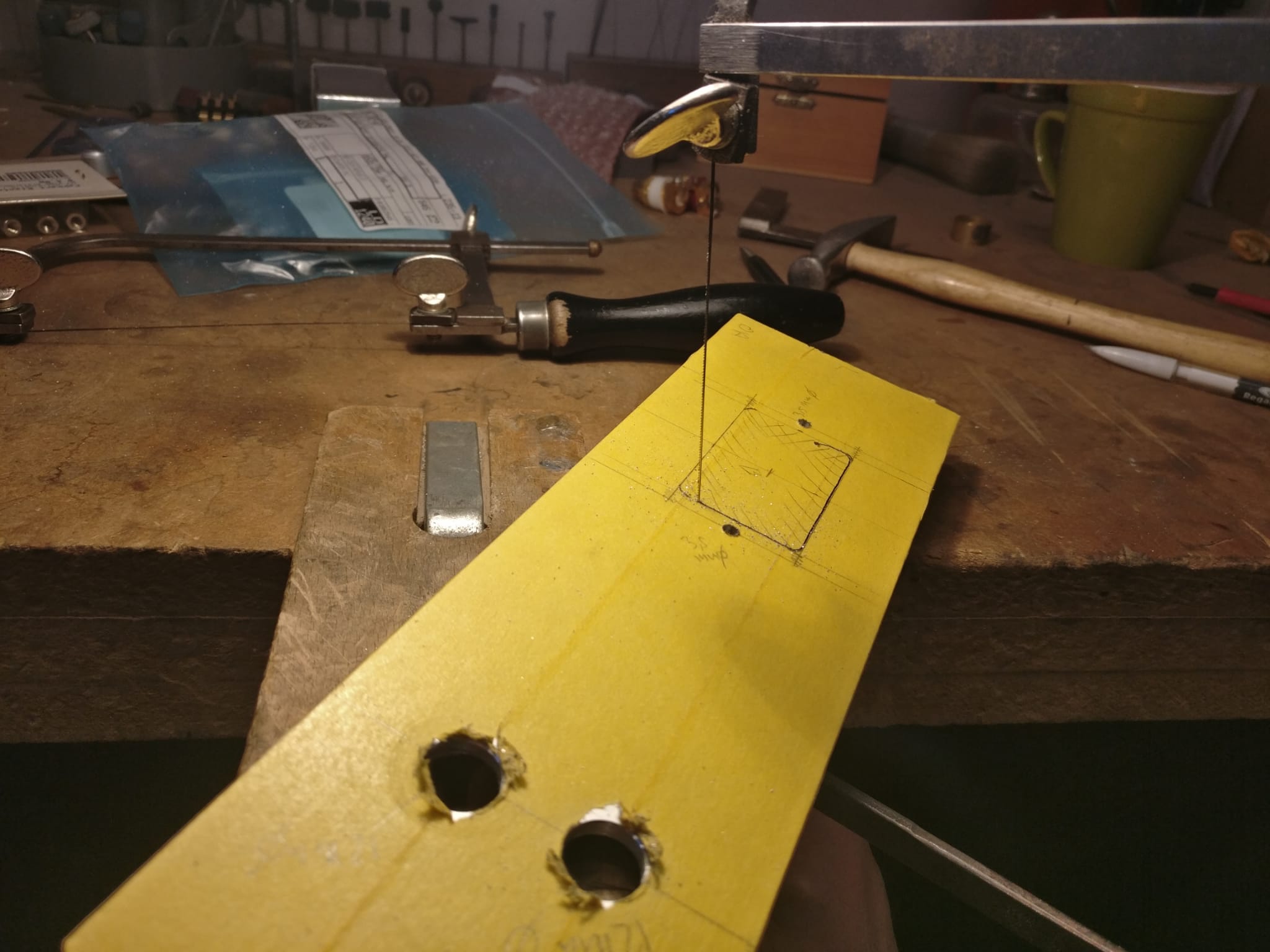

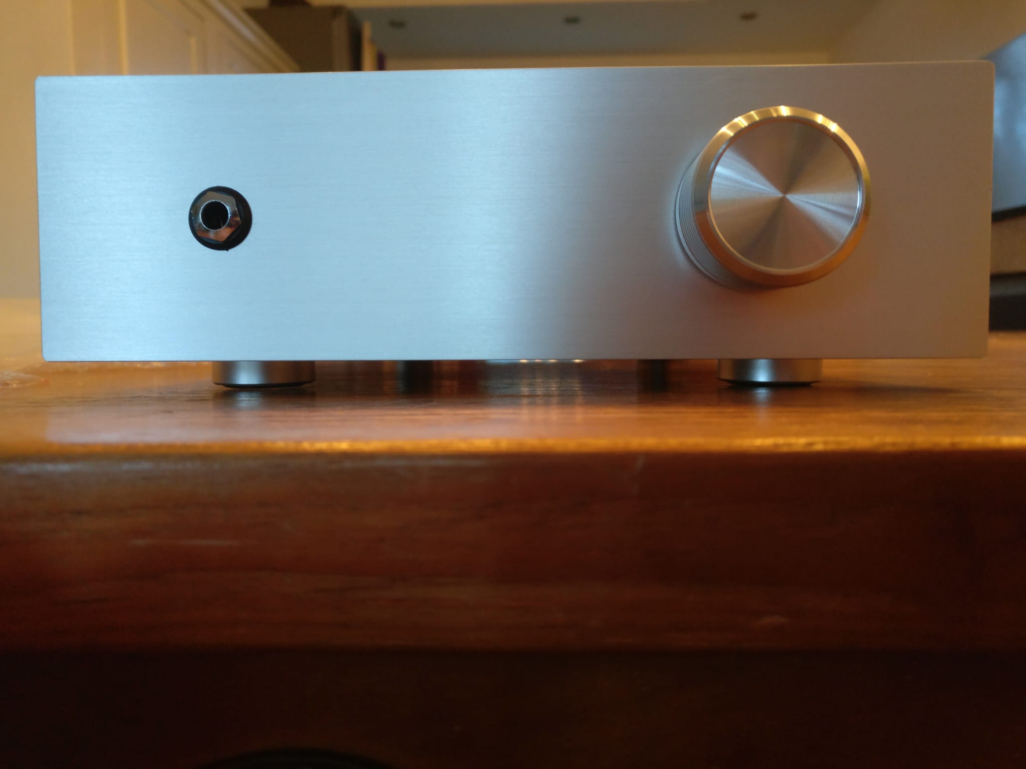

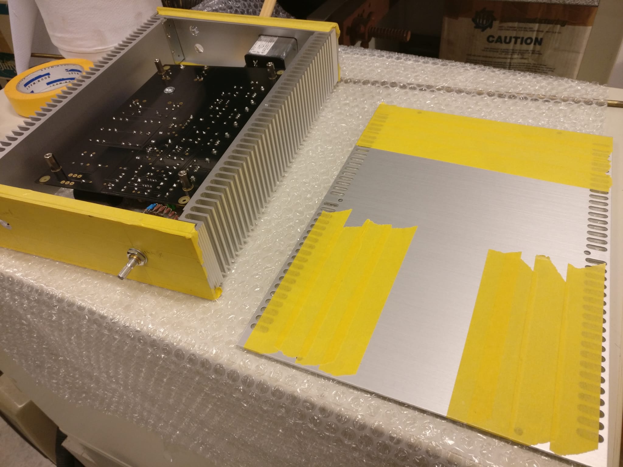

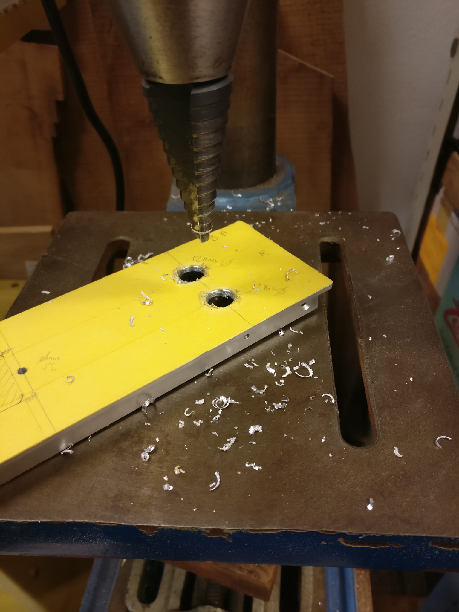

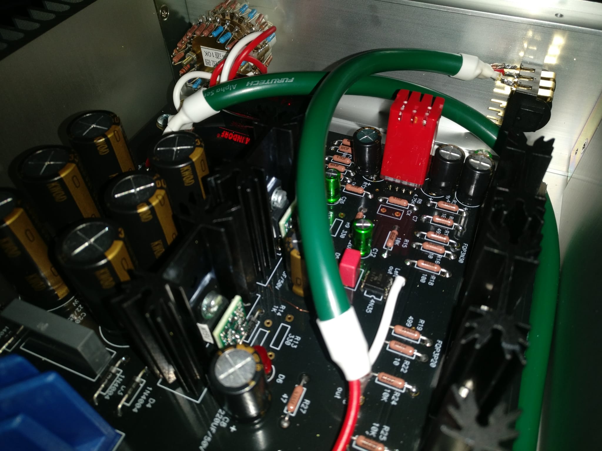

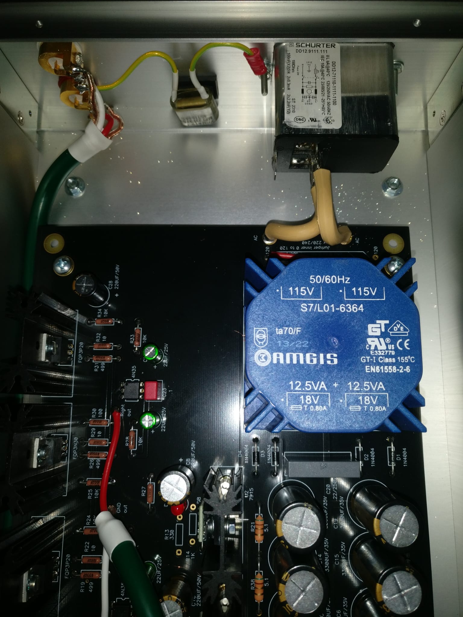

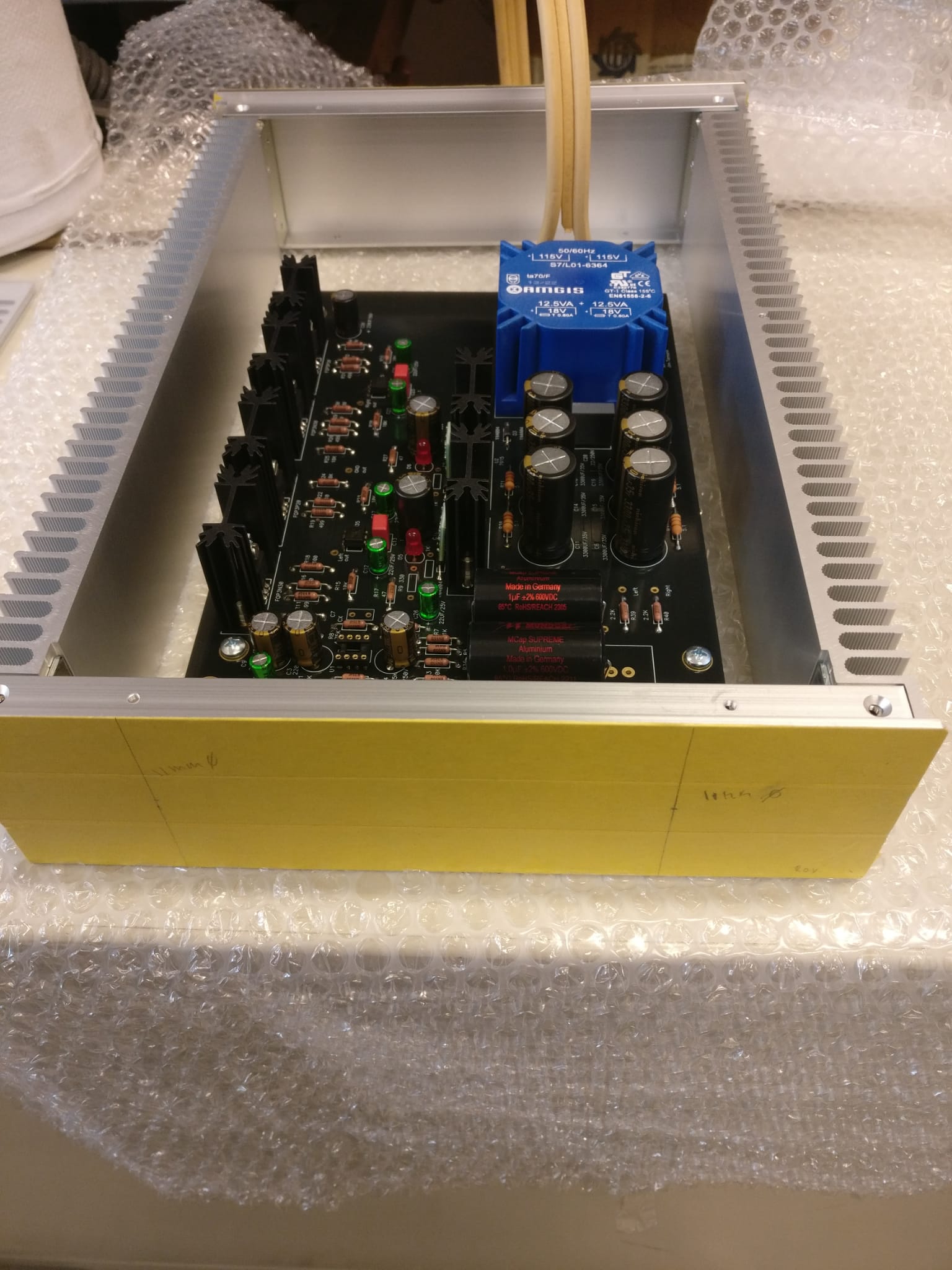

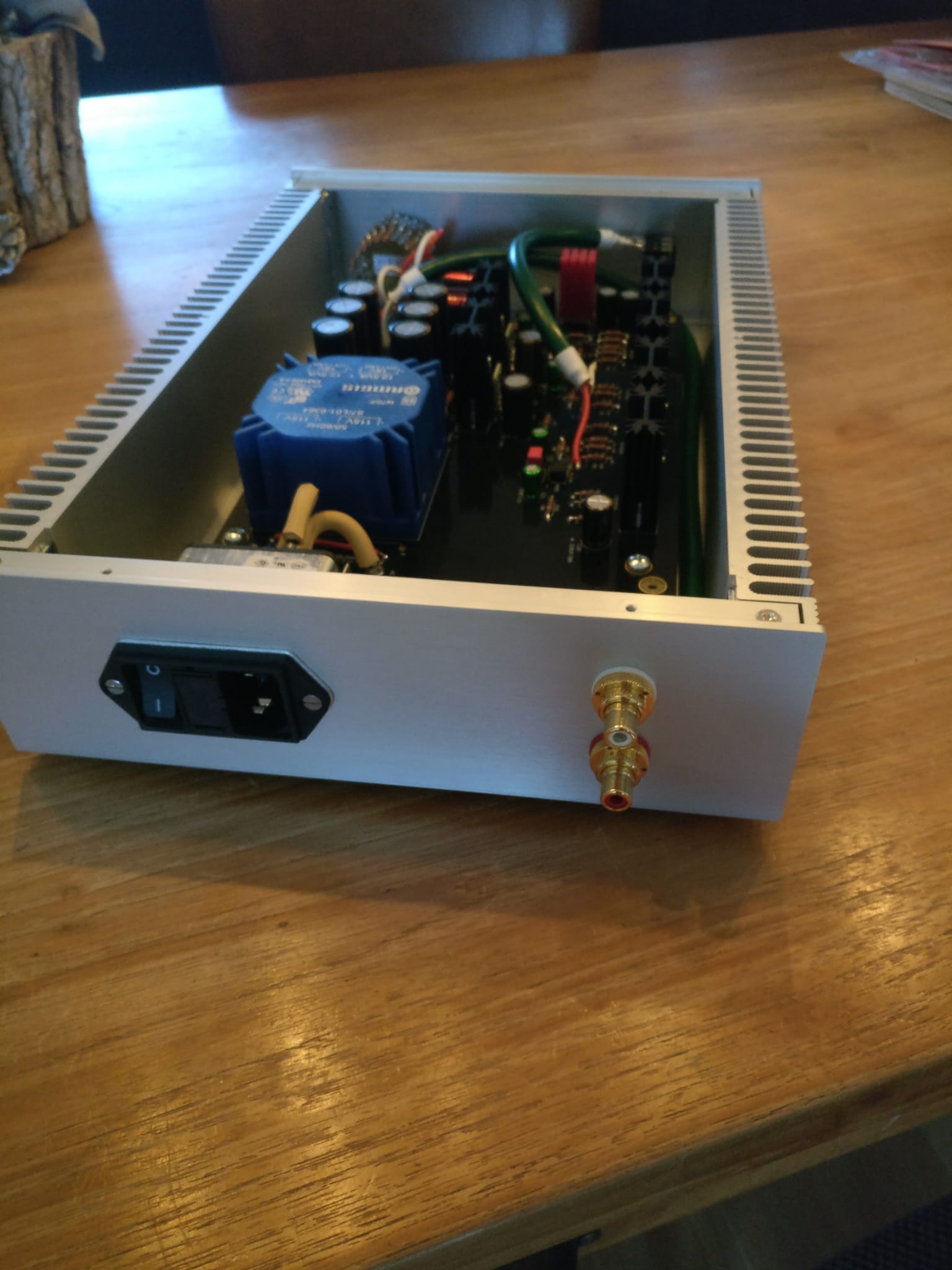

It almost took me a year before I could find the time to finish my WHAMMY build after ordering the PCB.
But recently I had a whole day I could spend on making the housing for it, here's some pics of the end result.
Now I can't wait to buy a suitable headphone to listen with, with what I have (a very basic Grado) it's allready pretty allright.

Thanks! I'm happy with the result also.

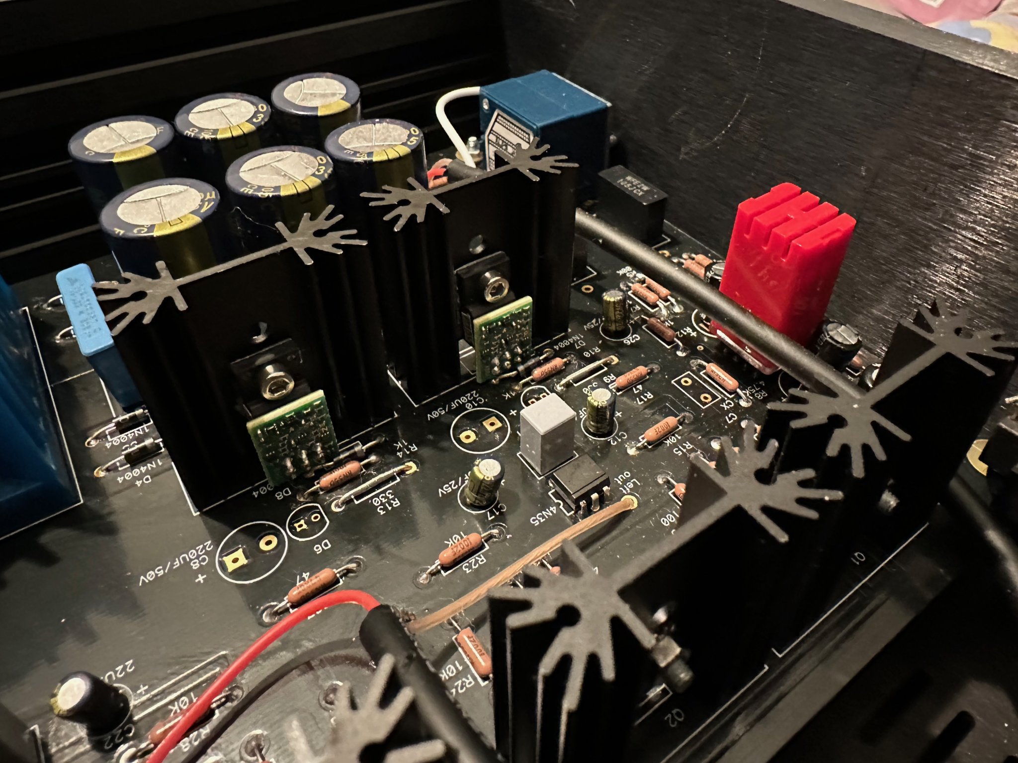

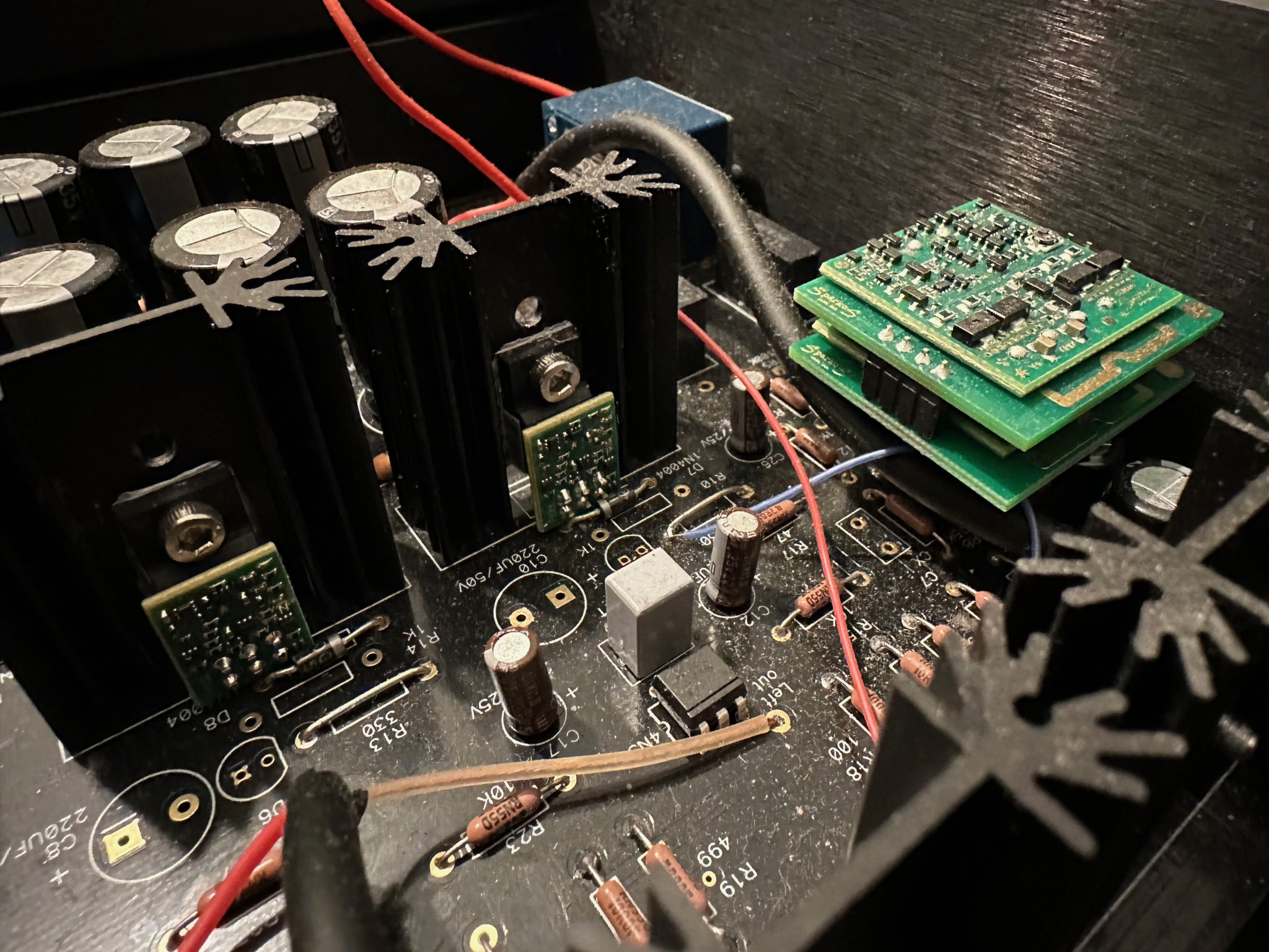

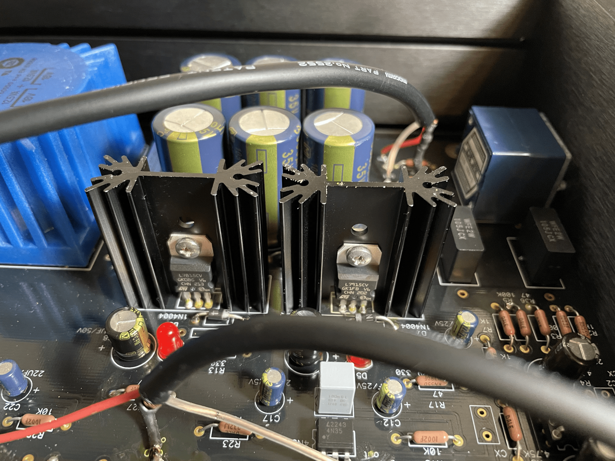

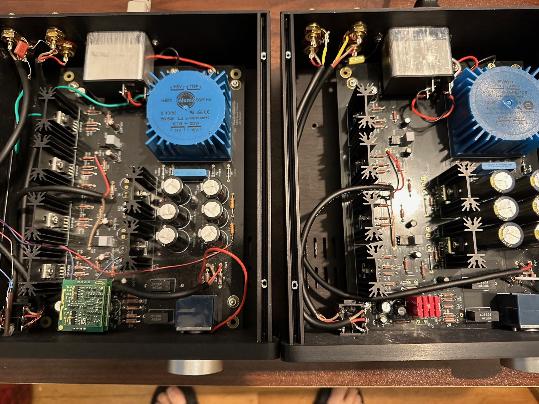

The Burson V6 Vivid was provided unsolicited by John Garcia of Burson who wanted my to post pictures of their opamp in my builds. Both units are using Sparkos voltage regulators and one of them are using the Sparkos Pro opamp. The Burson appear to have tighter bass, but the Sparkos a more opened midrange. The Sparkos require about an hour to stabilize for DC offset adjustments. Since they are stacked, it took me a few days to get the Sparkos adjusted. The Sparkos are also sensitive to variations in ambient temps. DC offset in the Burson are not possible, but the opamp appear to be more stable in terms of DC offset.
Reactions: 1 user
Fantastic build, @Avalfa :)
What's the model of your potentiometer?

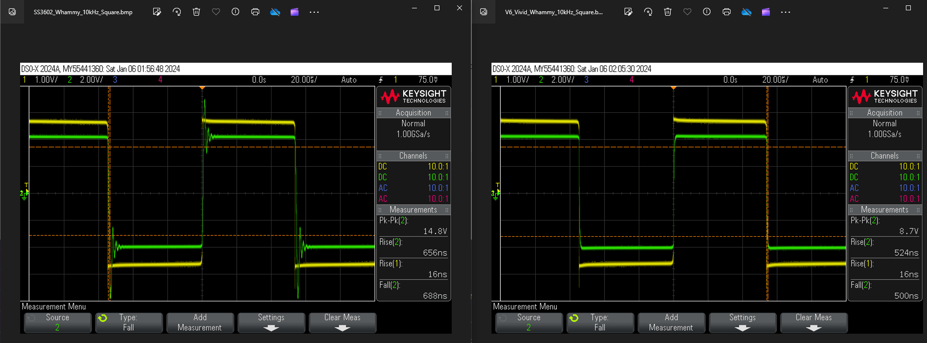

@RYC2000 , I also see more DC offset out of the Sparkos Vs Burson, but I did not fiddle with resistors around the Op Amp.
Have you checked for oscillations?
I have not tested the pro version, but I have not managed to get a fully stable SS3602, despite multiple decoupling trials:
Sparkos SS3602 (Left) Vs Burson V6 vivid (Right)
The interesting part is that the Vivid actually has a faster rise & fall time, and the SS3602 oscillation has the same pattern regardless of the level.
So I'm thinking that the only thing that might help stabilize SS3602 here is adding the feedback capacitors C2/C7 to limit bandwidth ?
THD+N was lower on the SS3602 (harmonics in the ~-115dB range @8Vrms ; ~100dB @2Vrms IIRC), compared to the V6 vivid and classic, (~-80dB range @8Vrms ; ~95dB @2Vrms). - For context, all my listening is done with <1Vrms.
Subjectively, the SS3602 are worse: flat sound stage, lack of dynamics, especially in low frequencies, sterile and cold sound, odd decay/reverb, constantly trying to highlights details which sounds like compression to me. Quiet parts in the music are boosted, my friend described this as hearing "constant pressure".
V6 Classic and Vivid are my favorites, those days I stick to the Classic as the Vivid can be a bit more hot in the treble at times in comparison.
The difference between the two is very audible, but both sound fantastic and have their pros and cons. (I use a Topping A30pro/D30pro stack for direct relative comparison).
I hear that Burson might be releasing their V7 version soon, I'd be very interested to try it.;)
Reactions: 1 user
Thanks Martigane,
The potentiometer is one (unbranded,Chinese?) I ordered from audio phonics in France. 10k value and the mechanism is a bit stiff, if you get me right. That's what the reviews mentioned, and indeed is the case.
Therefore I ordered a few different knobs to try, and with the one I mounted (solid CNC made aluminium) which has some weight/mass that's no problem at all, and it's quite a nice potentiometer for the price, (somewhere around €25-30 if I remember right.)

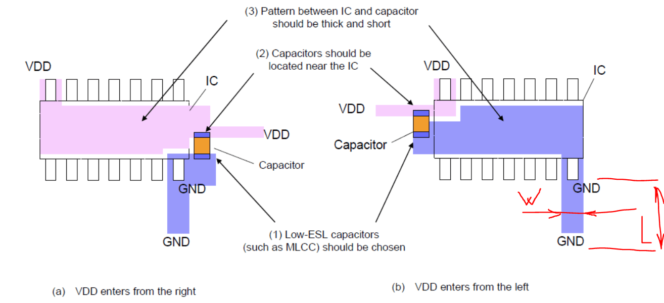

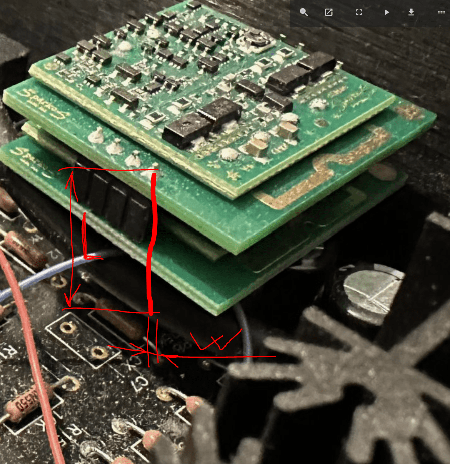

Have a look at this:
The IC on the photo is one of those exotic OPAmps.
For good decoupling results, the L should be as short as possible and W should be as wide (thick) as possible.
Now, consider this:
L is probably 20-30 mm (!!!), and W is negligible.
Any effort to decouple that "OPAmp" would be annulled by a very long L and narrow W. Completely useless at high frequencies.
A completely different layout is required, if those exotic IC / OPAmps are to be used, to allow them OPAmps to be soldered much closer to the ground fill (and Vcc/Vee, whose length & thickness are as important as the ground wire/trace length & thickness)
With WHAMMY, use a JFET OPAmp with a low input bias current. Once happy with the sound, remove the IC socket and solder the OPAmp straight to the PCB.
The Vcc/Vee decoupling electrolytes do not have to be 220uF... even 22uF will be more than enough (and much preferable, actually, if a uniform very low voltage rail impedance is desirable at the broad frequency spectrum range). Actually, a 10uF is all that is needed.... but I'd definitely try 4.7uF as well.

Yes, I think Mooly or someone earlier shown in this thread how to best decouple, I do the same and solder directly the cap on the OpAmp, with shortest leads possible.
