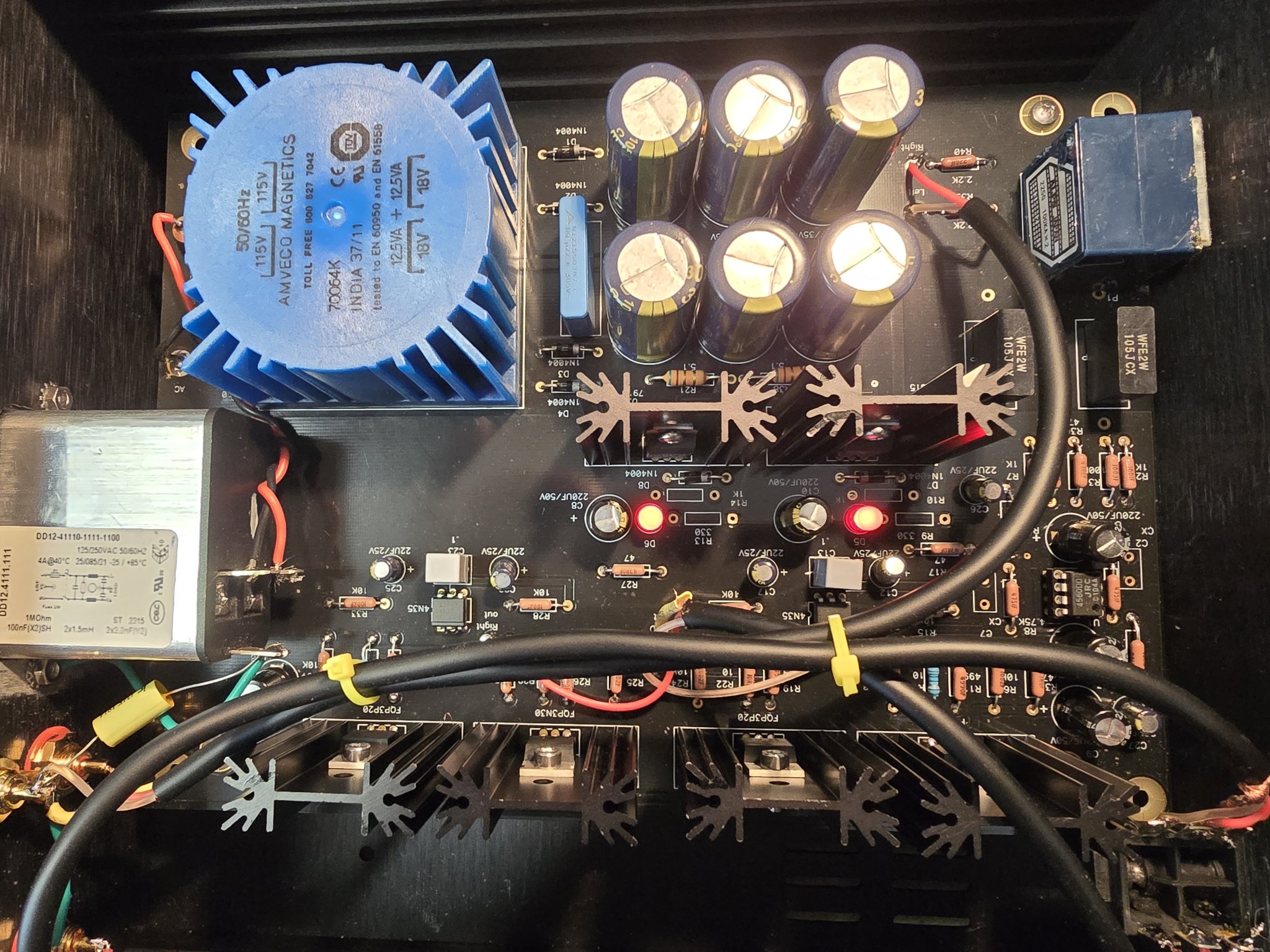

I visited the warehouse and checked the kits on shelf, and determined that a little less than half the remaining WHAMMY kits have PEM DD12.1121.111 ("One Amp, Screw A, 2 pole fuseholder, 2 pole line switch") instead of DD12.4111.111 ("4 Amp, Screw A, 1 pole fuseholder, 2 pole line switch").
After consulting our supplier, it turns out Digikey sent a number of 1121s in the order of 4111s.
The most practical solution to remedy the issue is to obtain one Schurter 4301.1413 "Fingergrip, 2 pole fuseholder, shorting bar on neutral side" (Digikey / Mouser). Any customer who has received a kit containing a PEM labelled DD12.1121.111 is welcome to either obtain said part themselves and contact the helpdesk for a refund of the part value, or contact the helpdesk and we will arrange for the 4301.1413 fuseholder to be shipped out to you at no cost to you.
All kits containing PEM DD12.1121.111 have been identified and set aside at the warehouse and will be updated with the 4301.1413 fuseholder. All customers who purchased a WHAMMY from this batch will be contacted and asked to check they have the correct PEM and if not we will ship a replacement fuseholder.

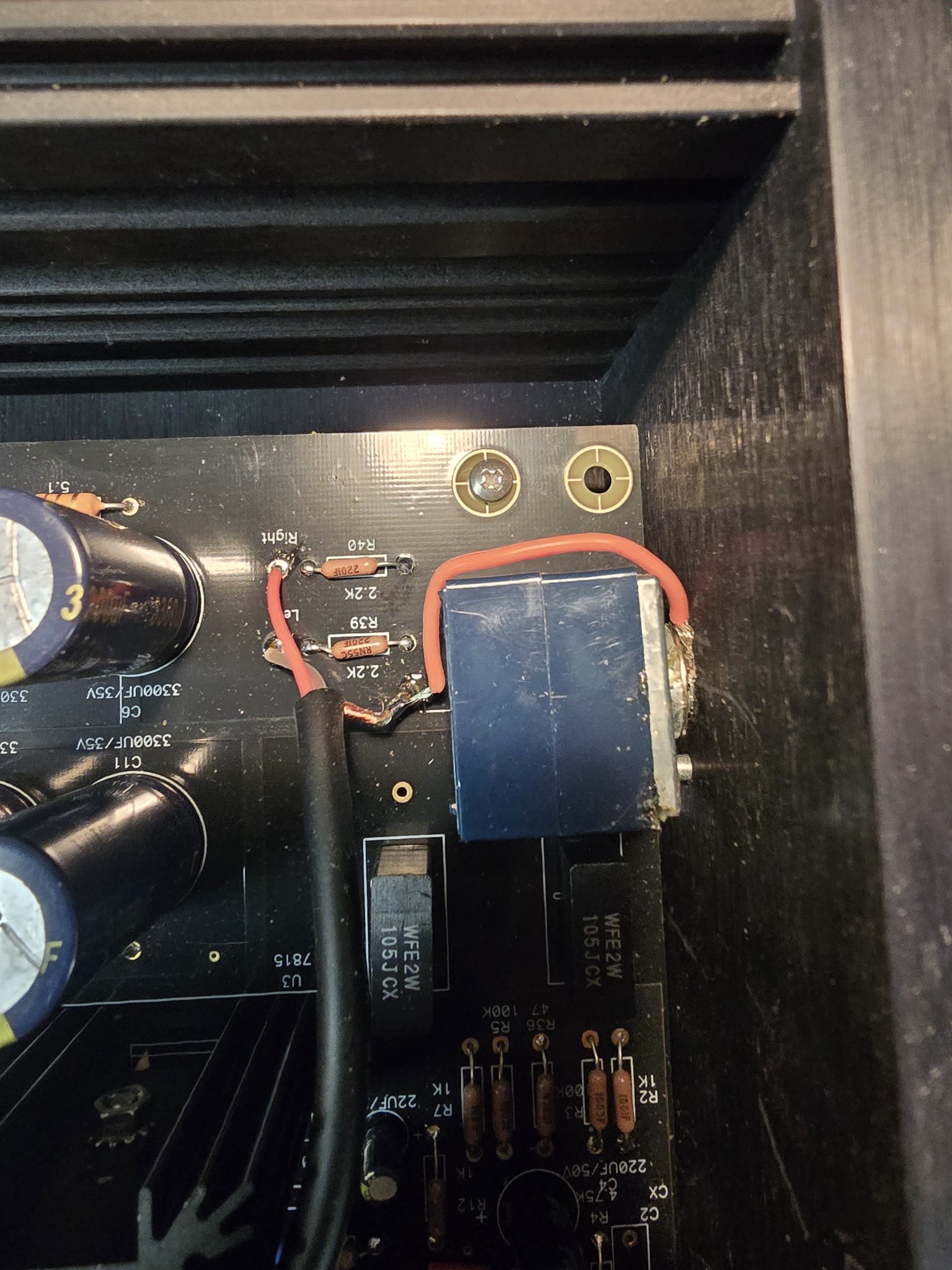

I was wondering if anyone has had noise issues? I immediately noticed a high level of noise thru my desk speakers. I'm using it in "preamp mode", switched by the phono jack. My amp has a gain of about 30dB. I can't hear it thru headphones. I would characterize the noise as NOT frequency specific, though I'm sure there is plenty of 180Hz in there. By comparison, my BA2018 line stage is dead quiet in the same environment.
I started poking around. I wired the input ground and pot grounds directly to the 100Kohm resistors at the opamp inputs (see photo). The Whammy is now DEAD quiet. Am I the only one that has run into this issue?
The pot I use is a NOS 50Kohm audio taper REAL ALPS motorized pot. Currently the motor is not driven, but available. I have used this pot in several BA2018 linestage build and many retrofits to vintage preamps. It's solid. I think the pot is so good that for one of my BA2018 builds, I was not using the motor so I removed it to reduce the drag. Pot is very well balanced and very smooth.

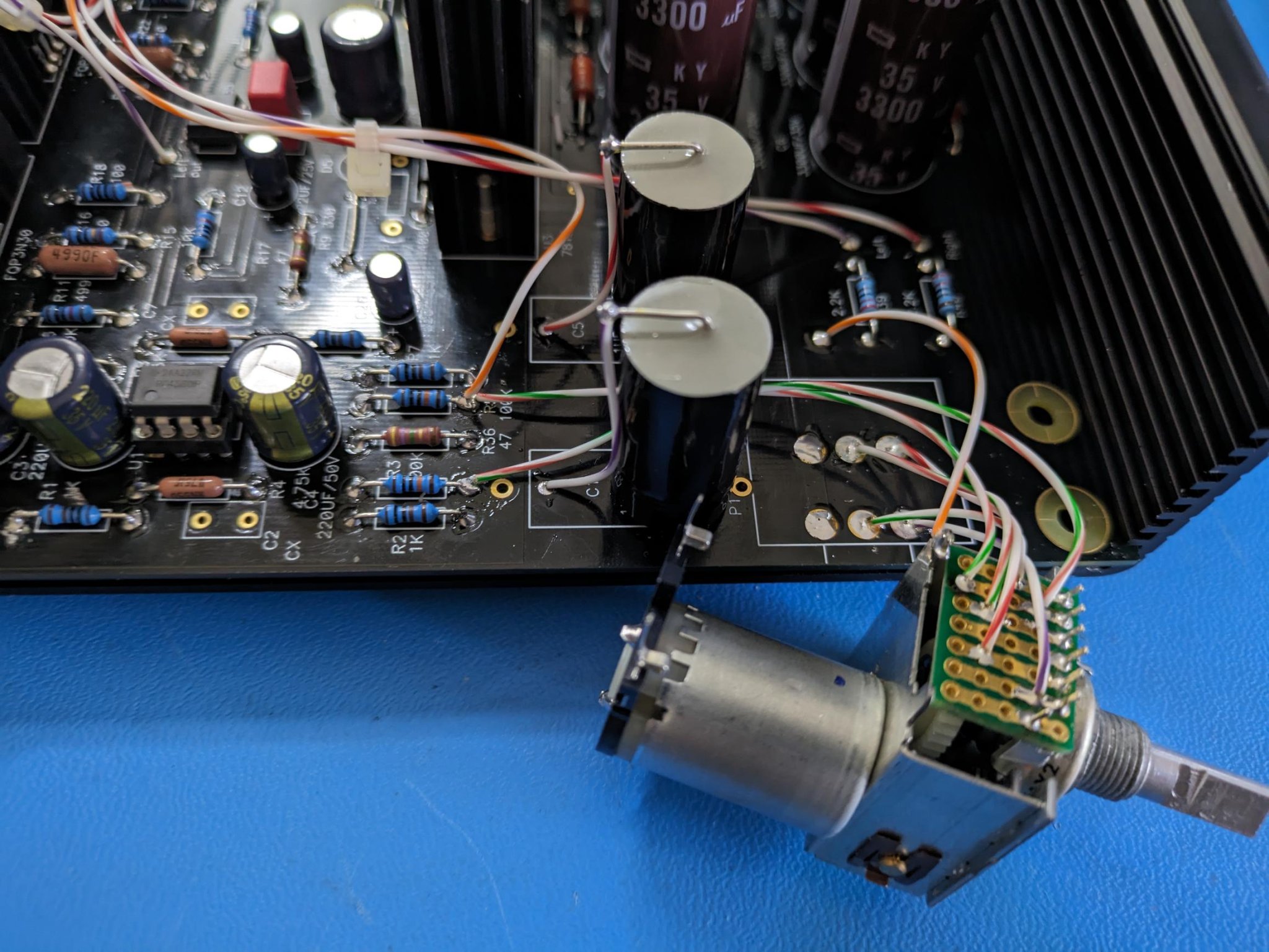

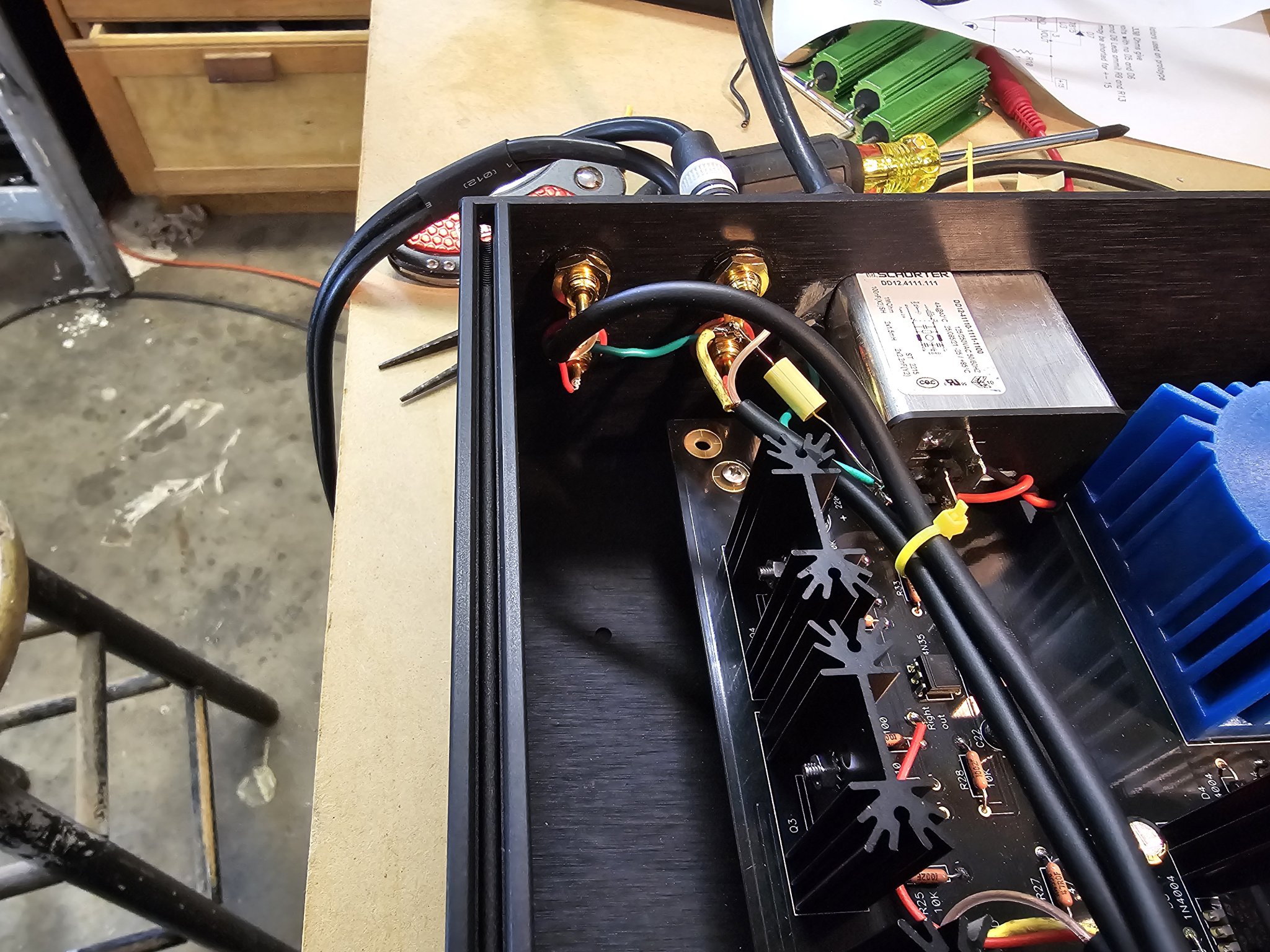

Quick question. Seems like there is something wrong with the chassis ground on mine. I get an audible hum (and some other noise) when I touch the chassis which is even worse on the volume pot. A quick test reveals that a grounding wire between the Alps POT body and the ground next to R39 seems to solve the problem. The hum is sensitive to volume and disappears completely at 0 AND full.
I have no idea how I would do this, as the POT doesn't appear to be something I could solder a wire to. I have read that some have grounded the pots, but I think those were no the stock ALPS.
Maybe there's another way to ground all of that? Maybe (nay likely), I've made a little wiring error somewhere.
Pics attached.

In my experience, this is common. Not so much at 0 but near full is something I see all the time with different preamps. It is in fact related to the pot chassis needing ground. You can see in my post just above at #5110, an orange/white wire going from the pot chassis to ground ...... however you are correct, it is a different pot with easy access to the chassis.
In the past I have used a flat very thin washer, soldered a wire to it, and placed it over the pot shaft, between the pot and the chassis, then connected the wire to ground. Not sure that is possible with you current build? Good Luck.
Looks like I can't edit my previous post.
@smoovj - That worked beautifully. This thing is dead quiet now. I stole a washer from another pot, then sanded it down a little, soldered ground jumper to it, and jammed it in the space between the chassis and the pot. I think the soldered wire is actually what is touching the chassis at the pot, but I ran the ground wire down to the audio ground by R39. There is JUST enough room to kind of smash the pot and soldered washer against the chassis and still have the screw holes in the standoffs align correctly.
