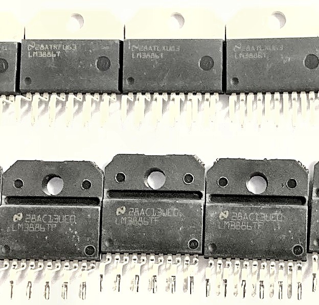

The ragged edges could be remnants of heat sink compound, but the printing is faint as well.
I cannot say if that is normal.
And they are with NS logos, so the date codes must be verified, I recall TI gradually putting their marks on products taken over after the integration of NS into TI.
Some products were dropped, and there was a transit period when the NS logo was used on TI made parts.

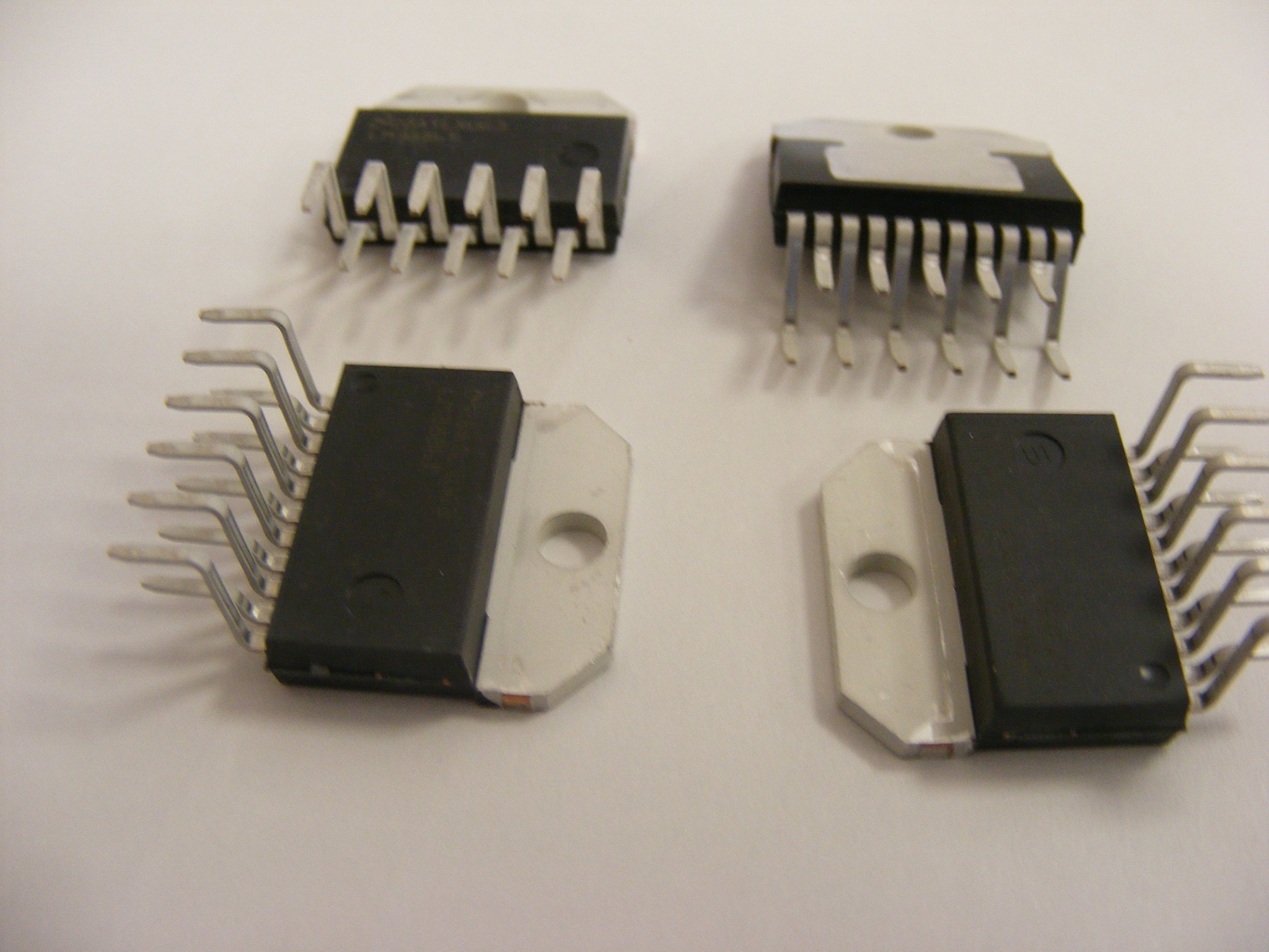

Not saying anything one way or the other, just intrigued by a few details I would not expect in current TI samples, delivered straight from Factory.
* Use of the "NS" logo in a presumably fresh 2022 product?
* mixed metal and plastic back?
* faint almost unreadable logos? (I also processed and enlarged images like PRR did and got worse results than him)
* a BIG red flag, the crude rough edges in the "plastic" ones, maybe sign of a very crude unfit injection die?
Naresh should have an opinion on that, since he makes plastic parts for living.
* no comment on tinned legs on the plastic on es, they "might" be pre-tinned for convenience.
Layer is too thick, so it´s not the normal electrodeposited/plated coating but looks like immersion in molten solder.
That said, they might work well.

They were ordered from the TI store and shipped from their albeit old stocks in China. There are both types, the original and the newer fully insulated ones. The fully insulated ones do have a higher thermal resistance to the heatsink that is actually not specified! However as the chips include a thermal shutdown mode, they really can be used interchangeably.

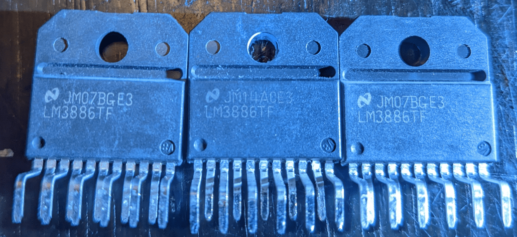

Just compared the TF ones to three pieces I found in a drawer which are ~10 years old.Just in 20 LM3886. Any question if these are genuine?
The plastic casing looks 100% identical in all details, but the type font differs... but even within my samples the font and logo lasering differs for parts with different date/mfg codes:

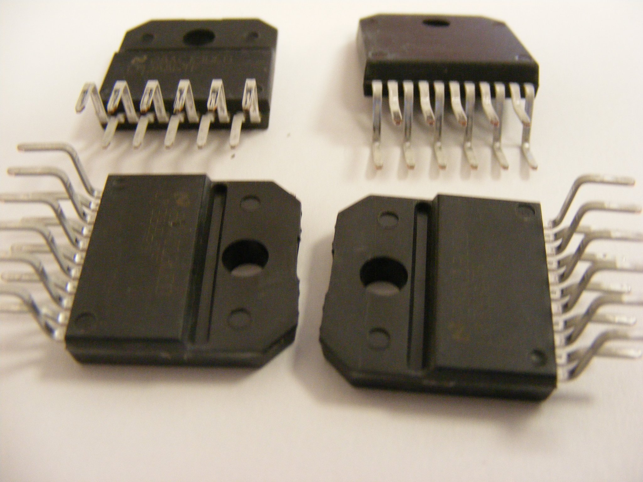

The ragged edges could occur if a filled material (glass fiber, talc and others are common), the groove is also not smooth in the old and new parts, typical of filler, and corrosive molding materials.
Simon has a clear trail all the way to TI, so these are unlikely to be fake.

Why would they use reinforcing fiberglass in a part that is not subject to mechanical stress?The ragged edges could occur if a filled material (glass fiber, talc and others are common), the groove is also not smooth in the old and new parts, typical of filler, and corrosive molding materials.

Finely ground Industrial Talcum or chalk are usually mineral "loads" to cheapen product, not needed here, and in any case grain is fine enough to not "show" in the final product, plastic while plastic will perfectly fill injection die and NOT show those ragged edges.
Can simon7000 please show closeups, front and back, from a couple plastic cased ones only?
I am worried about the back edges, barely outlined in the shown pictures.

And seeing the ejector pins and their engraving are sharp, I think the mold was left as is after EDM, which gives that typical rough finish.
May not be filled material, the reasons for use of those (temperature resistance, mechanical strength, cost saving etc.,) are mot needed for chips.
Injection, compression, and pot molding (as in LEDs) can all be used, the choice depends on the temperature and setting time, most epoxy formulas are slow compared to injection molding.
Ragged edges could be from the parts made from worn molds, for example, or not trimmed after casting.
But the finish quality is so so for original parts.

The LM3886T/NOPB I received from Mouser a month or two ago had the NSC logo just as the ones shown here.* Use of the "NS" logo in a presumably fresh 2022 product?
Pretty common with the laser marking.* faint almost unreadable logos? (I also processed and enlarged images like PRR did and got worse results than him)
