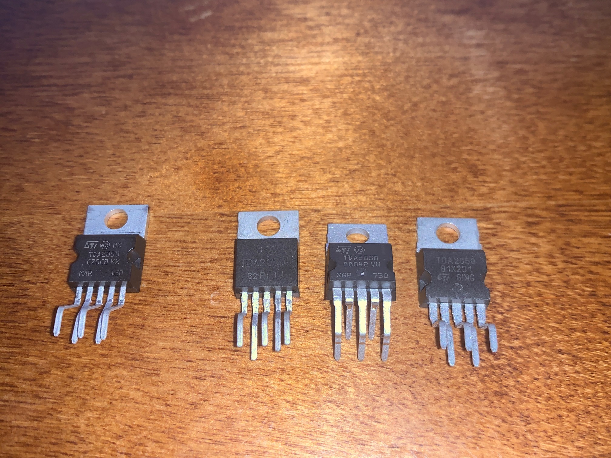

UTC Taiwan are selling 2050, some say they are legal, and some say it is a modified version, but they were allowed to do so by ST.
More clearly, they made 2050 with the knowledge of ST, and do sell them in Europe.
But some people, - Nirupam Bhowmick is a member here - think the changes made to it are not having a good result. He prefers the old ST ones.
The time limit on US patents being live is 17 years and copyright is 75 years, some chip makers like Intel use copyright to protect their intellectual property.
If the patent has expired, anybody can make their version, and calling it fake would itself be wrong.
The patent expires indeed after a certain period of time , then other companies will try to clone that product , those are NOT original product, those are clones .
Since most of these companies will print the original company Logo on the cloned chips , that's a red flag, I call those chips 100% fakes .
About UTC chips, I have some of them , never tried them , I cannot say much.
The chip on the left is fake , next is UTC2050 chip and on the right 2 100% authentic ST chips.
