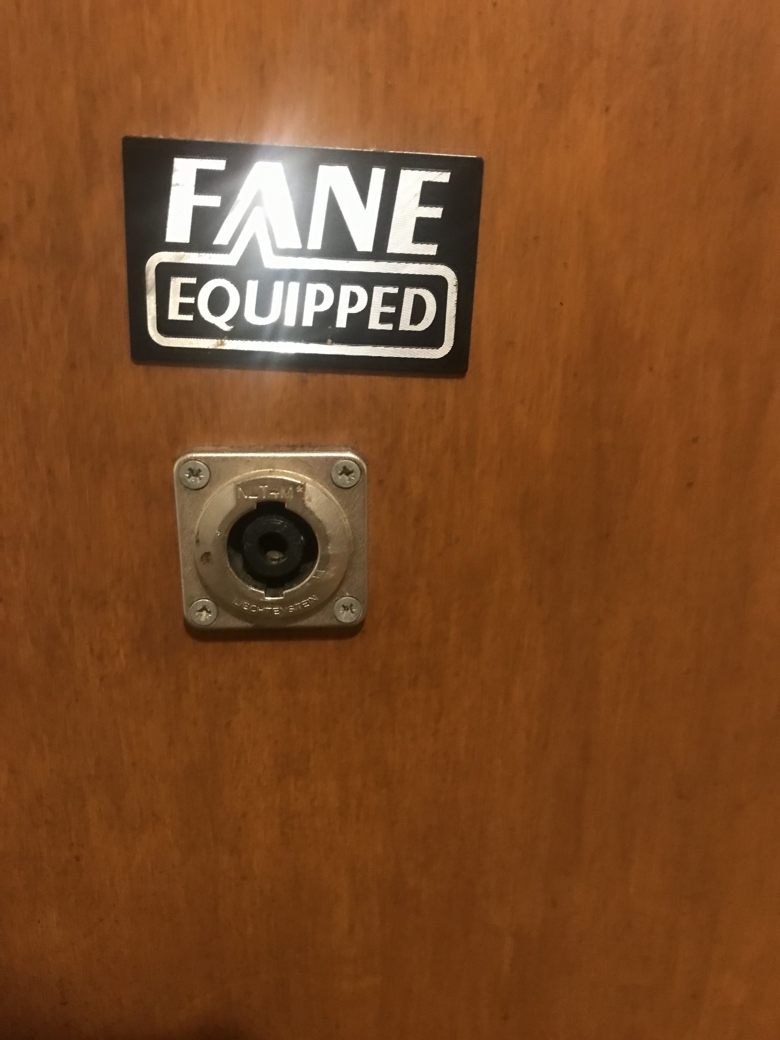

In the long term i plan to cut larger holes in the back of the cabinets and install proper speakon plates with through outputs. Photos below for reference
