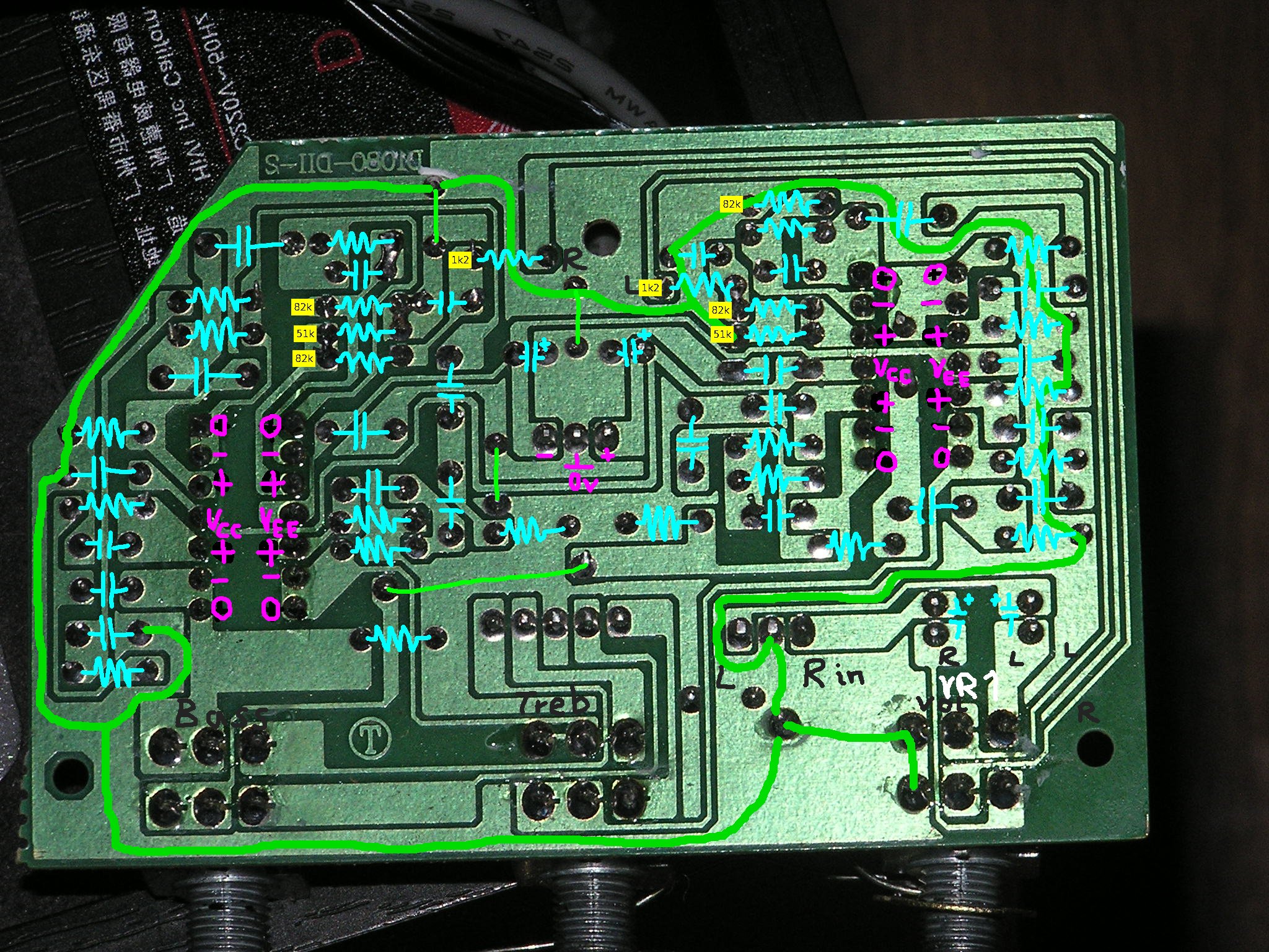

I've been spending my free time these past couple of days reverse engineering these speakers, as a prelude to devising the mods. The first stage in doing that is to photograph the PCBs both sides and have both images up on the screen at once, the underside is flipped horizontally so its as though I'm looking through the board. I then annotate the components by hand with the mouse drawing tool. Sometimes I'll write the values in this way too, other times just paste text for the value next to the component. Most of the time though I'm too lazy to add any annotation.
Here's the result for the volume/tone control PCB - one of two PCBs in the design. There are two quad opamps, TL084s - they're marked up in magenta. Interestingly there's no tone control circuitry as such, the bass and treble controls just act as volume to the woofer and tweeter respectively! I've never seen tone controls implemented in this way before...
