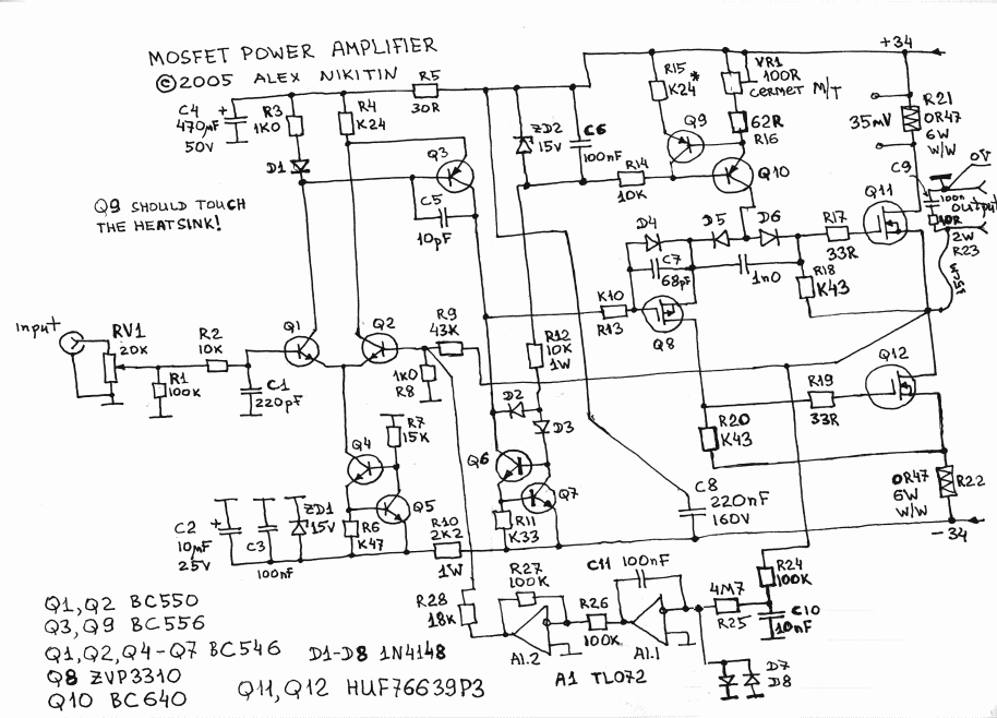

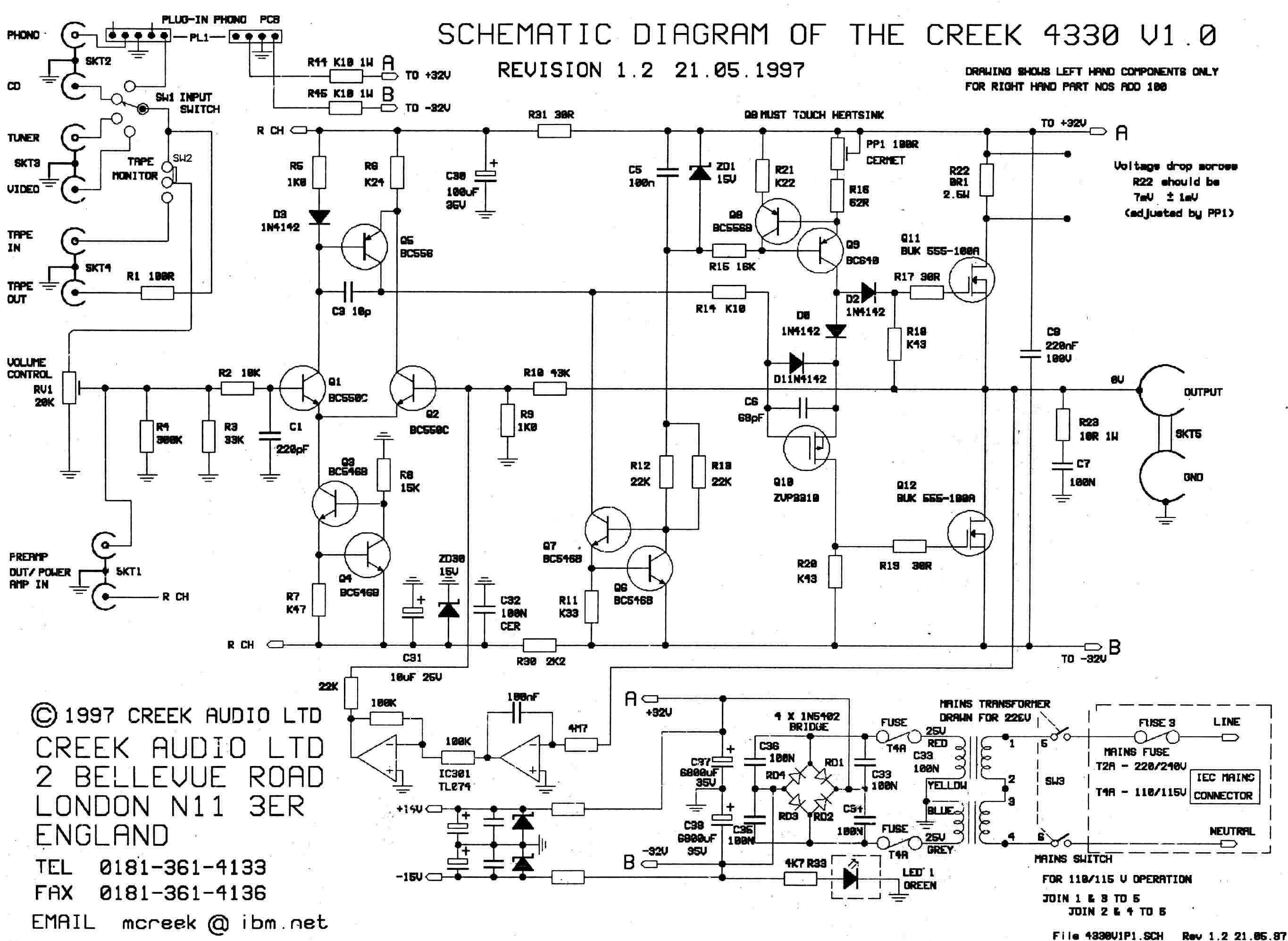

Updated 11th April 2016 at 08:19 PM by alexcp
One of the more interesting projects for me was building a tweaked clone of Creek 4330. It was designed for Creek by diyAudio member x-pro; the schematic is available on his web site. The tweak was the topic of x-pro's paper and was discussed in this forum. Last year, this design generated enough interest on one of Russian DIY forums for a group buy of PCBs and some components. I used a PCB from that group buy, a compact chassis from modushop, and a K4700 speaker protection kit from Velleman. Today it is this amp that I use most often for music, and I am very pleased with its sound. Thank you x-pro for sharing the design!

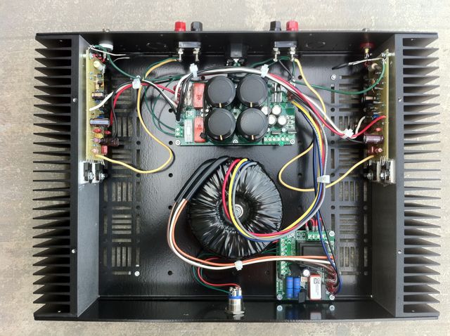

Zen V4
Posted 12th August 2010 at 05:16 PM by alexcp (My DIY projects)
Updated 11th April 2016 at 07:49 PM by alexcp (Amp reworked)
Nelson Pass' Penultimate Zen (aka Zen V4) proved trickier to build than the simple schematic suggested. I used a chassis from designbuildlisten and PCBs made with the gerbers posted on passdiy.com. Initially I used some Chinese electrolytic capacitors that were easily available, but the sound was not good at all. I replaced them with ELNA for Audio, and things improved greatly. I found that the apparent simplicity of the schematic belies the difficulty of making it right.
