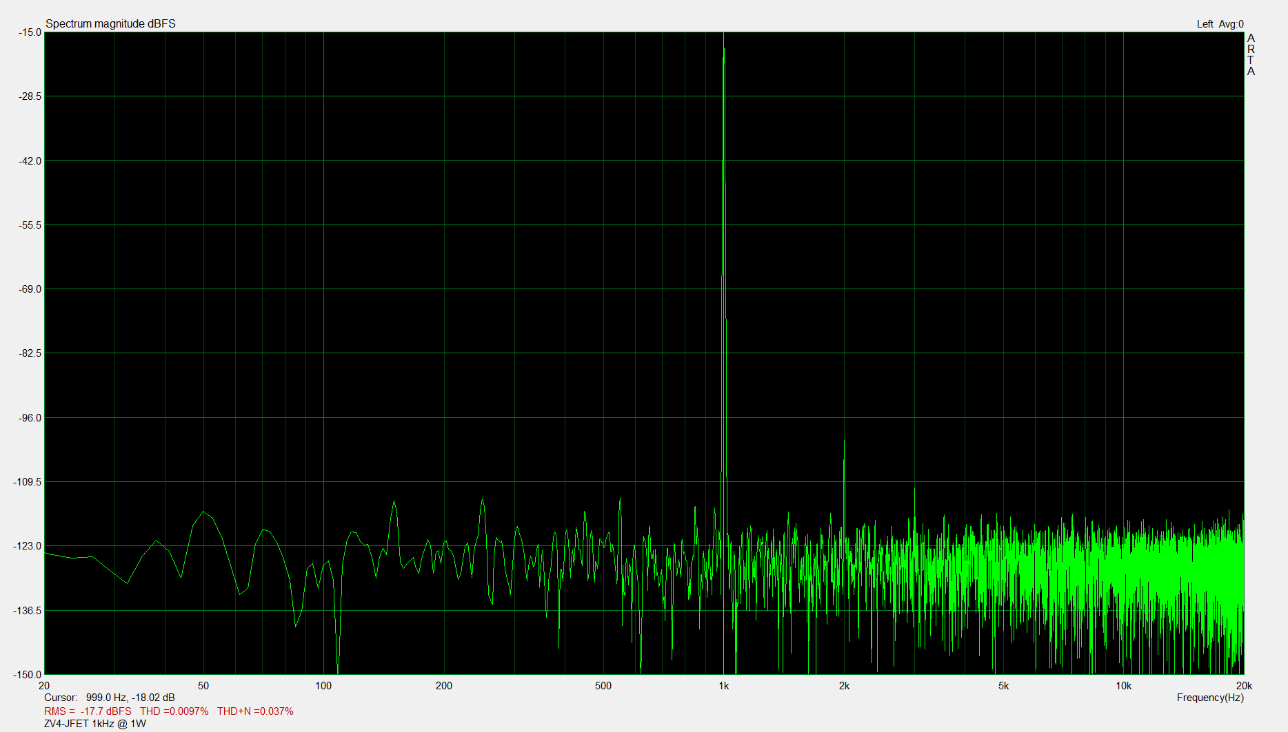

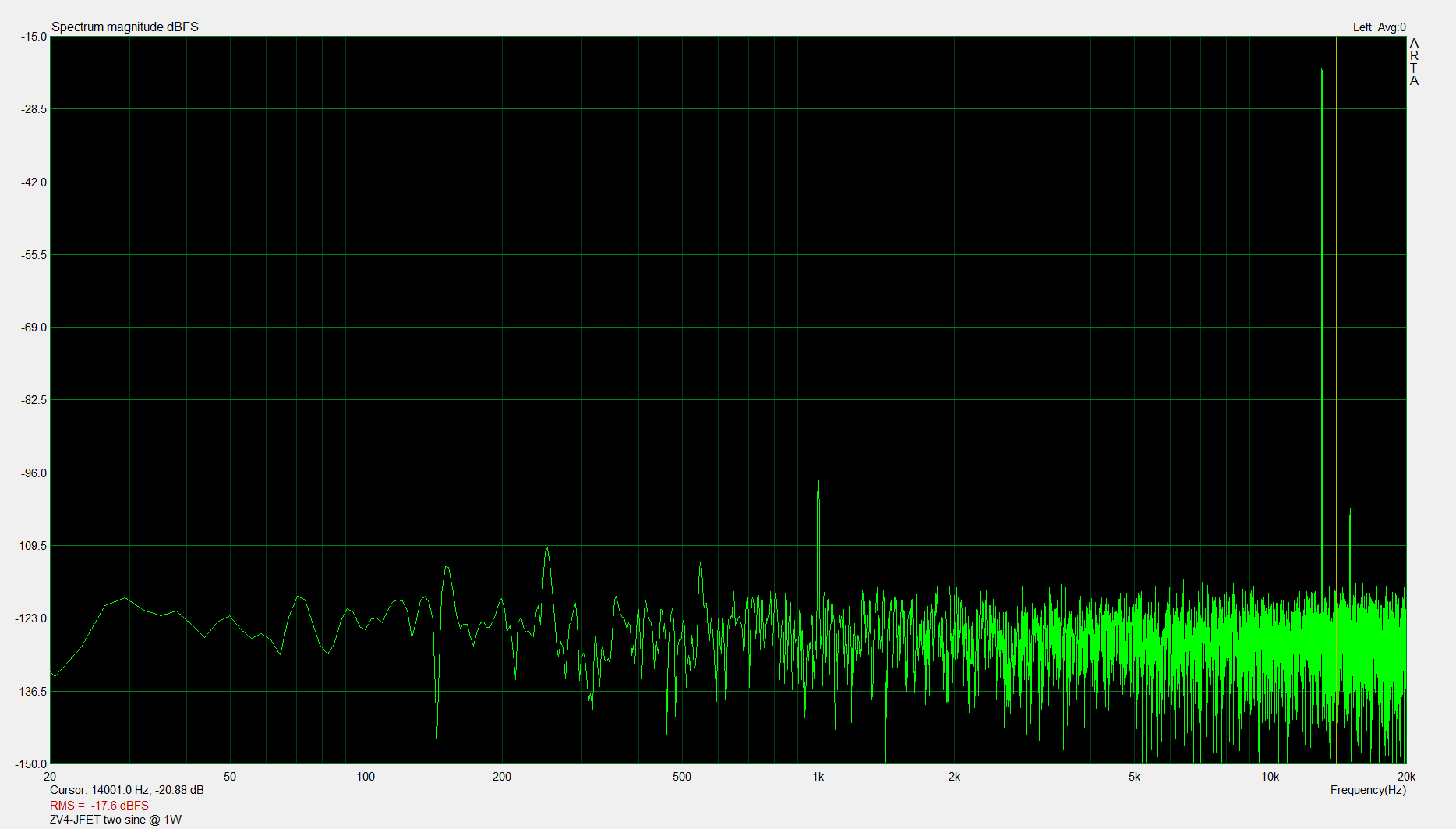

My first solid state amplifier build, in 2009, was The Penultimate Zen, aka Zen Variations Part 4, aka ZV4. It was built with the parts I could find back then, without knowing where to look. It ended up big, heavy with two 400VA toroidal transformers, ugly inside with some electrical tape here and there, without proper grounding, etc., etc. I was as disappointed with the sound as my wife was disappointed with that heavy black metal brick gathering dust.
My first mod on ZV4 came after I turned my disappointment into finding better part suppliers. I returned to my ZV4 and replaced the output caps with something marginally more decent from eBay. The sound improved a notch. Aha!
My second mod was to rebuild the power supply. I threw away one of the toroids, added a softstart circuit from Hypex, and put in a CRC filter with some Mundorf HC caps. One power supply for two single ended channels forced me to learn about grounding and add input transformers and balanced...

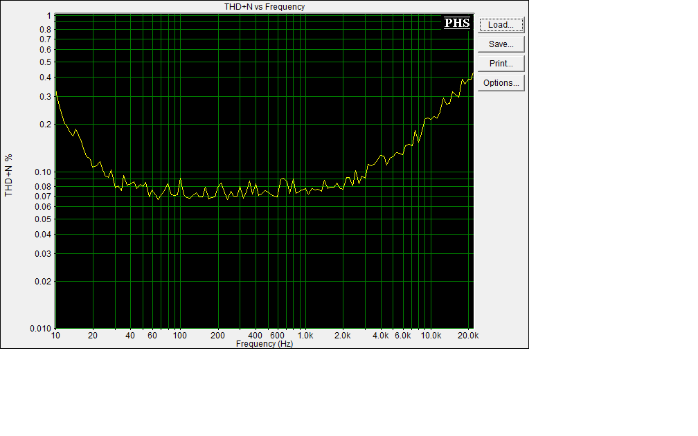

Now that Nelson Pass published the details of the JFET upgrade to First Watt F2 and that Newark sells power JFETs from Semisouth, there was no excuse not to upgrade my Zen V4 with the new active device.
I replaced Q1 (see the original schematic) with SJEP120R100A; increased R5 to 130 kohm to bias the JFET correctly with Vgs of approx. 1.5V; and reduced R8 to 22 ohm.
The measured result is a nice reduction in THD+N; attached are the graphs for THD+N @ 1W into 8 ohm vs frequency, before and after the upgrade. With IRFP044 as Q1, the distortion was mostly 2nd harmonic (at -65dB), plus some traces of the 3rd harmonic. With the JFET, it is still mostly 2nd harmonic, which is now at -80..85dB, with the 3rd below my measurement floor.
Subjectively, the improvement is remarkable! There is additional detail and depth of the scene.
