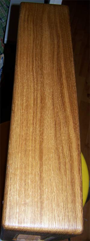

Posted 16th November 2009 at 10:36 PM by Bas Horneman (Bas Horneman's diyAudio.com blog)
I have used a diy fluid for drilling for the first time. Used bicycle chain oil...water and detergent. Quite happy with it. Drilled the largest hole yet. And it looked almost professional.
Also a photo of the oak enclosure after it was treated with boiled linseed oil. The oil makes the oak enclosure look a lot better, it really brings out the grain. As usual I don't have "before" pictures to show the difference. (the pictures below had a partial coat already)
I'm not sure what to seal the wood with. Suggestions are welcome. Right now I'm thinking about shellac.
