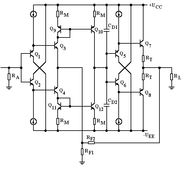

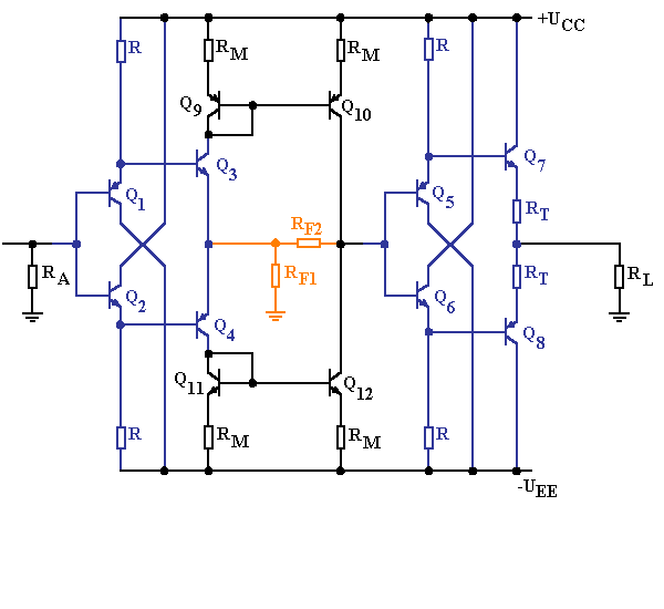

Current Feedback Amplifier
Posted 31st January 2012 at 06:15 AM by rjm (RJM Audio Blog)
Updated 31st January 2012 at 06:22 AM by rjm
Found this today: DC Coupled Amplifiers for Audio from an 11 year old web page by one Knut Harald Nygaard.
I've taken some minor liberties with the circuit, shown in the second, color image below. Replaced the current sources with resistors and moved the output buffer out of the feedback loop.
Note the resultant double symmetry of the dual-diamond buffer topology, highlighted in blue.
