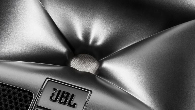

IMHO, JBL's "Image Control Waveguide" is simply a new twist on an old concept: a diffraction horn.
Hello,
This is all old stuff with the edges rounded and polished.
I think of the Image Control Waveguide throats as image control weirs with well-rounded geometry. The sound travels the paths of least impedance.
Someone needs to get close and measure the distortion differences among horn throats with sharp diffraction slots, these “new” ICW’s with well-rounded geometry and throats with no groves or notches.

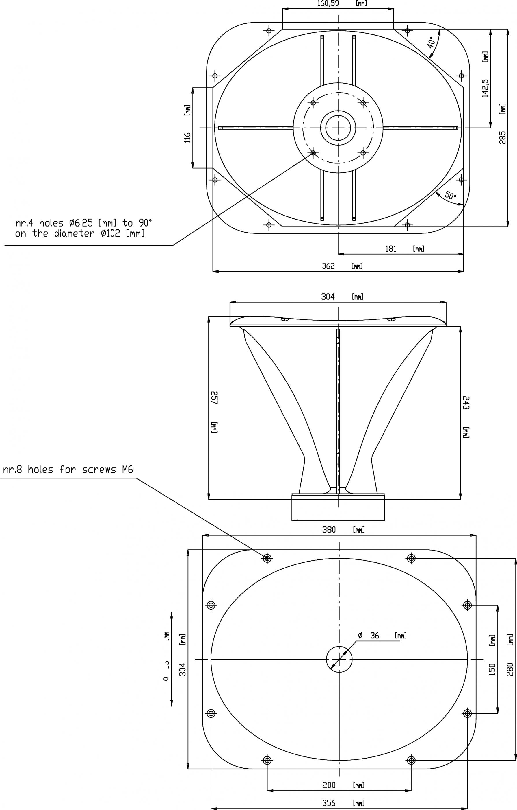

In any event, I don't think the JBL "Image Control Waveguides" are either diffraction elements or horns. The profile expands out from the "entry" (even if variable with its profile) and the design is focused on dispersion irrespective of gain.
As an alternative, note the "pinch" in the XT1464 at the "entry":
The XT1464 is definitely not pinched. But the smaller XT1086 has something that is leaning towards a pinch (it is not getting narrower actually towards the mouth but it does start a little later to expand in the horizontal direction than it does in the vertical). And the XR1496 is definitely pinched but in a rather smooth way IMO. This is a 1.4" 90 degrees horn that I would definitley like to hear.
..but 18 Sound's diagram *clearly shows that it is, and the polar map's "agree" with a top-octave pattern that would not be there without it.
*Maybe a better look is required through the PDF with "zoom-in" capability:
http://www.eighteensound.com/Portals/0/PDFs/XT1464.PDF
..in addition to the "pinch" near entry (shown on 2nd/side-profile diagram), the centered "double ring" from the diagram for the CD connection plate (shown on 1st/rear-profile diagram) - also presents this: the entry is a larger diameter "ring" than the interior "ring" that shows the "pinch" character. (..at least this is the sort of behavior I get with 2d view when working with 3d CAD.)

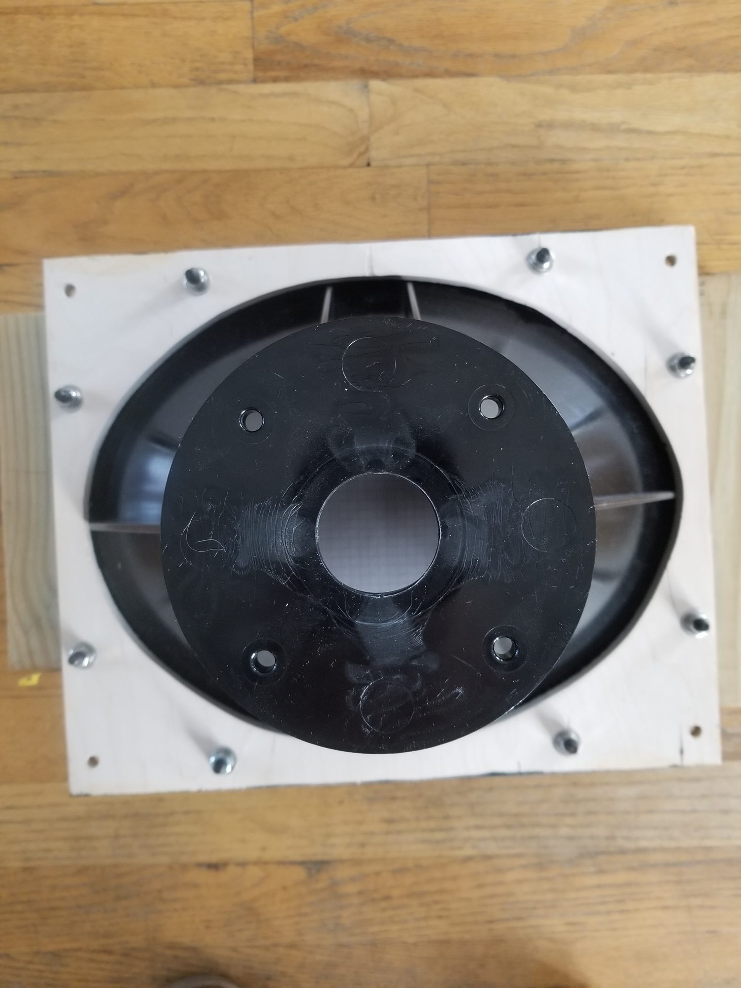

I am actually listening to mine at the very Moment. Let me see whether a mobile phone picture is worth anything.
It would have to be from the rear (with good lighting and CD detached). Looking down the throat will really (likely) only show the most constrained portion, as seen from the 3rd/mouth diagram.
Now if the "pinch" was further toward the mouth (rather than being such a small/short transition).. THEN you might be able to pick up the difference from the front.

It's not pinched at all...I have one laying loose.
Picture? (rear.)
I only ask because it's not what is shown in the datasheet diagram.
I will post them tomorrow because it is easier to do it with the pc than with the phone. Visibliy there is no pinching. Probing with the index finger makes the impression of a veeeery slight pinching.
Yeah, I 'felt' that slight pinching too, but couldn't see any, so I got a caliper out that measures bores.
What we feel appears to be the transition from mounting flange to horn curvature, but it doesn't really constrict at all.
I have here an XT1464Y ( an OEM version made for Yorkville ) and it's definitely not pinched from entry through to flare.

PS; I see in the second pic of the pdf it shows a 1.4" entry that necks-down to about 1" before starting it's expansion >> mine is certainly not like that!

Picture? (rear.)
I only ask because it's not what is shown in the datasheet diagram.(..at least as I'm reading it.)
No problem...seeing is believing, huh?
I think I know why people think it might be pinched: That stiffening thingie ( some sort of ridge, don't know how it is called in English) on the outside is shaped such that it could be mistaken for the outside of a pinched horn contour. You can see it quite well on the Thomann website.
No problem...seeing is believing, huh?![]()
Actually it does look like there is one from the photo..
Yeah, I'm guessing it's a manufacturing plastic weld. (..joining connection plate to horn, assuming it's totally flat to that interior diameter.)
Their data sheet need's to be revised (IMO). Being familiar with CAD, what they are showing in their sheet is NOT what they are selling. (..and while the end-result isn't a bad thing, it does cause confusion.)
