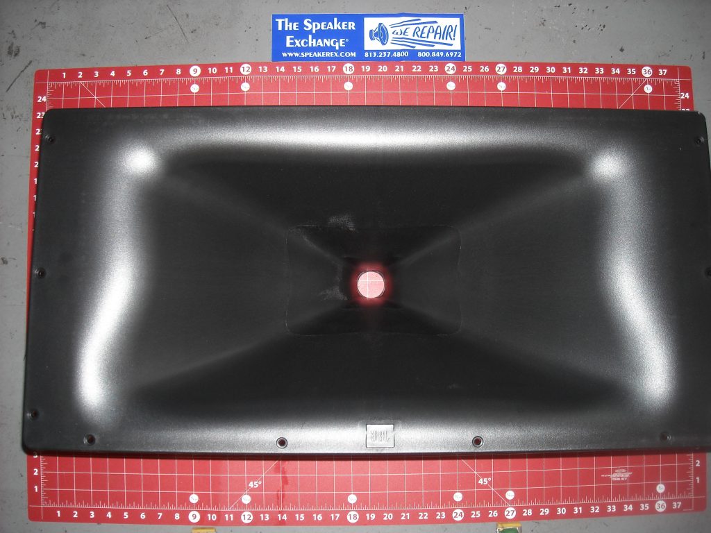

"There are these 2" horns I found on ZXPC's website -"
These are very good value. Overall decently solid and well made.
The throats may need a bit of work if you are a perfectionist.
The throat area may need a brace if you plan to mount a very heavy driver and/or will subject them to rough handling.
...but that's quite OK, considering the price. They are also pretty easy to drill / grind, so are a good test rig (e.g. to try a DIY Synergy, without too much work / without buying a lot of tools).
