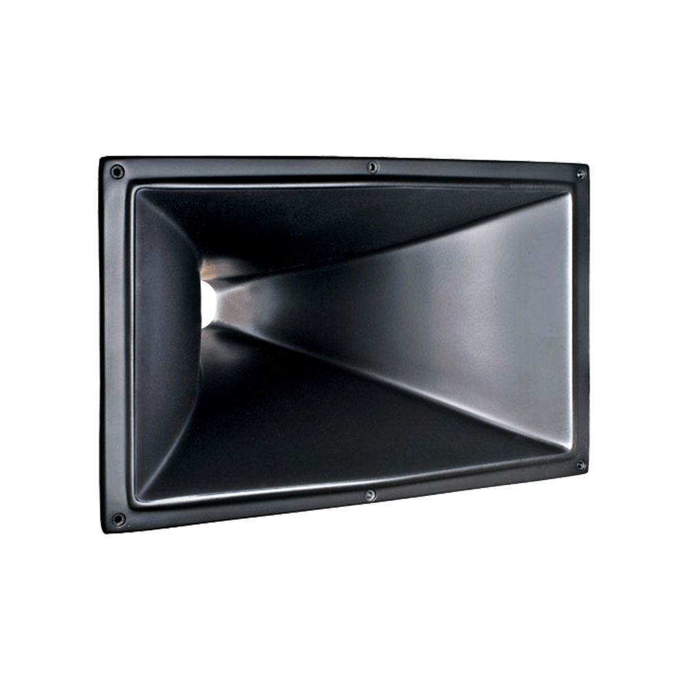

HelloThat's why some Japanese added an throat extension to the 2380A.
The effects are visible in the shaded part of the response curve below.
In the second plot, EQ-ed response shown compared to the raw response (below).
With DSP the response could be improved.
The 2380A isn't a bad horn, provided it's implemented properly.

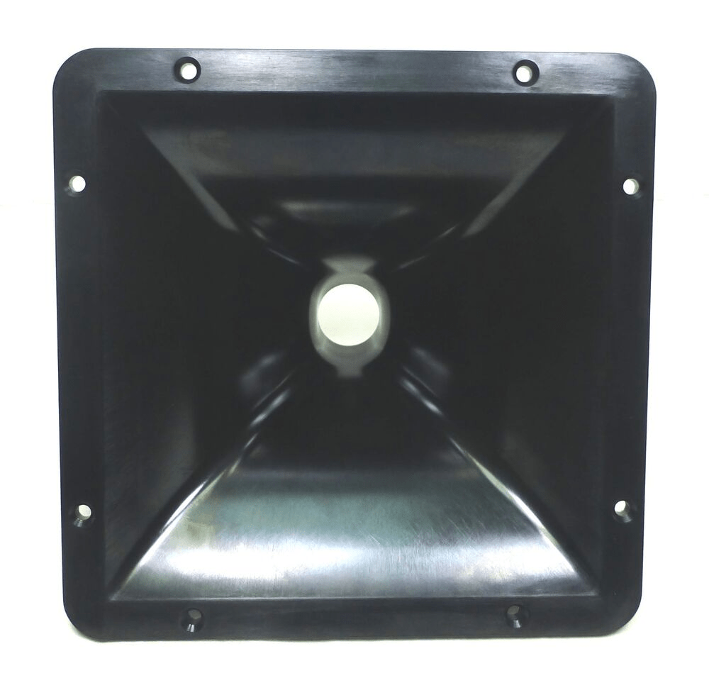

The Lease Horn, a rather good looking clone of the B&C ME 90 (available in Europe for €75) offers controlled directivity and wider coverage at the expense of loading.
In combination with the JBL 2431H, it should be usable from 800-1000 Hz.

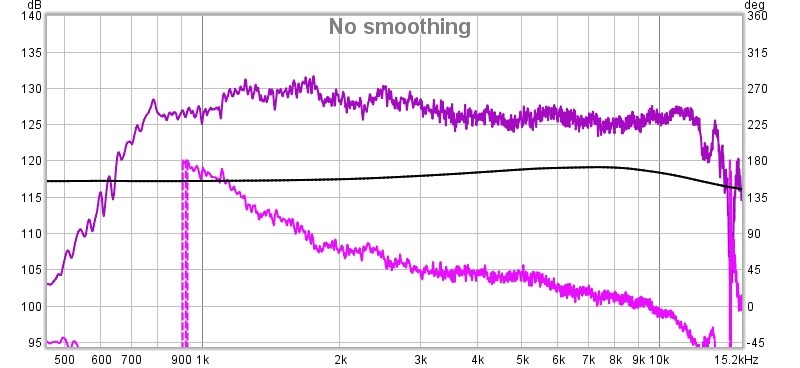

Scholl, do you have measurement data of the Lease Horn + 2431 H?
Lease ME 90:
B&C ME 90:
Lease ME 90:
B&C ME 90:
Yes, I do. And they look pretty good. This one has EQ it would be about 10db down at 10K without EQ. Note that the breakup above 10K is downward where some 1.5" drivers are upward.The Lease Horn, a rather good looking clone of the B&C ME 90 (available in Europe for €75) offers controlled directivity and wider coverage at the expense of loading.

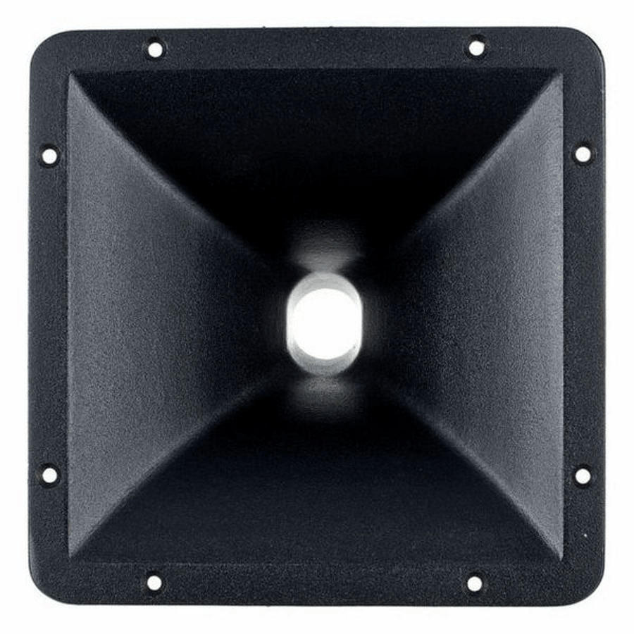

Another CD horn, with a relatively smooth slot. No pinching, just a constriction in the horizontal plane like the18Sound, B&C and RCF horns.
Overall, it looks suspiciously like the HF950, albeit without the vanes and with an 'open slot', i.e. the (1" instead of 1.4") throat is fully exposed.
It appears to be tiny, but it isn't > 30 x 30 cm mouth and 22.5 cm length, so cut-off should be < 500 Hz, making it usable from about 700-800 Hz.

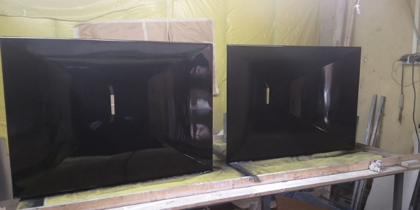

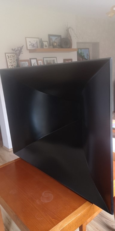

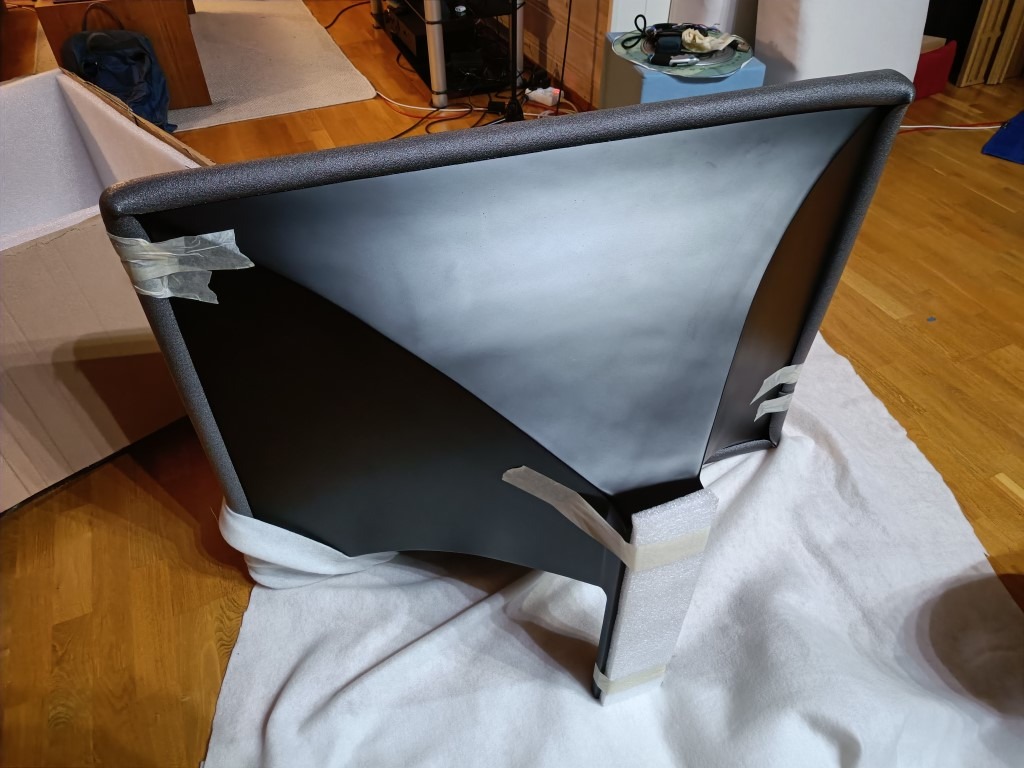

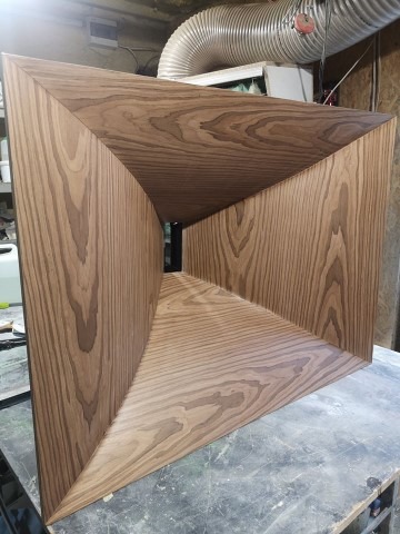

We will have two pairs of our horn we can sell in a few months. It will be one time opportunity as we don't plan to sell these separately. Dimensions of horn is: 110 (w) x 80 (h) x 55 cm (d). Directivity approximately 80x50°. Exceptional constant directivity. Works with Radian 951 with 1.4" exit only.
One pair with simple black paint and some aesthetic deviations.
And one pair with walnut veneer on the inside.
PM me if anyone are interested. Take note that they are not cheap like many PA horns and shipping cost might be high.
![Side (Liten).jpg Side (Liten).jpg](https://www.diyaudio.com/community/data/attachments/1038/1038230-2d9316dc9982195f9dcf0a5c1eab74d2.jpg)
![IMG20221125192818 (Medium).jpg IMG20221125192818 (Medium).jpg](https://www.diyaudio.com/community/data/attachments/1038/1038231-ee55c38d712e159e99ac2aa4b4831c86.jpg)
