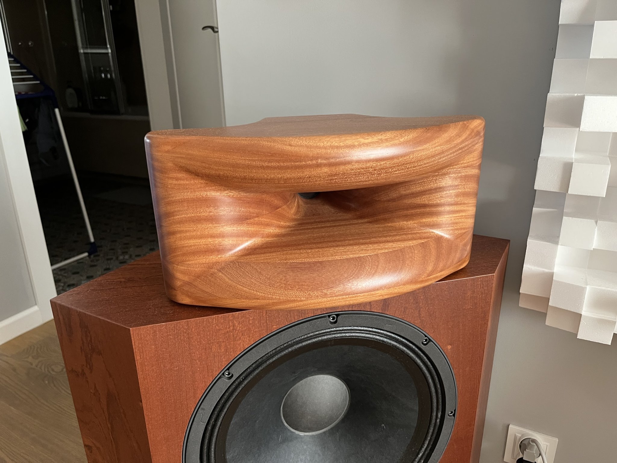

Have anyone tried Joseph Crowe horn design? how is it compare to other popular one?
I have got ES-600 and I can compare it HF950. The ES-600 has much narrower beam, but they seem to produce more stable imaging when being placed close to the front wall. ES-600 are 2x more expensive if being printed, or 10x more expensive if being made from wood.
