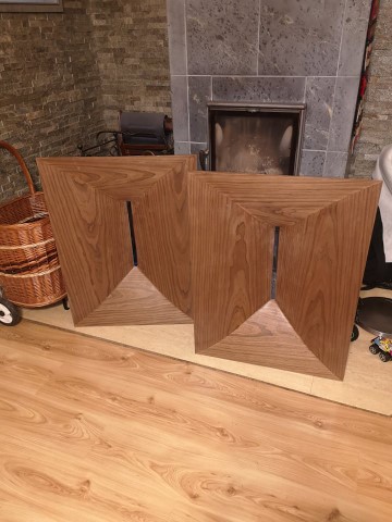

Found some quite large horns from our local musicians flea market.Bought all four of them..
They are from brand: "Community" and model is PC264.
https://www.communitypro.com/sites/default/files/PC264_spec.pdf
Was thinking about active 3-way with 18" JBL 2240H in 200L sealed (up to 120Hz) and 15" JBL 2226H in 45L sealed chamber (120-500Hz) and those community horns with RCF ND950 2.0.
All drivers in same enclosure. Already own those JBL´s
Is this waste of time? Anybody tried PC264 horns?

pic of my horns:

Nice find!
Haven't used that specific horn, but have used other Community horns, they do what the spec sheet says, and are built very well.
The size and construction of those horns would allow the 2226H to share the horn, saving frontal space, improving vertical polar response and imaging.

Thanks for info weltersys! They are really sturdy and there is possibility to modify them. im glad that i bought four of them, could take risk of modifying one pair.
Have to study those threads first, hope there is info how large openings have to be made and how far from throat.

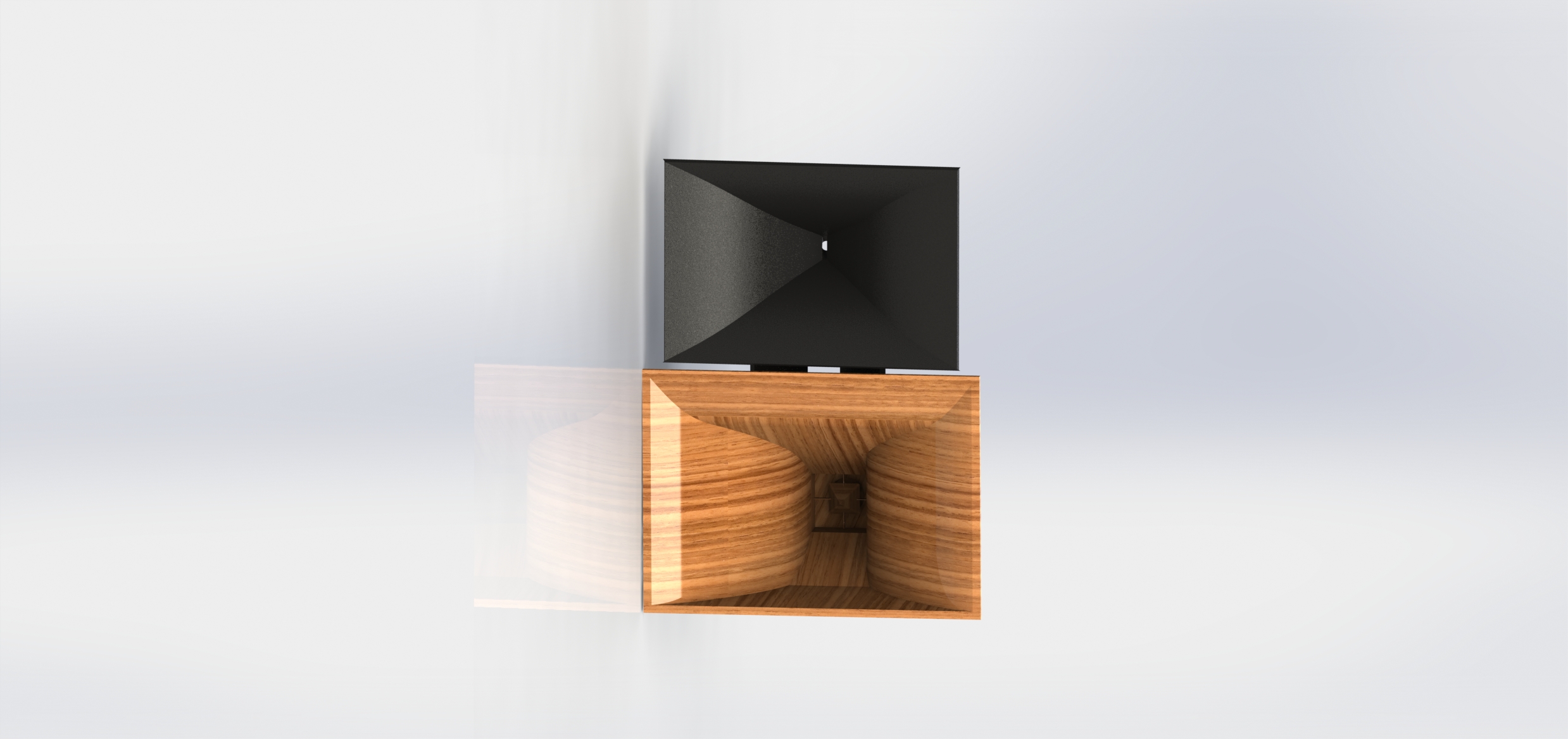

I'm working with Don Keele and Bjorn Kolbrek on a horn design that have several of the same specifications. A 2-way design that requires a separate bass/subwoofer solution. May also get a horn subwoofer designed with it.
- 80x50 coverage angle
- Frequency range 90 Hz-18KHz or higher
- Crossover at 600 Hz or lower if the driver permits it
- Very uniform directivity low in frequency
- Exit angle of 1.4" (Radian 951BePB driver) but could also be made for other drivers including those with an 1.5" exit
- Non resonant enclosure
Downside is the size the horn requires for constant directivty low in frequency and it's not cheap to build either. I have a Klipsch K-402 horn which I will use for comparison to the top horn. The top horn needs to be better than Klipsch for it to be worth it.
Already have measured and tested the midbass horn. While we'll may be making some adjustments to it, it does work tremendously well today. The horizontal directivty doesn't change much before you get to 100-150 Hz. Picture of it below with the Klipsch K-402 horn on top.

There are no plans to sell the horns separately presently. The top "midrange" horn surpassed the Klipsch K402 in several ways and offers extremely uniform directivity.

What you mean by unfair? Shouldn't one compare horns that have different topologies by listening when finding out what's best? That makes no sense to me.docali said:To compare this to the K402 seems to be not fair as your horn obviously have a strong diffraction slot section what the K402 does not have. What is happening in this section while we encounter very abrupt flare rate changes?
The horn measures well on-axis too. I don't care much about minor small peaks/dips with high Q and especially if they are minimum phase behaviour and thus can effectively be equalized.
