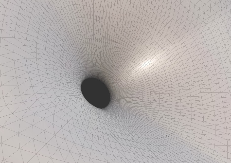

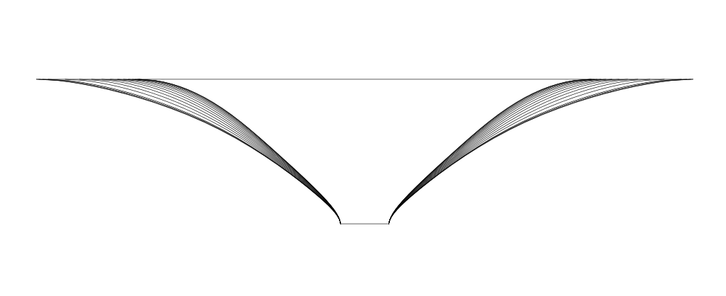

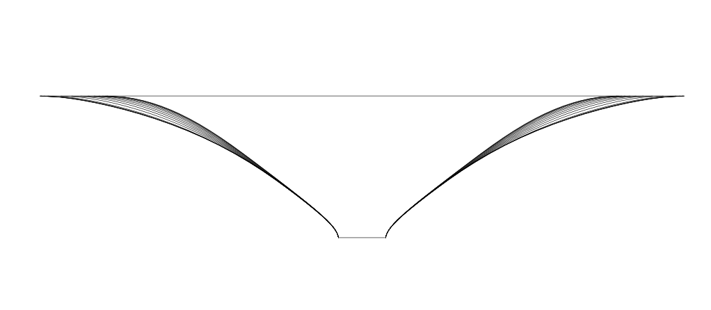

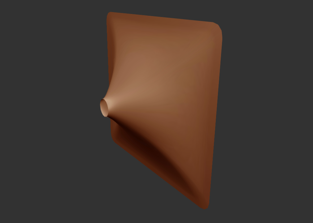

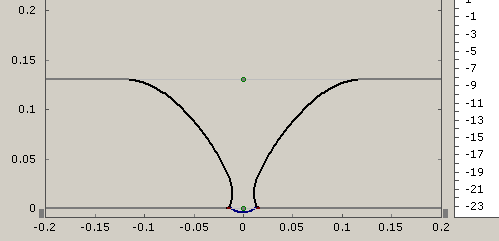

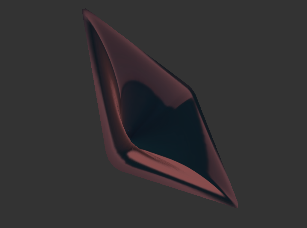

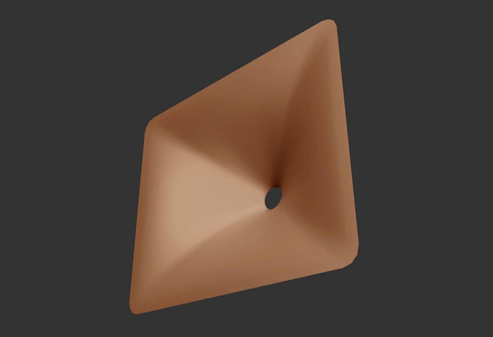

I found some more pictures of the "rectangular" profile including cuts around the circumference. I'm willing to release the tool if anyone is interested. I could incorporate a functionality of generating of complete ABEC project with a mesh file so everyone could easily "design and try" their own. Any interest?
That is something still to be figured out and which I hope someone will show later on. I don't work with any 3D CAD myself and I have no clue what the possibilities are, I only know it can be done. All I'm able to do is to export coordinates of the points in some form. These can be imported to CAD and then splines, surfaces and volumes created. We already tried this with jzagaja and it worked with satisfactory results. I can create directly only triangular meshes and STLs...
Hold on, I'm finishing the tool to be released. I began to use Gmsh API internally so it's really easy to add any mesh for ABEC, including a (rounded) box for the waveguide, etc.
Well done mabat! I would really apreciate if you choose to share the ABEC project as I am learning the software myself.
Importing points into CAD and creating a solid model for CNC or 3D printing will not be very difficult.
I have been working with waveguides about 10" in size in ABEC and had to move away from OS to obtain nice polars. Interesting to see your results in this regard.

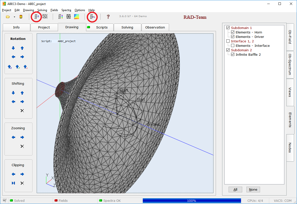

I just need to write some short user guide. In the meantime you can try these two sample projects. All you have to do (provided you already have VACS and ABEC3 on your computer) is to load the project file to ABEC and push the two buttons in the toolbar (left first) to see how good it can get.
These are some quick ABEC projects just created by the tool. One OSWG and a rectangular-morphed horn. Calculated are horizontal, vertical and diagonal polars and a radiation impedance, for the start. You can inspect the *.msh files with Gmsh (Gmsh: a three-dimensional finite element mesh generator with
