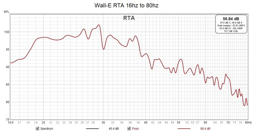

Here's an interesting graph of my own, from Wall-E the animation movie. It slams 30hz and has 20hz peaks that are almost at the same level as the 30hz stuff. It's not just once either, it happens quite a bit in the film. Plenty of "kids" movies like the Pixar stuff or similar have rather extended bass.
But as you can see here, after 19hz it drops rapidly. But still, the 20hz to 30hz data is within 4~5db of each other as peaks through this movie.
Overall, 20hz to 20khz covers virtually every title except truly just a handful.

Thanks for that graph. Funny - I don't remember Wall-E has a bass heavy film when I saw it at the cinema. But it certainly has LF in that mix.
But that does 20-30 Hz actually sound like? Isn't most "slam" that people like so much more up around 90Hz?
That's the thing, 20hz at 98db doesn't sound nearly as loud as something 40~60hz at higher SPL does. We are increasingly deaf the lower the frequency goes. You would need +10db or more to even begin to feel like it was slamming. Also not everyone can hear 20hz. I can hear it at very high SPL, and I can get 112~115db at 20hz in my room no problem, but I don't listen at that level. I can "feel" 20hz though, in that 105~110db range and that's where I listen at for a movie.
20hz doesn't slam though, it's a rumble, nearly inaudible, you feel it more than anything. Chest slam happens between 60~100hz. I have dual 12" drivers behind my seat for that job.
If you go through the graphs, most content has repeating 30hz as its nearly lowest area and it repeats often, so building to 30hz makes a lot of sense. There's plenty of newer content getting down to 20hz area, but it's at lower levels and way less common, so maybe once or twice in a film or more sometimes, depending on what it is. There are of course some that do it a lot, but they are rare exceptions.
Wall-E has a lot of it because of the space ships and equipment slams, they often will slam at rumble at 30hz and roll off down to 20hz so that it's not just a weird on/off sound and has a natural roll off.
Another one is Home (a cartoon with aliens). Lots of flying space ships and "big effects" that dig deep.
But most of these are already measured in that thread linked above; just look at the RTA peak data and focus on 30hz and below. It would be awesome if we could compile all that data into an excel sheet to see what % actually goes below 20hz with any meaningful level other than like 5 titles out of hundreds or thousands. It's that few.

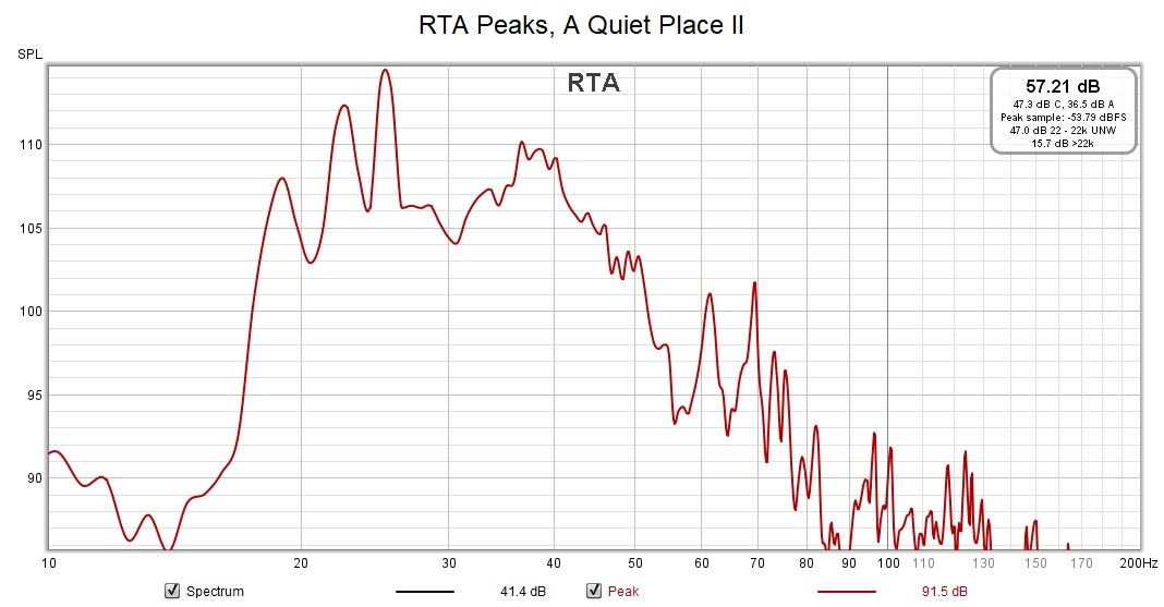

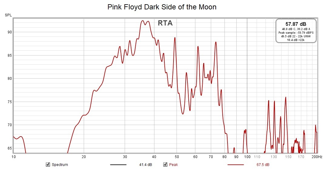

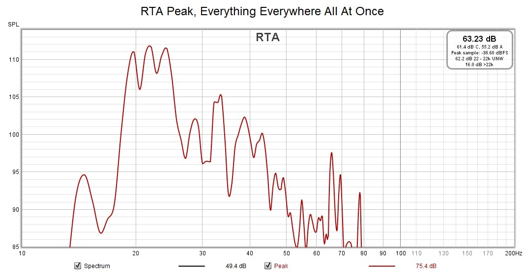

Just watched two movies and listened to a classic record.
Pink Floyd Dark Side of the Moon
A Quiet Place II
Everything Everywhere All At Once
I gathered peak RTA data from all three.
For a classic recording, DSotM is a pretty "bassy" classic 70's rock album. Most are not this bassy. You can see my primary peak from 35~38hz. But crazy enough, there's audible information rolling down from 30hz with natural instruments. Not super impactful, but it's there.
A Quiet Place II has lots of quiet moments then it bursts with tons of bass. Everything is artificially inflated with bass. Everything. Breathing has bass. Shotgun blasts have infrasonic bass artificially added. The monsters every move and breath has lots of bass. You can see with my peaks here just how much. Look at that 25~27hz peak hitting 114db and right below it a 22~23hz peak at 112db and even a peak at 18~19hz at 108db. 30hz stayed in that 105db range where I mostly listen (bass wise) for movies. All the 40hz data is mostly the gun fire and/or the attacks from the monsters and that 40hz slap was pretty impactful. I was watching the graph while watching the movie and the moments where it would drop into the 20's and below it was mostly reverb from an impact of some kind. Still, the bass in this movie hits hard from beginning to end and takes advantage of a system that can do 20~30hz range for sure, but it won't have much for anyone with a system that can go below 20hz.
Then that movie Everything Everywhere All At Once. Lots of dialog. Lots of martial fight scenes. Plenty of 28~40hz peaks from slaps/impacts/slams. But the transitions or multi-verse jumps which happen every other minute all had this huge 19~26hz peak that would happen, as you can see, hitting 112db here and all a solid 7~9db louder than any other bass frequency. It really added some omph to this kind of film. And as you can see, a system that only did 30hz and up would have completely had nothing during those multi-verse jumps every minute or other minute. But you can also see, nothing below 20hz really mattered much.
On a side note, I noticed in this film that every time there was a low tone there was another tone with it that was always 1 octave higher. It made for interesting effects with some of the transition scenes that each used 20hz and 40hz but the 40hz was a much lower level despite both happening at the same time. Was cool.

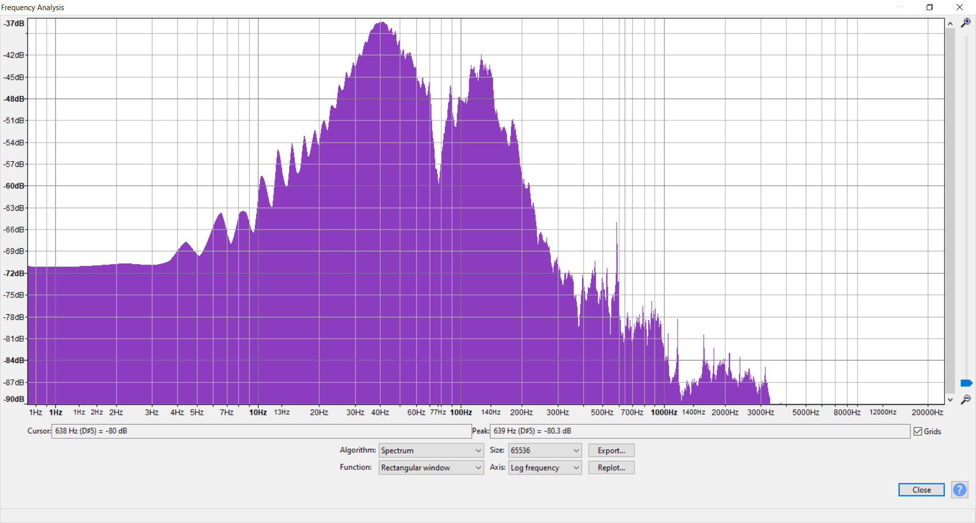

However, transients occur with many instruments, and those can contain much wider bandwidths. I just pulled up the bass drum channel from a recent live/recorded session I provided sound for, and ran it through Audacity's spectrum analyser. A screenshot is attached. While that particular mic + drum combo had a strong 40Hz peak, there's content down into the single digits.
The mic in use was an AKG D12VR, which starts to roll off around 30Hz. A large-diaphragm condenser with an even-more-extended LF response would certainly show stronger sub-30Hz content. IIRC, the mixing desk's mic inputs are a few dB down at 10Hz as well.
