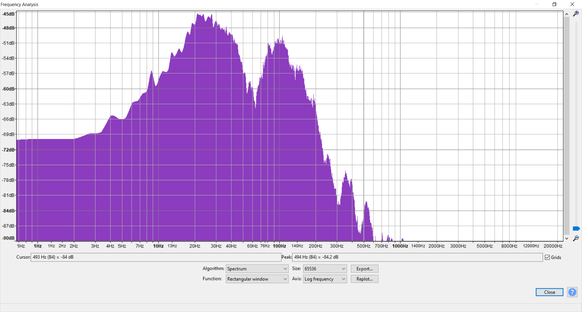

I see the bass drum having twin peaks. 40 Hz and 140 Hz. That would sound like a big thump, right? I don’t see any of the HF that we usually dial in for live sound to give it a crack or snap.
This particular bass drum was pretty well-damped IIRC, with a small duvet shoved in there. There's also the fact that I selected about 10-15s of content for Audacity to analyse, so the short HF impacts probably aren't represented properly.

Ben,
In this case, the mic was positioned at the port of the bass drum, and it's entirely possible that some cancellations were showing up, relating to the dimensions of the drum etc.
I'll see about posting a short sound clip later.
Season's Greetings,
Chris
PS - Bonus spectrum. Different bass drum, different mic. This time it's a Sennheiser e902 which I've modified by taking out the strong EQ contour in the low-mids.

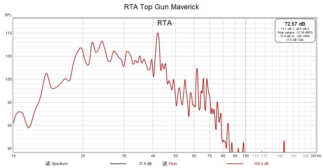

Just watched the new Top Gun Maverick film. Here's my RTA graph from the movie:
Plenty of sub bass through the whole film with the jets and engines. Lots of 40hz peak stuff with the explosions, machines, slams, etc. I was getting lots of tactile response from 18~20hz range pretty often with the jet engines in almost every other scene or so, so it was pretty common. And there were a few moments that had spikes down even lower into infrasonics, but it was much more rare, including my spike around 15hz there. That happened maybe once or twice. But the 18~20hz stuff was through the whole movie. And 30hz and up was all the time except in quiet dialog scenes. So this movie absolute needed to have that infrasonic to sub-bass range below 30hz or so much of it would have been missed. The tactile response rumble I was getting at the 18~20hz moments (they were not just peaks, they often sustained a few seconds with a jet engine) made it like you were near the jet feeling all the vibration, it was fun.

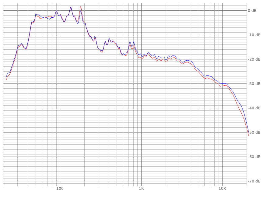

chris661 - Kudos for measuring a real bass drum. The very low-frequency energy is due to the mallet hitting the drum. It is the initial transient, not perceived as a tone, but gives the impact.
The "Rhiannon" spectrum is among the most bass-heavy that I have seen. Most rock music peaks higher in frequency. This is intentional to avoid spending the limited spectrum on sounds that one can barely hear.
Even worse, nearly all pop/rock music has tipped-up treble to make it "radio-friendly" (Rhiannon is an exception). Every station wants to be the loudest.
I think our observations are consistent - a bass drum can generate very low frequencies, but very little makes its way into the mix.

Just because the impact isn't a "tone", does that mean we shouldn't reproduce it?
The spectrum I posted shows 4Hz is 20dB down on 20Hz. The 4Hz component would require about 2.5x the excursion of the 20Hz component, assuming a speaker mounted in a sealed box. The 20dB down is also ignoring the LF rolloff on the mixing desk input, and the microphone's diminished sensitivity to frequencies that low. It's difficult to determine how much LF signal is lost, since all of my measurement gear also has inherent rolloffs <10Hz, but I'm certain that a DC-coupled microphone & recording device would show much higher levels of the VLF.
FWIW, there's plenty of not-rock-music with stronger intended-by-the-artist <40Hz content. Heck, even the rock bands with a 5-string bass tuned down (low-B = 31Hz) will do the job.

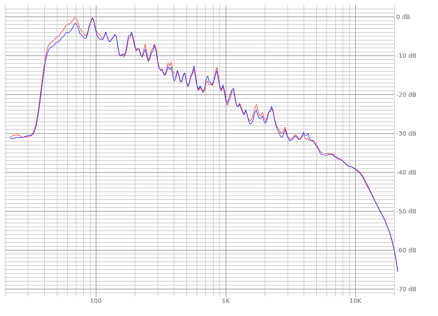

Chris - Here is the spectrum of a somewhat more recent rock recording - Metallica's "Enter Sandman".
This one also rolls off very quickly below 40Hz. "Enter Sandman" has a lot of high-frequency energy (enough to drive listeners from the room if played loudly). 😉
I am not saying that low bass should be rolled-off, just that it has been in all of pop/rock recordings that I have analyzed.
