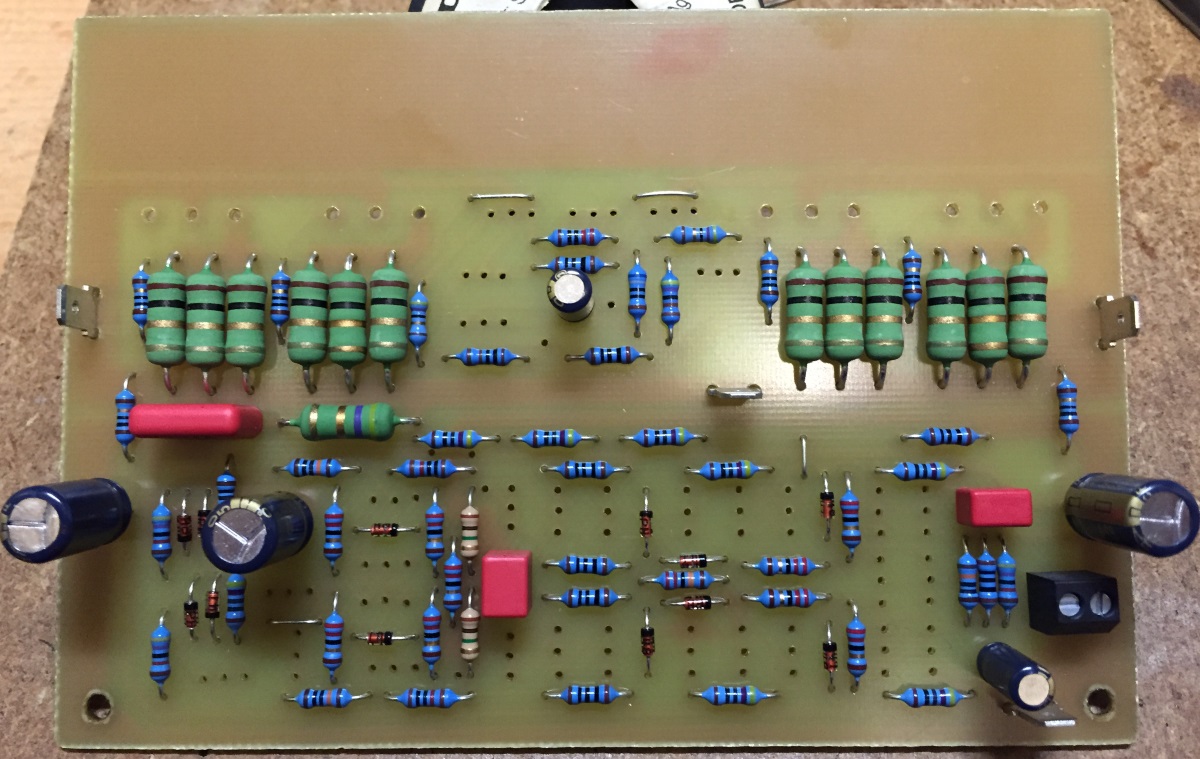

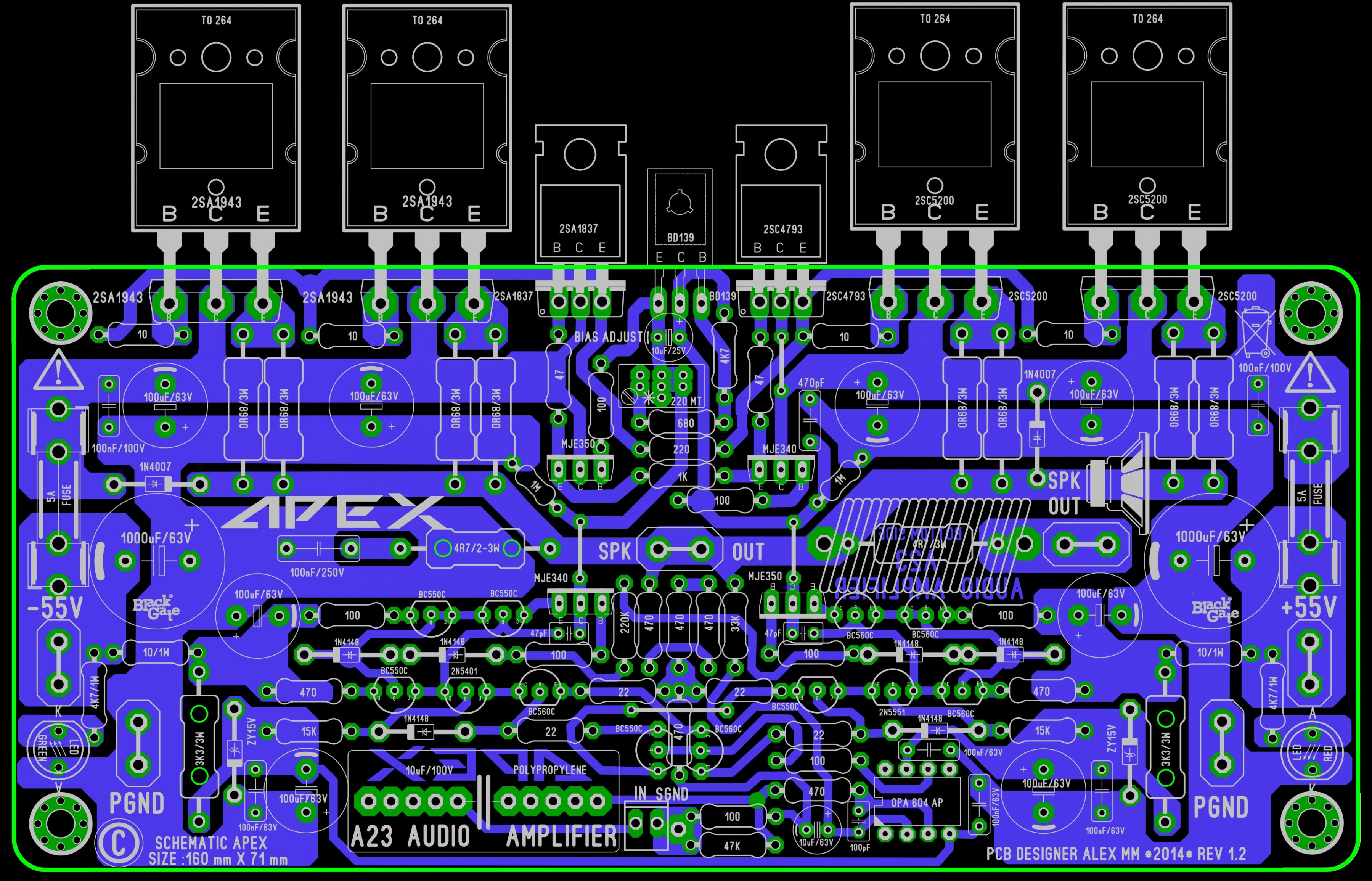

After detailed check :magnify:,of traces I find ,only one mistake as usual .
Corrected layout attached below , I will test as soon as I have some time to do this. I will report my results 😉
Regards ,Alex

Files for PCB of A23 audio amplifier in .pdf format for toner transfer attached....🙂
Regards ,Alex

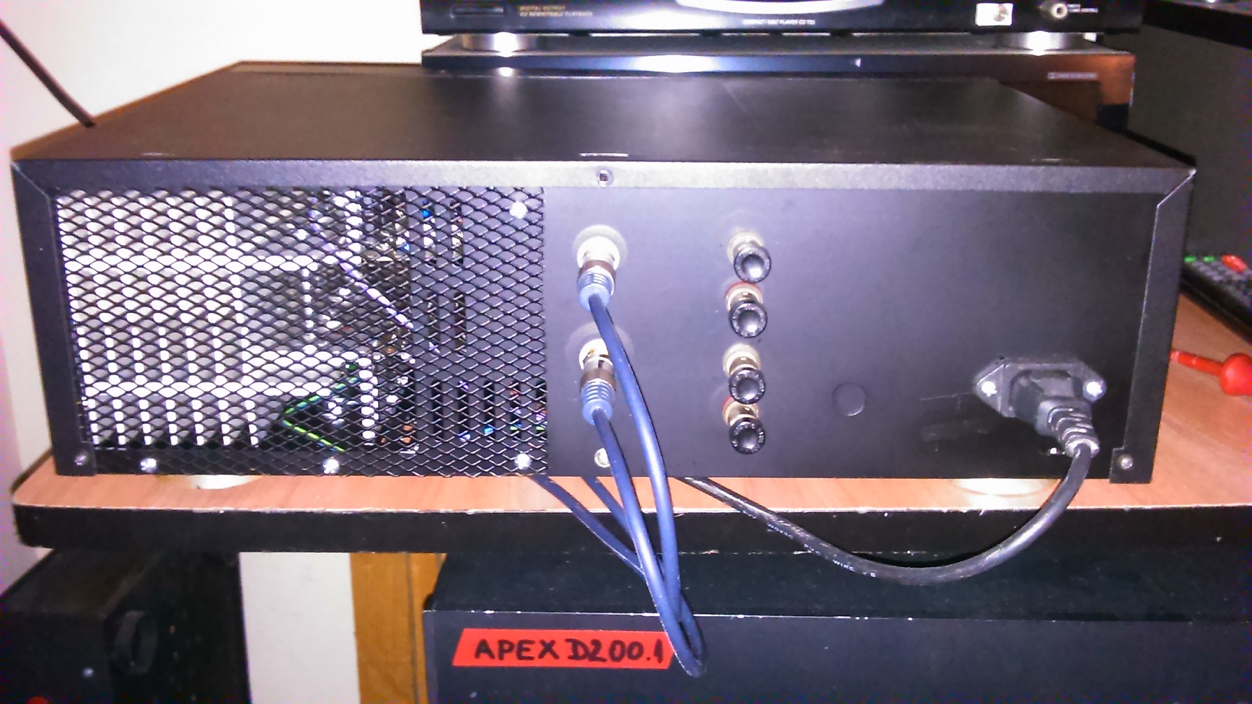

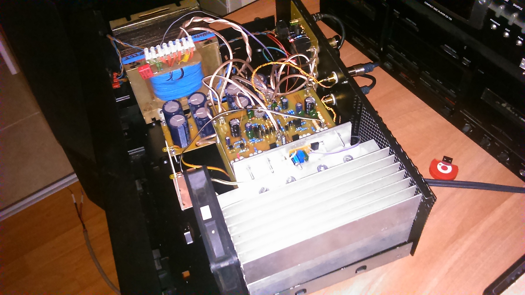

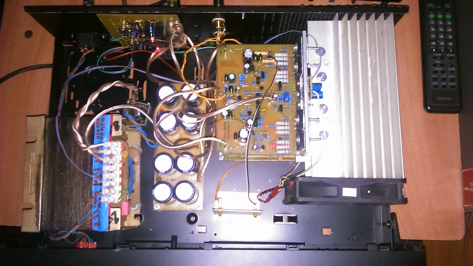

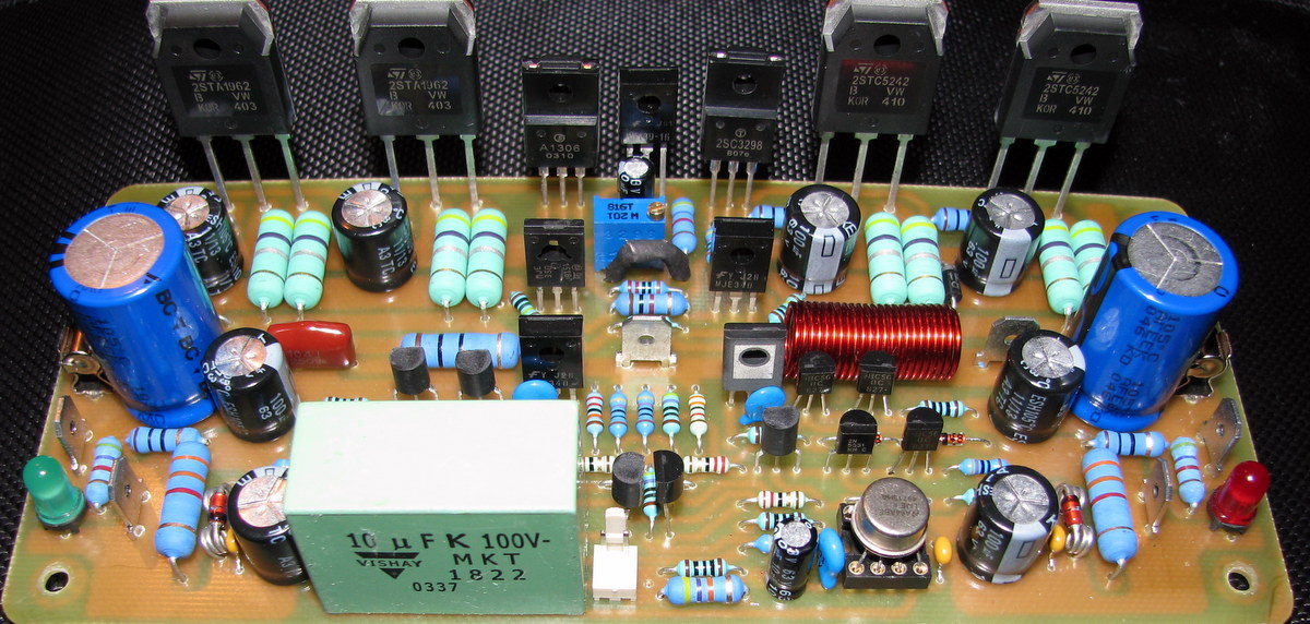

both versions work,one was done by me (with dual op-amp) and the other one by Djera (with single op-amp).
the latest files were only a little bit differente than Djera´s and my and all the difference is in a way of connecting GND from power supply to an amplifier PCB.
my and Djera´s pcb´s (first versions) have only main GND wire that goes from amp-pcb to a ground star of PSU,and newer pcb has PGND that should go with thicker wire to a PSU star GND,and two SGND that can be connected with not so thick wire,again to a star ground of PSU.
both versions should work fine,i just finished dual op-amp version,painted inclosure and wired completly:

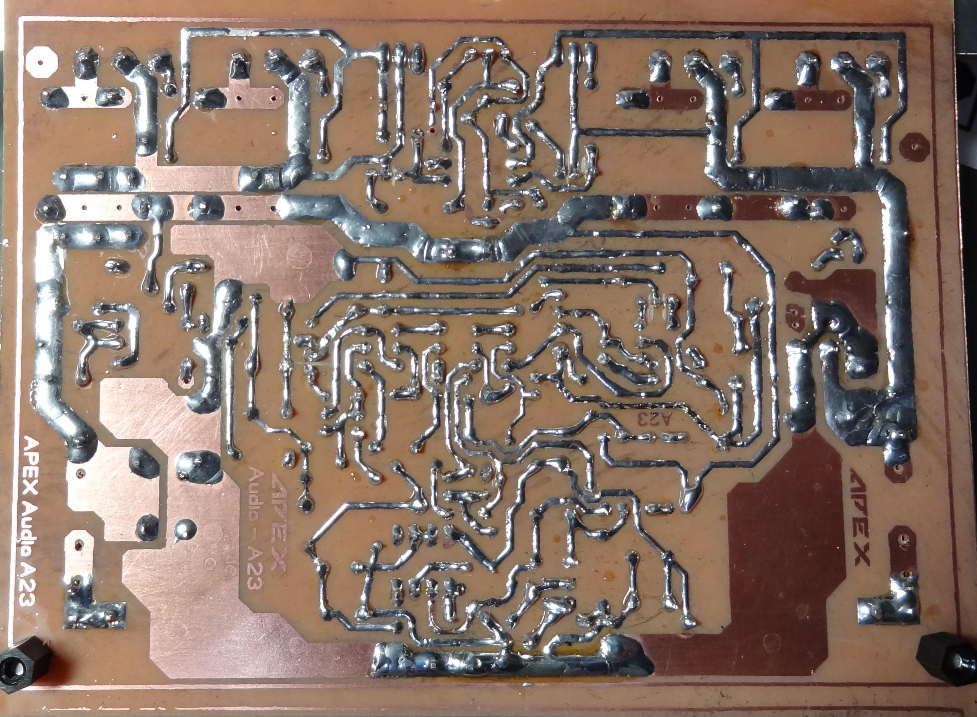

PCB correction
Sorry ,found another error ,I hope the last one 🙁 It's corrected ......🙂
So new files attached .... Files like : bottom and silk screen printed on transparent film foil can be used in photographic method as well if mirrored.
Regards Alex

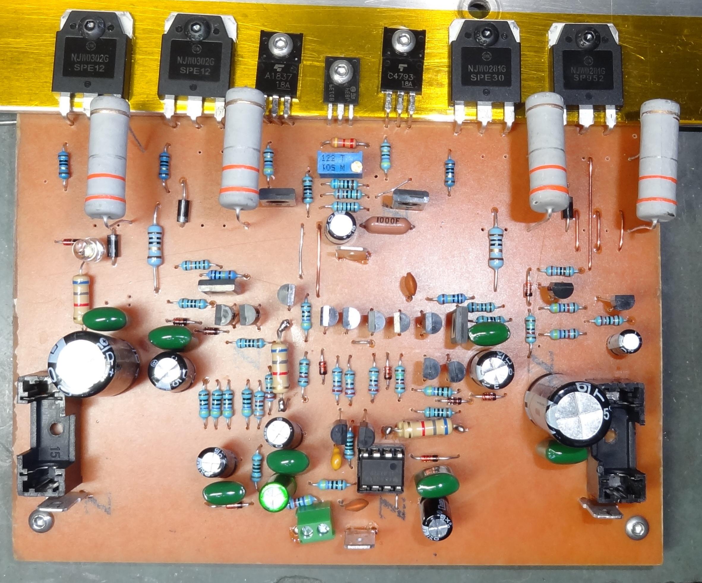

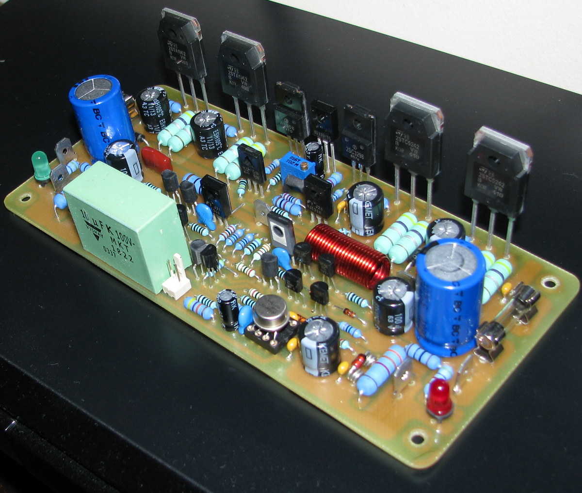

Here are some pics of one of my boards. Please look to see if you can find any errors. The board will not power up properly. I installed a 500R trimmer since the schematic shows 220R in that position. I didn't have 2W 1R so I installed 5W 0R33 emitters and I used two 1W 6K8 resistors in paralell for the 2W 3k3 resistors.
Thanks, Terry

changes you made are not a reason for problems you have. what op-amp do you use? re-check if there is any unwanted connections and if all the transistors are on their places,tourned as they should be. what to92 transistors do you use?
I will have to go back and read though again. I used screenprint from post 3576. I see now that there are new versions. I used TL072. All TO92 are what are called out in the screen print. Without a matching schematic, trouble shooting is very difficult.
Thanks, Terry
