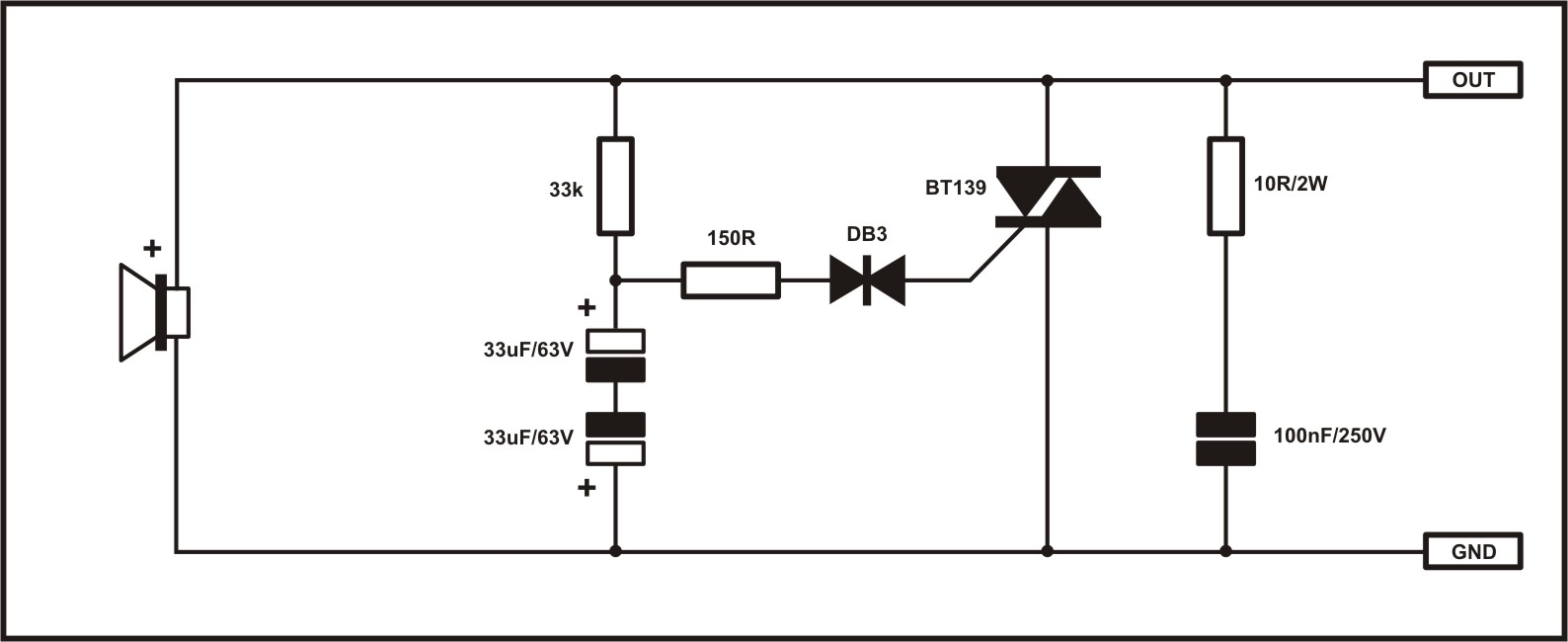

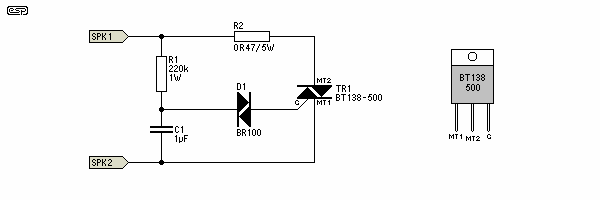

apex,
where are you sir?
please post triac protection pcb,
i saw it in another thread before,
i cant find it now,
Speaker Terminal
thanks guys... how about MJE340/MJE350... any replacement?
Co0LET
2SA1478/2SC3788 can be use instead MJE340/MJE350,
Regards
