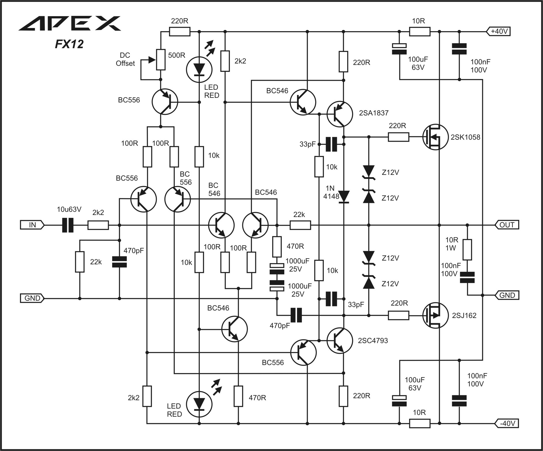

In FX12 is there an advantage to use BC546/556 over KSC1845/KAS992 i have both brand....
In most situations, you can improve a design by substituting inferior parts with better parts (e.g. lower noise) BUT the rule is that when people design an amplifier, the "surroundings", the details of the circuit, is made to support the operation of the chosen transistors...
If the amp has been designed with superior transistors, problem may arise when you substitute with lesser transistors. You may end up with adding compensation caps everywhere... (and this FX12 topology is not "simple")

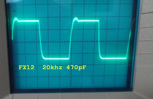

Add 10pF and 33pF for more compensations.
Hi Mile,

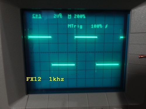

The addition of the two 33p seems to have eliminated the oscillation however the 10p cap made it worse. It plays fine now but I see a little overshoot on the square waves.
what do i have to do to fh9 if im going to use 20v+/- supply with it instead of 35? the reason being that i have 25v psu caps readily available and my speakers are high efficiency.
40v caps are cheap. You will be much happier with the sound with the higher voltage PSU vs 20v. I have tried 20v supplies before and it's just not as good. There is probably a way to do it by lowering the resistors that limit current into the CCS LTP and VAS stages but I think changing all those resistors is more complicated than buying some 35/40/50v caps.

I always prefer lower v sounds more. All the amps ive tweaked to lower v always sounds darker/warmer, im guessing due less excited components from lower voltage? Perhaps less thermal noise? Would love an explanation on this.
And also the loss of headroom can be compensated by more cap values which have now become cheaper with the lower rating. And with high eff speakers 30,40watts is still plenty. Also smaller heatsink, less footprint... too much is in favor of lower voltage for me.
