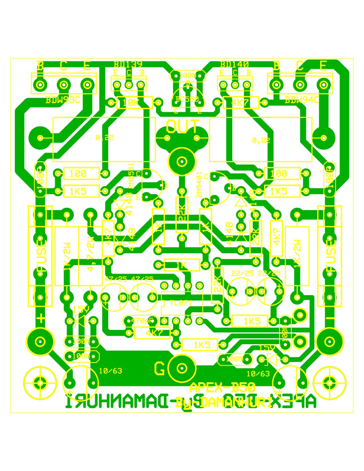

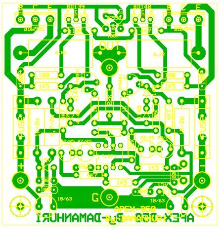

Is it like this?Zeners must be connect to 1k/2W not to rails...
Is it like this?
Yes, I suggest to change position of bias transistor BC550 with 100nF cap, BC550 must be on heatsink with outputs in thermal connect.
Regards
as instructed Mr. Mile, I had my fix for the perfection of designYes, I suggest to change position of bias transistor BC550 with 100nF cap, BC550 must be on heatsink with outputs in thermal connect.
Regards
BDW93C and BDW94C are in TO220 case...
Overload detect is add on AX16, and send +HV on PRO out...
thank you...
Overload detect is add on AX16, and send +HV on PRO out. This voltage can activate DC protect (like in HV350 PSU7), and disconect speakers if overload detect.
okay thanks mr.mile.
