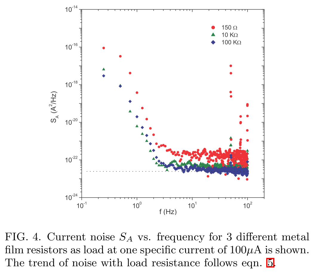

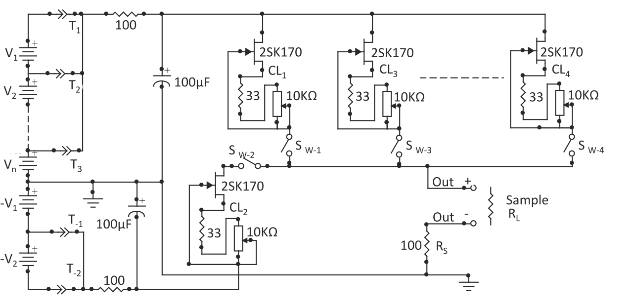

Thanks for pointing that out Jay - it looks similar indeed with Borys using an extra 4 actives to get the CCS for each rail and he has a MOSFET for the temperature compensator. I was frankly surprised at how well this thing models with a basic resistor for a current source. I guess I could get fancy and maybe try the 2SK170 CCS pointed out in the new Jason K CCS thread. Those have measured noise in the the 10E-22 amps^2/sqrt(Hz) current noise for a 100uA CCS current.
Although 1st cut would be to just build the very easy to make 7 active parts version. So simple, point-to-point could probably work well.
