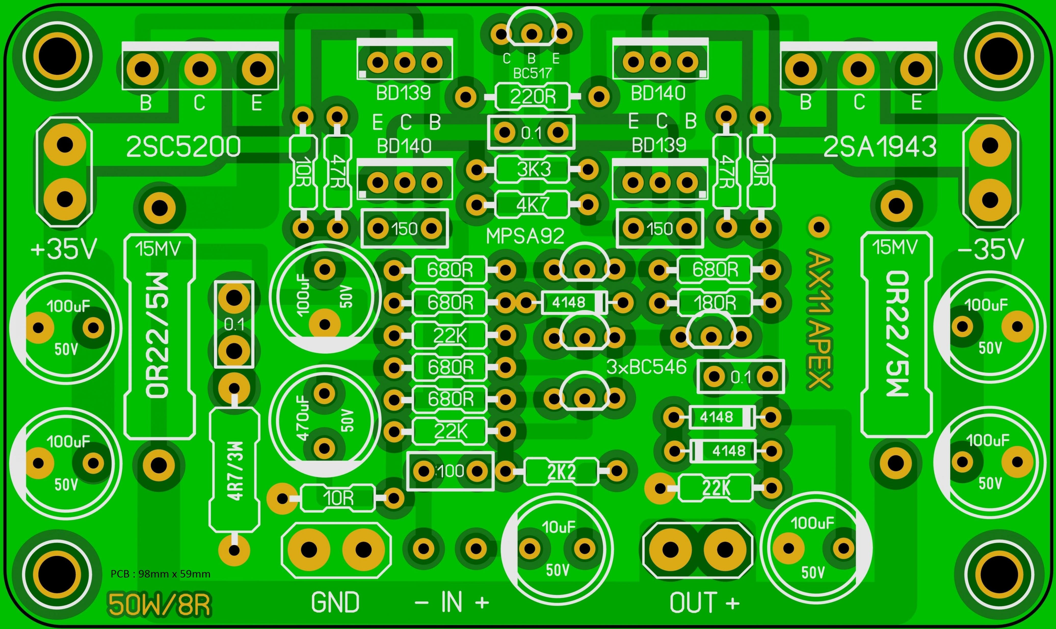

I've never built an Apex power amp so looking through this thread the A9 and AX11 seem to be popular so I decided to send (very soon) the Gerbers to the PCB manuf. so I can have my own.
These PCB layouts were donated freely. (see attached Layout from Sonal Kunal and Thiagomogi, thanks guys)
I just realized that my power transformer are about +/-39Vac, 300Va, I've got 4 of them and I'd like to use them of course. This 78Vct translate to about +/-53Vdc so too high for the normal A9 and AX11. Can I use these nice PCB layout and change a few components to make them work at +/-53Vdc ?
If so, what should be changed ??
If not, my solution would be to make a bipolar buffered zener regulator a la Zen Part 3 from NP.

You can use regulated PSU from thread http://www.diyaudio.com/forums/solid-state/173462-studio-reference-amplifier-2.html

I made simulation of AX11 topology using +-90VDC. It tested my my friend, he claimed it have good sound quality. If you interested, I can make AX11 simulation using +/-53VDC.

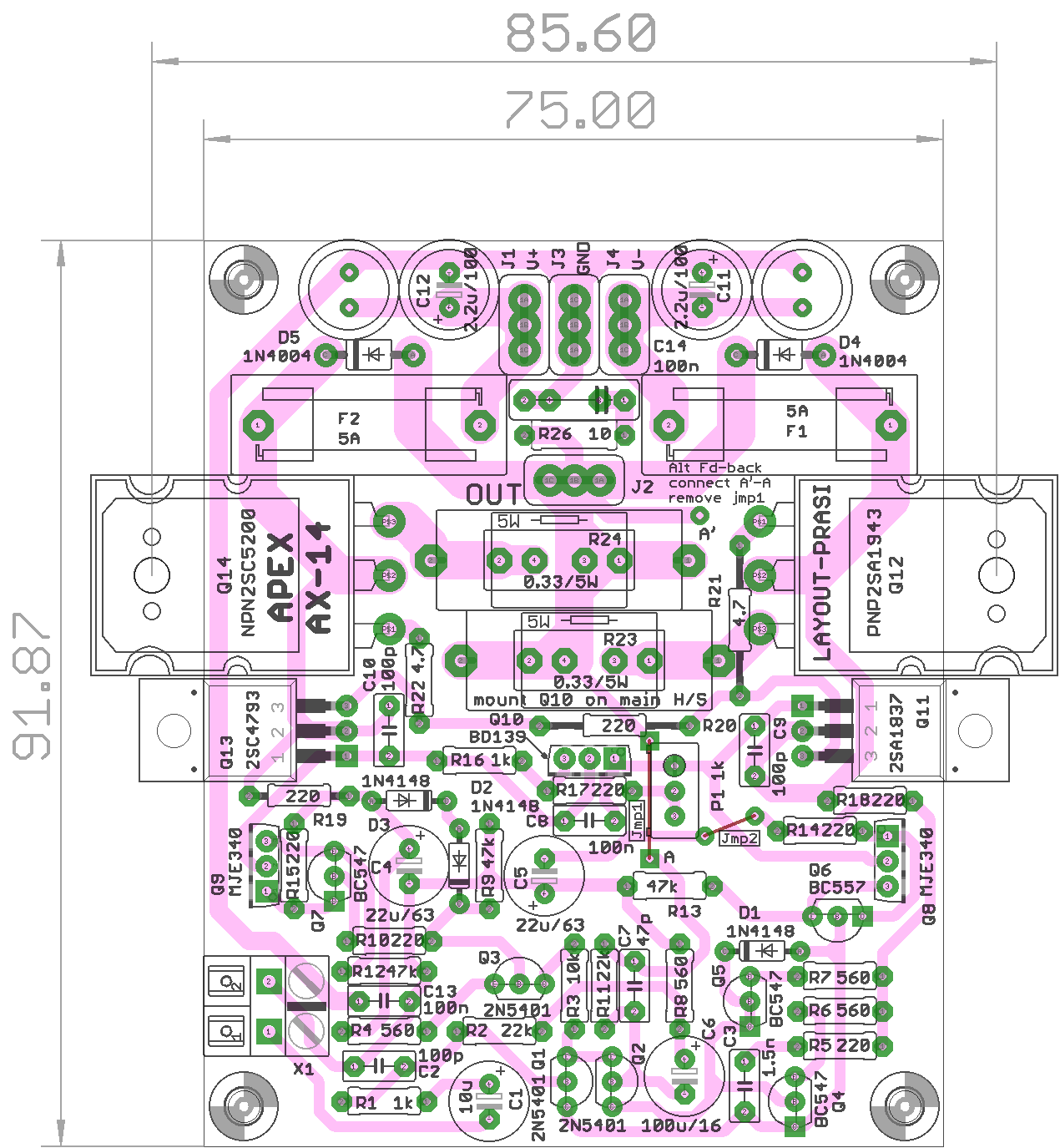

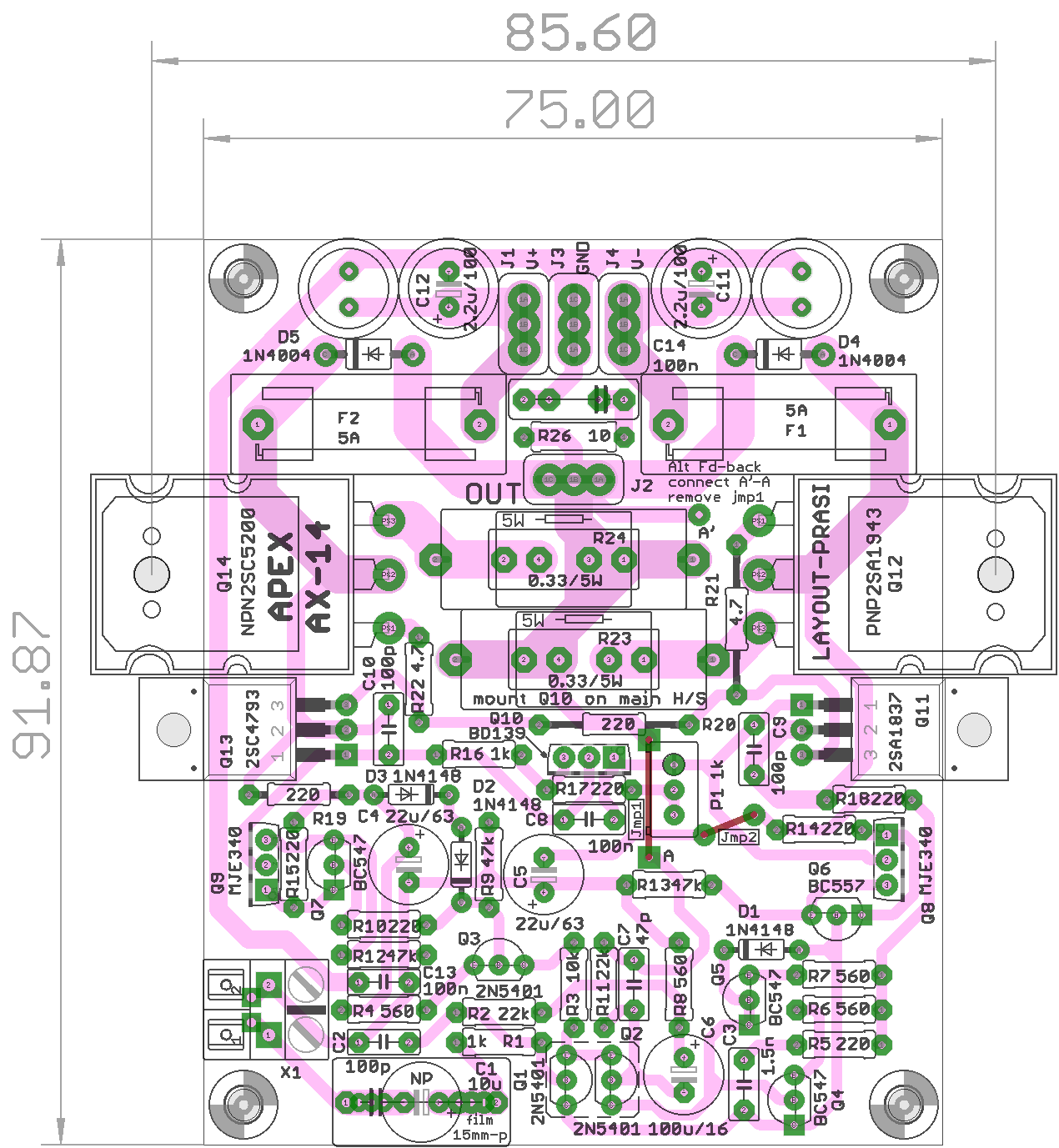

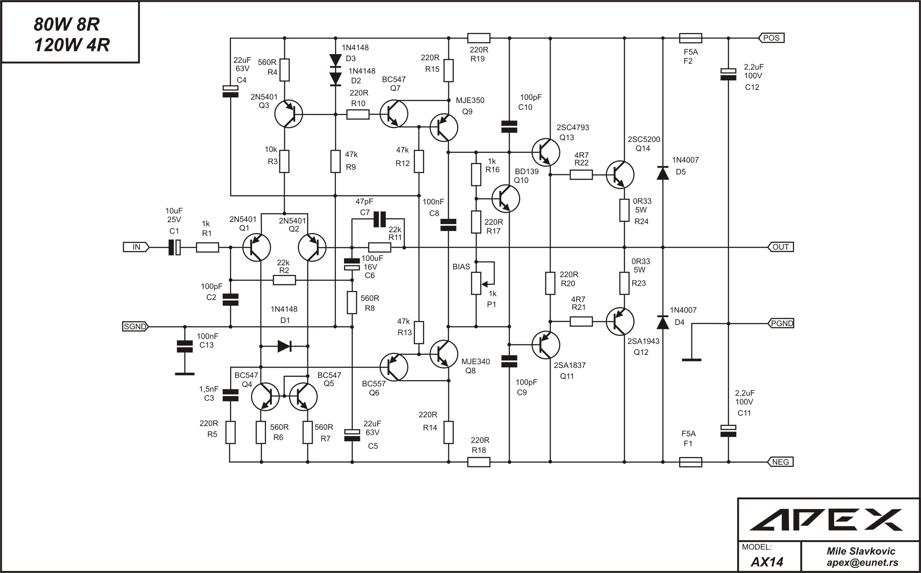

I had never made a layout for the "100W ultimate fidelity Amplifier-AX-14", there are many many interesting designs by various guys + Mr. Mile's compact layout.
Anyway here it is, similar to the FR-100 layout I did and is based on the attached schematic early on in this thread. Its compatible to adding more pairs easily by minor modifications, only in o/p stage of the layout.
Hi Bimo,
That would be very nice of you
Will I be able to use the attached Layout ? (I already have the Gerber)
Thank you,
Eric
Hi Bimo,
Thank you,
Eric
You have must be make the layout yourself. Because, it is slightly different than AX11 which originally using 35VDC. It is more like my modification of AX11 that built by someone here. For using +-53VDC, I will make the modification as simple as possible, but still have good specification.

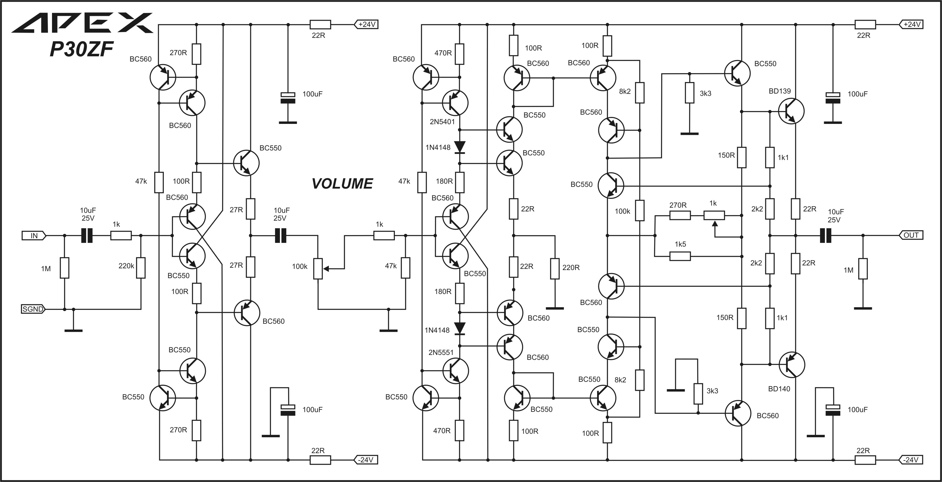

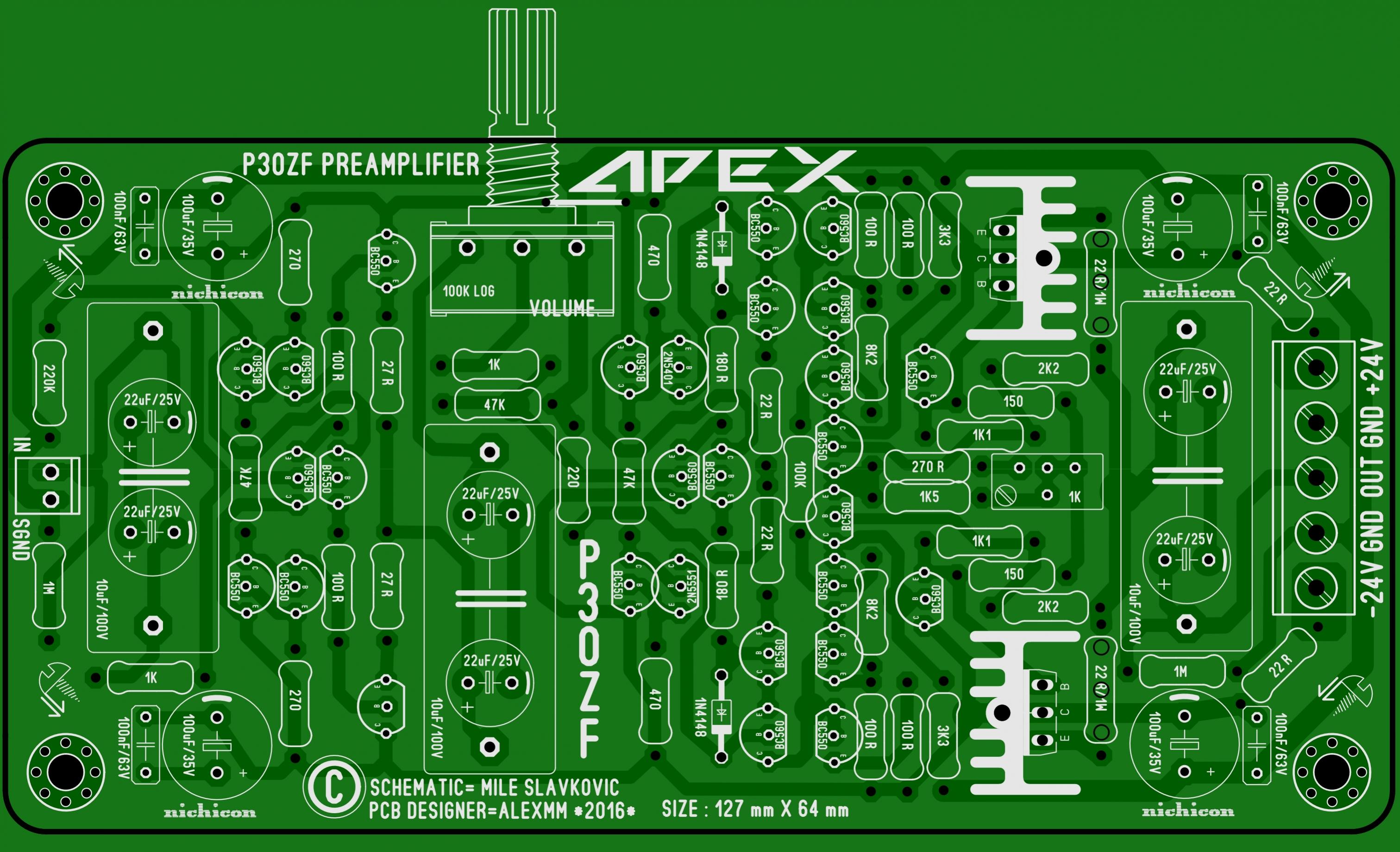

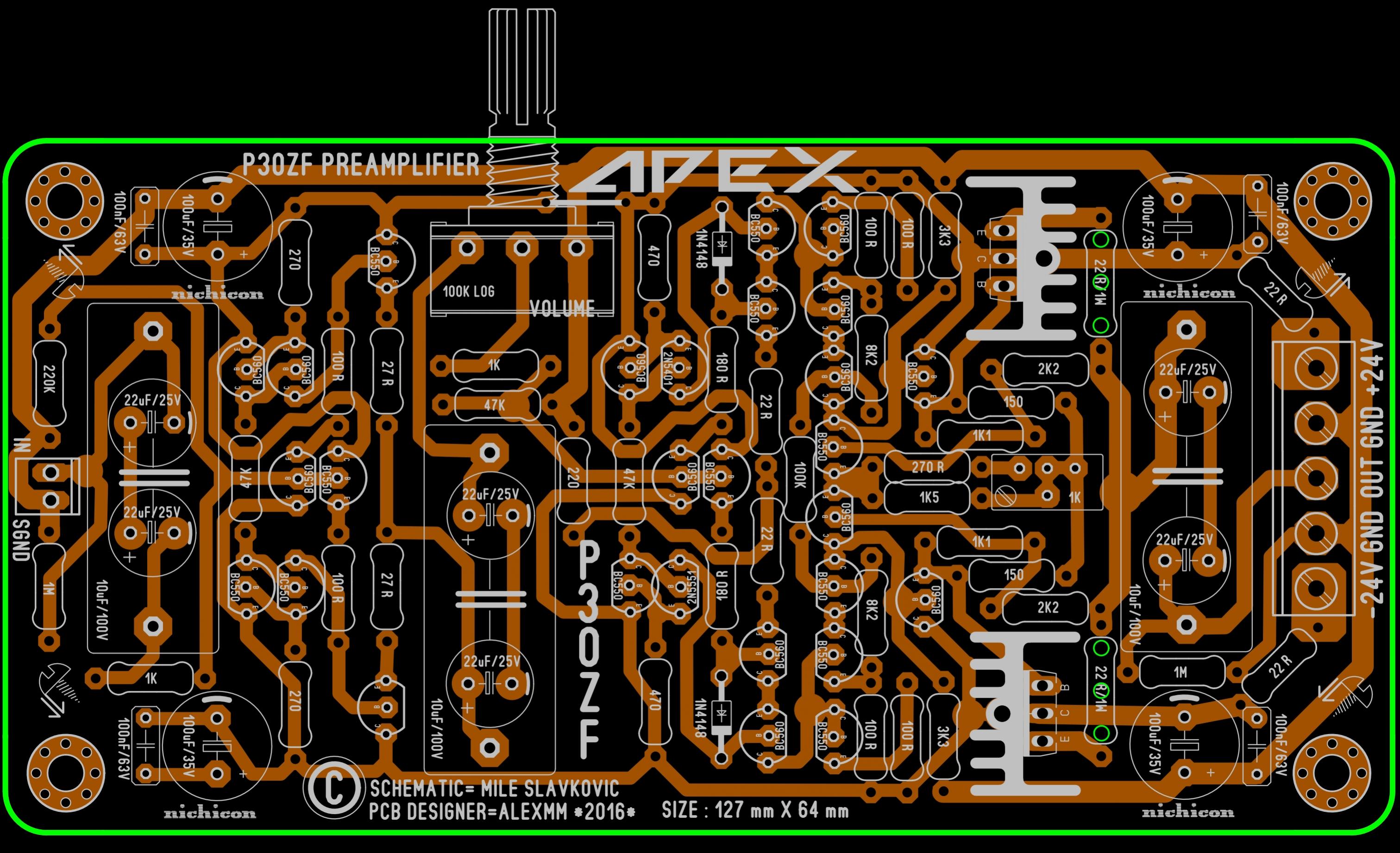

the master is back with a bang!.. wow!P30ZF preamplifier PCB layout ,not tested .....
Regards,Alex
Yep, where prasi could very well be the master of Eagle around here, I think Alex could very well be the Sprint master.
Regards,Alex
Hey Alex,
Very cool! A new circuit to build.

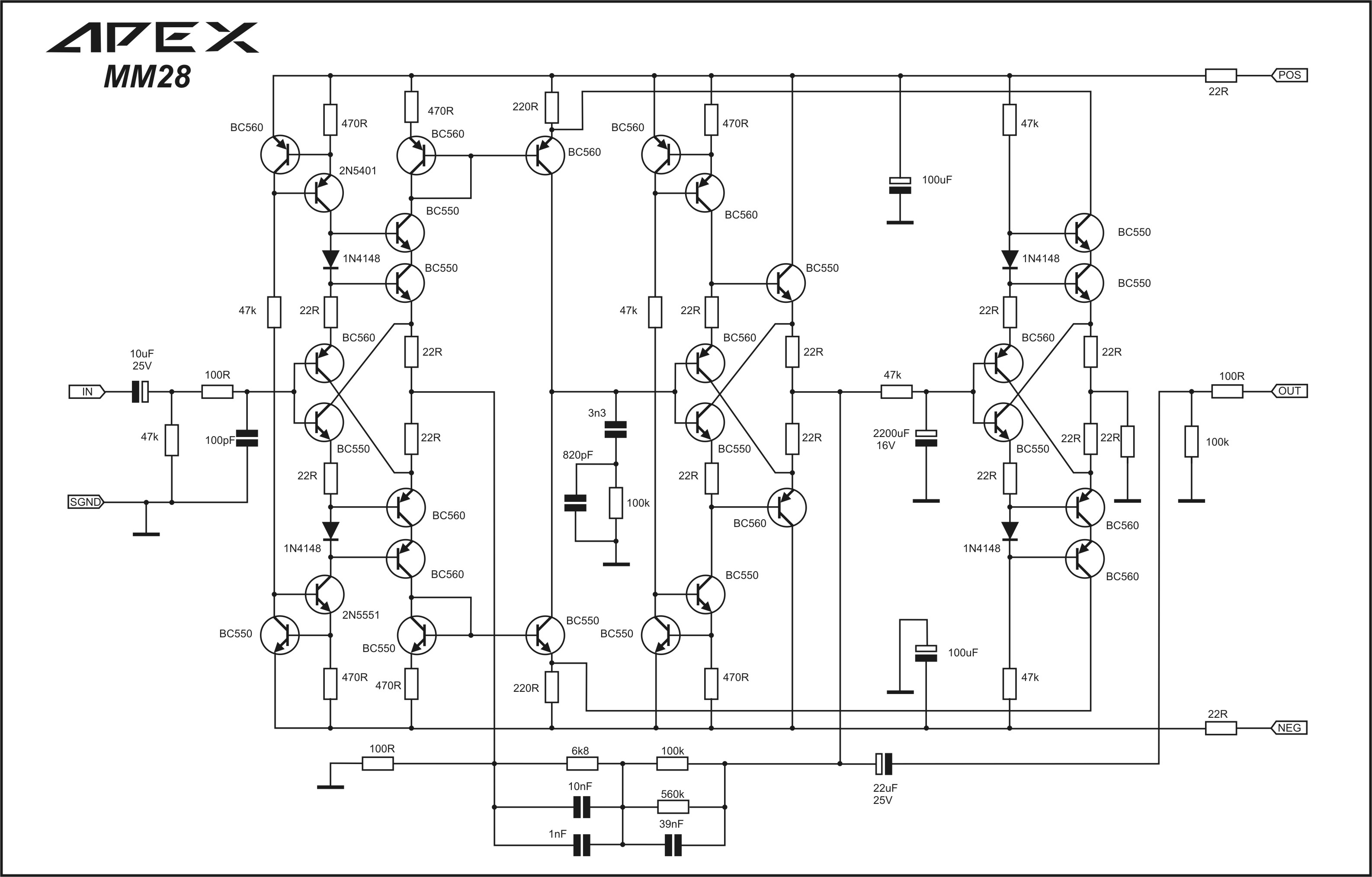

I am in the process of finally mounting my P30, built on your layout, into a case. I have the A class PSU built for it. The only thing I'm lacking is the MM28 phono circuit. If you get to feeling ambitious would you give a stab at a layout for it? I would love to have the complete setup. Here's the schematic.
Thanks, Terry
