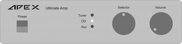

Hey Guys,
I finished the P30.
P30, MM3, TB3, Shunt Regs and A Class PSU.
I added a volume control/channel switcher with remote. Pretty cool setup.

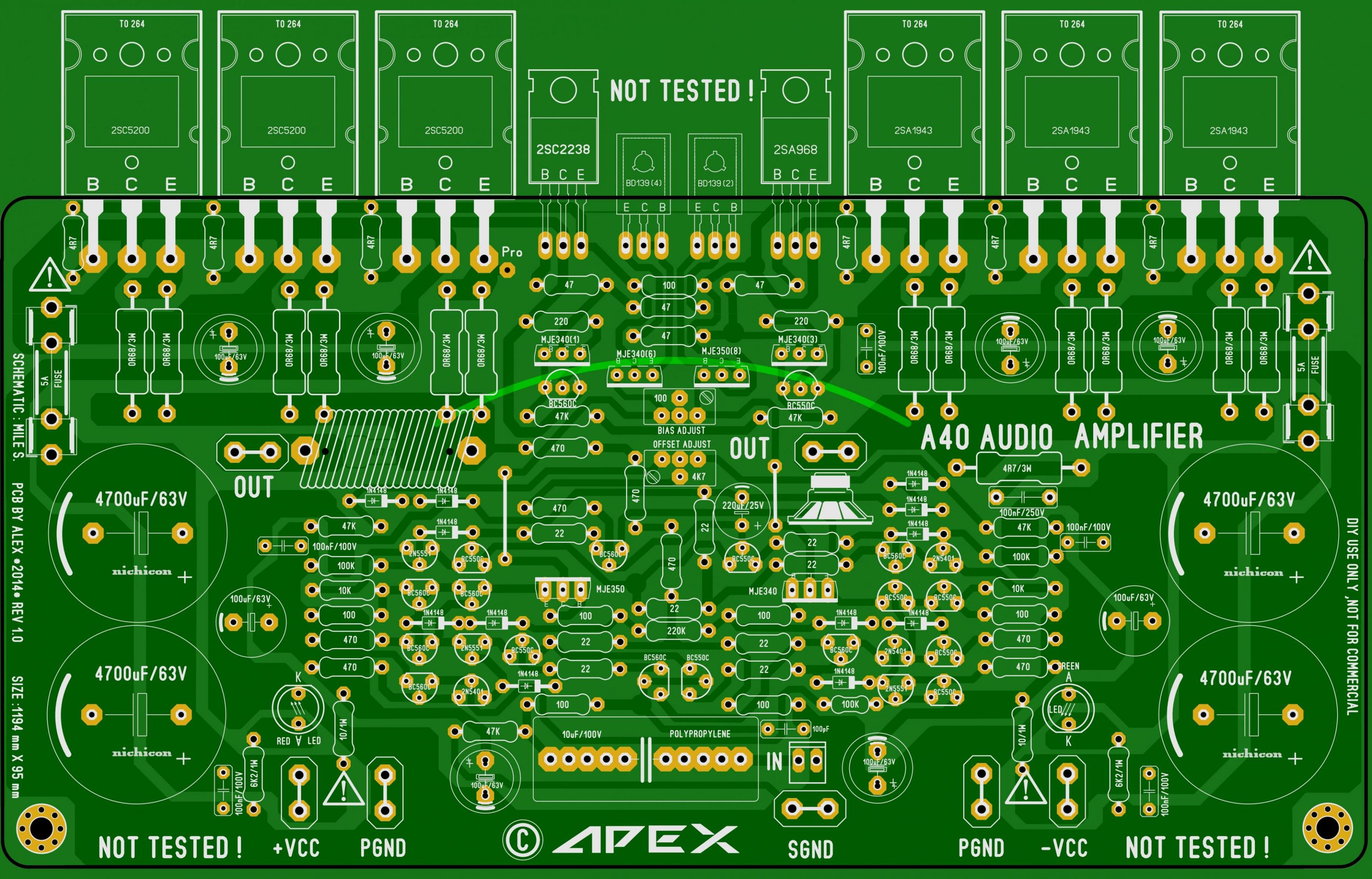

I have a nice chassis and PSU parts that I would like to use (if possible) to build an A40.
The 1200va toroids I have are 60-0-60, which gives me ~80v DC rails after rectification and CLCRC filtering. Is there anyway to use this to power an A40?

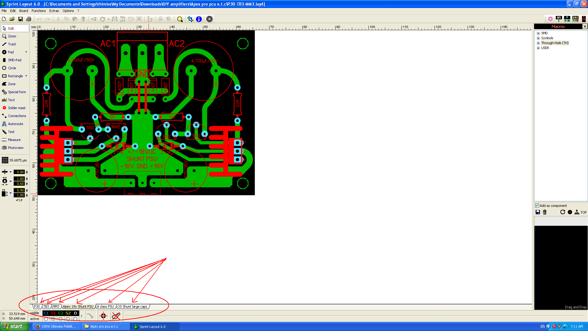

Hi Donovan,
I believe +-80V is too high for the A40. Yo may need to look at one of Mile's class H amps. I'm not sure if the A40 could be modified to handle more output transistors. That might be a possibility. My A40 uses 63V caps so +-60V is about all I can go. Even that will be working hard with a 4 ohm load. Mile did design a PSU that is adjustable so that also might be a solution.
The P30 layout is from Alex. The others are from Mile and I just copied them in Sprint. I'm attaching the Sprint file with all of the circuits I used.
Hope this helps.
I alredy save this file,but after extracted i only see PSU file no another file.
What's the problem sir?
Did you look at the tabs at the bottom?
You need Sprint Layout software ,then look on the bottom left.Switch between all.I alredy save this file,but after extracted i only see PSU file no another file.
Thanks Terry.

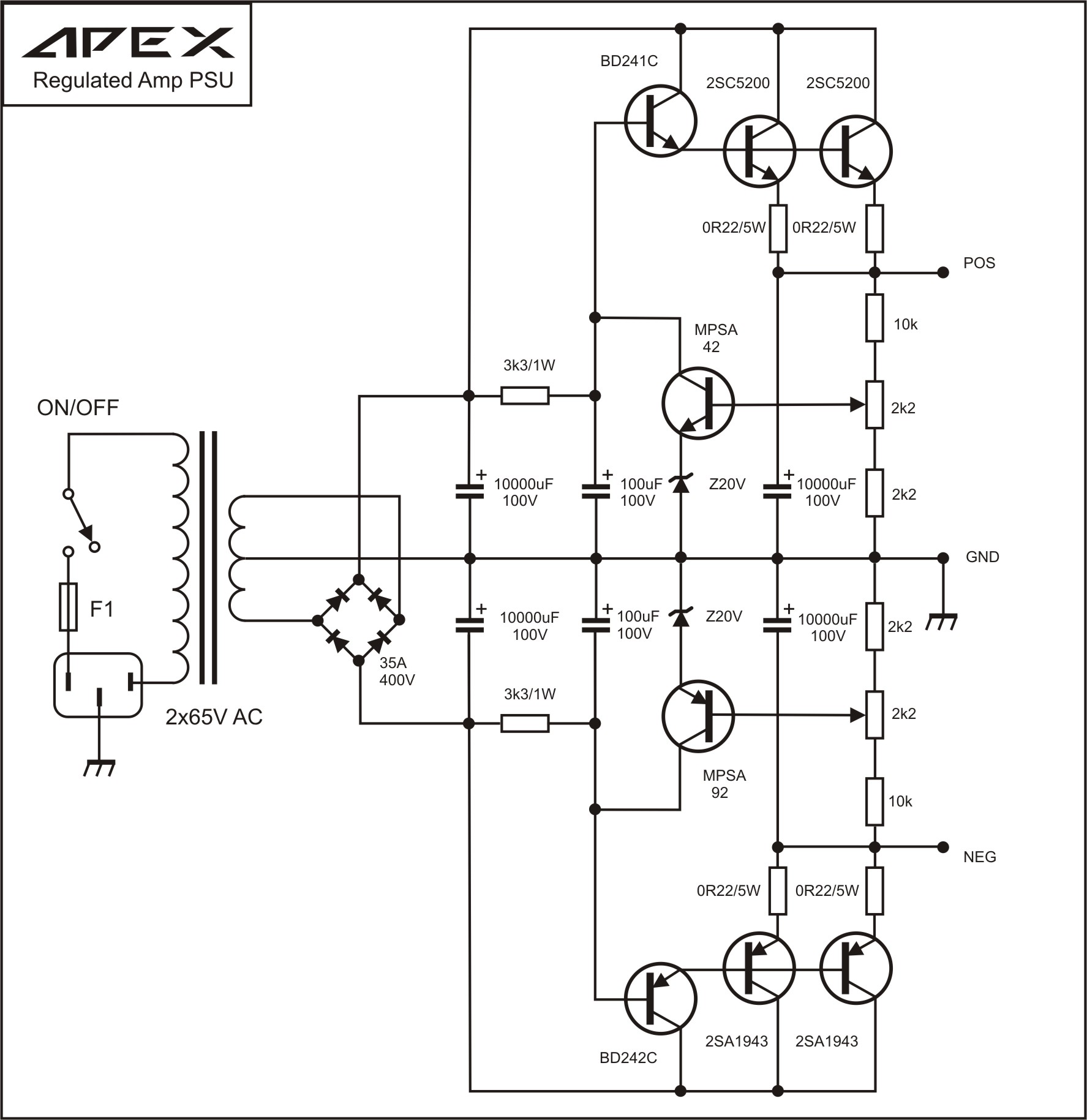

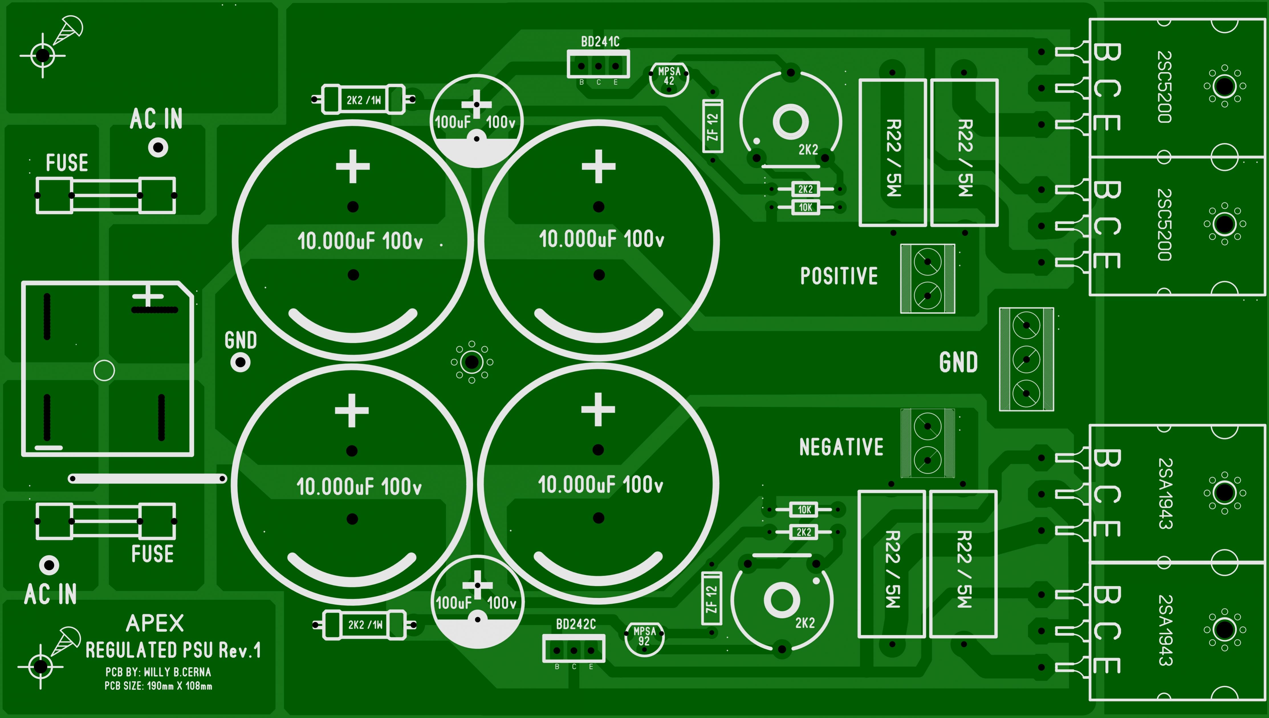

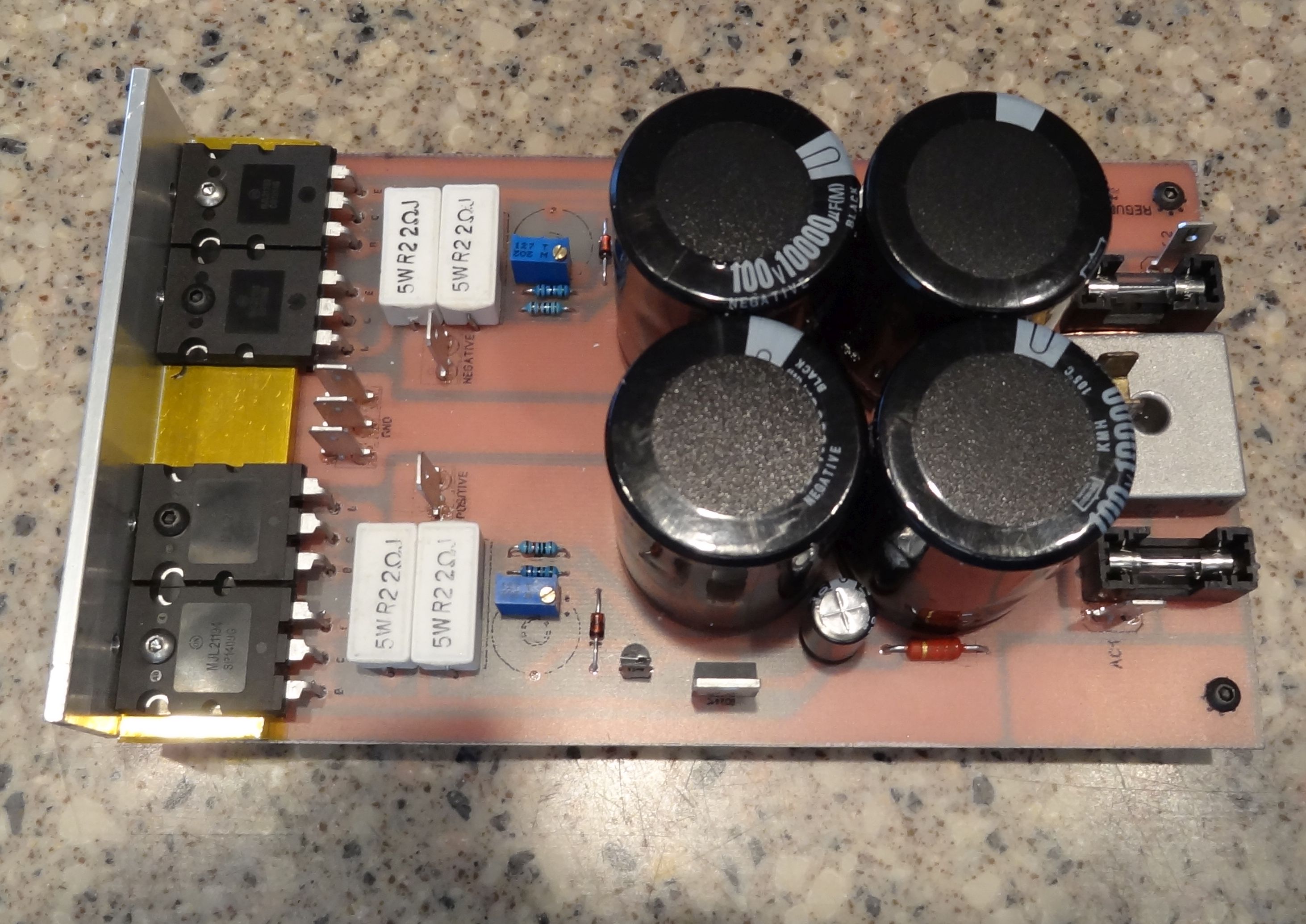

Use Regulated PSU for Amps with 4 pairs of outputs, output voltage can be set from +/-55V to +/-90V.
Regards
Hi Mile,can you post pcb for home make?Use Regulated PSU for Amps with 4 pairs of outputs, output voltage can be set from +/-55V to +/-90V.
Regards
You can find all files in thread: http://www.diyaudio.com/forums/solid-state/173462-studio-reference-amplifier.html
Ok still4given,thimios, i will see again on the sprint layout7.

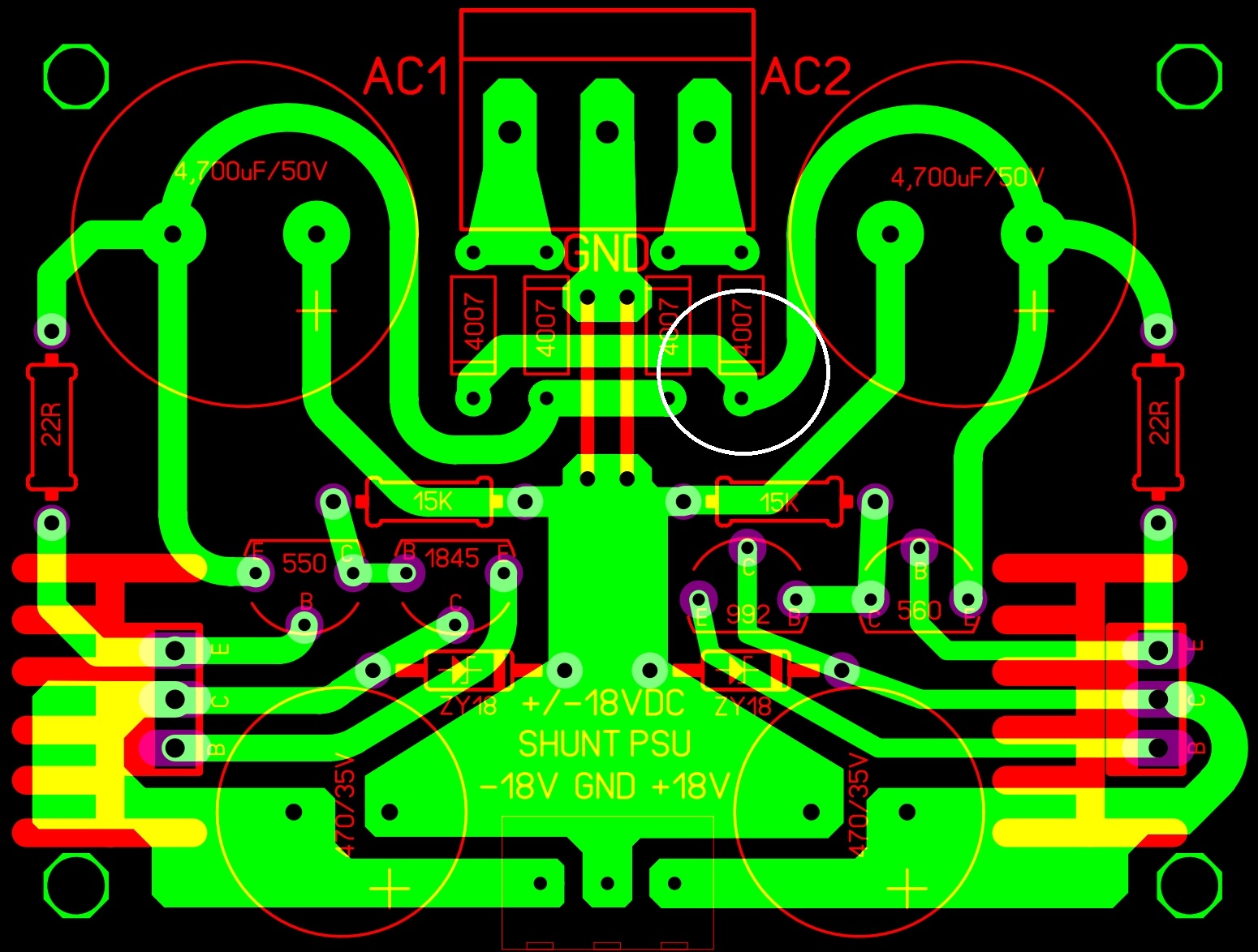

Hi Guys,
The sprint file I posted had an error in the 18V shunt. I have corrected it and am sharing the corrected file below. If you want you can just correct it in you file or download the new zip file.
Thanks, Terry
Thanks, Terry
