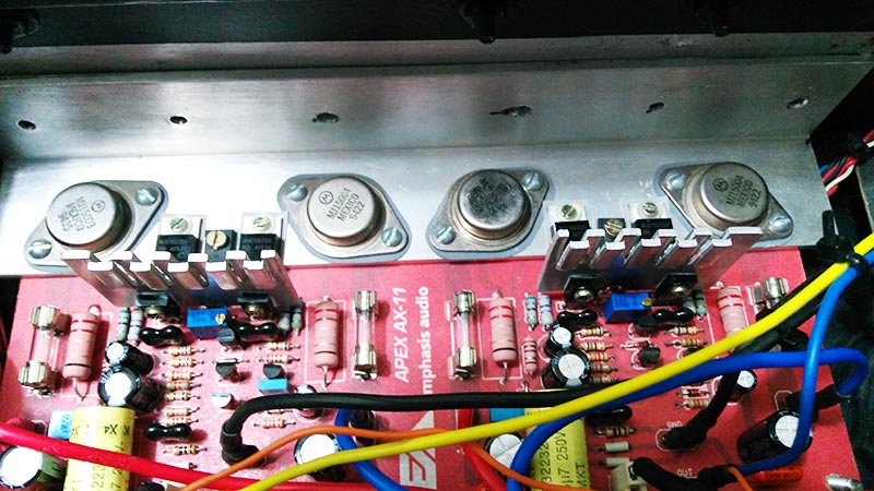

I'm having a little problem with the AX-11. The amp works well, good sound, the outputs transistors (MJ15003/15004) and drivers (MJE15032/15033) are only warm, but the pre-drivers (MJE340/350) get very very hot. The bias sensor are a BD679. Supply with 38+38 VDC and bias set at 50mA (I replace the 4k7 resistor with a 5k pot). Any idea what it might be?

The BD679 is darlington transistor and I'm not sure i fit.
Yes, it's darlington, but here in the topic is mentioned that it works ... Would it be better to replace with a BD139?
Sir Apex will answer much better than I do.Yes, it's darlington, but here in the topic is mentioned that it works ... Would it be better to replace with a BD139?
It is ok, you must use heatsink for MJE340/350/

Thanks Apex, I will provide heatsinks for the transistors.

MJE350 and 340 are not pre-drivers and rather VAS, as Mr. Mile mentions that it is good to have heatsink.
A wise choice to improve ax11 performance is to place the transistors faster and with lower COB in the "heart" of the amplifier which is the VAS.

Thanks for the information. Can you give me examples of good VAS transistors in the brazilian market?

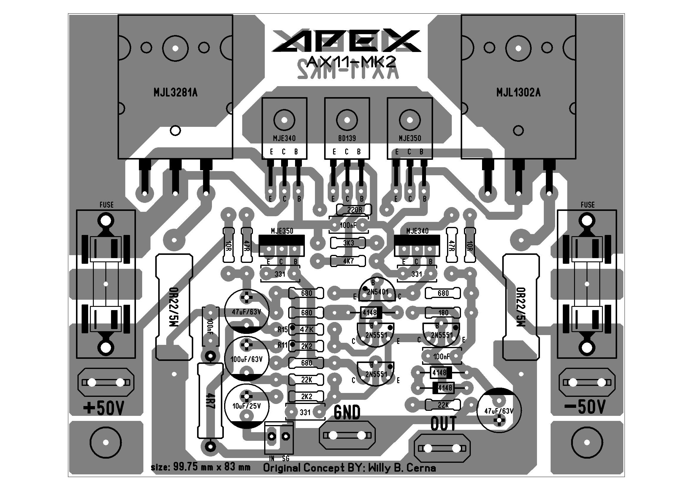

Hi
what is the probleme?
my HX-11 not work in first time
this two resistors are burn after connect supply to terminalllllllll
why?
any one have an correct and tested pcb for Hx-11?

2N5551 reverted polarity on this pcb...
I reverted 2N5551
Now the 2sc5200 and irf9540 is hot when power is on
