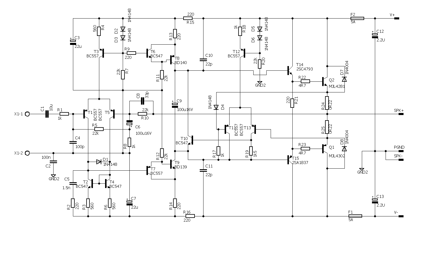

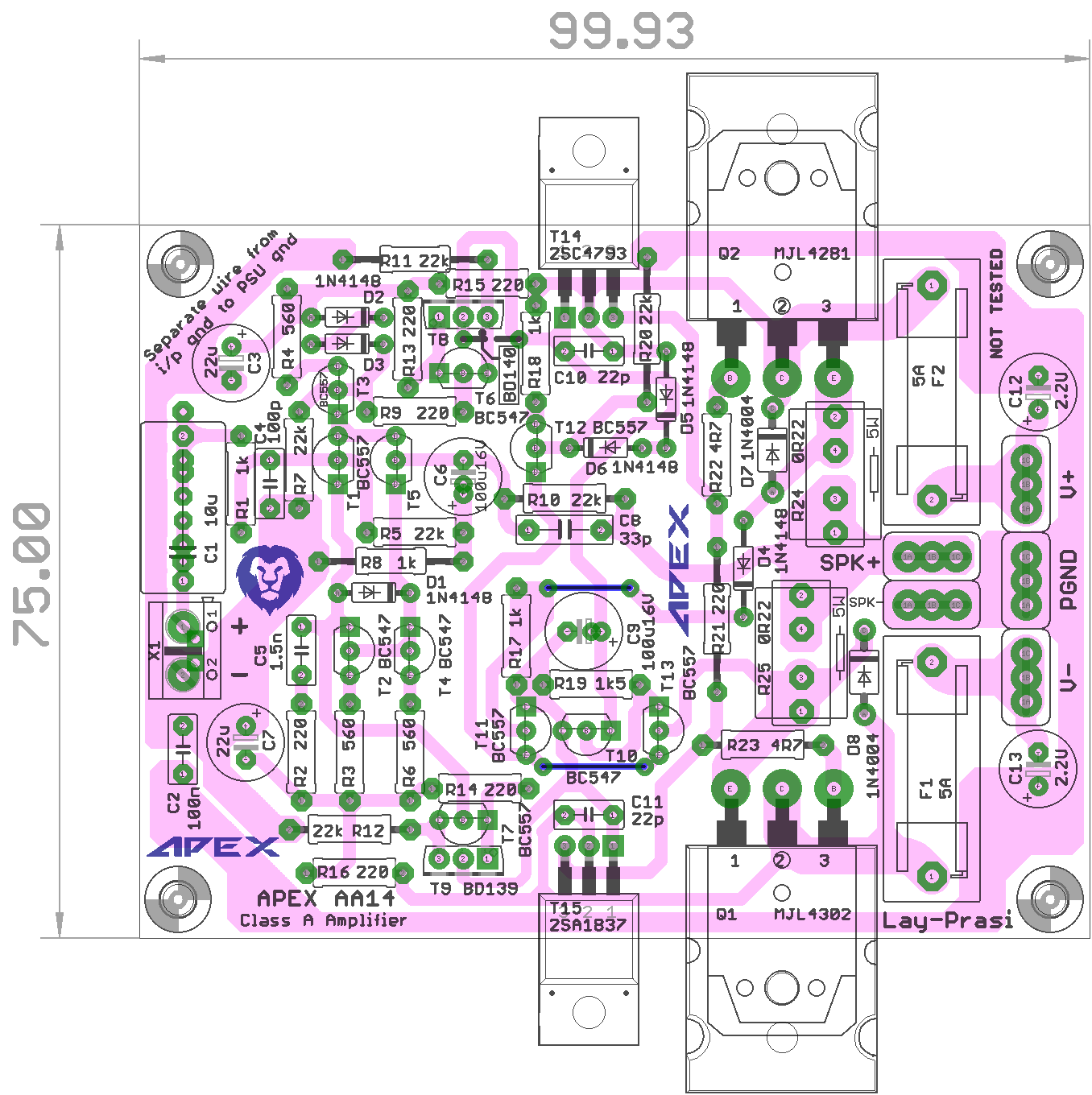

How many watts is this amp and what is suggested PSU voltag and bias current setting?
There is 1300mA auto bias circuit on AA14, can be set with change 0R22 resistors. Use +/-24V PSU for 20W.

Ok, I see it now - the current is read by the voltage drop across the two 0.22R (0.44R) with a 0.563v delta added by the 1N4148 and then the error is amplified by the LTP which then drives the T10 to control the bias to bases of outputs. Will this prevent thermal runaway reliably? 24v rails is perfect, although 20w is a little less than I would have hoped for.

Thermal runaway is posible only with Vbe multiplier bias circuit in class AB amplifier. 25W/8R is maximum expected power with +/-24V rails for any amplifier, use PSU5 regulated PSU.

I read this bias on Douglas Self book. He claim it is better than Nelson Pass bias with single transistor with feedback (like FA9).

Don't the Sziklai pairs T6/T8 and T7/T9 need to be swapped?

They are not Sziklai pairs.

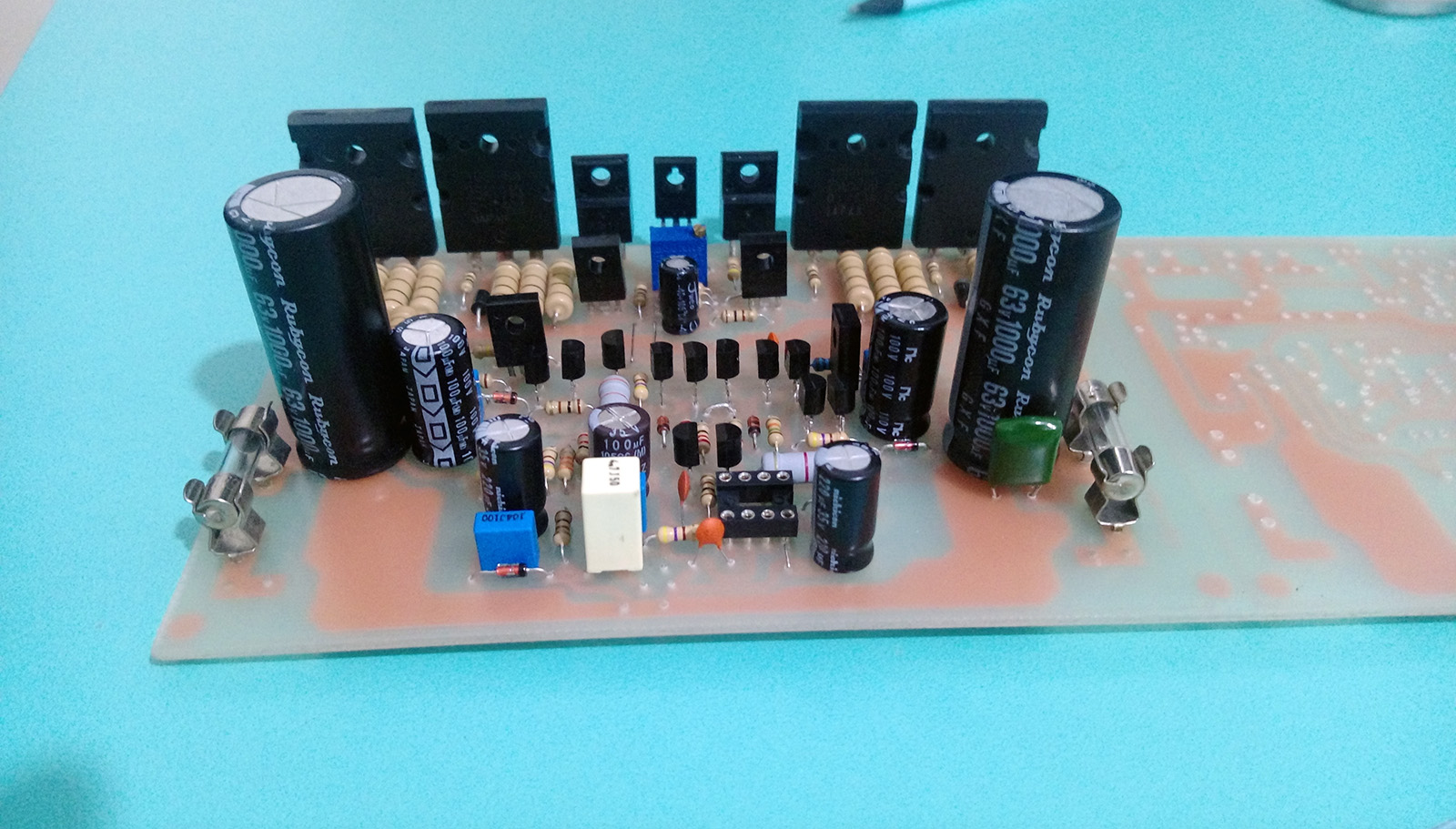

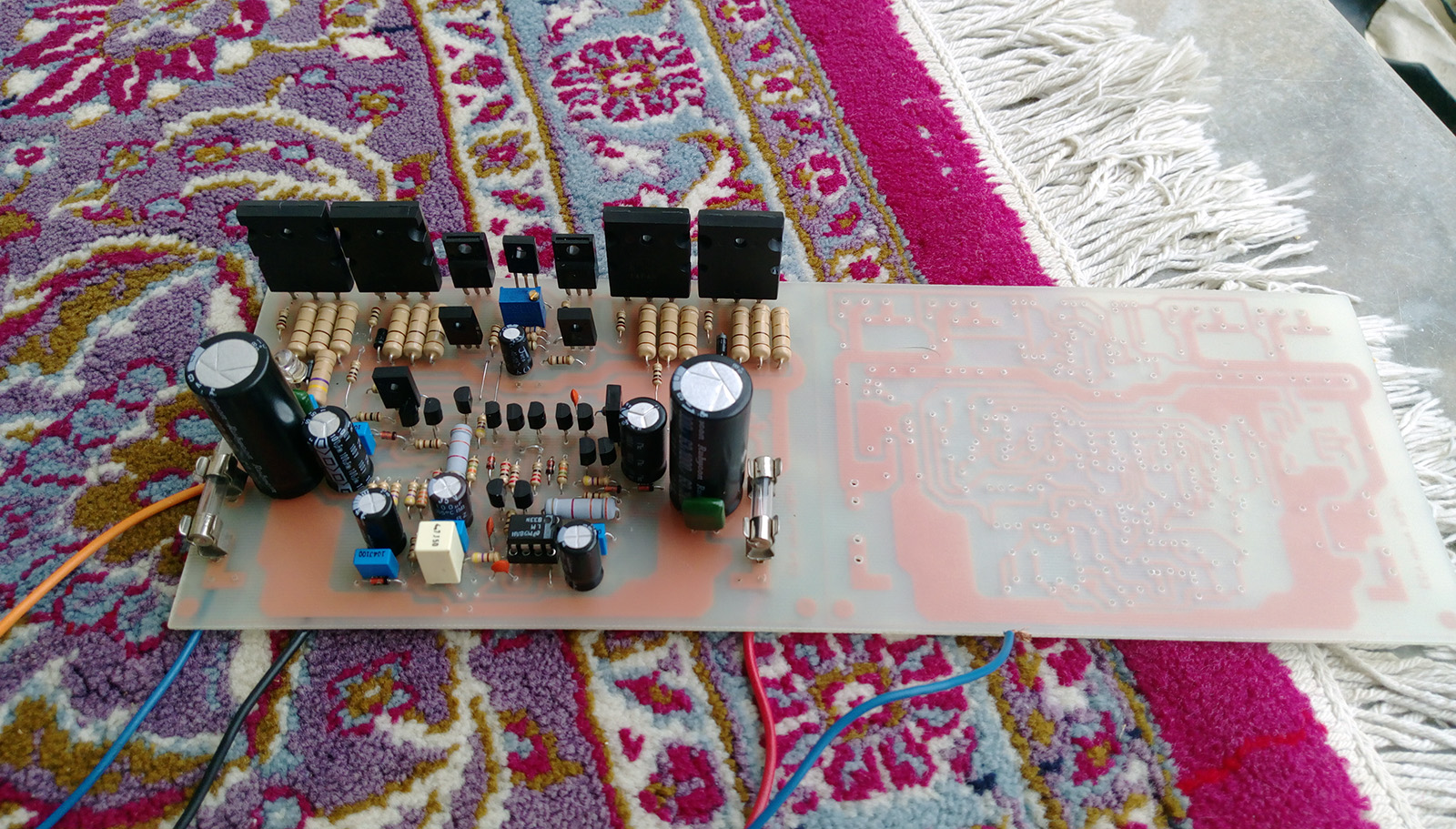

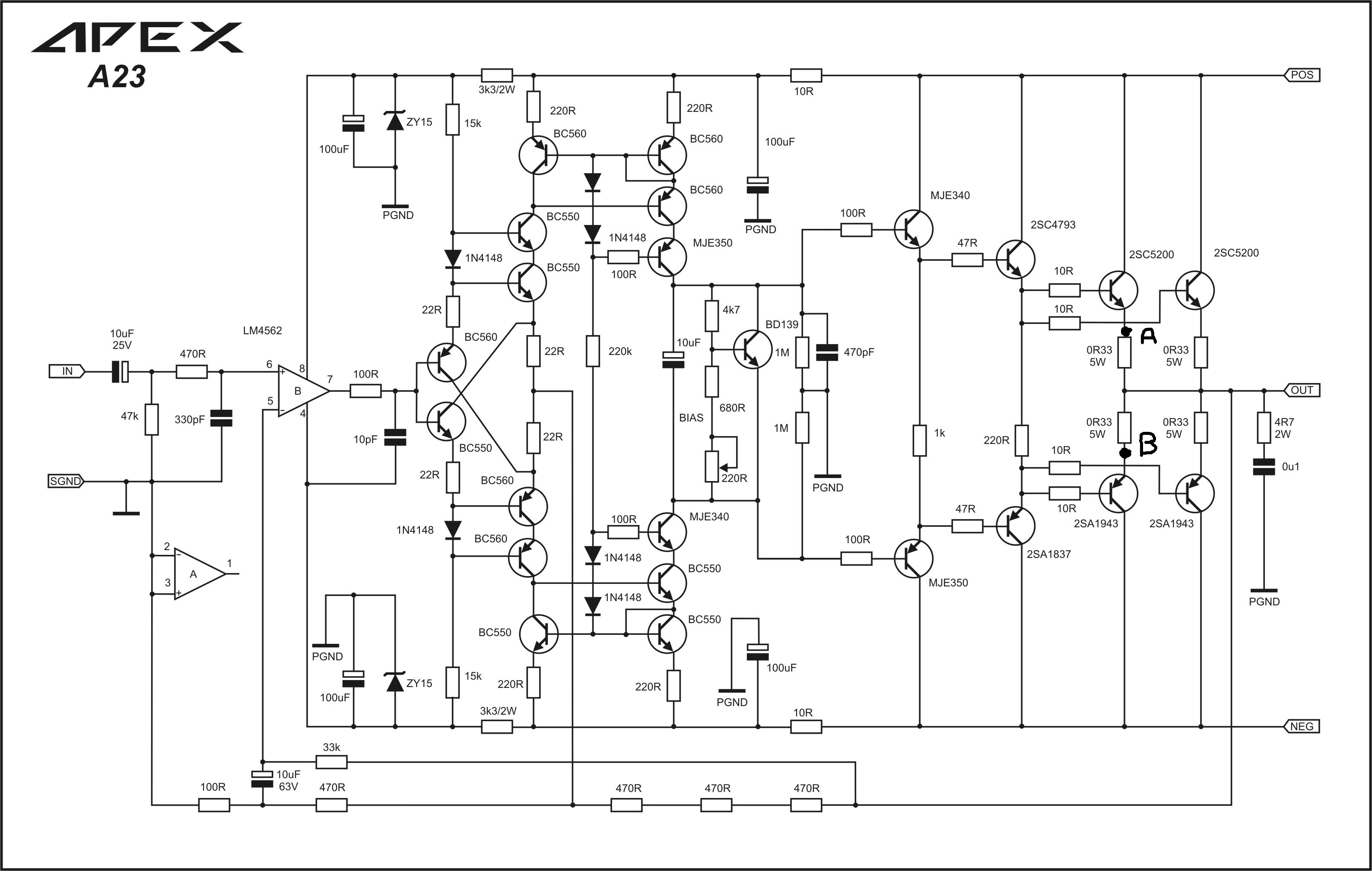

i tried to adjust bias in a23
so i put multimeter probs on point A and B in bottom pic
i adjust BIAS pot and now i have 25mv bias
is this correct?
Yes.

@Bahrad
With your measurements @ testing points TP A-B (your pic),
with emitors resistors 2x0R33 @25mV is quiet good,
this is 35-38mA per output BJT pair
try to biasing @50mV, this is 50mV/0R66=75mA per output BJT pair,
if the main heatsink maintens lower temp then 55°C.
This is the temp that you can touch the heatsink with your fingers
for more then approximately 5sec
or measure precisely with adequate temp-meter.
You will have less crossover distorsion, better THD...
