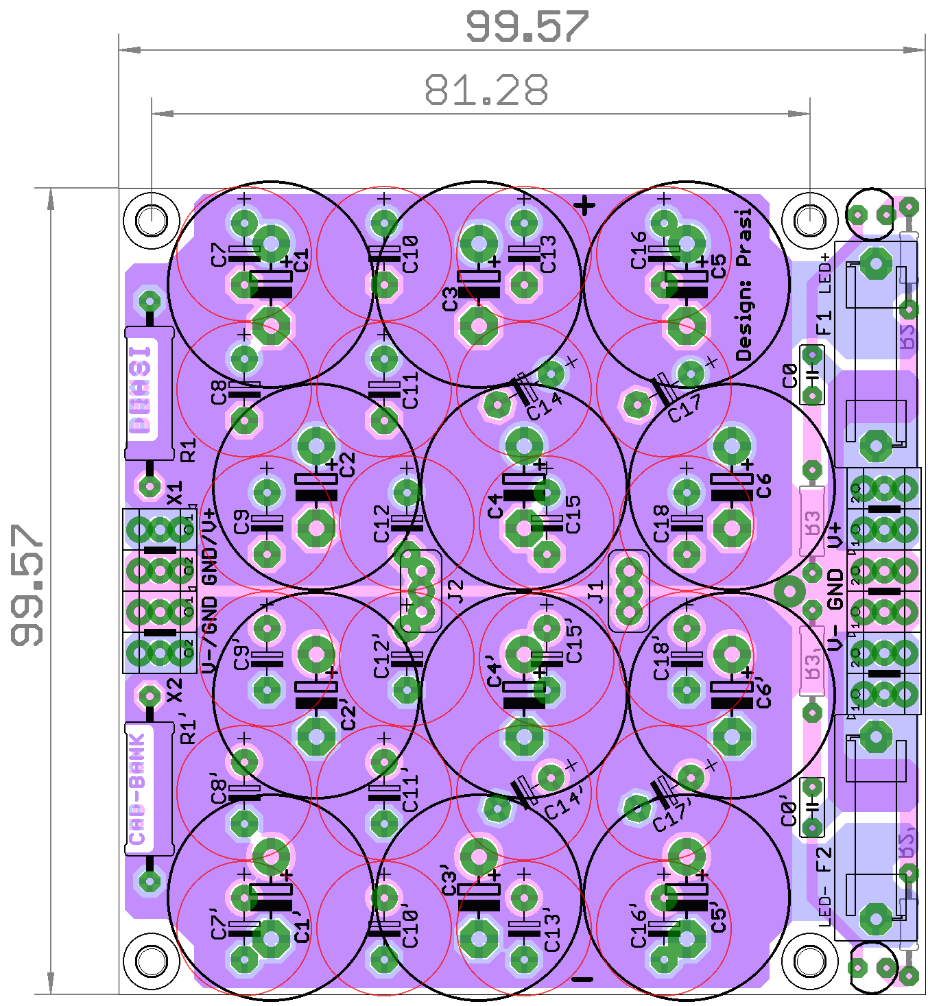

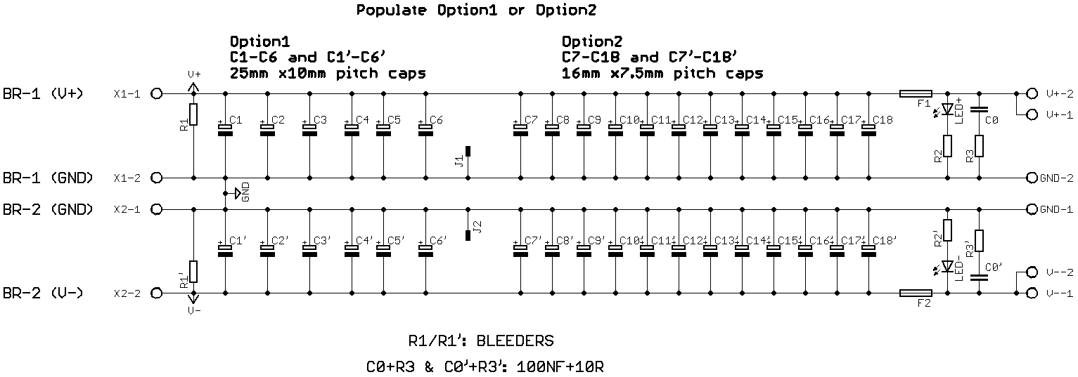

100W Ultimate Fidelity Amplifier
sch, gerbers and stuffing guide.
Although i/p terminals are shown to be 5mm pitch termi blocks, One could fit 6.35mmx 0.81mm faston connectors. There are some optional ground vias at the center and towards o/p side.
Regards
Prasi

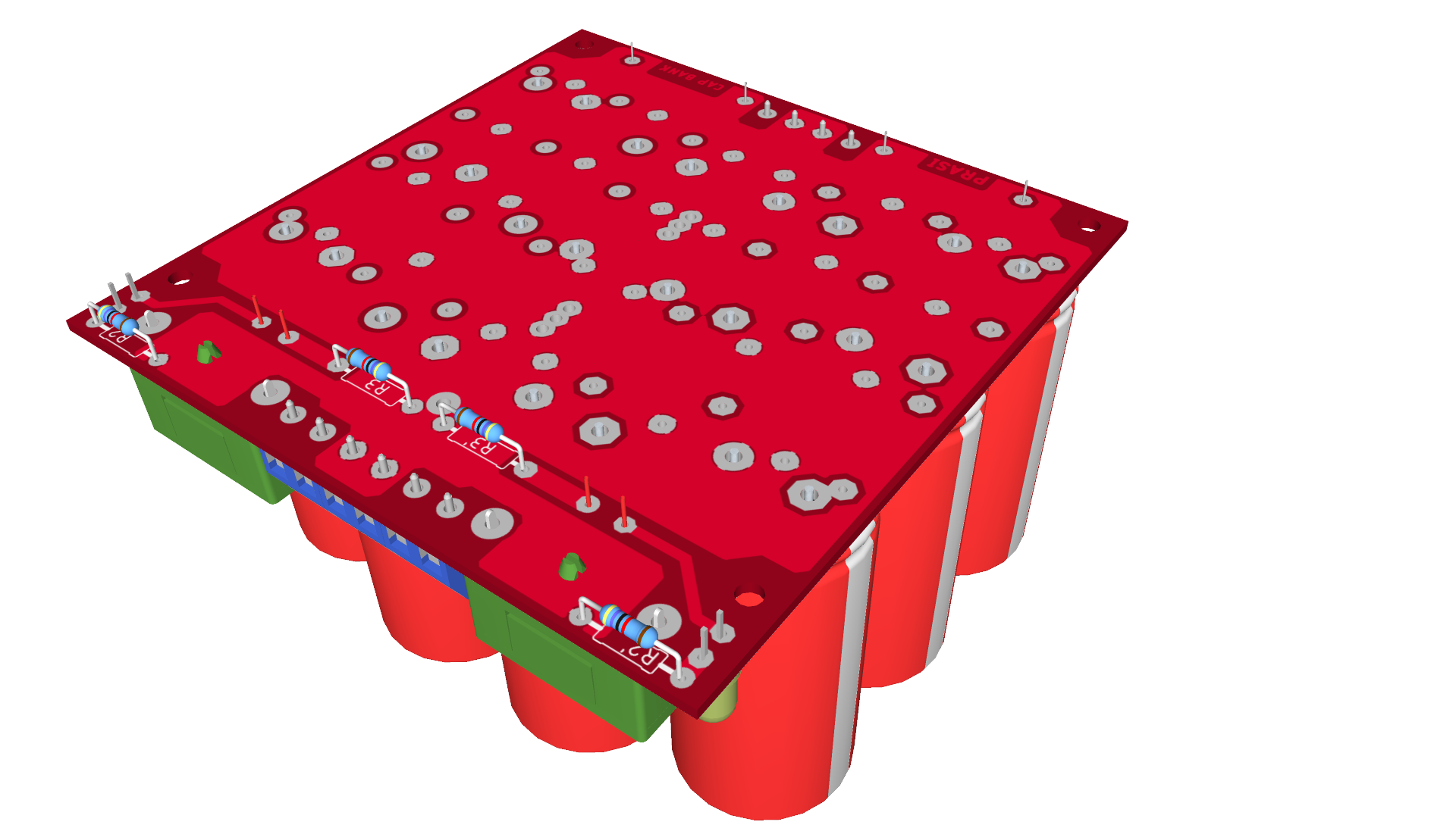

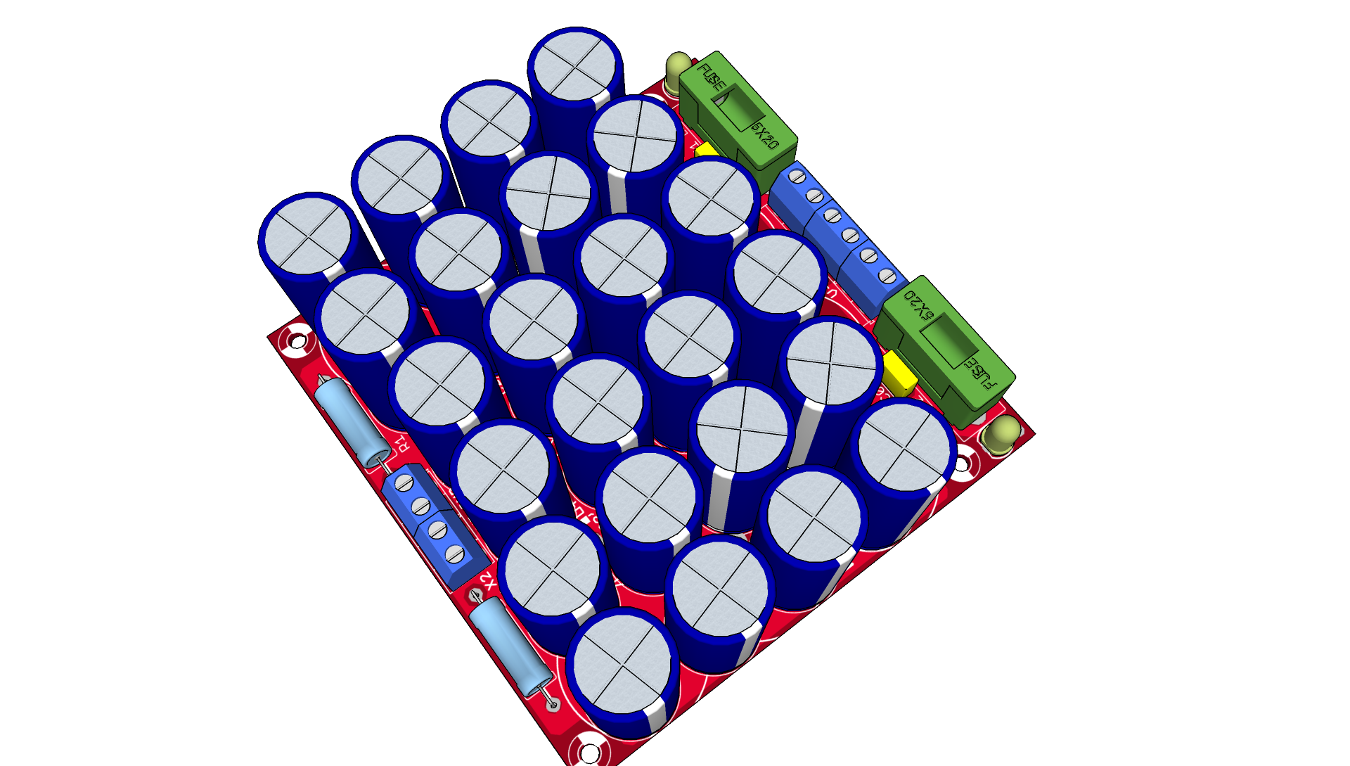

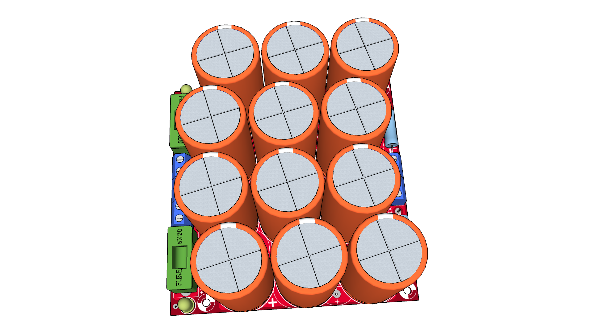

ok, this is how 25mm caps fit..
The second image shows where the resistors fit on the bottom (to be soldered first before putting caps and fuse holders.
PS, Orange colored caps are the omnipresent (in India) "Keltron Electrolytic Capacitors";).
Joined 2010
Prasi,
Forgive me in advance, as I am new to looking at schematics and visualizing the circuit board. My question is: " Does one need to still solder wire to connect the caps in parallel, or is there hidden traces in the pcb that connect the +, -, and Gnd as shown in the schematic.
Thanks for the help,
Myles
Hi Myles,
there is no need for any additional wire.
There are 2 top planes (of copper) that connect the caps' positive and negative pins.
There is a ground plane on the bottom that connects to all the ground pins of the electrolytic caps.
zoom in on the image of a single cap and you will see 4 blue spokes connecting cap pin (rail). 4 pink spokes connecting the cap's ground pin.
hope this clarifies the scheme.
I have provided thermal relief (4 spokes of PCB copper connecting the cap's pins) so that soldering is easier and can be done with an ordinary 25W iron available with most people.

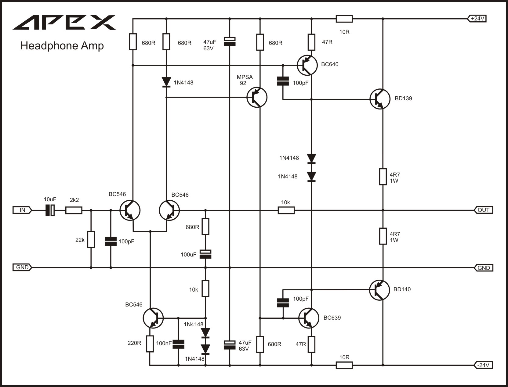

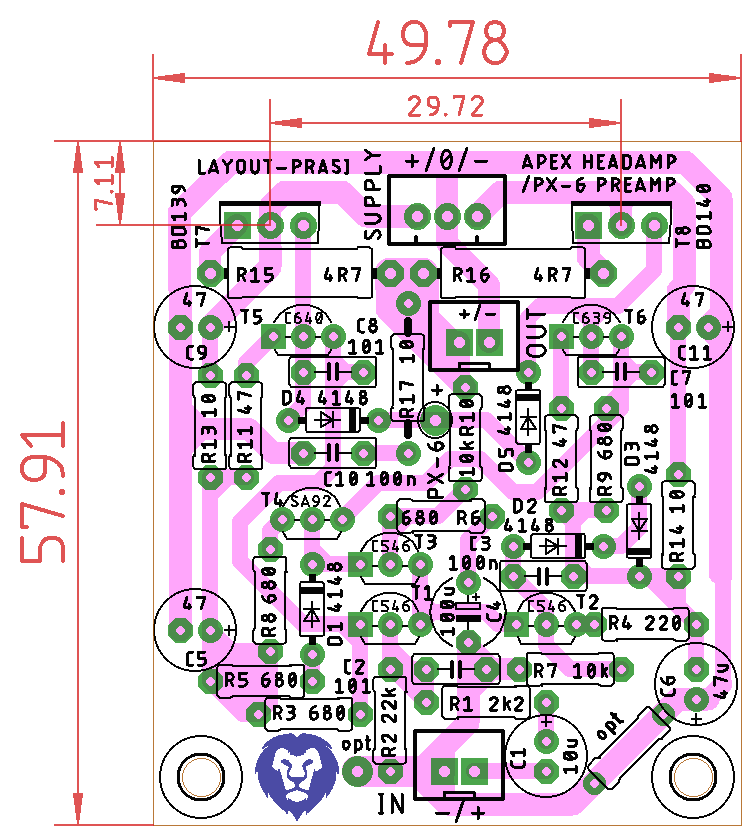

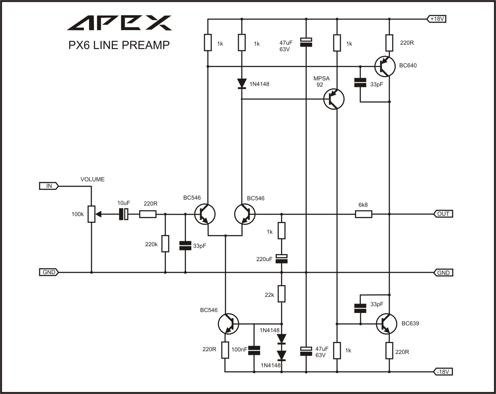

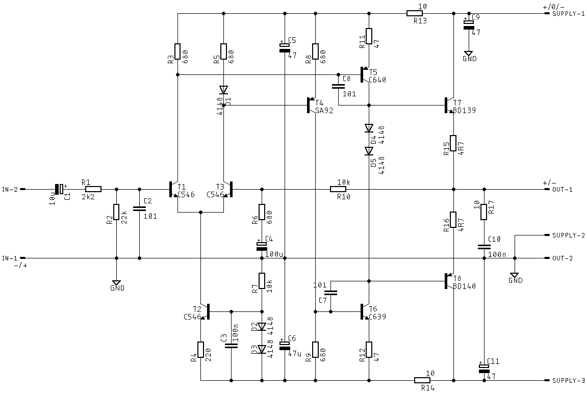

just a quick dirty little 'diy-friendly' layout of Mr. Mile's very flexible ckt.
It can be a pre-amp or a head amp .. (can also be FX-8 amp, but I havent given a thought to this).
First 2 images are Mr. Mile's designs and 3rd is a head amp layout and 4th is my exact schema.
regards
Prasi
you can send the gerber zip file to any of the chinese board houses wihout facing any issues.
Schema here
bias procedure
Procedure for bias.
1. you will need 2 nos. of 10ohm 1W/2W resistors.
1a. turn the trim pot so that resistance between first and third leg of trimmer is approx 250 ohm.
2. Connect one lead these 10ohm resistors in series with your + and - rail wires of psu.
3. connect the other lead of resistors to amplifier +/- supply connector on amp pcb.
4. switch on supply and measure the voltage drop across these rail resistors.
4a. measure the voltage between spk out and ground. this is offset. it should be less than +/-30mV. Good matching of Hfe of i/p transistor pair (Q1/Q3) will ensure that offset is close to zero.
5. total quiescient current is given by I= V/10ohm
6. set the pot so that voltage drop across 10 ohm rail resistors is about 1V to 1.1 V.
7. Let the amp warm up for 1/2 an hour recheck the bias
8. Adjust pot if required to have voltage drop of 1 to 1.1 V.
9. This will ensure that you get a bias through o/p stage of approx. 100mA.
let me know, if you need anything else.
