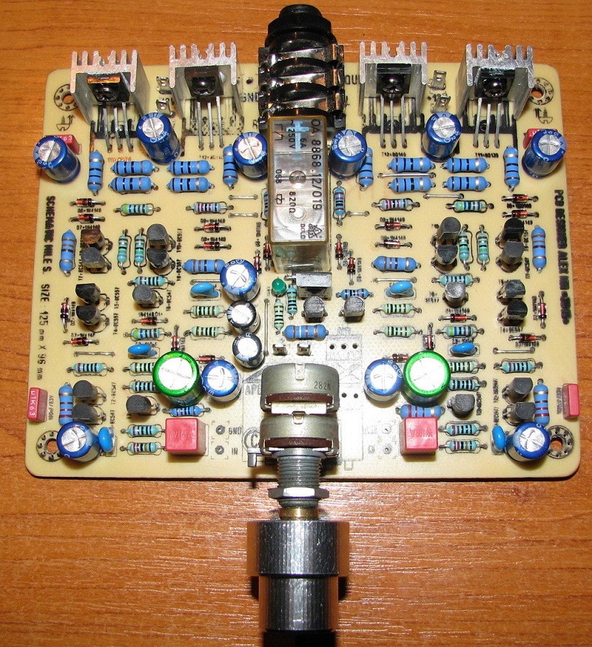

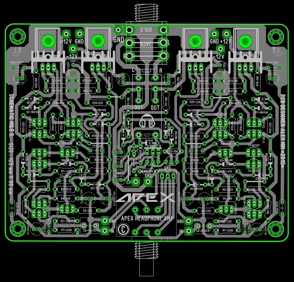

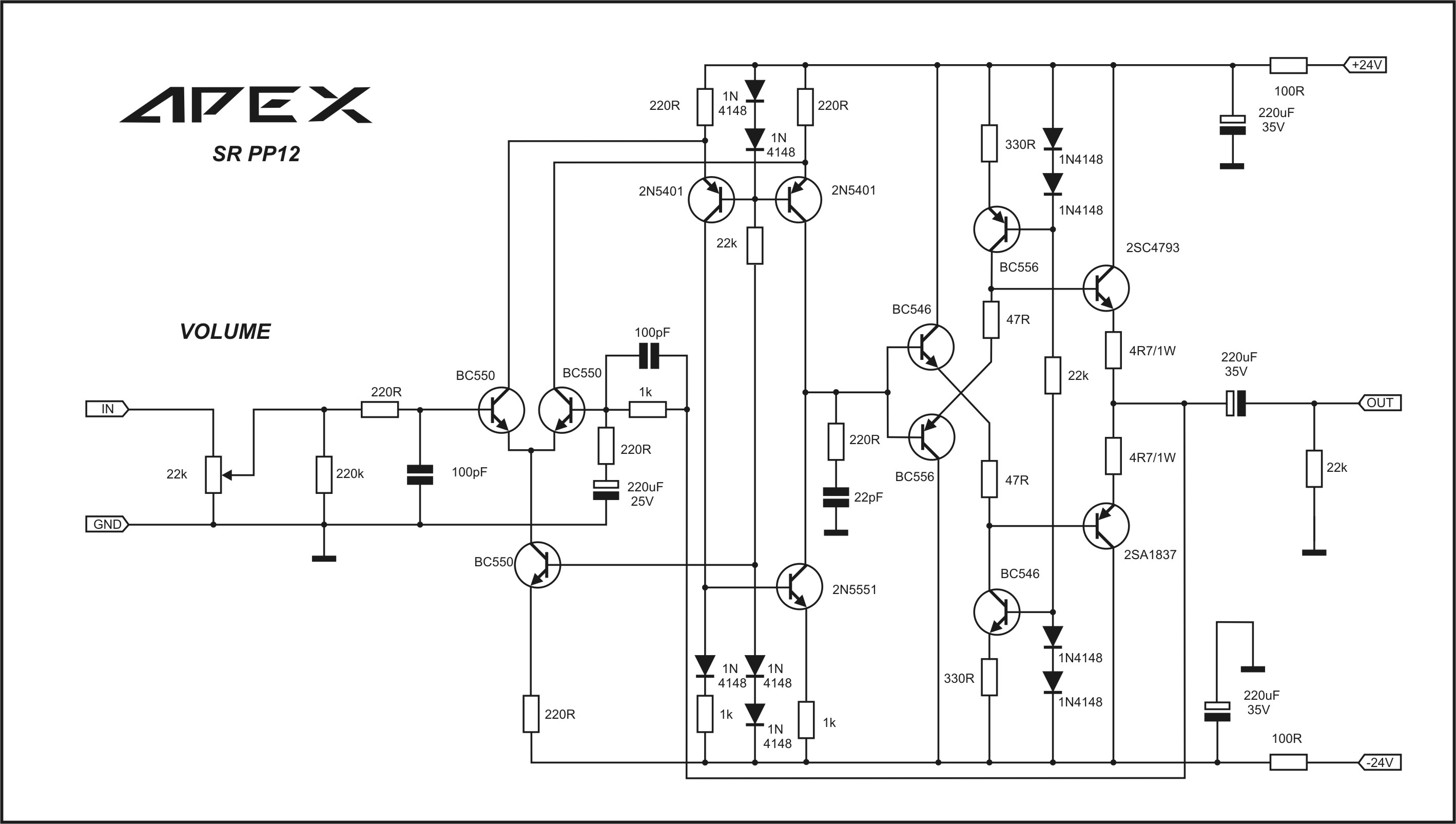

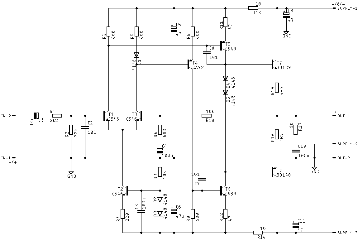

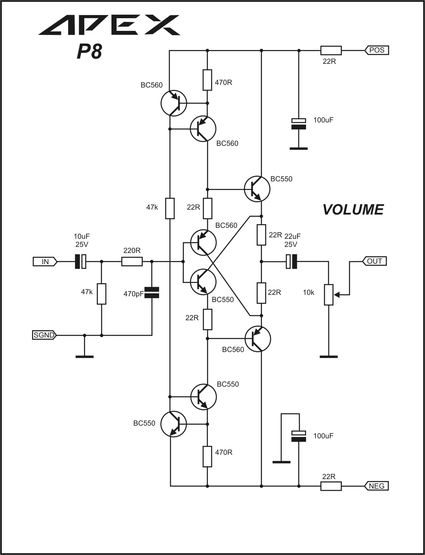

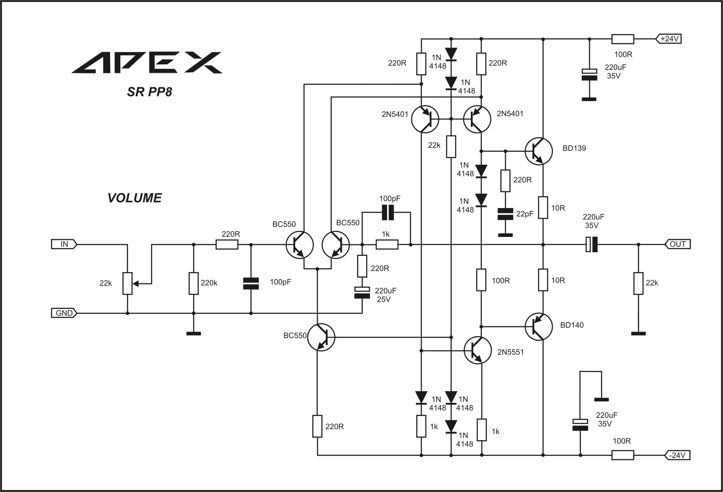

I have started building P8 preamp but it has 23db gain.I would like to have around 10 db gain but i am afraid stability margins will get worse if i lower the gain.
Which one P8. I am confused. I found this schematic on post no. 1800 in studio reference amplifier forum.
Mr. Miles plz explain.
Regards
Gurpreet
Use 3k3 for R6 and if there is instability try higher value for C7 and C8 (220pF or 330pF). Also, the value of C4 should be 50 to 100 times the value of C1 in order to avoid interaction between them. So, use at least 470uF for C4.
Should i change R10 from 10K to 22K as R2 for minimum output offset?Also could i use a 10p cap across R10 or from T6 collector to base of T3 to improve stability?
