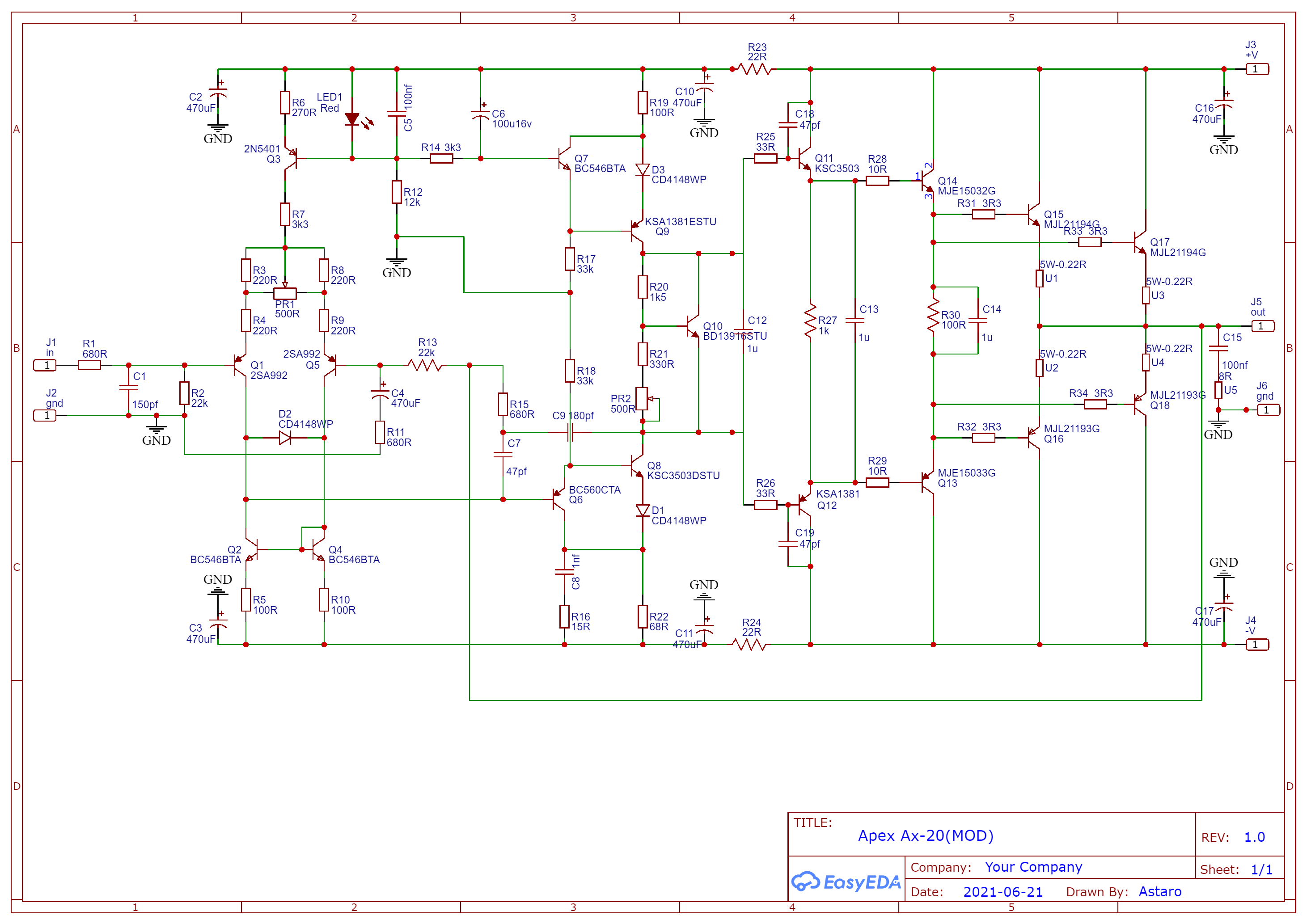

Previous you asked about 4.7pf cap size - looks like 7.5mm just comparing to the resistors right beside it. You could order 5mm and bend the legs to ensure it will fit too

5 mm, but you can slightly kink the legs to make it fit in 7.5mm pads.

second via for 5mm pitch is is left out on left channel😉

The inage i had had a single leg option but I see my boards have 5 and 7.5. Great.

Cool asymmetric design feature Prasi...just seen that!

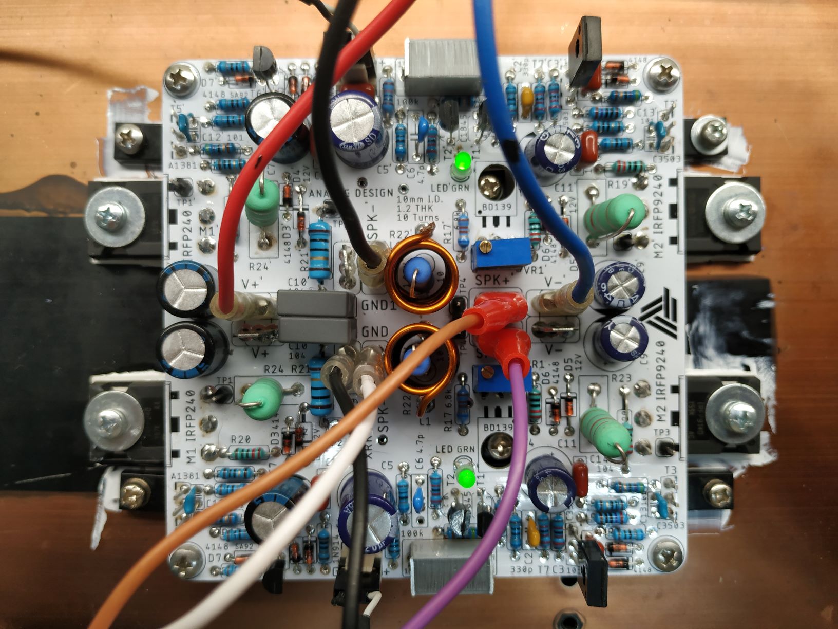

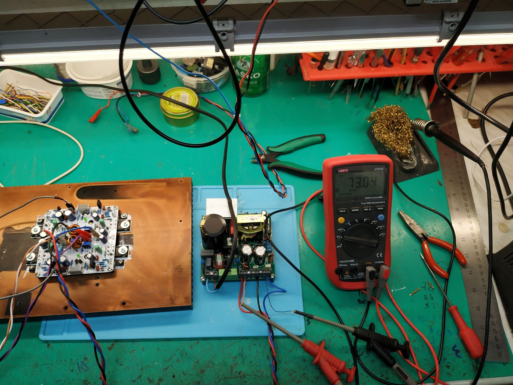

This is my build from post #13686 ordered from PCBWay. The amp is powered with SMPS ,+- 36V,plays very well and not difficult to assembly. The bias is around 70ma per transistor and is not hot at all in normal listening level.
Thank you Prasi and XRK for this amp.
Regards
zoky2
Regards
zoky2

A request , if possible post a close up of assembled pcb as a guide to others

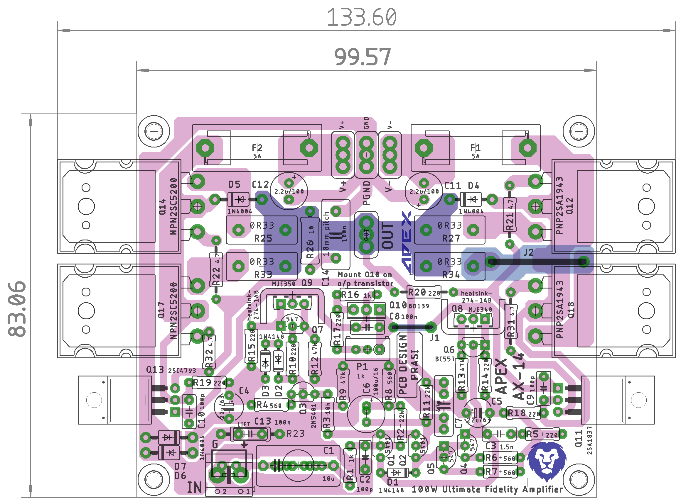

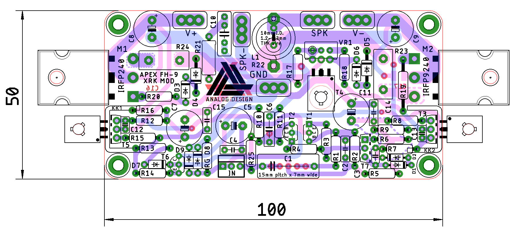

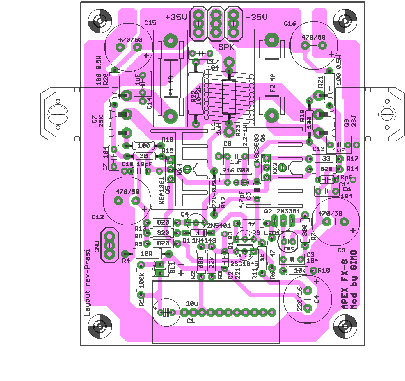

How would you compare these three amplifiers Prasi has drawn boards for?
Apex AX-14,
Apex FH-9 XRK-MOD-Compact,
FX-8-bimo?

Apex AX-14,
FX-8-bimo?

Hello Dave,
it is mightily difficult to get an answer.
all the three have been built by many and with parts in their bin and they worked every time, so its up to you.
I never built the FH-9 since I had built a few FX8s and was very pleased with them. Never built the Bimo mod though. The AX-14 is a sweet amp and with two pair will handle more power. All of them are using parts that are getting harder for find. You would be pleased with any of them I'm sure.
Does the APEX A40 support +-55V transformator voltage output, so +-55*sqrt(2) rail voltage?
If I understand correctly, you are asking if a 55Vac secondary is too high for an A40. This would give you approximately +/-75Vdc .
Yes this is too high for 3-pairs of outputs. You should have at least 4-pair and to be safe would suggest 5 pair.
But it’s DIY so if you are willing to take the risk you can “try” almost anything. Suggest if you are going to try it, that you buy more robust outputs then the 5200/1943
Use PSU15 and you can set +/-60V
regarding APEX-XRK FH-9 stereo amp pcb, Since I didn't get many responses, I went ahead and ordered 10 protos from pcbway, they are all booked, strawa 2 pcbs, inyashd 2pcbs, viki_v2 4 pcbs, me 2 pcbs.
if anyone wants to place order , they can do so below.
APEX-XRK971 FH9HVX AUDIO AMPLIFIER-STEREO - Share Project - PCBWay

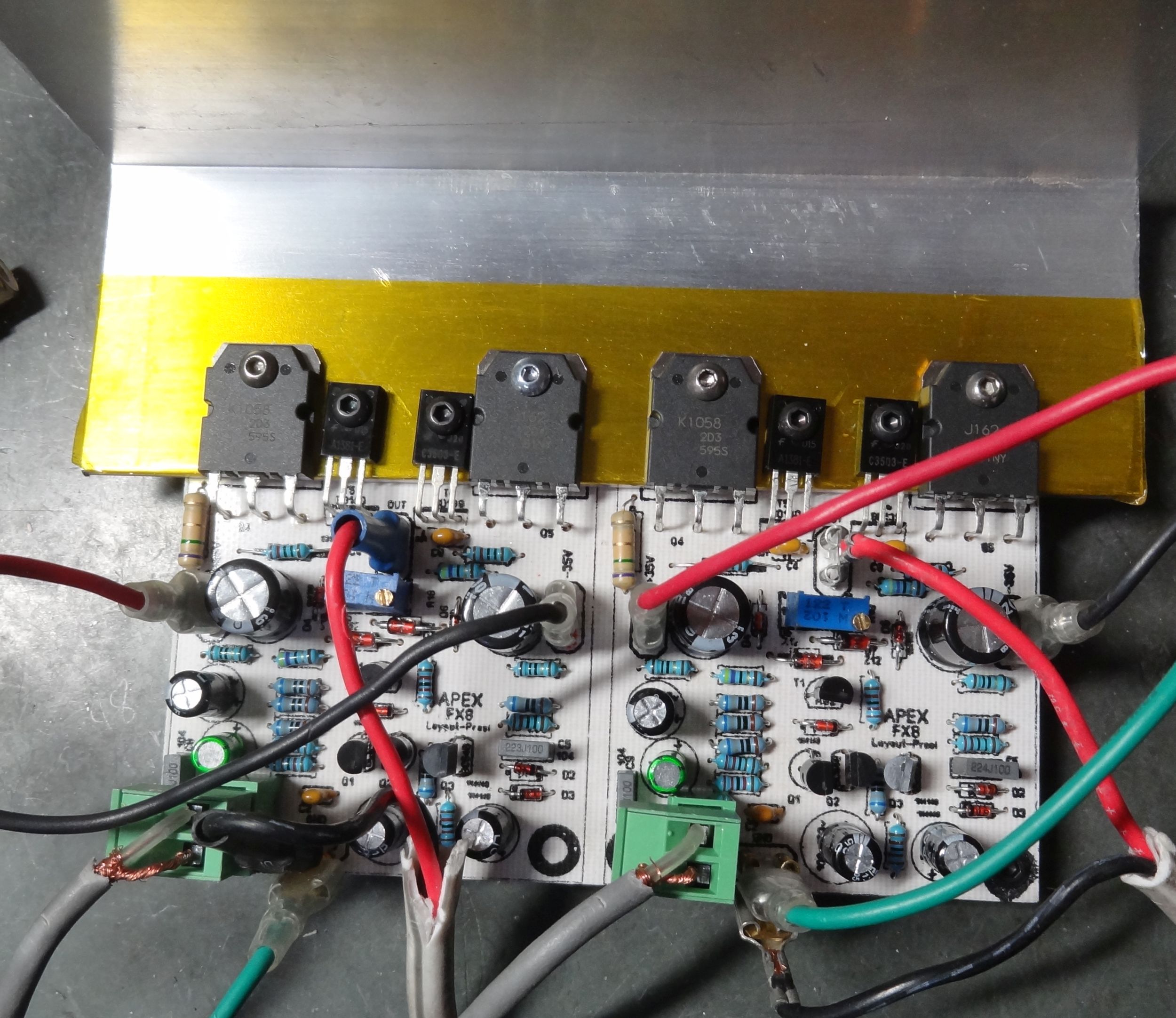

If memory serves me, the FH9 was XRK's work around to the FX8 so he could use the cheaper HEXFETs for the output instead of the Lateral MOSFETs. I guess it is getting increasingly more difficult to get laterals these days. The FX8 was one of the best sounding small amps I've built.
Was this the FX8 you made post #6202 based on Prasi's FX8 layout?
Link to post 6202
