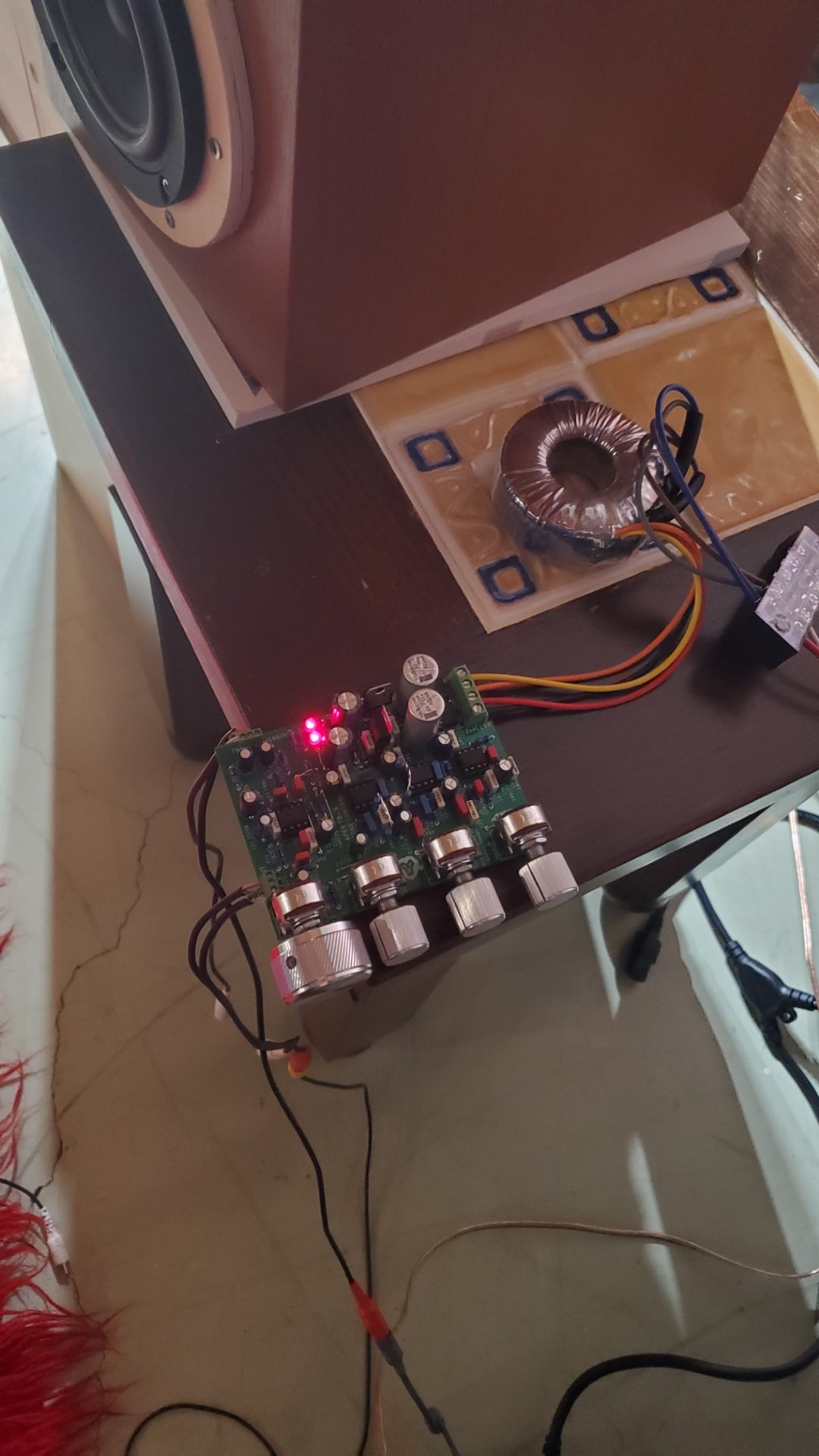

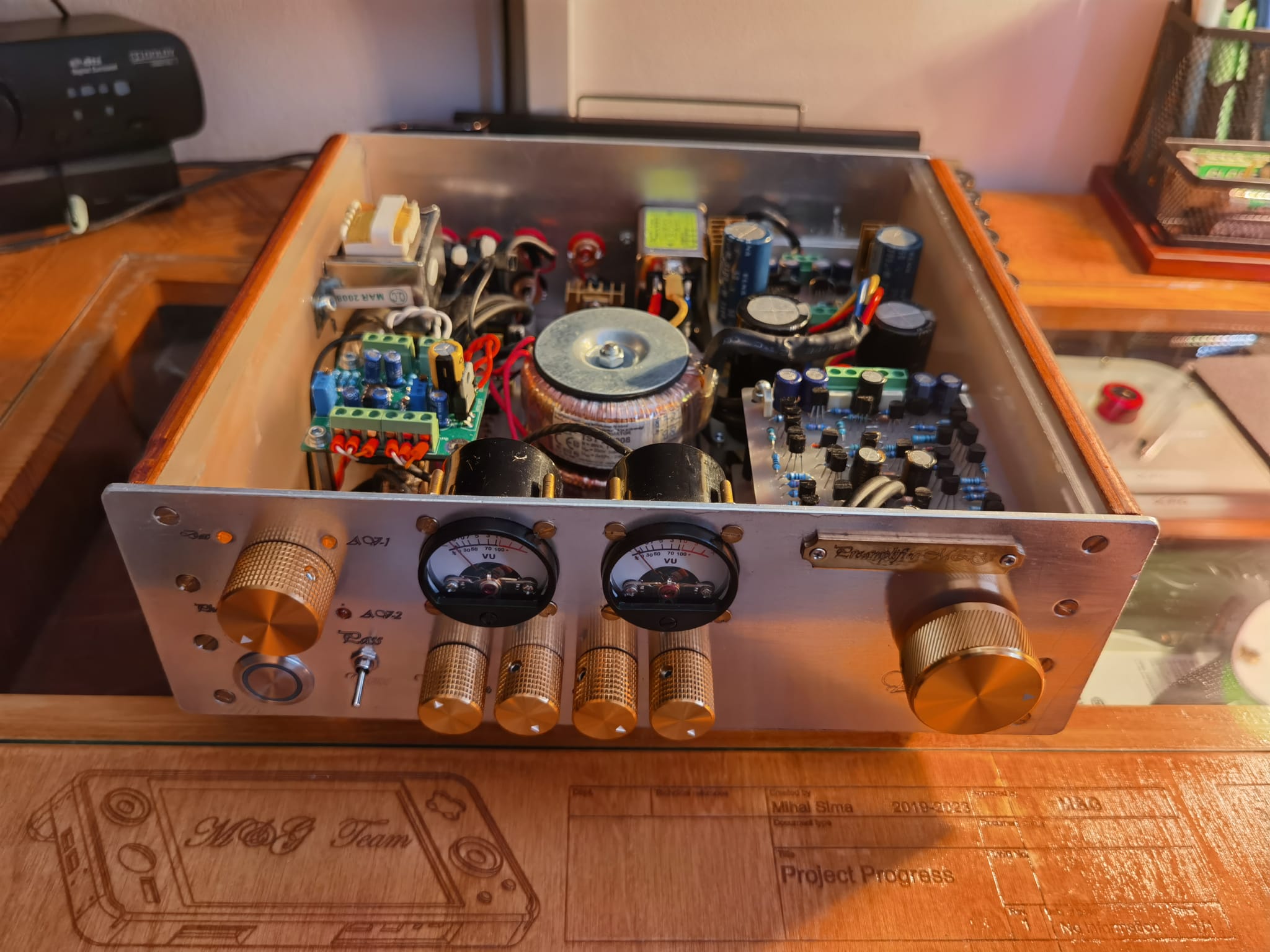

Hello ! First , thanks Alex MM and Apex for brilliant schemes and pcb.I managed to finish the P30+TB3 amplifier.
Reactions: 11 users
Joined 2003
TB-3 tone controls are fabulous!

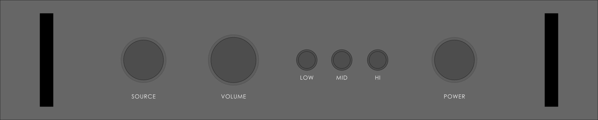

I'm correcting the overall rising speaker response of small midbass driver. I'll try it with a pass full range eq. This driver still need cone break up attenuated!

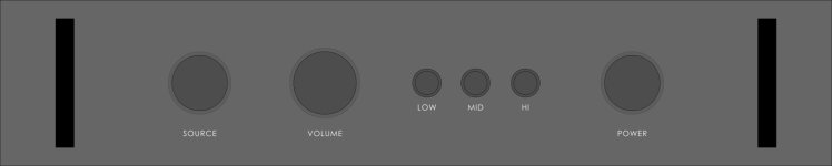

My plan is to install it in an integrated amp along with Apex AX11 mini

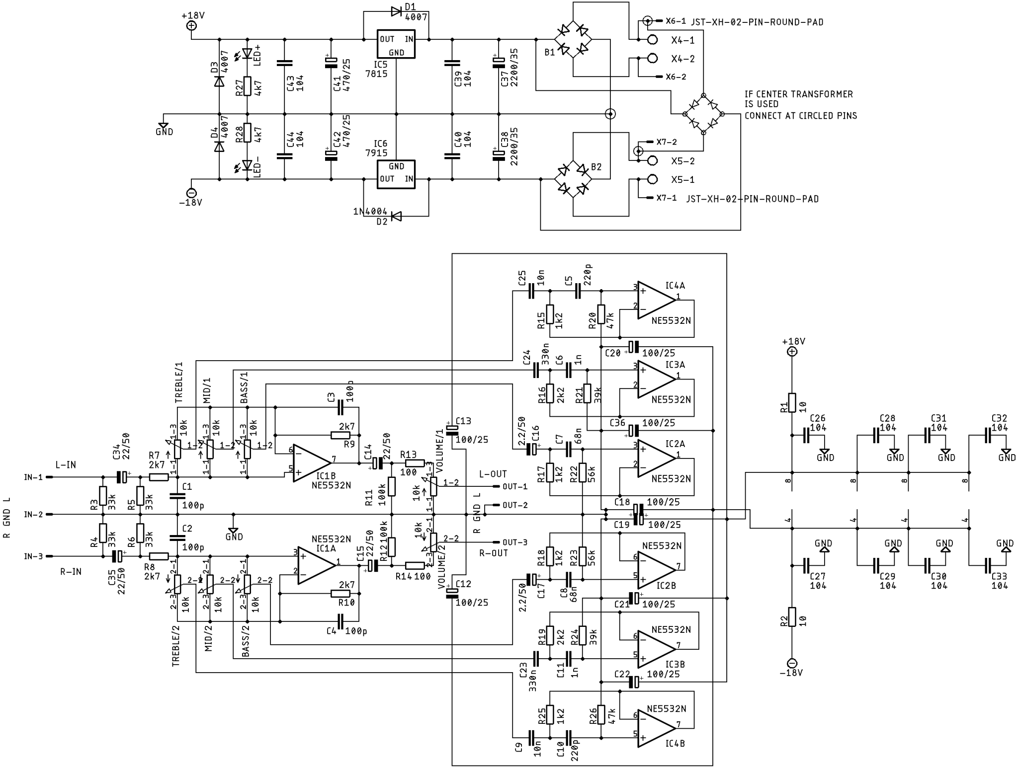

Hi all,
referring to the REV3 scheme of #14,268 - I wanted to know about the 3 potentiometers (bass-mid-treble)
are they lin or log?
many thanks,
Marco.
I'm using linear.
This one fits. I would like to find other options for 10k linear that will fit the pcb
https://www.digikey.ca/en/products/detail/bourns-inc/PDB182-K220K-103B/2564759
edit - BTW, the Bourns pot has a center detent. The response is basically flat at the detent. From my acoustic measurements it looks like
an approximate 6db cut and boost

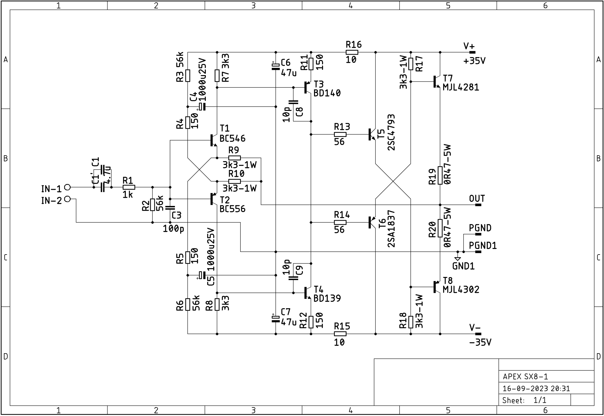

Apex BJT STEREO PRE-AMP SB 3.1 2014 - 2020
Hi guys I got this new layout I decide to go back a re-done the BJT pre-amp now that I have more experience I'm gonna posted here please if some one see an error let me know I just make it today I attached the schematic I use on simulation
Note: is not tested yet
