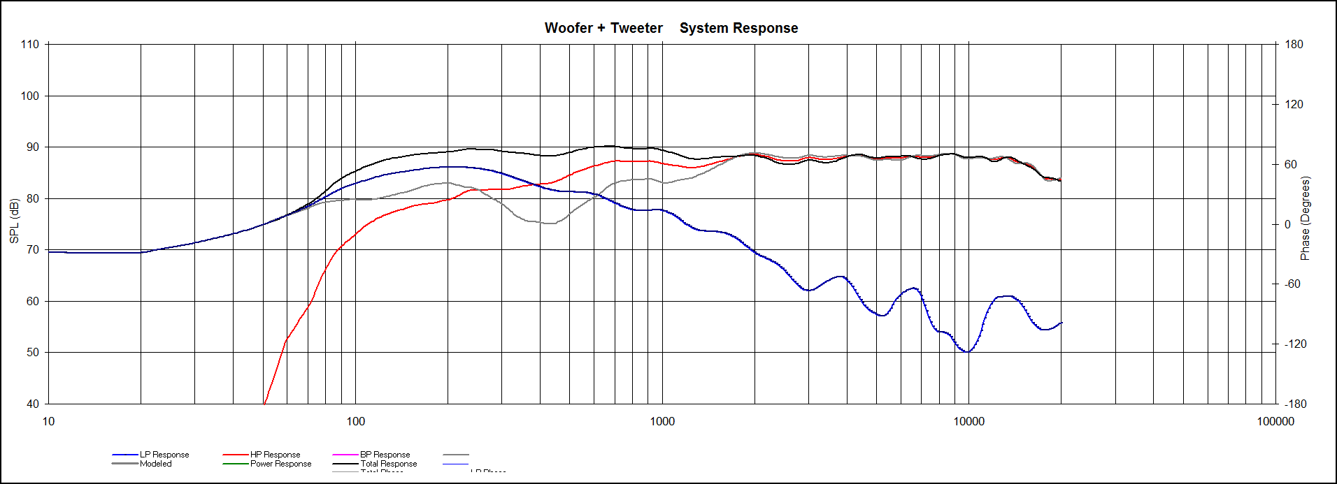

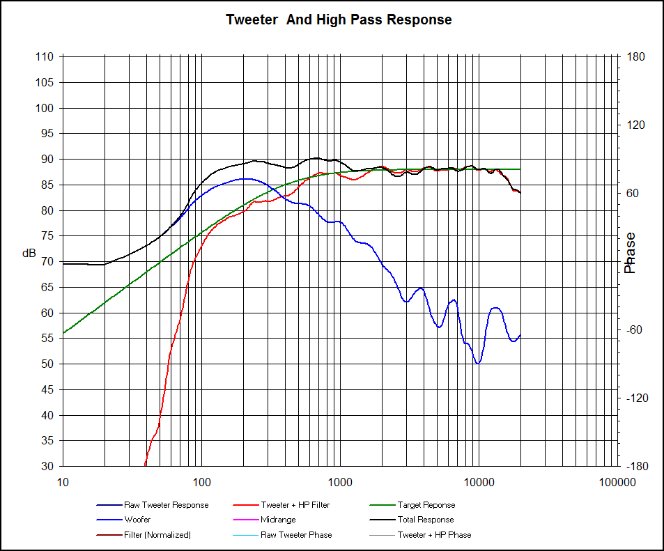

First of all, you really should try to hit your specific acoustic slopes. The minidsp is just dealing with the input/output signal. It's up to you to deal with the drivers actual response. The areas that deviate from the standard slope are messing with your frequency response and they should be dealt with on driver side eq, not global. Also, your xo should be exactly 6db down at the xo. No less, no more unless you're using butterworth.
I can't remember how to do it off the top of my head, but you can import standard slopes, ie. LR12 etc. into REW and then adjust your xo/driver eq and measure until you hit your desired slopes. That's how xo's are typically designed and how I do it, both digital and passive. If you have the interest and time, I recommend download passive crossover designer or something similar and spend some time playing with it. There is a learning curve and it'll seem complicated at first, but it'll help you understand what's going on. BTW, PCD has an active section too so you can model your dsp setting to hit slopes there too.
Secondly, you're using the RS225 too high. A 750 xo with 1st or 2nd order is just not going to work that great (2nd order maybe if you deal with the breakup) . Regardless of what your distortion measurements are telling you (you need to raise the level as stated before because at .71V you're not really getting any useful information in you distortion sweeps, you're mostly just seeing the noise floor)
I know you think it sounds great, but that's mainly because you likely haven't heard it sound the way it should. That's not a critisism, I used to think all my designs sounded great when I first set them up too. When people are saying that the female vocals sounds hard, that is likely due to the woofer's breakup. In the graph above, the breakup is only about 20db down. You're hearing that, and believe me, you don't want to hear the breakup on those dayton drivers. It should be at least 40db down, preferably 50.
I'd move the xo back down to around your baffle step frequency (450Hz?) and HIT YOUR SLOPES so that the crossover is actually where you expect it to be and the individual driver responses are 6db down where they cross. If you need to, use the peq function to add a notch or two at the woofers breakup so that it's at least 40db below the summed. And I would stick with 2nd order or higher. With 1st order slopes you are going to be introducing distortion at both ends (low on the 10F, high on the RS225)
Third, you have some phase issues going on. Anywhere where the individual driver's response is above the summed response you have phase cancellation. Looks like pretty much from 70-5K there are phase issues which are going to affect the frequency response and imaging. The drivers response should not go above the summed and you should have more gain around the crossover in the summed response than your measurements show.
Reverse the polarity of the 10F and measure. you should see a dip in the summed response at the xo. My guess is that you will see a minor dip at the xo and the response actually raising from 70-350 and around 2k. That's not what you want.
To make it right, with the 10F reversed and both drivers connected, measure and adjust the delay of the 10F only until you get a suckout of at least 20db or so. A second order LR xo should have a wide and deep notch, 4th order a narrow deep notch. When you get a deep notch, switch the polarity back to where you had it and measure. Hopefully the summed response is no longer below the individual responses.
Now, you'll likely see a hump at the xo because your current xo is not 6db down like it should be. To fix this either hit the correct target slopes as outlined above (recommended) or move your crossover points apart, ie 350Hz on the woofer and 450Hz on the mid.

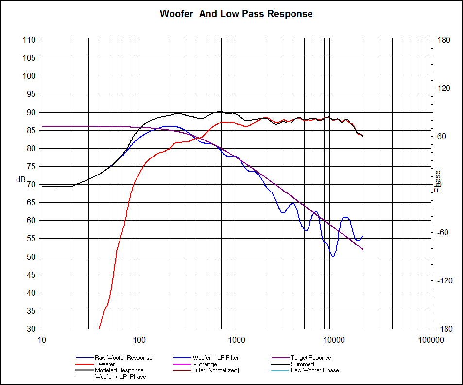

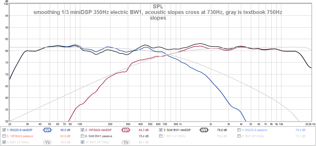

Take a look at this regarding phase. I had these driver files already so I put together a quick sim. Dayton is the 4 ohm and 10F is 8 ohm, that's what I had already.
This is just to show what you should be seeing around the crossover in regards to summed FR vs individual driver FR. Notice the large combined gain in summed response from 80-1800Hz. Then notice the response above 2K where the woofer's breakup is out of phase with the 10F and causing cancellations. This is with one // notch, 2 series notches and an eliptical notch! And it still looks like poo. 1st order crossovers are almost never a cap and a coil, especially with metal drivers. I also had to boost the crap out of the 10F with active eq to get it to apoximate a 1st order slope below the crossover, but the baffle model on it might be set up for open baffle, I can't remember.
Gray line is reverse polarity on the mid. 13db down and the phase is not particularly good with the sim. I don't think 20db is out of the question. And notice how wide the notch is.
The other two show my attempt to hit 1st order slopes which wasn't particularly successful. But those targets are what yours should look similar to if you want true 1st order slopes.

Yes, it certainly can and that's what I was suggesting to you earlier. I didn't post those to try to get you to go passive. That sim I did is not very good. It's just to show phase and gain/cancellation.
That graph you just posted demonstrates the point I'm trying to make about your phase being off. Between 70 and 350 you are showing cancellation of the woofers response. You should instead see gain like you do at and above the xo.

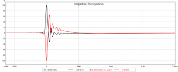

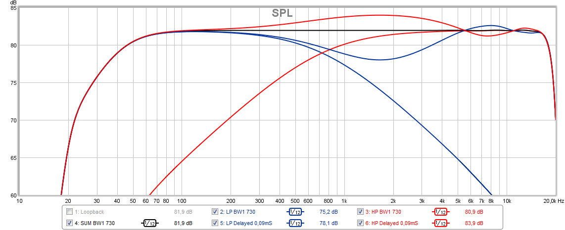

BW1 XO with possibility being transient perfect i understand X want investigated for a while because as is think he knows what he hears sounds good and there could be more precision to improve further. My post 63/106 exercise running BW1 at 400Hz for me performed very good and now the tweeter is replaced with a 10F/8424, acoustic slope plus squarer waves on axis that TC9FD can be seen below and sound was very good.
Being little green this sport making good acoustic XO integration observed a lot of things happen when trying calibrate speaker to hit best possible performance and these some times in head got confusing leading to wrong settings. So for better understanding made som small study in electric domain with target BW1 XO slopes. The filters are set real in JRiver DSP engine then soundcard I/O looped back and REW listen in loop.

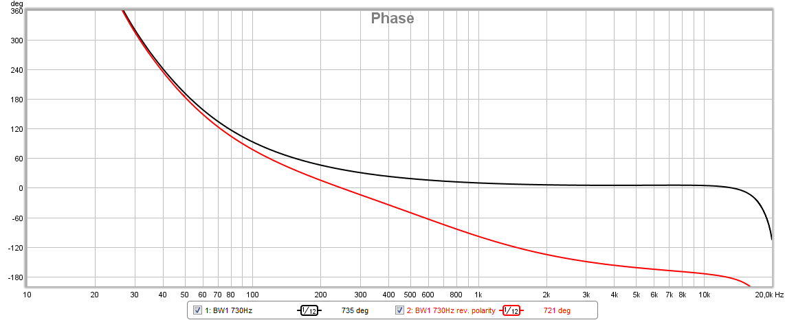

Frequency response HP/LP BW1 730Hz and their sum if slopes are perfect. The boosts and cuts are when drivers are unaligned on axis and for this example 0,09mSec delay where blue is woofer set behind and red if tweeter set behind. The alignment offset effect is nice to see visual to be prepared when setting up system. Setting higher offsets really spoils things getting much worse than the ones shown here.

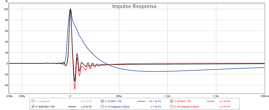

Impulse response dicovered the ringing at pulse decay is because of sytems LP in this exercise set at 18,5kHz BW2 plus soundcards limit. If the 18,5kHz BW2 system LP filter was deactivated the black impulse presenting sum gets as pure on pulse decay side as on attack side of pulse. Probably some the reason modern tweeters have HF extension up very high and reflect in better squarer wave reproduction too.

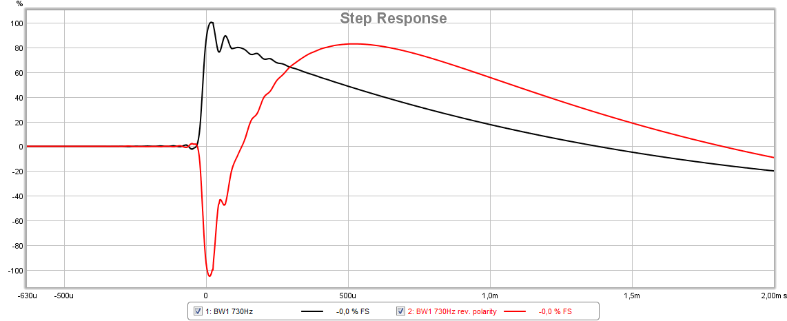

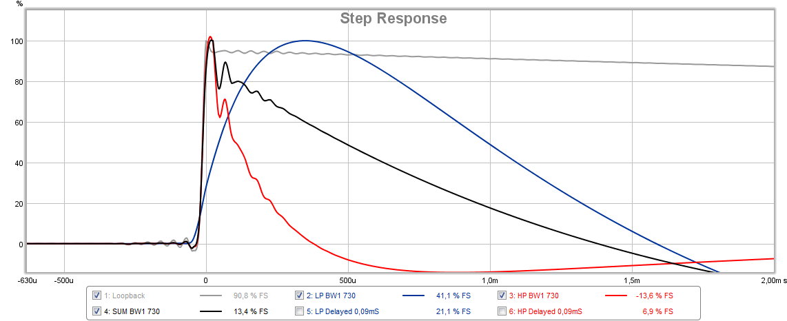

Step response exercise discovered some logic too and help align offset LP and HP sections and for below example same offset 0,09mSec is used. Black is perfect sum LP and HP summed and again system LP at 18,5Khz shows up preventing strait line from decay slopes meeting at 100% step pulse forming a sharp pinch. Blue is woofer set behind and red is tweeter set behind. Tweaking a digital delay up and down get blue or red in synch with the correct black one, if setting high values as offset things get really ugly. Running digital DSP powered exercise in electric domain its easy to say black slope reflect perfect slope for this alignment but its mush worse in reality when one gets close to target to see if slope has some small deviation. For that in reality did find if one measure woofer with its lowpass filter turned off and save this measurement as target then tweak summed measurement to overlay with target.

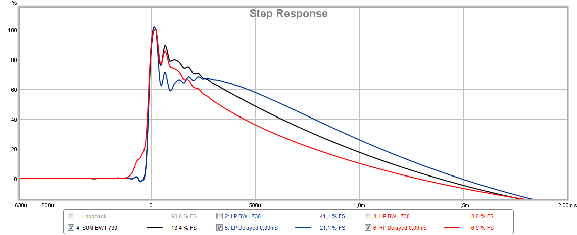

Step response once again this time to see the two aligned signals blue LF and red HF they sum as black system step response. Grey is soundcard loopback having nice lower frequency extension than the drivers.
Hope some find usefull when setting up BW1 filter.

Yes cleared some things for head to get stuff visual and less user errors when trimming system.
Difference is very clear under critical listening when being tecnical correct placed on axis between blue black red versions. One must then admit if sitting a strange position in room the the 0.09mSec aprox. 3 cm shown think can easy be a actual offset. The red one cover the midrange boost that ruined our first trial for passive.
That said its as when correct aligned they fire sound stream more as a concentrated hot beam not spreading sound so much to room reflections but i could be too practical simple thinking in what really happens.
A fun thing at post 63 my woofer is clear set back being as the red and settings was 0.63 now its 0,36mSec, yours seems as blue where tweeter needs set back, so try measure woofer alone with all correction you have set at it just turn off the LP XO then one get a nice target slope to hit when fine trimming offset. If it don't work your setup because electric XO doesn't reflect acoustic XO then request my mdat file in that it is set at 730Hz.

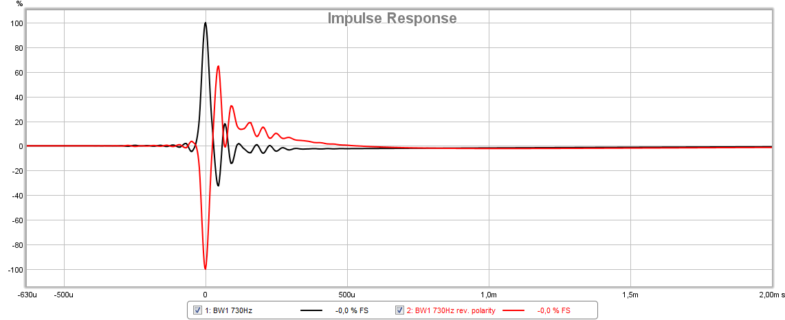

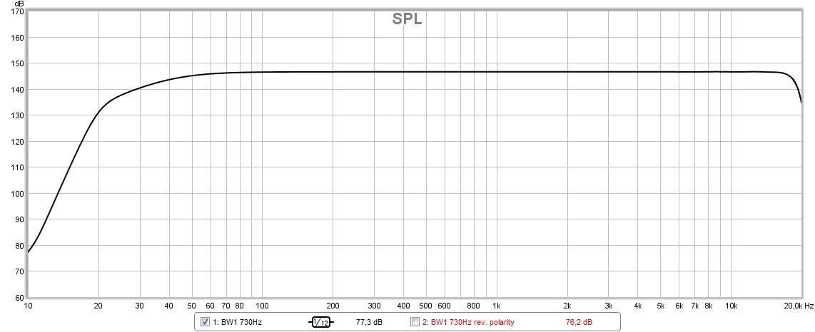

REW was warmed up so reversed polarity one driver at BW1 and it doesn't reflect in FR looking for deep nulls. Phase takes a 180º turn ruin step response and looked for other clues to align acoustic phase in this mode maybe some could find schemes in SR patterns to look for i find it hard the few trials.
Byrtt, did you build the same speaker with these drivers?
If you reversed polarity you should see a null at the crossover point and at least a couple of octaves each side with BW1. Phase and step and everything else will get out of wack of course
