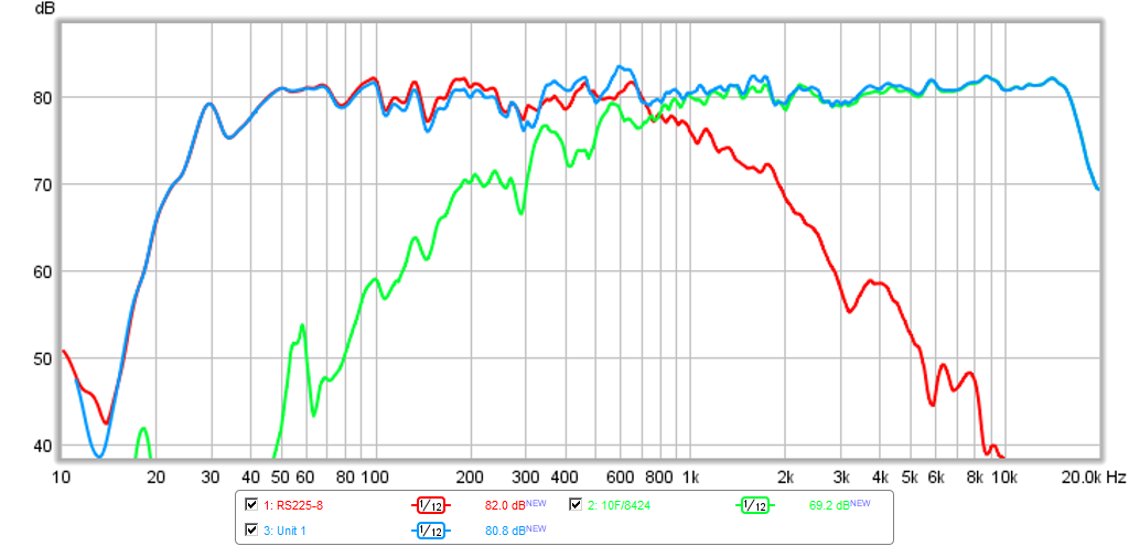

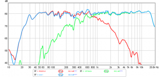

I applied very minor EQ'ing to smooth small bumps in the response (<-2dB cut in maybe 3 spots). Here is final response showing acoustic XO:

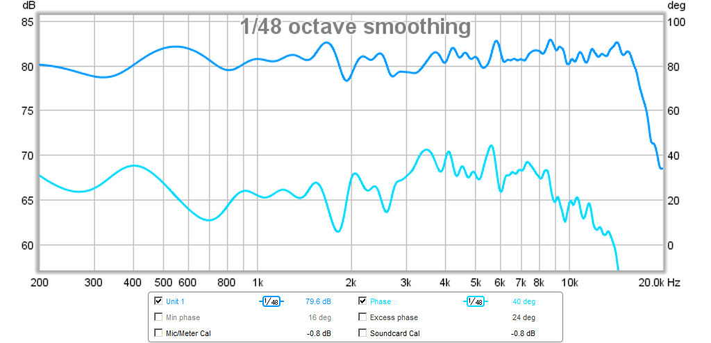

Here is the frequency response and absolute phase (4ms gate) varies +/-15 deg from 200Hz to 10kHz:

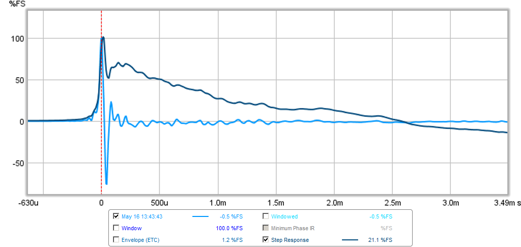

Here is the step response and impulse response:
![483462d1431802430-10f-8424-rs225-8-fast-ref-monitor-10f-rs225-fast-unit1-bw1-350hz-lt-eq-xo.png](https://www.diyaudio.com/forums/attachments/full-range/483462d1431802430-10f-8424-rs225-8-fast-ref-monitor-10f-rs225-fast-unit1-bw1-350hz-lt-eq-xo.png)
![483463d1431802430-10f-8424-rs225-8-fast-ref-monitor-10f-rs225-fast-unit1-bw1-350hz-lt-eq-abs-phase-48th-oct.png](https://www.diyaudio.com/forums/attachments/full-range/483463d1431802430-10f-8424-rs225-8-fast-ref-monitor-10f-rs225-fast-unit1-bw1-350hz-lt-eq-abs-phase-48th-oct.png)
![483460d1431802072-10f-8424-rs225-8-fast-ref-monitor-10f-rs225-fast-unit1-bw1-350hz-lt-eq-sr.png](https://www.diyaudio.com/forums/attachments/full-range/483460d1431802072-10f-8424-rs225-8-fast-ref-monitor-10f-rs225-fast-unit1-bw1-350hz-lt-eq-sr.png)

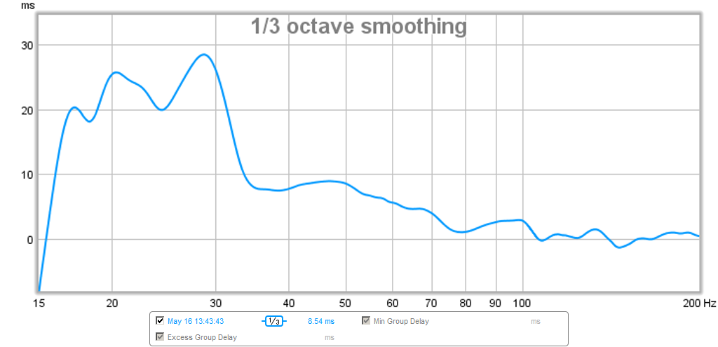

Here is the group delay, no more than 9 ms above 35Hz and about 2.5ms at 100Hz:

Thanks! This was actually a fairly slow build for me - many days for glue to dry, but I spent maybe close to a month designing it with the help of Byrtt who helped me settle on the volume and the sealed alignment with Linkwitz transform as the best way to get clean low group delay and fairly good bass extension. Lot's of Akabak models to settle on the approximate XO range and the selection of the bass driver. The RS225-8 is really quite a special driver, at any price. The ScanSpeak 10F/8424, on the surface looks like an overpriced Vifa TC9FD, which I really like. But it really shines in the transient articulation and ability to resolve percussive details very well, combined with a butter-smooth mid range that excels at vocals. It's been a fun speaker to design, build, test, and now really enjoying just listening to my music with them. The neutrality allows any music to be played and sound good. If you coupled this with a sub for below 40Hz it would sound even more impactful.
