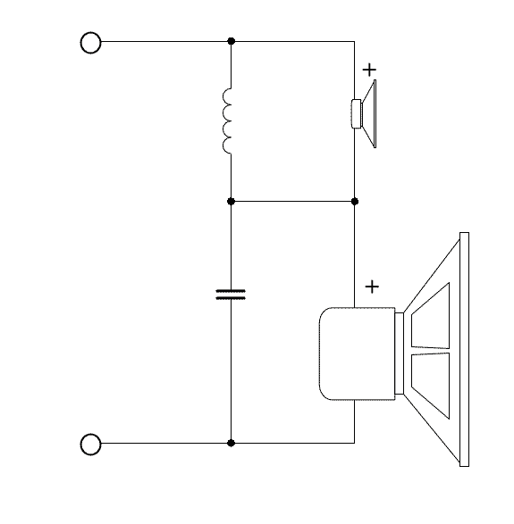

Passive XO is constructed in XSim and my logic said me if i design same slopes passive as xrk971 satisfied use in miniDSP we must get close, so bass slope is nearly exactly same for both versions, the passive just have less low end extension in lack of LT circuit, and for 10F the passive one is padded little more than miniDSP and gives think a pretty close to miniDSP sum. It should be said XO is set at electric 350Hz but acoustic slopes cross at 730Hz probably because 10F is padded down at least the 6dB baffle step loss. Because this passive version have nearly same slopes as miniDSP expect it needs nearly same delay to perform same acoustic IR/SR/FR/PHASE.
So hope the cost put to get a 57uF capasitor and a 3,64mH inductor is not lost plus make me unpopular and will give nearly same performance as the miniDSP once subtracted we don't have the delay for correcting on axis acoustic center between the two drivers, we don't have the LT circuit low end extension, and lastly the two drivers is no more seeing directly into to a low z amp and the electric motion dampening effect (elastic) this have in that RS225-8 looks thru a 350mOhm inductor and 10F have a padding network and a cap in the route.

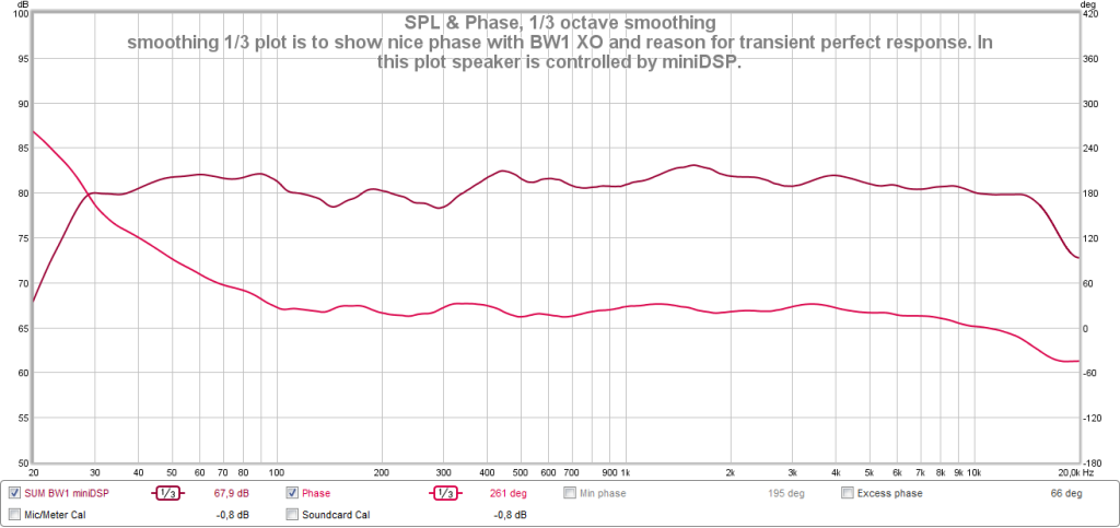

If passive XO needs delay as miniDSP setup did to calibrate on axis acoustic center the two drivers between, a electric solution is add a 1.order allpass but its drawback is its a 180º phase turn circuit adding not all 180º but some to the system nice flat phase gained by use of BW1 XO and it ruin some the perfect transient response. As pointed out by xrk971 instead of electric delay it could be done with a separately mounted Dagger that could be moved back physically to get the delay. Regarding delay or not if planet10 have tweaks he very welcome share

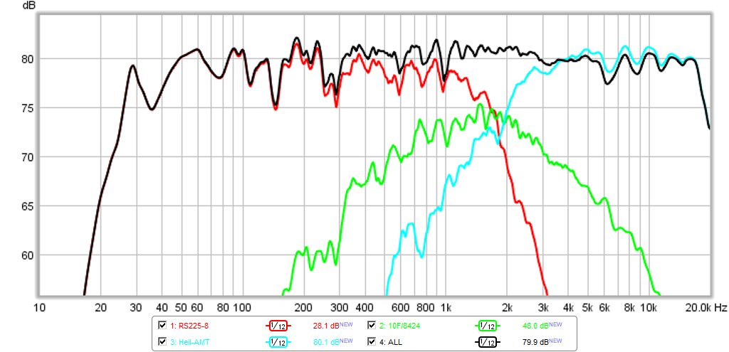

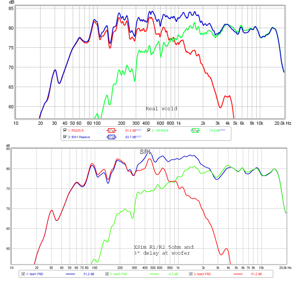

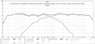

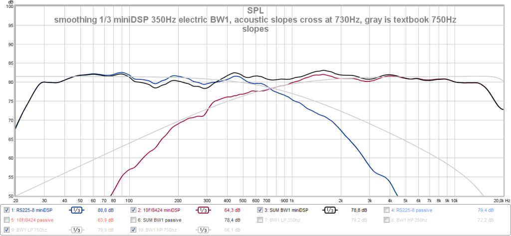

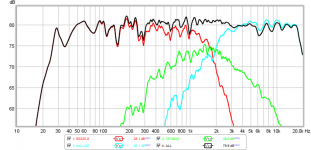

Think DSP active route is tough to beat given the flexibility, also see in picture 2 plot the measured acoustic deviation compared textbook is so easy to correct by EQ and then the square waves previous shown would probably show considerly improvement even we still in minimum phase domain.

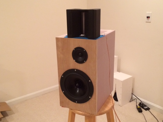

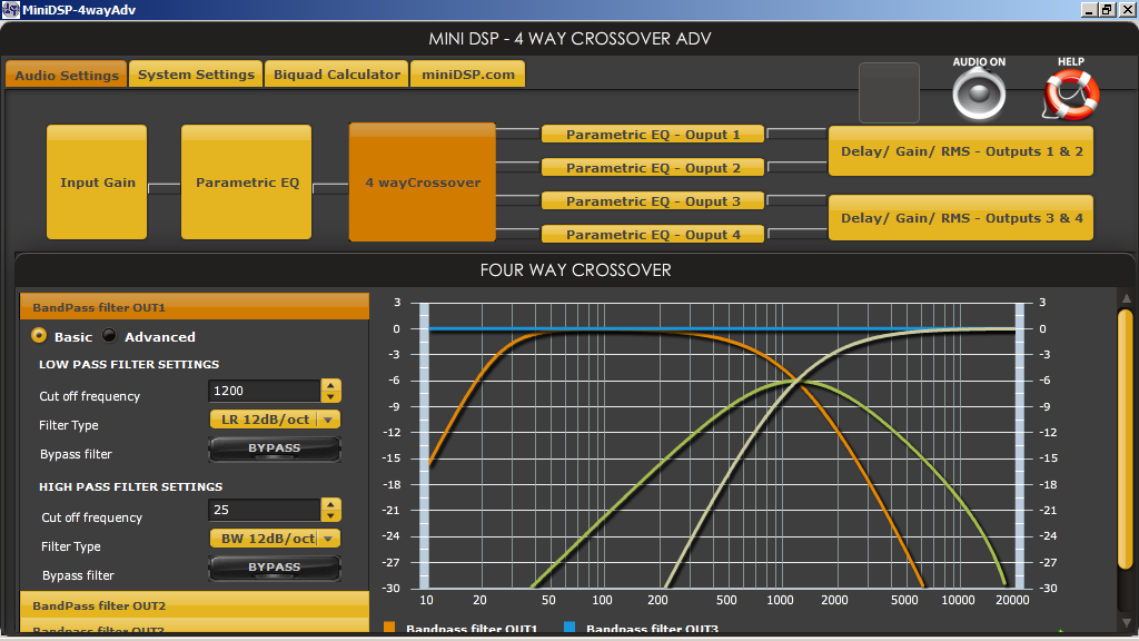

I stuck the Heil AMT on top of the speaker and loaded up the4-way XO plugin into miniDSP. I set the XO at 1200Hz with LR2 for the RS225 and AMT and BW1 for the 10F at 1200Hz (HPF and LPF). It took -20dB of padding on the AMT to level match it with the rest of the system (that is a lot of efficiency we are throwing away). The time alignment, even with digital delay is tricky.
Here is photo of setup:
Here is the minDSP XO screen shot:
Here is measured acoustic XO, appears closer to 1.8kHz:

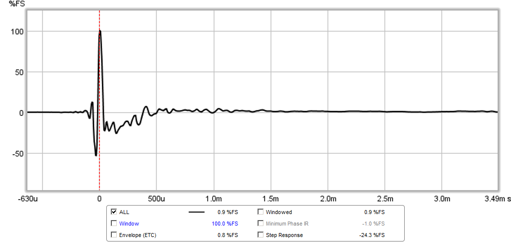

The impulse has a pre-ringing but is clean otherwise:

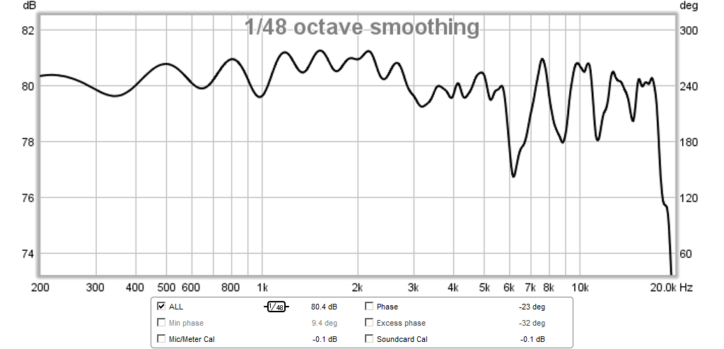

Here is the high resolution 4ms gated freq response. Not sure why there is the oscillation in the AMT response:

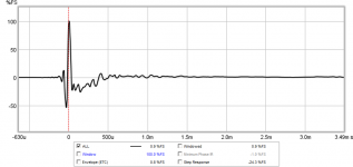

![483324d1431754089-10f-8424-rs225-8-fast-ref-monitor-rs225-10f-amt-3-way-ir.png](https://www.diyaudio.com/forums/attachments/full-range/483324d1431754089-10f-8424-rs225-8-fast-ref-monitor-rs225-10f-amt-3-way-ir.png)

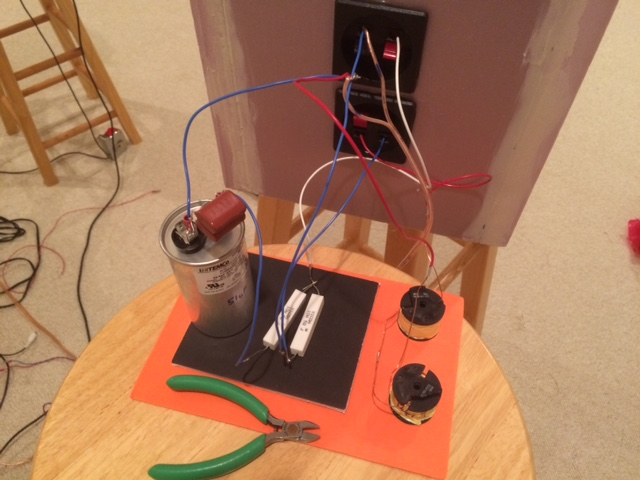

Passive 1st order BW XO test
I received my oil-filled 50uF 360V industrial motor run capacitor yesterday so I assembled a 1st order Butterworth XO per design from Byrtt: 56uF cap and 4.6R padding resistor pair for 10F, and 3.64mH coil for RS225 as low pass. I added a couple of existing 3.3uF caps to the motor cap for 57uF, and unrolled a 2.5mH + 2.5mH coil to get the 3.64mH inductor. All I had on hand were two 5R resistors. Here is the temporary XO setup outside on the back of the speaker:

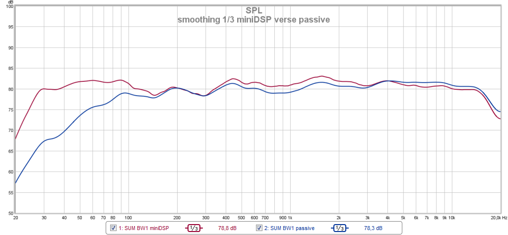

And here is the measurement at 0.5m and 0.71v (equiv to 2.83v at 1m), and below it the predicted response of the XO that Byrtt provided me using member Bwaslo's Xsim software and measured impedance curves (.ZMA) and raw frequency .FRD curves. Byrtt adjusted for the 5ohms vs 4.6ohms and had to add 3in of time delay between the 10F and RS225 to compensate for the lack of the mechanical time alignment. With the proper delay the mid range bump would go away and the step response would be better. This is very good agreement between the model and measurement:
Thanks to Byrtt for the XO design! It sounds very nice but bass is reduced of course due to no Linkwitz transform. This is where ported bass reflex would help. Well this was my first all passive cross-over and with Byrtt's help I had a chance of making it work. Otherwise miniDSP is the only way I could have done this before. The $9 oil filled industrial motor cap seems to work well and costs less than the circa $25 "audio grade" caps.
![483395d1431784025-10f-8424-rs225-8-fast-ref-monitor-passive-bw1-xo-photo.png](https://www.diyaudio.com/forums/attachments/full-range/483395d1431784025-10f-8424-rs225-8-fast-ref-monitor-passive-bw1-xo-photo.png)
![483396d1431784025-10f-8424-rs225-8-fast-ref-monitor-passive-bw1-xo-measurement-compare-xsim.png](https://www.diyaudio.com/forums/attachments/full-range/483396d1431784025-10f-8424-rs225-8-fast-ref-monitor-passive-bw1-xo-measurement-compare-xsim.png)
