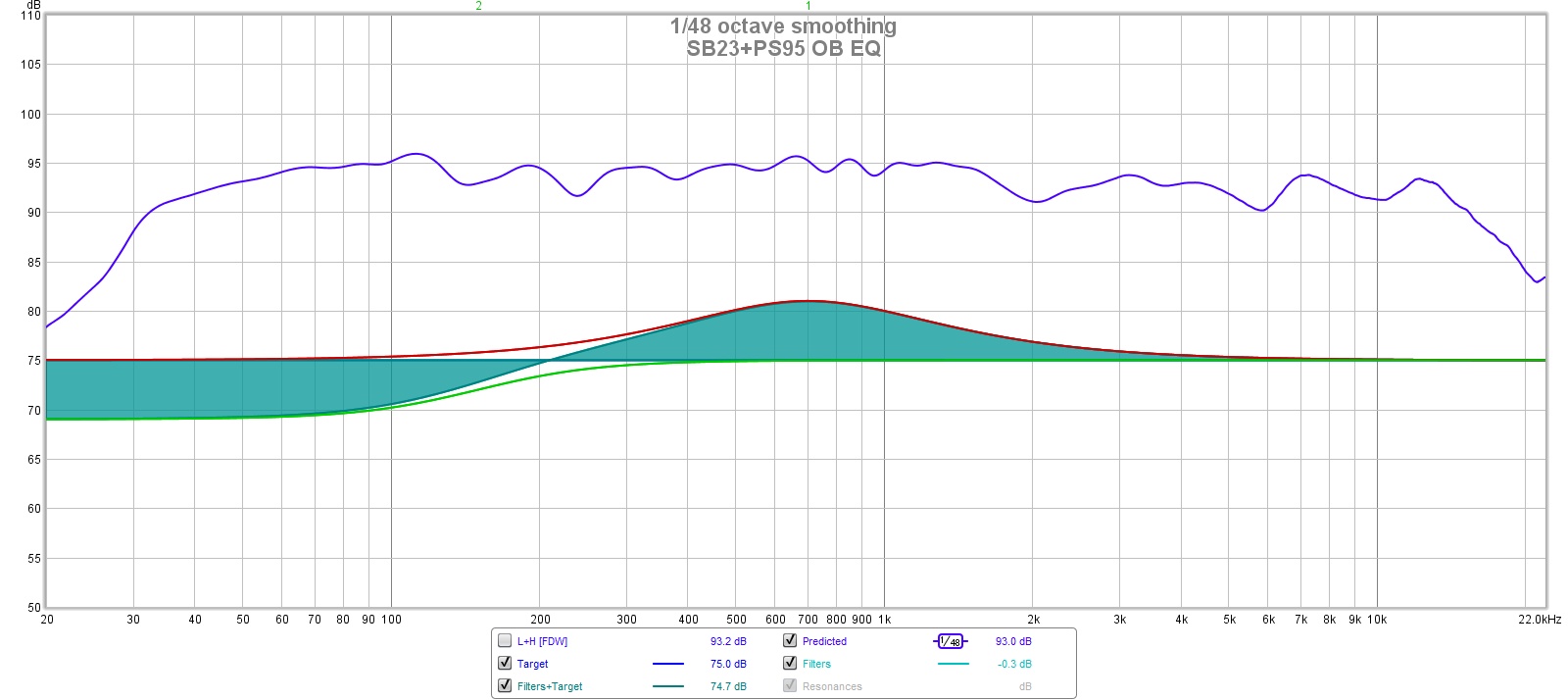

It should work fine, if you recall I ran an OB experiment using a narrow 10 in baffle with a SB23 and PS95 and usual XO then augmented with bass EQ. Instead of bass EQ, a subwoofer would do nicely. Same could be done with 10F and RS225.
10F/8424 & RS225-8 FAST / WAW Ref Monitor
EQ looked like this:
-6dB peak at 700Hz and Q=0.60
+6dB low shelf at 250Hz

OB FAST with 3.5in Fullrange and SB23NRXS45-8
It sounded very good.

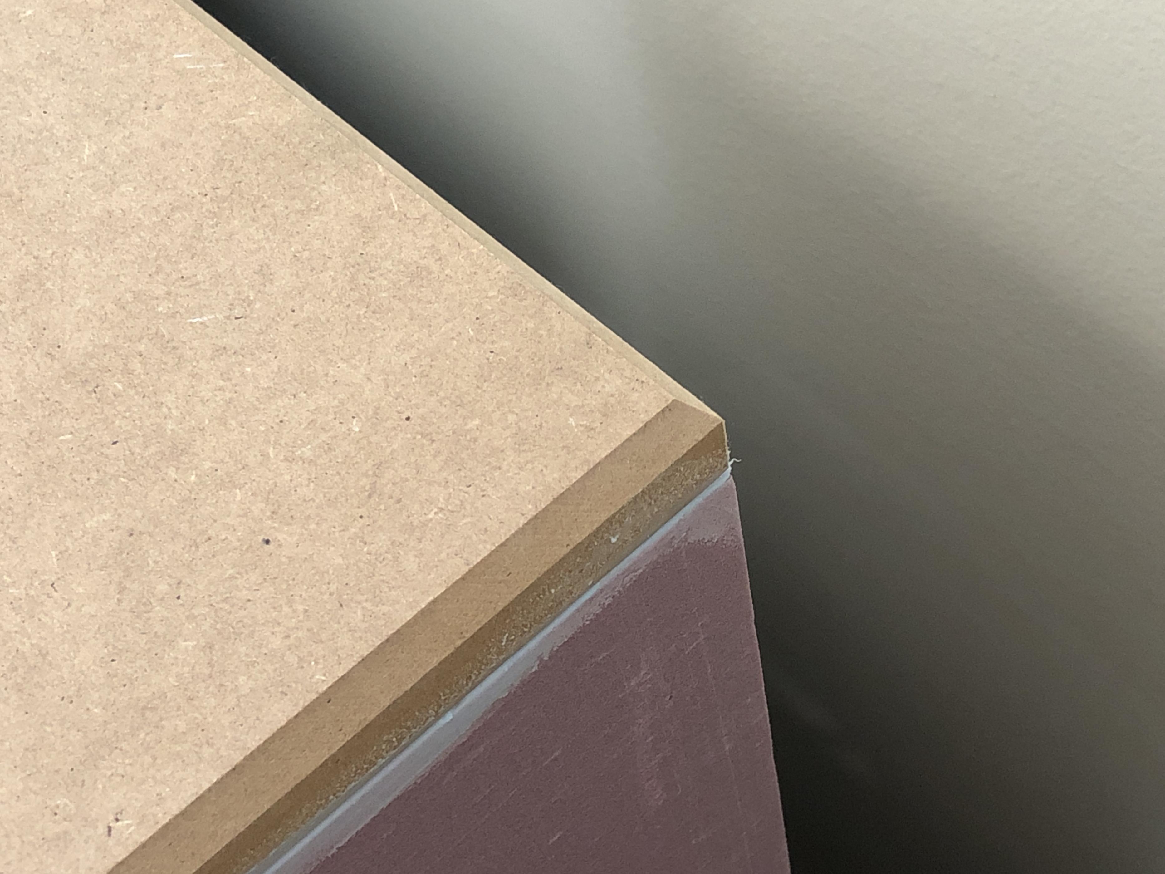

If not a round over, maybe just a 45° chamfer instead of a full 45° cross section cut. This way there’s no interference with the woofer bezel and IMO will look more pleasing than a full 45.

I think our woodworking expert might be planning on doing a chamfer of some sort. I'll show him your photo. Thanks for sending it. If anyone else has pics of edge work on 11 Ply Baltic Birch, please post them for us. I can't find any images of a 45 Degree Cross cut or chamfer. This is the closest I could find.

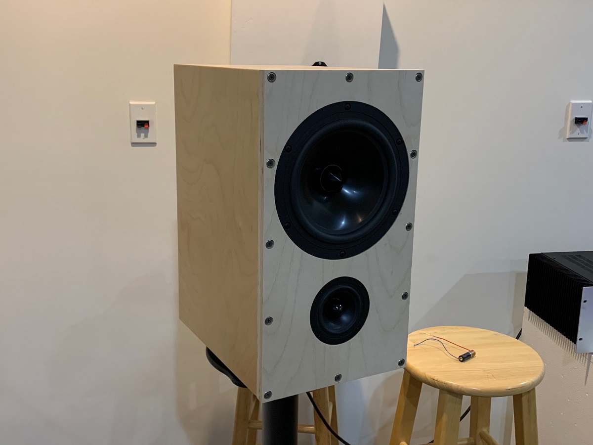

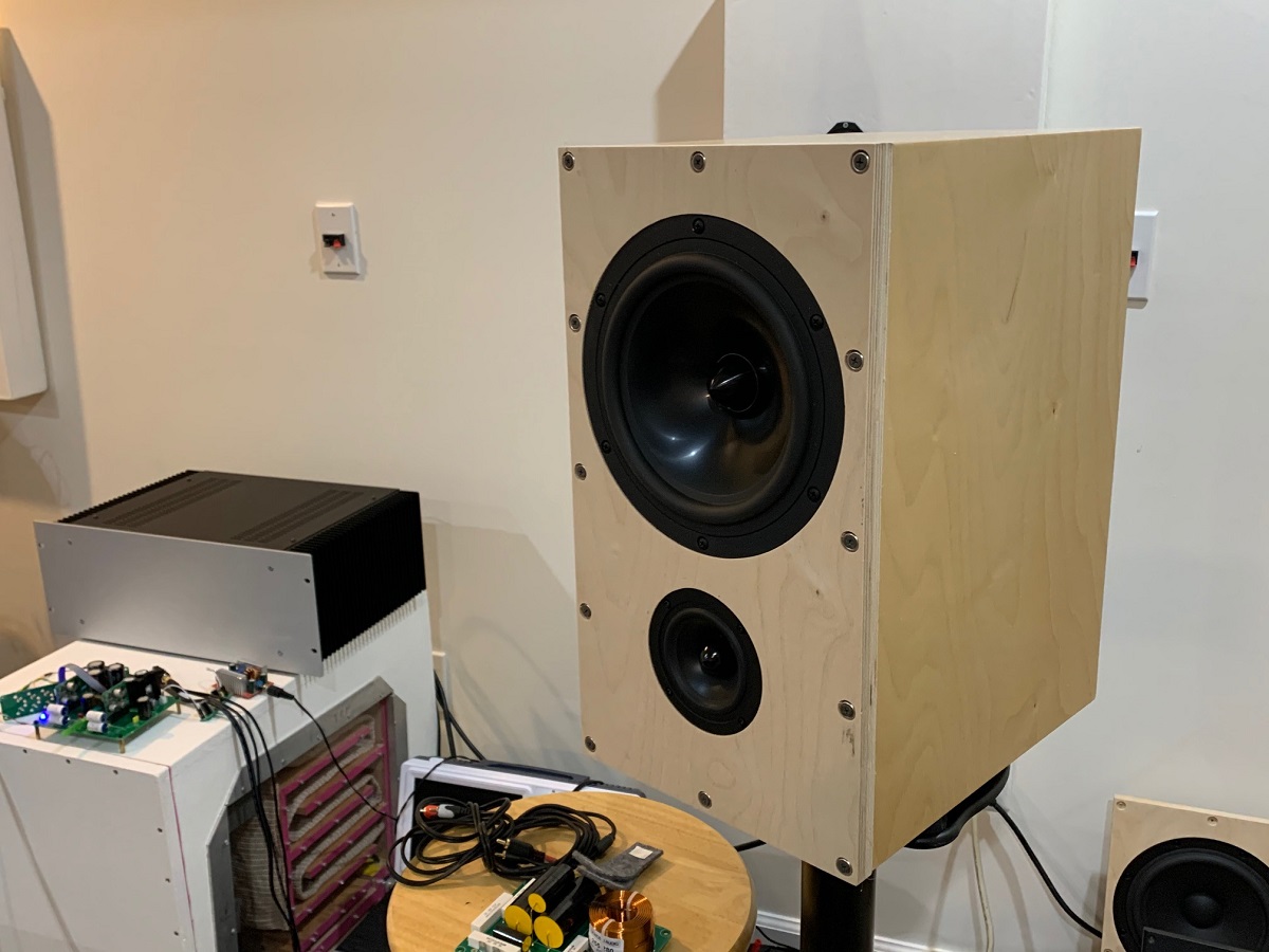

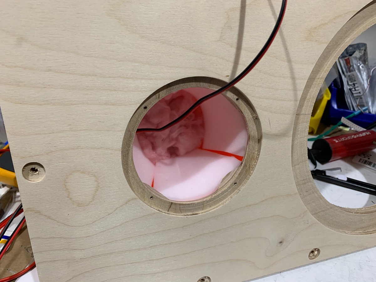

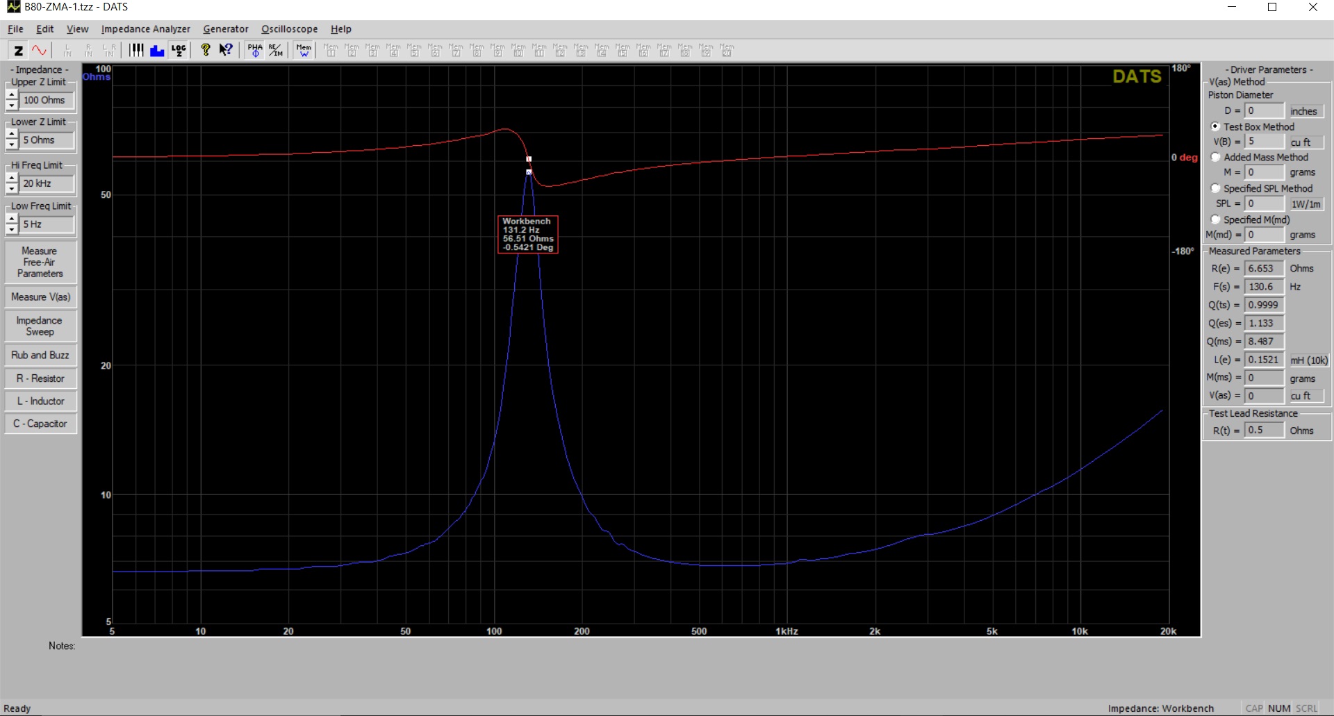

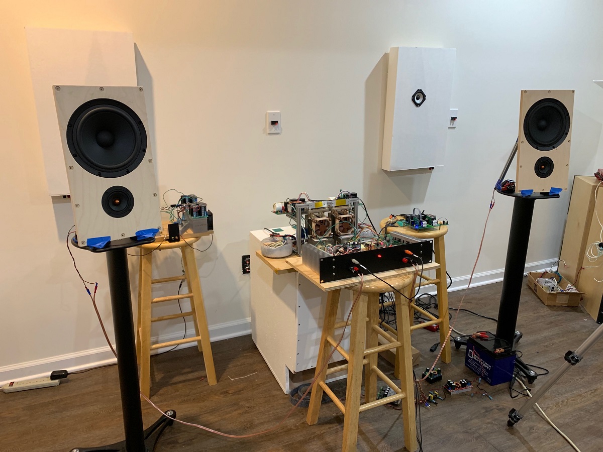

I installed the B80 into the sports cone Dagger rear chamber stuffed with fiberglass and the front 2in lined with half thickness melamine foam. I installed a parallel 10ohm resistor to R1 for a net 3.2ohm padding resistor. This should compensate for the slightly lower sensitivity of 85dB vs 86.7dB of the 10F. The new plain BB ply baffle with the two black drivers looks pretty good actually. It was nice that all the screholes lined up. This time with nickel shoulder washers for the drywall screws.
Listening to it right now, maybe 4 tracks so far. Very nice. Very similar to the 10F actually. Will take some more time before I comment too much. Also need to measure and see if the XO is still consistent.

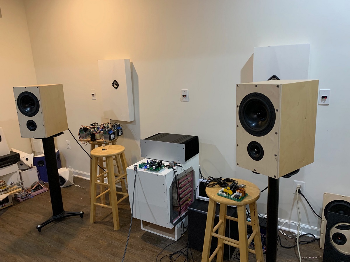

Sports cone Dagger lined with melamine foam and stuffed with fiberglass:
Left speaker:
Right speaker:
Stereo Pair:

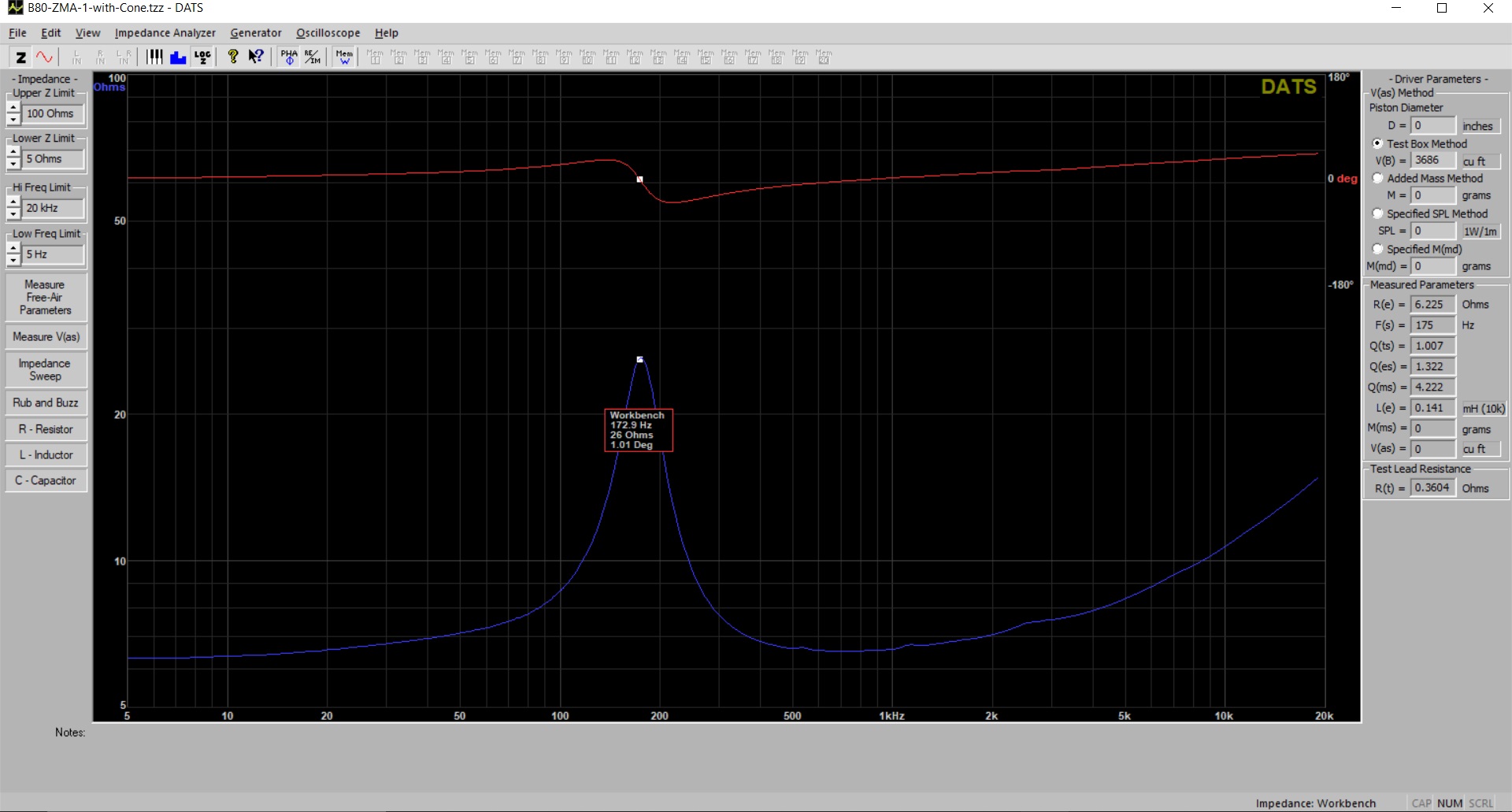

Here is the impedance sweep of the B80 driver in open air (driver #1), it has fs of 131Hz and max Z of 56.5ohms:
This is the impedance sweep of the same driver in the sports cone Dagger, now doing its job since the fs is now 172Hz but the impedance has dropped to 26ohms:
Left speaker:
Right speaker:
Stereo Pair:
