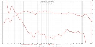

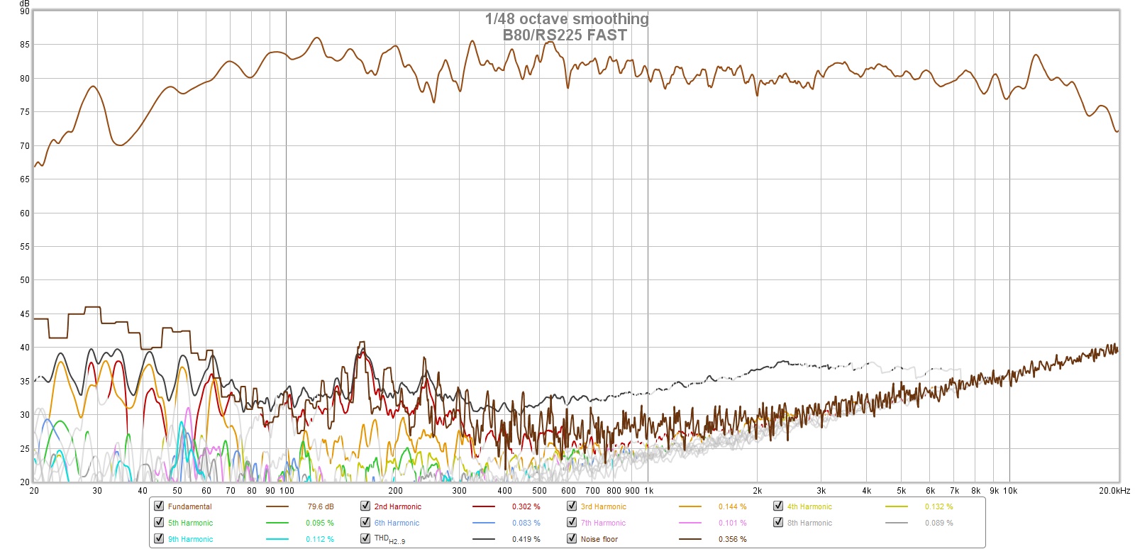

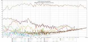

Some Measurements of the B80 and RS225 in Baseline XO (3.2ohm)
The measurements seem to indicate that the B80 works quite well in the XO designed for the 10F/8424. The phase is not quite as flat, but we have a +/-15deg variation from about 120Hz to 12kHz. These were taken at 0.5m along an axis in between the woofer and tweeter corresponding to my ear height where I sit. Amplifier used was 40w SE Class A Alpha Nirvana fed by a Sanskrit 10 USB DAC. Mic used was UMIK-1 from Cross Specctrum Labs. Data shown using 6 cycle frequency dependent windowing (FDW) to reduce effect of room reflections.

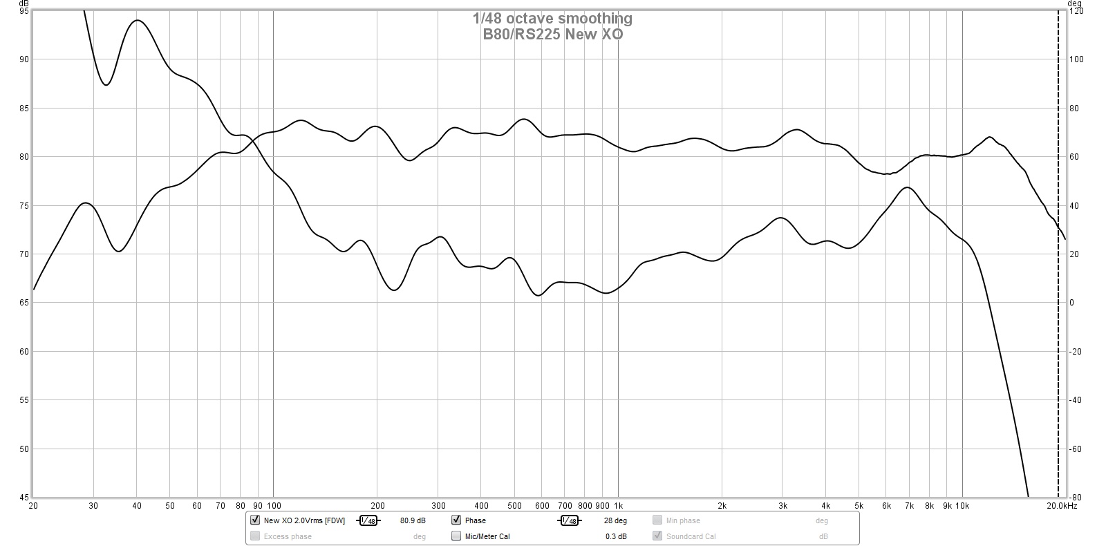

Frequency and measured acoustic phase:

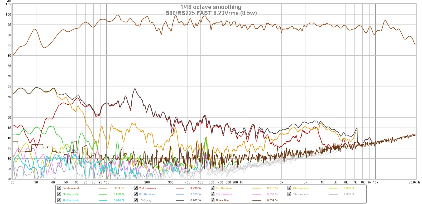

Distortion vs frequency at level of 2.0vrms:
Distortion at 8.5W (about 90dB at 1m):

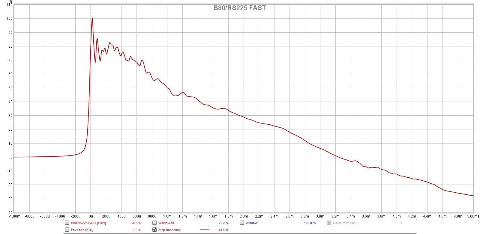

Step Response:
As I previously said that I thought the driver sounded balanced but could use a little less padding seems to all be verified by the measurement. I will try reducing the amount of attenuation.
But in general, I think that this is actually a very good performer in a crossover designed for another driver. For the above data, R1 was modified to 3.2ohms by adding a 10ohm in parallel with existing 4.7ohm R1.
Step Response:

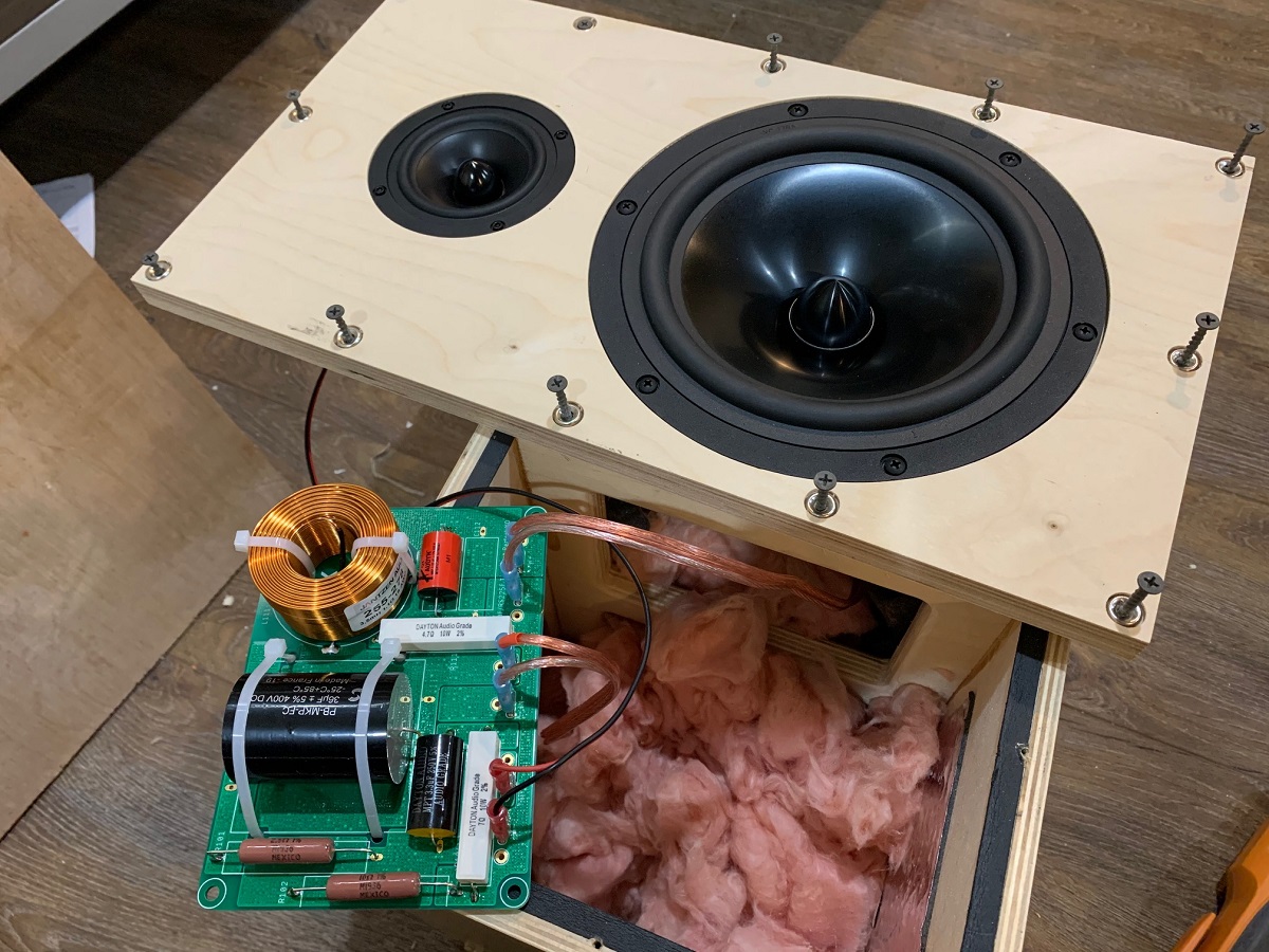

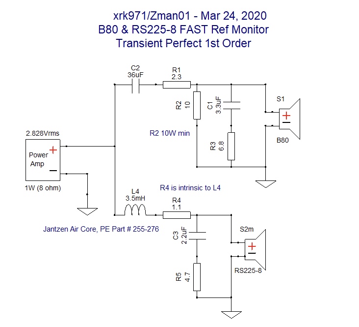

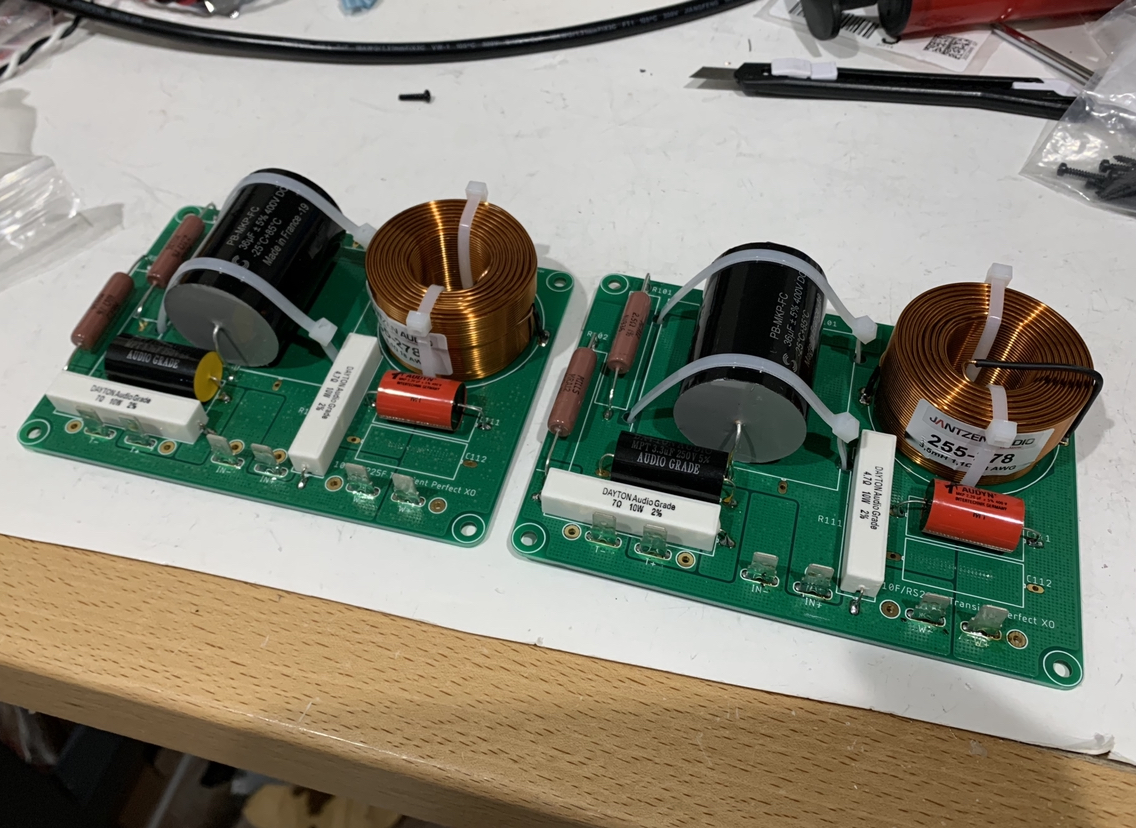

I am thinking of trying out this crossover for the B80 and RS225. It’s got a smaller capacitor and lower value inductor. The predicted phase seems a bit smoother. My parts all arrived and just needs to be assembled on the new XO PCBs. This XO was tweaked with Zman01’s help.

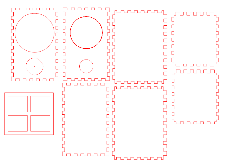

I've acquired the drivers and crossover components for these and have started my sealed design with a finger joint box that will be laser cut. I'll be using 12mm baltic birch and will add a .25" thick walnut facade to the baffle that will allow the drivers to be flush. I know that XRK spec'd the baffles to be 10" wide, but I had to add another .5" to allow for the walnut baffle to not be too thin around the RS225. My outer dimensions with the walnut baffle will be: 10.5" W x 16.5" T x 12.25" D.
Here is a screenshot of the pieces to be cut:
10.5in will be fine, looks like a nice cut sheet. Snap together panels - very cool. Interesting look that’s for sure.

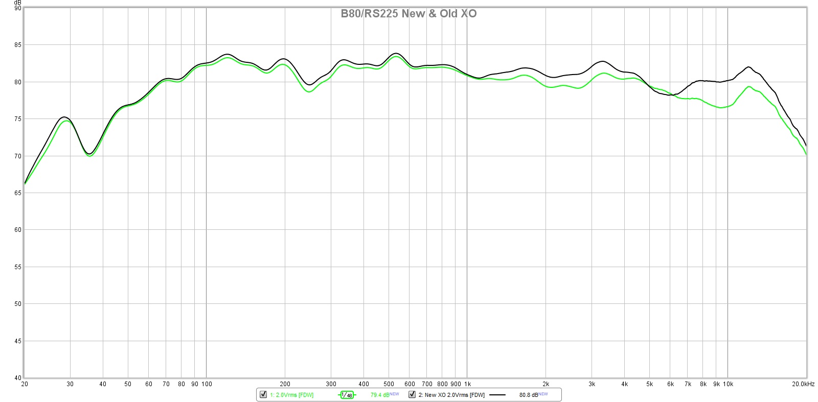

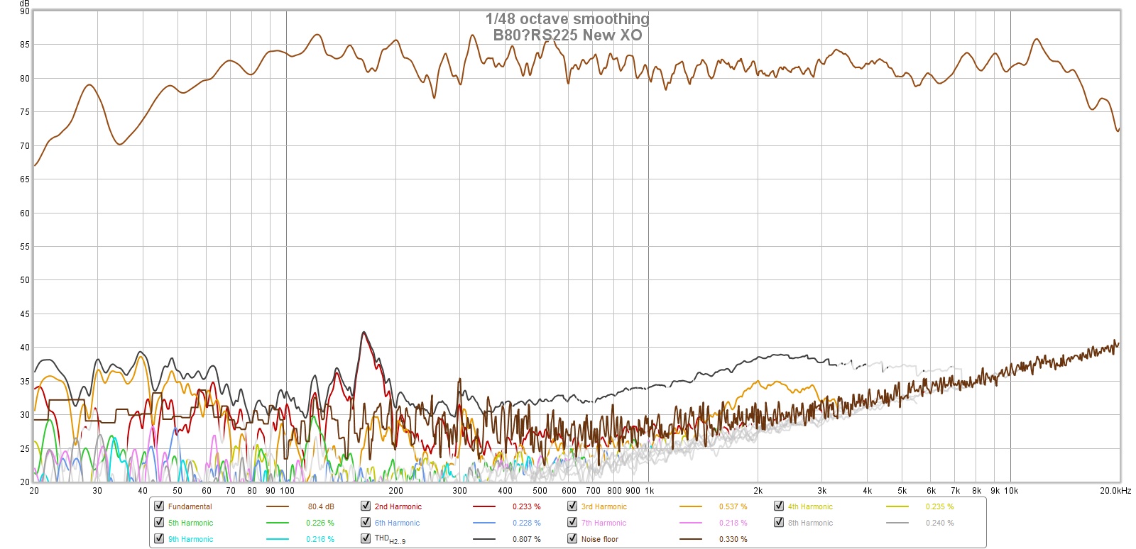

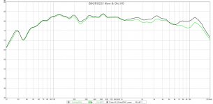

Here are the new measurements vs the old. Very similar - a bit more of a lift in the highs. Not sure why the shape is so different though around 9k-10k. The phase is not as flat, now within a 40deg band vs 30deg band. However, listening to it, the increased presence around 2k is very nice, and the upper registers sound about to be the perfect balance now.
New (black) old (green) frequency response:

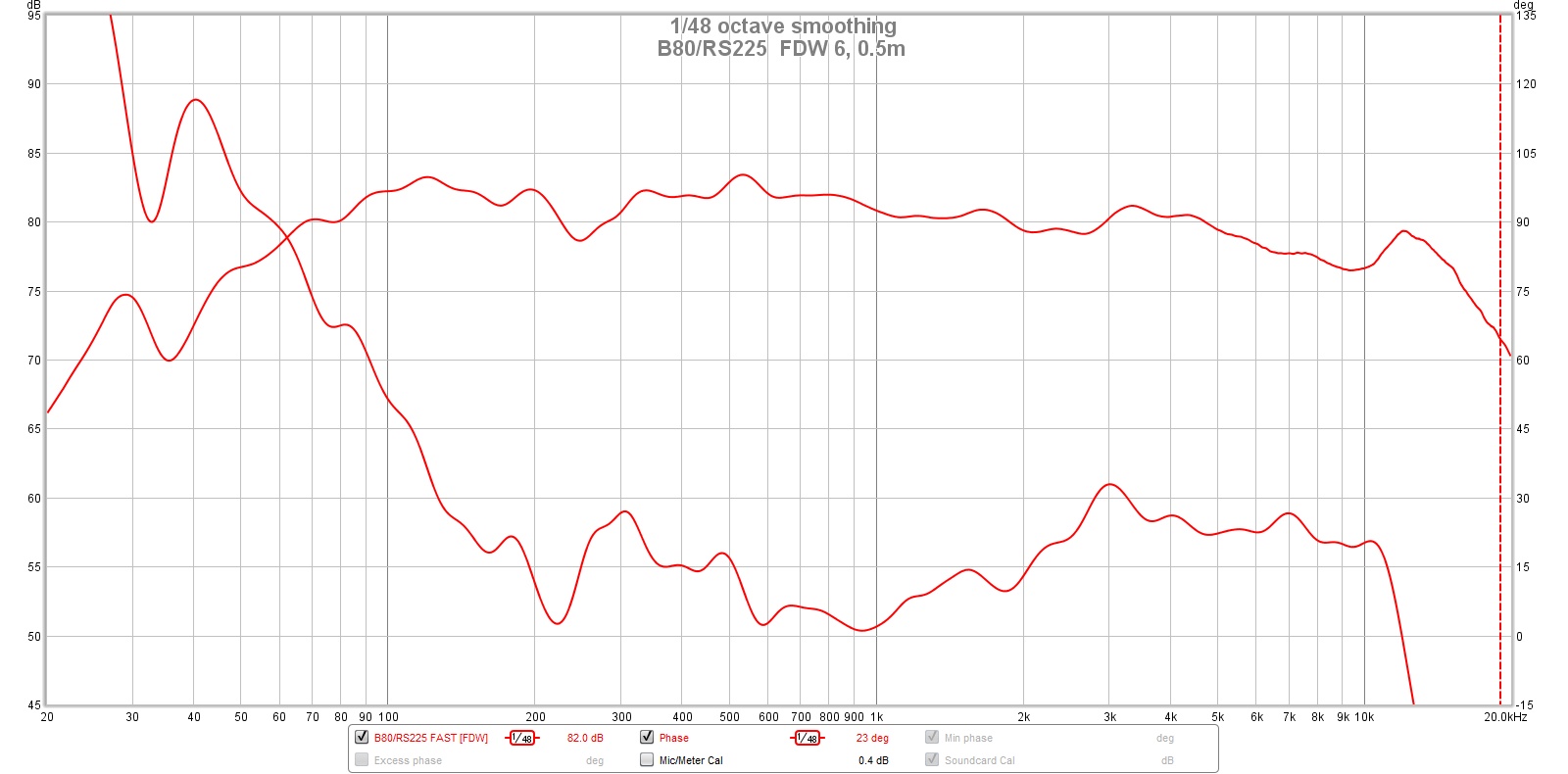

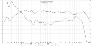

Measured frequency response and phase:

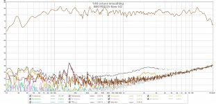

Measured distortion at 2.0Vrms:

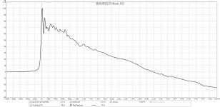

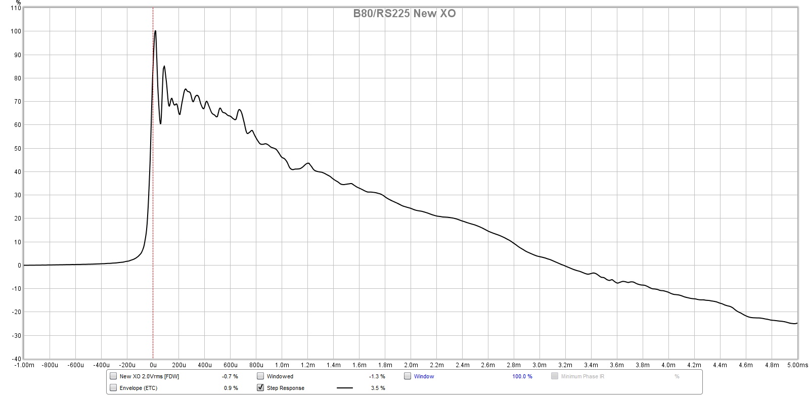

Step Response:

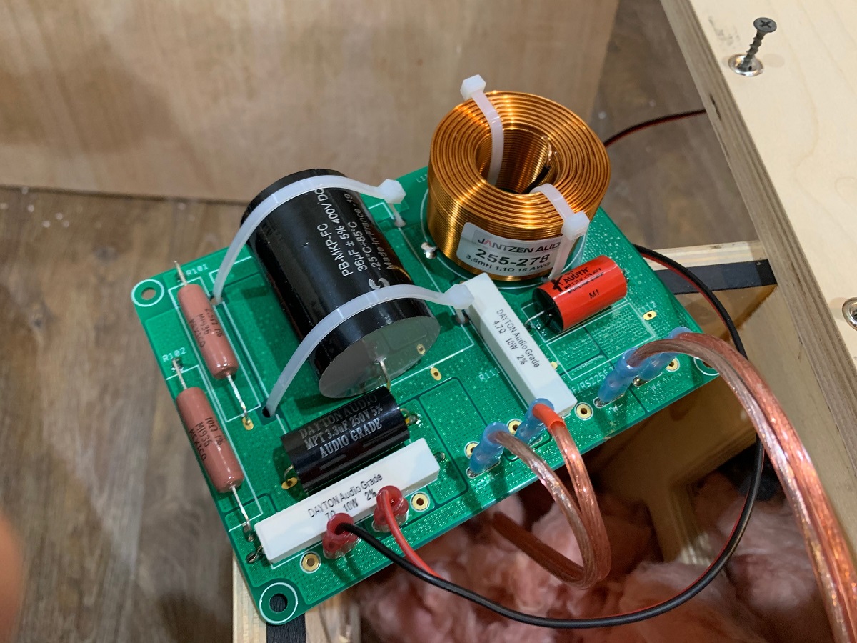

Installing the new XO board:
Closeup of the new XO board with all Faston tabs connected:
Will listen some more and give assesment later after a lot more time with various genres of music.
Step Response:

I am very much enjoying how this speaker sounds with the B80. My initital impressions that the sound was very balanced but could use a little more emphasis in the upper registers was confirmed by measurement, and the softness of the treble has been resolved with this modified crossover. Although I wonder if using the stock XO for the 10F/8424 with less resistive padding (ie., replace R1 with 2.5ohms and R2 with 10ohms) would have had a similar effect. there is a bit more 7kHz to 10kHz emphasis that is offered by using the B80.
Subjectively, what I am hearing appears to be more definition in the attack of notes, and this is not just the treble, it extends to all the octaves. But because the frequency response is flat and balanced, all genres of music play equally well.
The usual things like soundstage, imaging, clarity of highs are all great. The midrange and vocal presence feels very crisp and clear, but perhaps less refined than the 10F - which is "glass smooth". I am not complaining though.
All of my familiar test tracks sound great - perhaps on same level as the 10F/8424 - and quite remarkable for a driver that costs about half the price. The B80 is very well made with a cast aluminum frame and nice black aluminum phase plug that matches the look of the RS225. The phase plug seems to have a narrower polar response in that I feel that the sweet spot is maybe a tad less than with the 10F, which has a fiberglass dustcap of same material as the cone.
In short, very highly recommended driver sibstitute for the 10F in this speaker. I think that stock XO works well and I suspect changing R1 to 2.5ohm and R2 to 10ohm will work just fine. If you want a little more high end definition in treble from 7k to 10k, then use the new XO for the B80.
