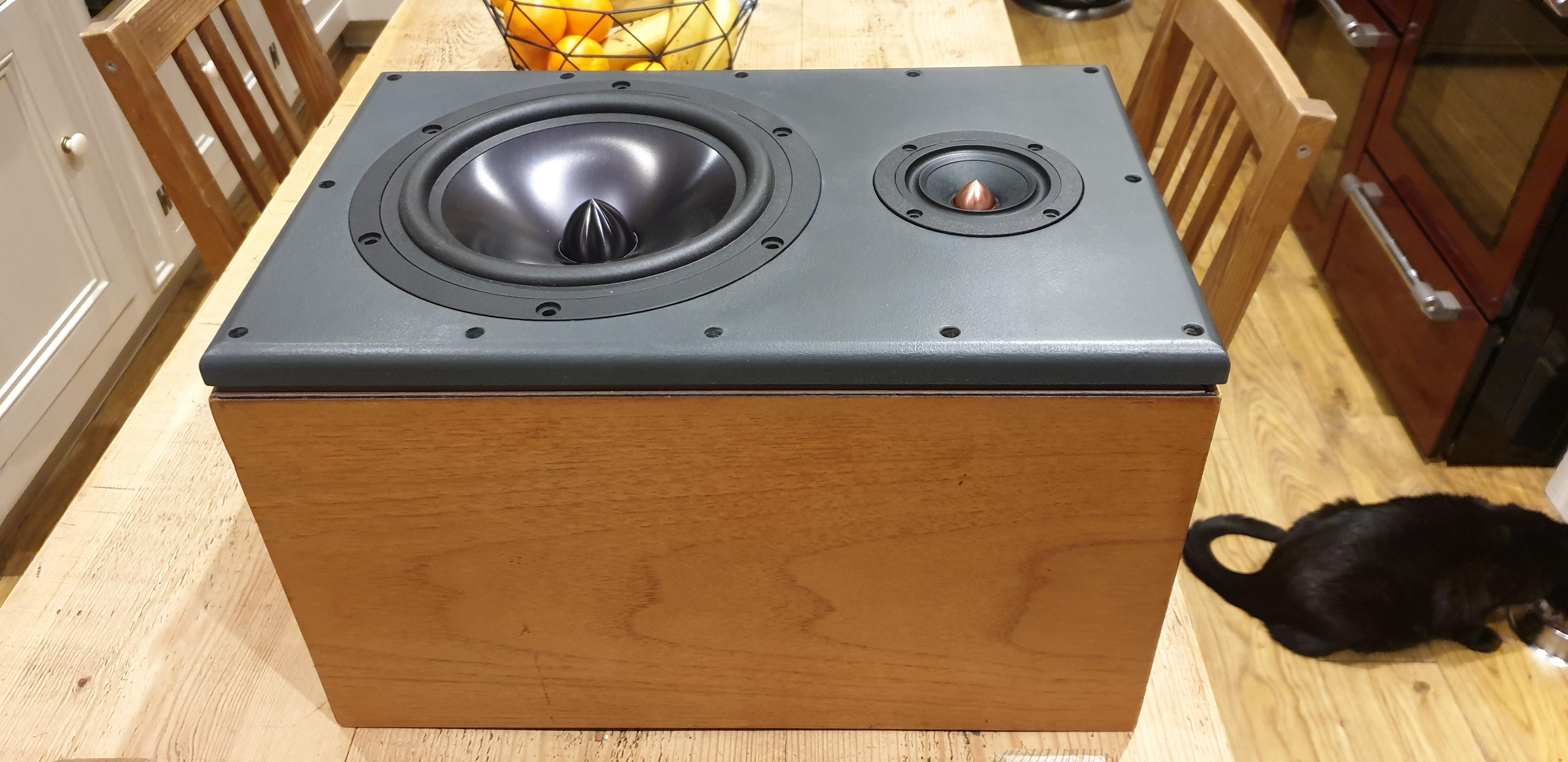

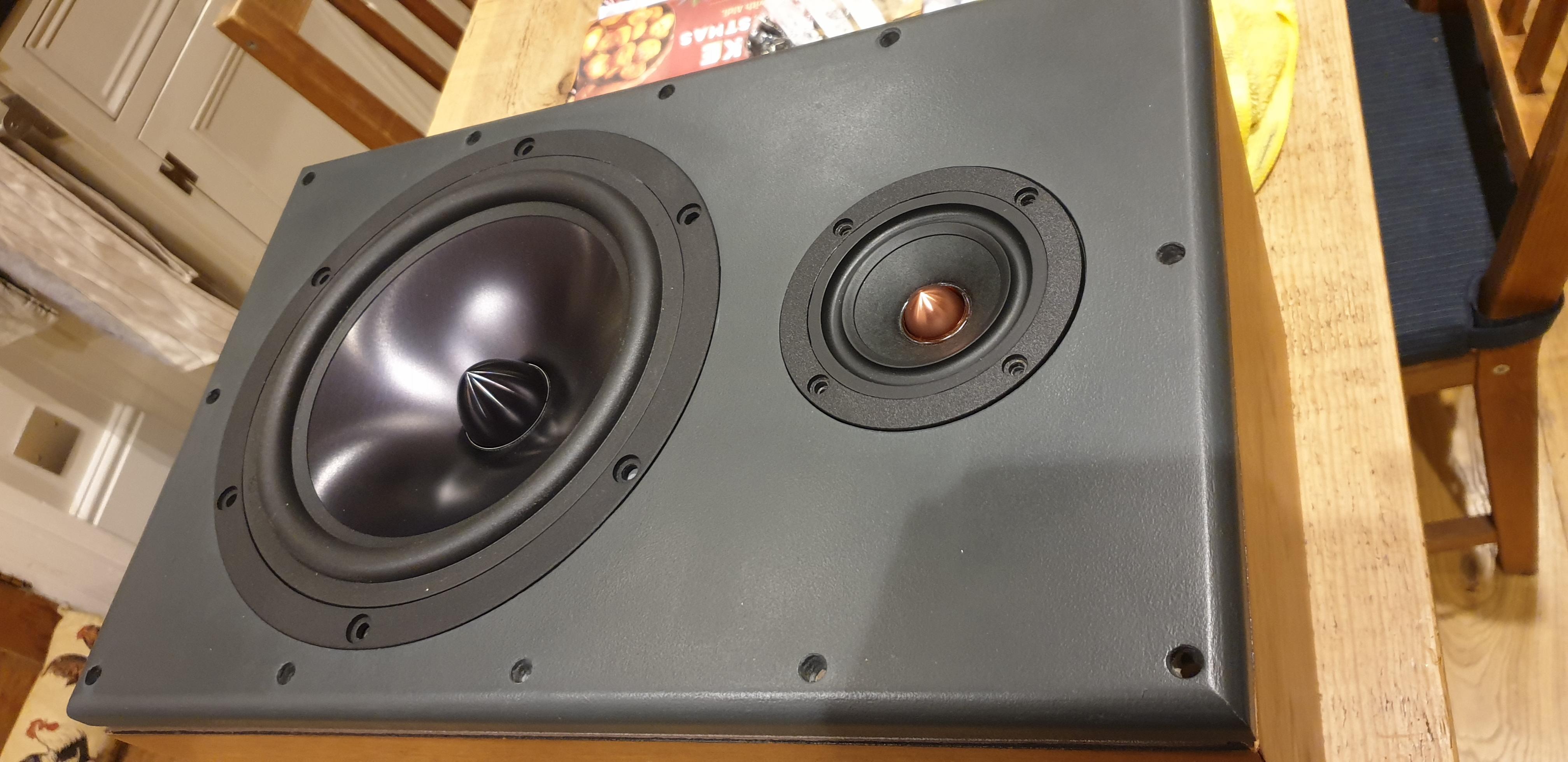

Annoyingly have done my woofer rebates a little too tight...bugger!
Spent a good while trying to get a good finish on the baffles which I have now done. Using a gloss roller with water based emulsion. It marks easily though so I may wax it.
Now how to relieve the cutouts a bit.!
Very beautiful work! Try a dremel tool to make the rebate wider. This has happened to me before. You did not do a test for before paint? Or the paint made it too tight?

Thanks X...they were a snug fit and I tried to avoid paint in the recessed but the slightest amount and it is too tight. I could maybe draw them in with the screws but didn't like that idea! I'm getting there with good old fashioned sand paper.!

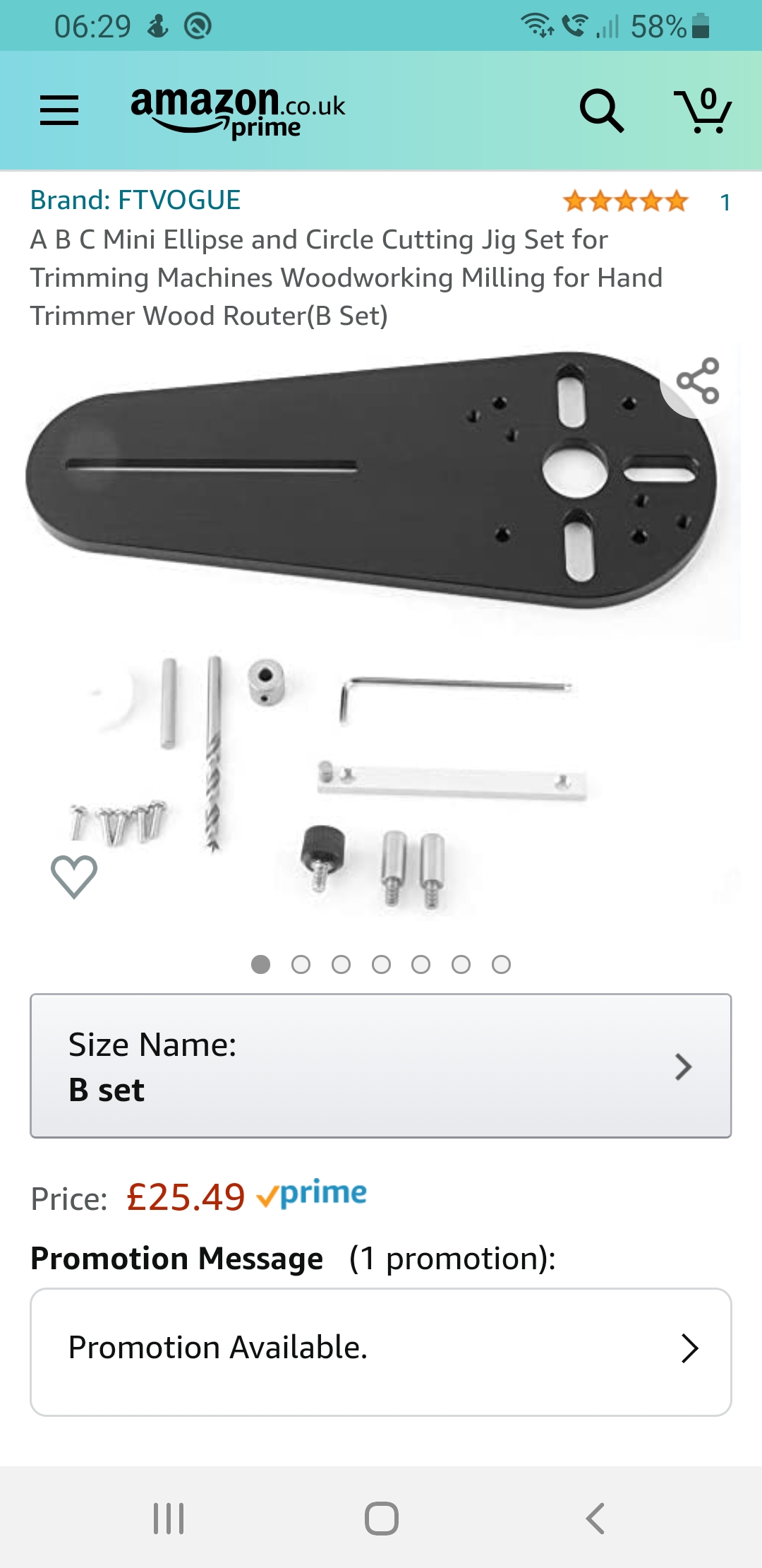

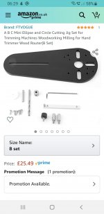

Thanks again for the tips and input... ah I just need to find a compass router jig here in Europe, have the drivers and chosed a ply cabinet cause of the wood looking whilr still have some foam I keeped from your horn project with the 10F ! Great little driver, I love it, neutral my ears says 🙂

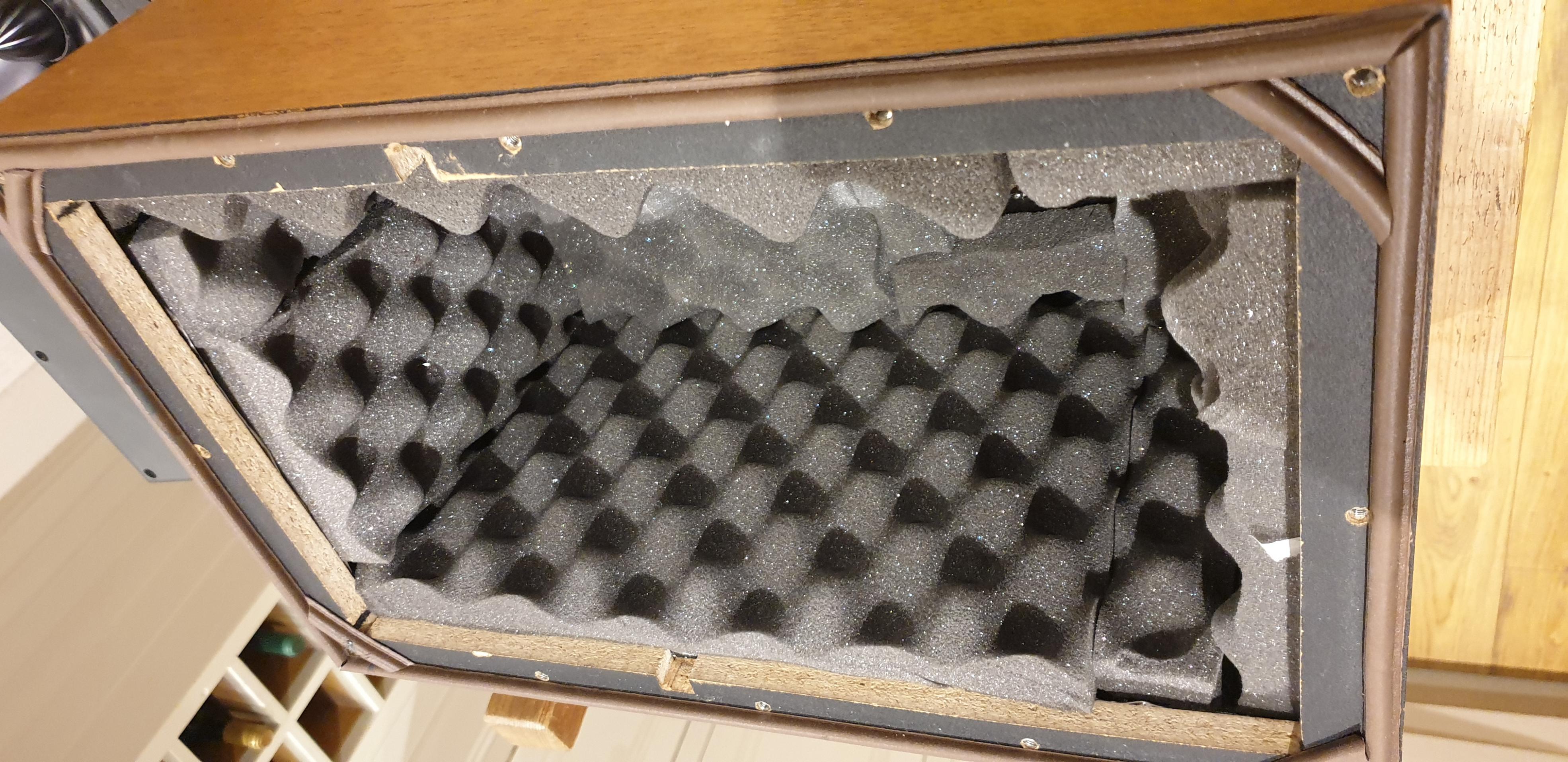

And some more progress on my build. Have wasted a lot of time on paint finishes which is annoying. I have also made some additional rear panels which will be sort of cld as I will stick them on with butyl. These enclosures like many 1970s and 80s speakers have a recess in the back which will take a layer of butyl and 6mm MDf quite nicely. And so will stiffen up the rear panel without loosing me any interior volume.
Traffic cone is mounted and sealed....I think.! Will test with the woofer cone press test.
I'm hoping my gasket for baffle sealing won't fully compress before sealing the air to allow a degree of isolation from the baffle into the box.
Other than trying to find room for the crossover in there I am working my way through. Would like them done for Christmas but it isnlooking doubtful!
