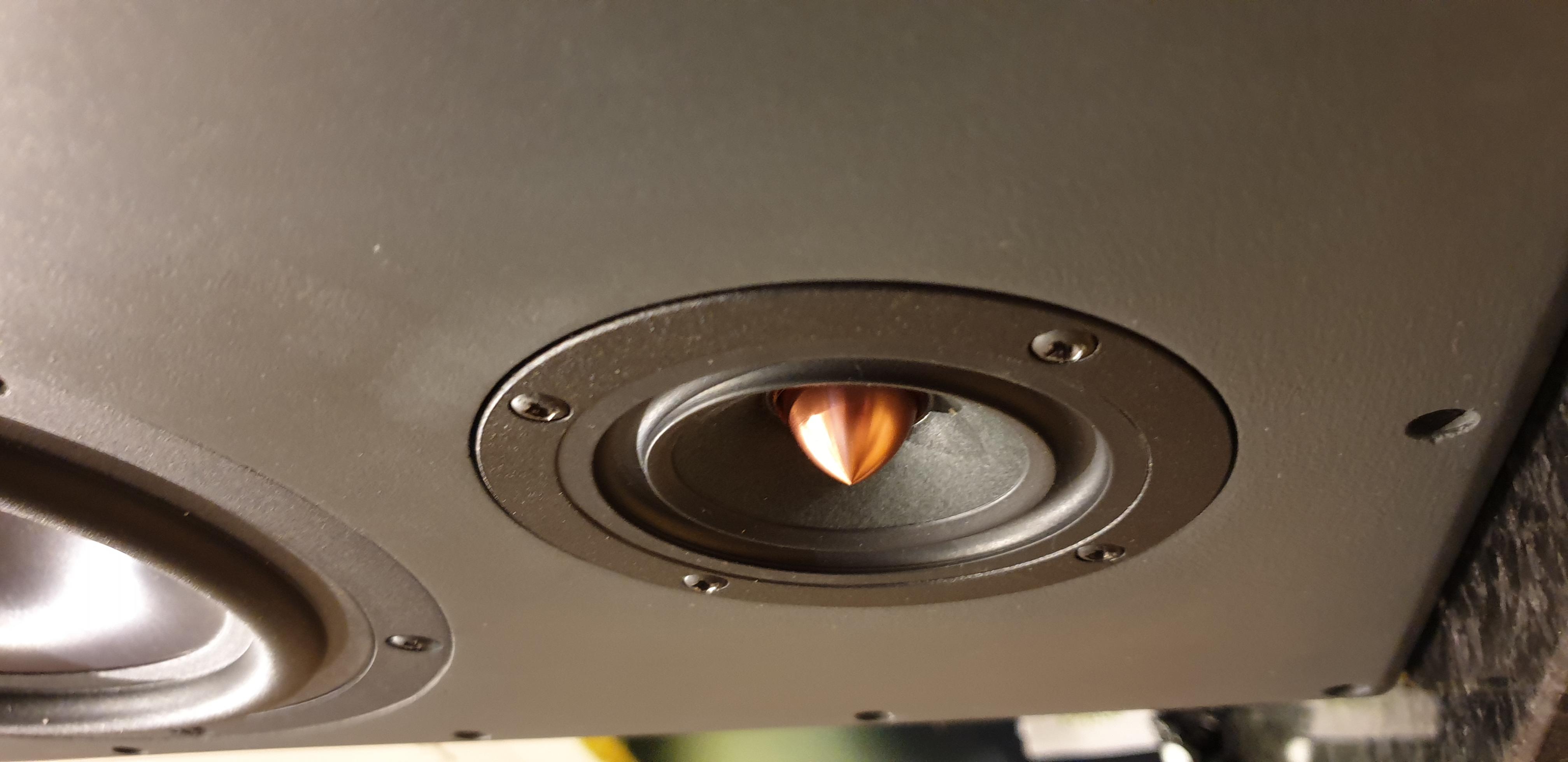

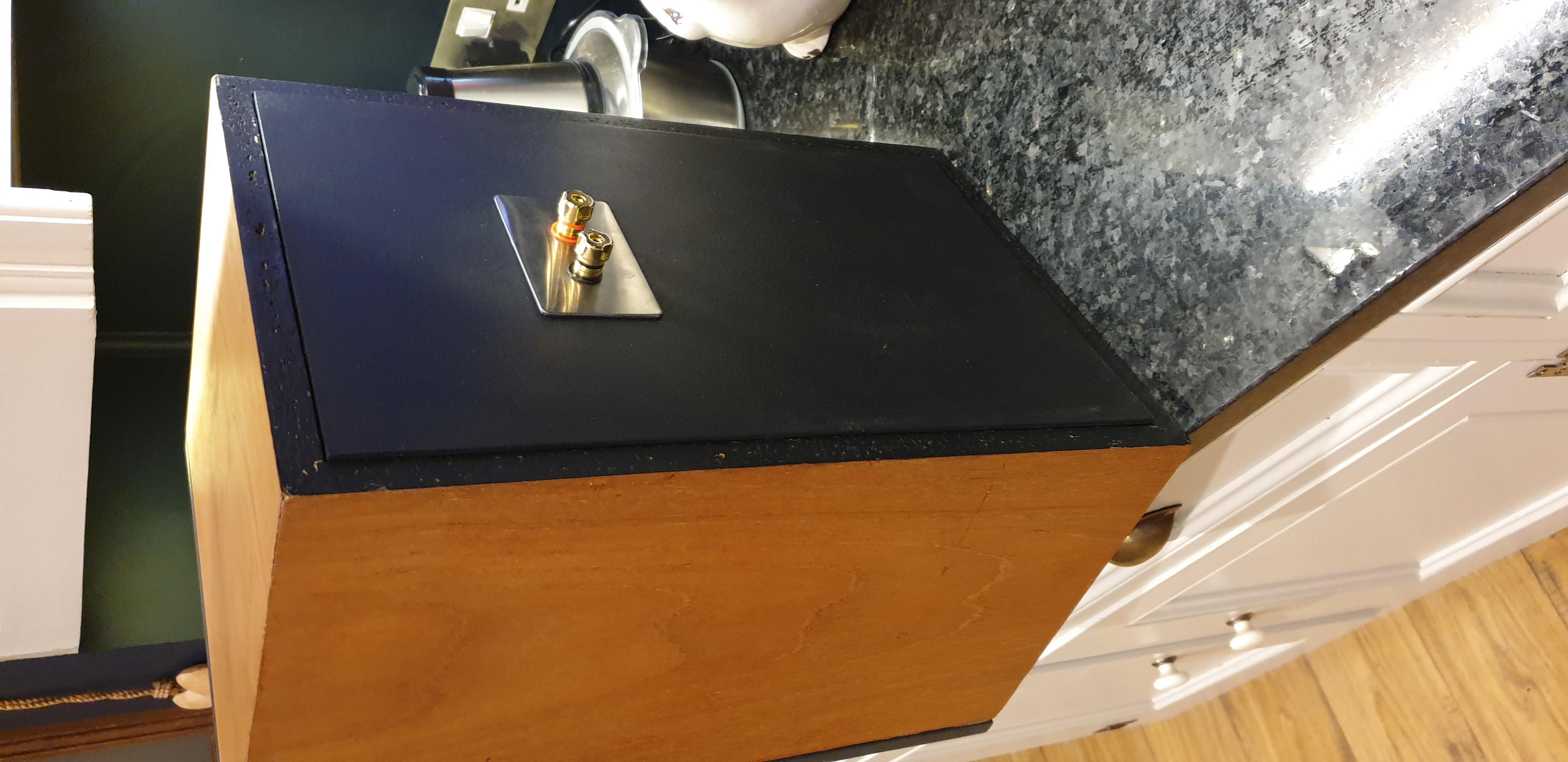

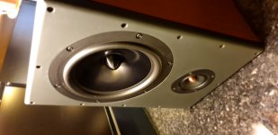

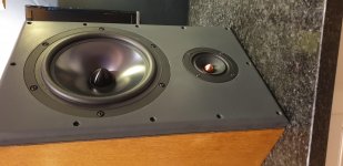

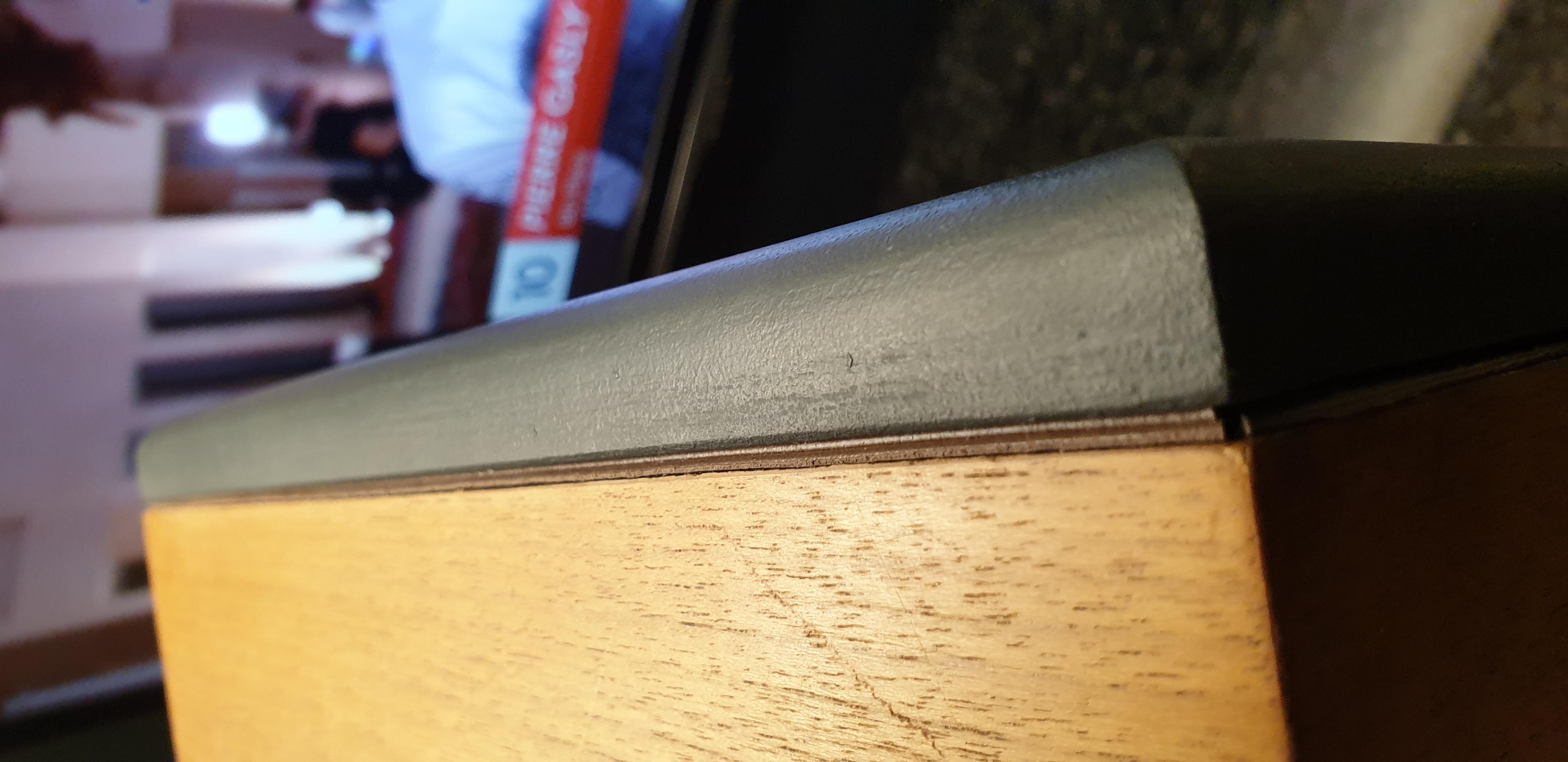

One is finally built! Not tested yet and work continues on the 2nd.

Plugged the sole one in last night replacing one of my re purposed Leak boxes SB17/DA25. It is a lot less efficient so it is hard to hear it over the other channel but it is definitely working as it should! I was sweating it a bit as the XO is buried in there under the dagger and it is a baffle off job to get to it. Hopefully I am happy with the padding on the HF side.
Taken a measuremt of 900mm to centre of the RS225 and that is about bang on the height of my tabs sat down...so that's good!
X in your above post you are referring to a 2700Hz Xo but aren't we at 900Hz with these?

These speakers are indeed less efficient than many single fullrange speakers. If using PS95-8, sensitivity is 2dB less than ScanSpeak 10F I think.
Padding circuit probably closer to 3.3ohms/6.8ohms vs 4.7ohms/4.7ohms. But your listening preference or a measurement is best to tell.
