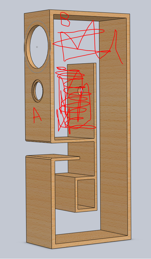

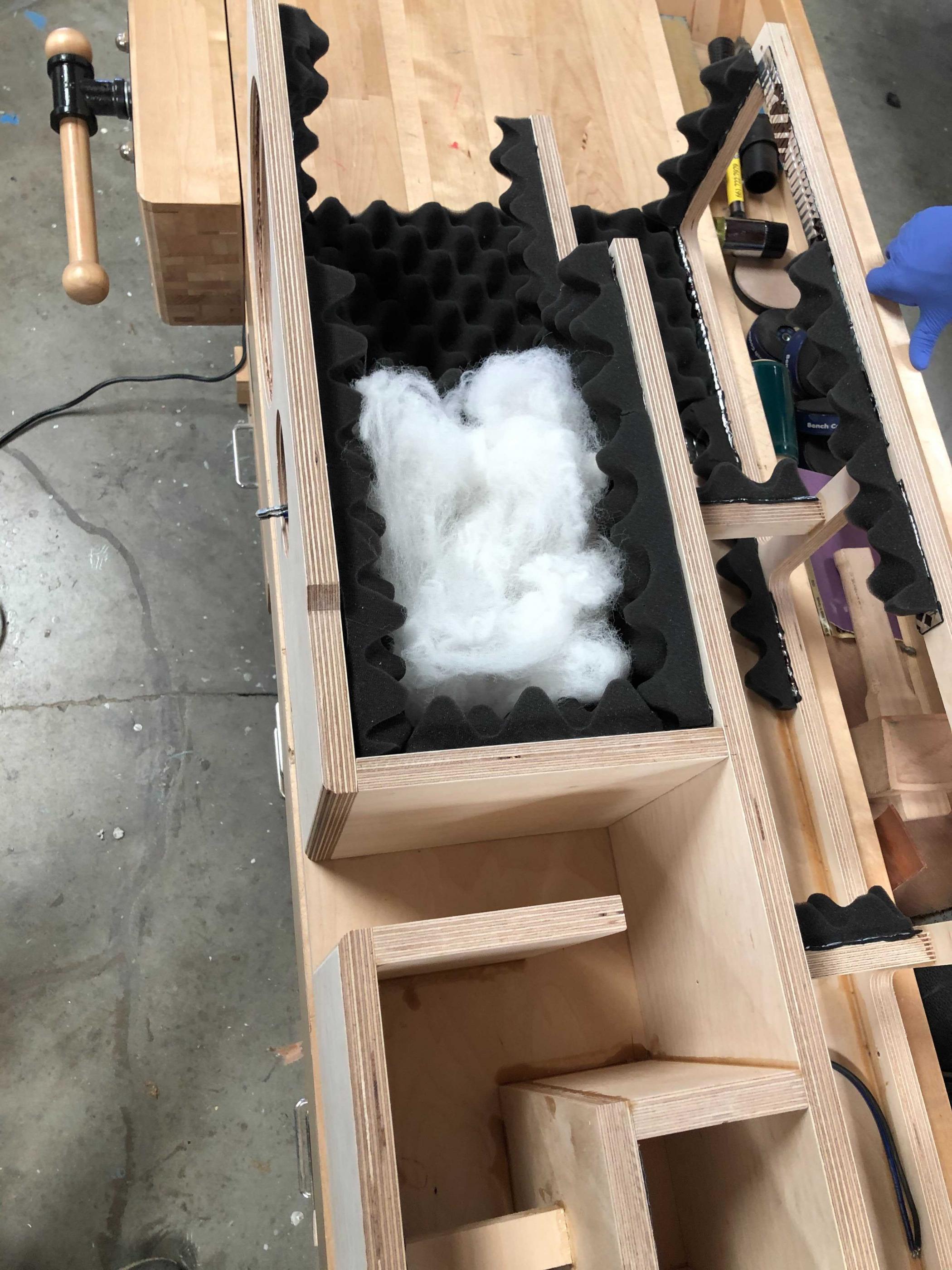

I have stuffing in the closed end up to the woofer, then a small loose amount right at the top of the turn. The rest of the line is empty except for eggcrate foam lining. Adding 5x more stuffing at the top hairpin essentially killed the bass from the TL. So you can really adjust it exactly from 0 to max.
Hey XRK, I'm a bit lost as to where you're describing, do you mean like this? A being mildly dense, then changing the amount at B to tune bass?

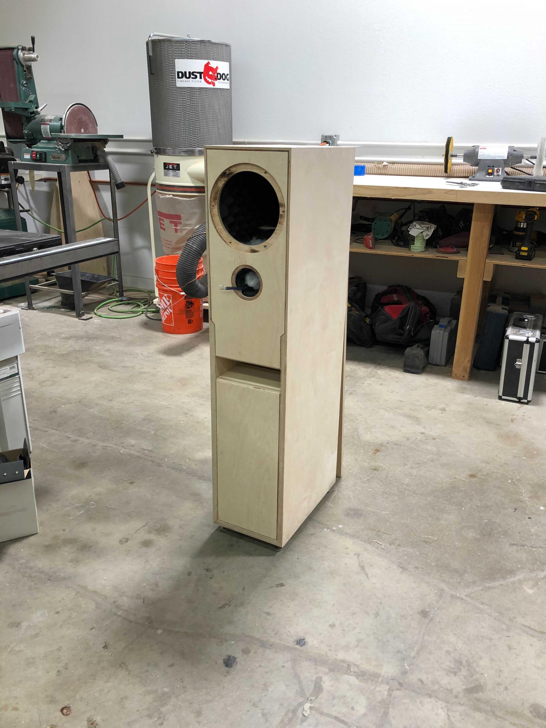

Ignore the above, I figured it out lol. I've now built 1 speaker (still need to finish in poly/mount the XO) but got it fired up on my (mostly working) FH9HVX and it sounds truly phenomenal, so much detail with a punchy bass (made me realize a bunch of my playlist songs are mastered poorly lol)

Super wood working skills, AS8912! Glad it is sounding great so far. You listened to to without a XO? I like how you added the brace as part of the inner panel cutout.
Yes, tune at B and can also add some at bottom turn. Very loose there.

Thanks! It has the crossover, it's just resting on the foam vs actually mounted at the moment. The back brace is nice, it makes assembly easier, but I was concerned about the volume reduction but the speaker sounds so good I won't think about it. As far as stuffing is concerned I'm running with only some in A as the photo above shows, and nothing else haha. I love the power and clarity of the bass from this thing.

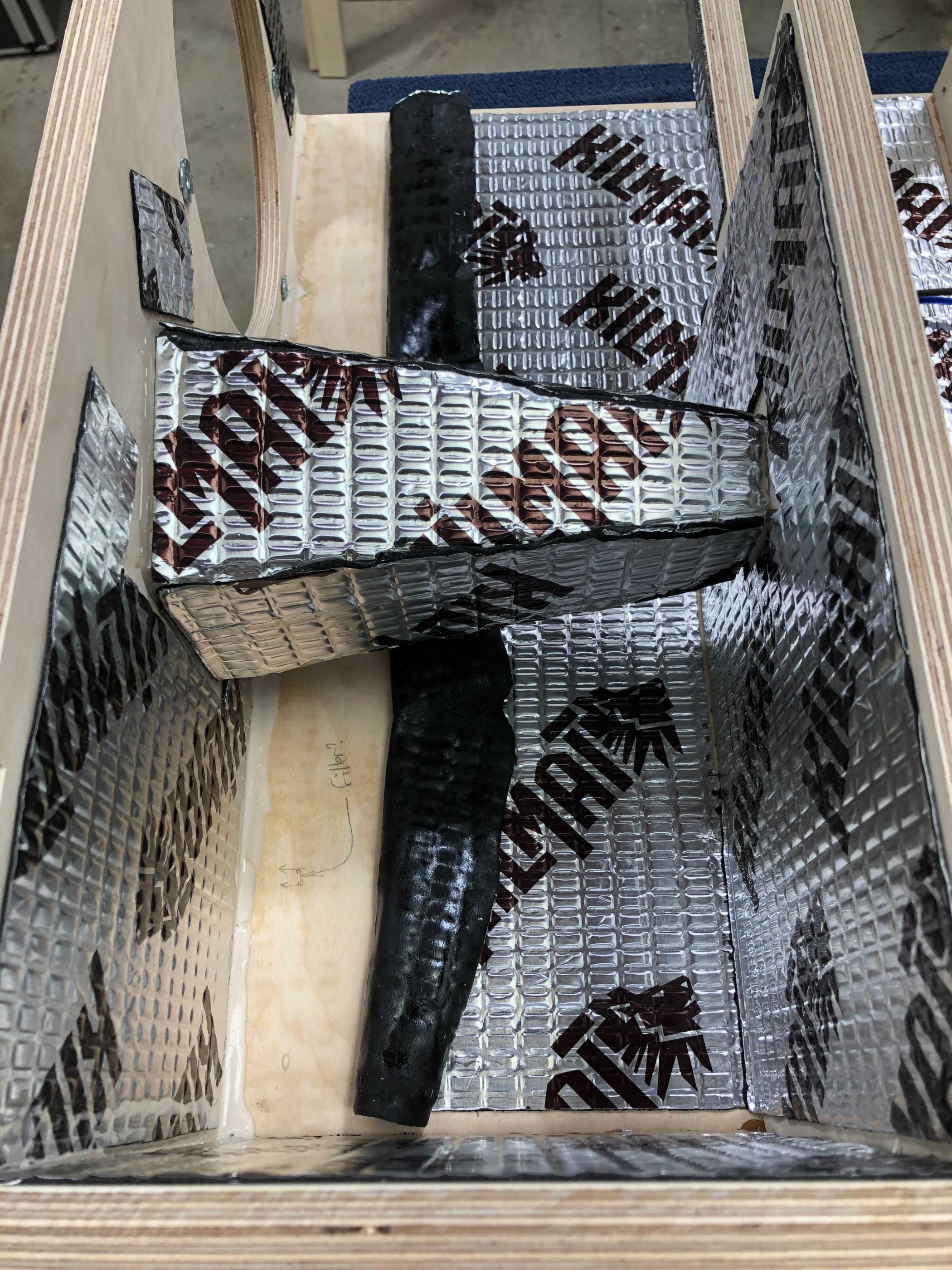

Awesome, great to hear about the volume reassurance. The 10F chamber is sealed at the back (foam core cap to the dagger, and some sound damping material over the top, the cable is sealed too). It's a 5 sided foam core dagger as I saw that you suggested that shape a few times on this thread.

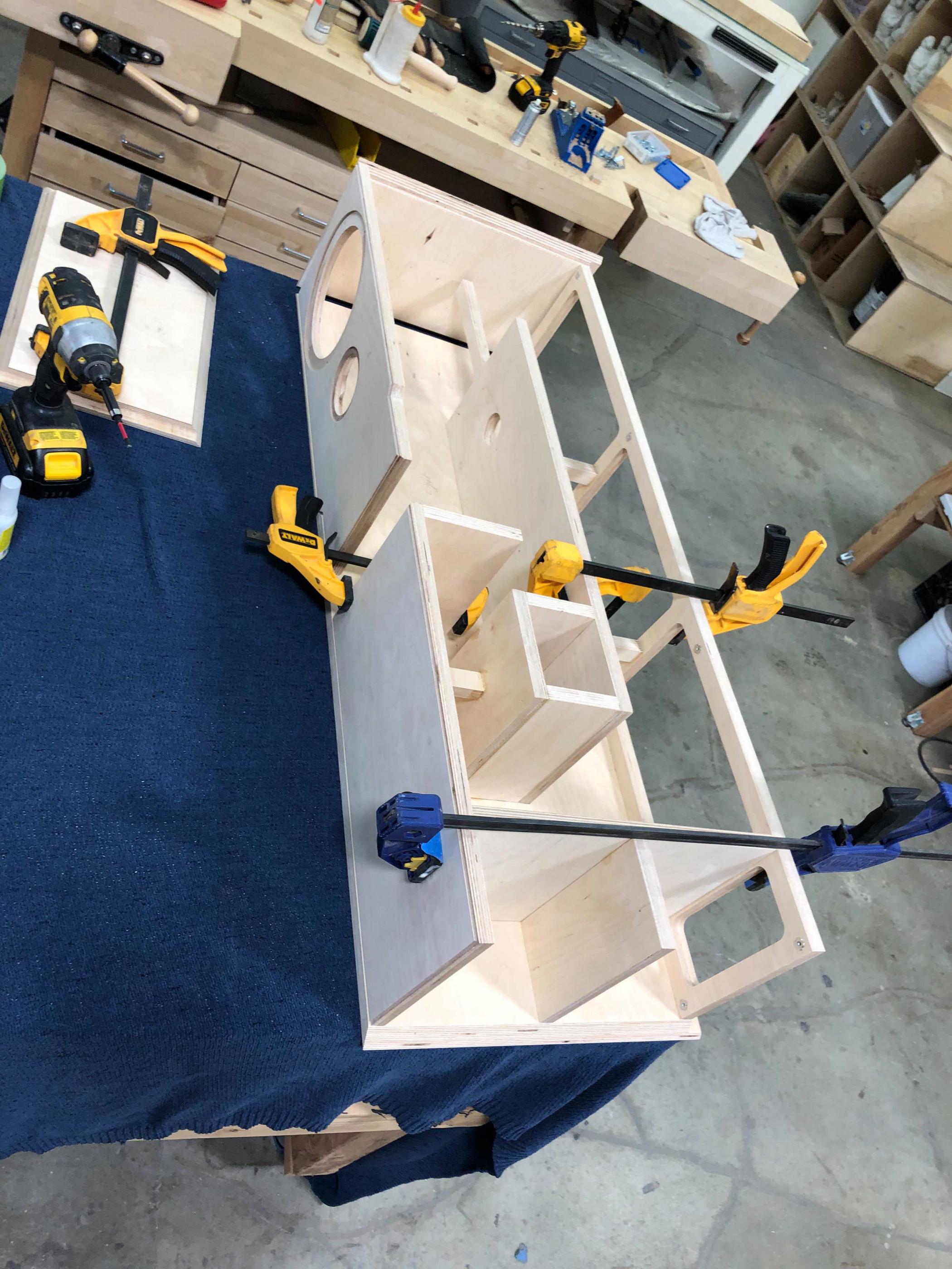

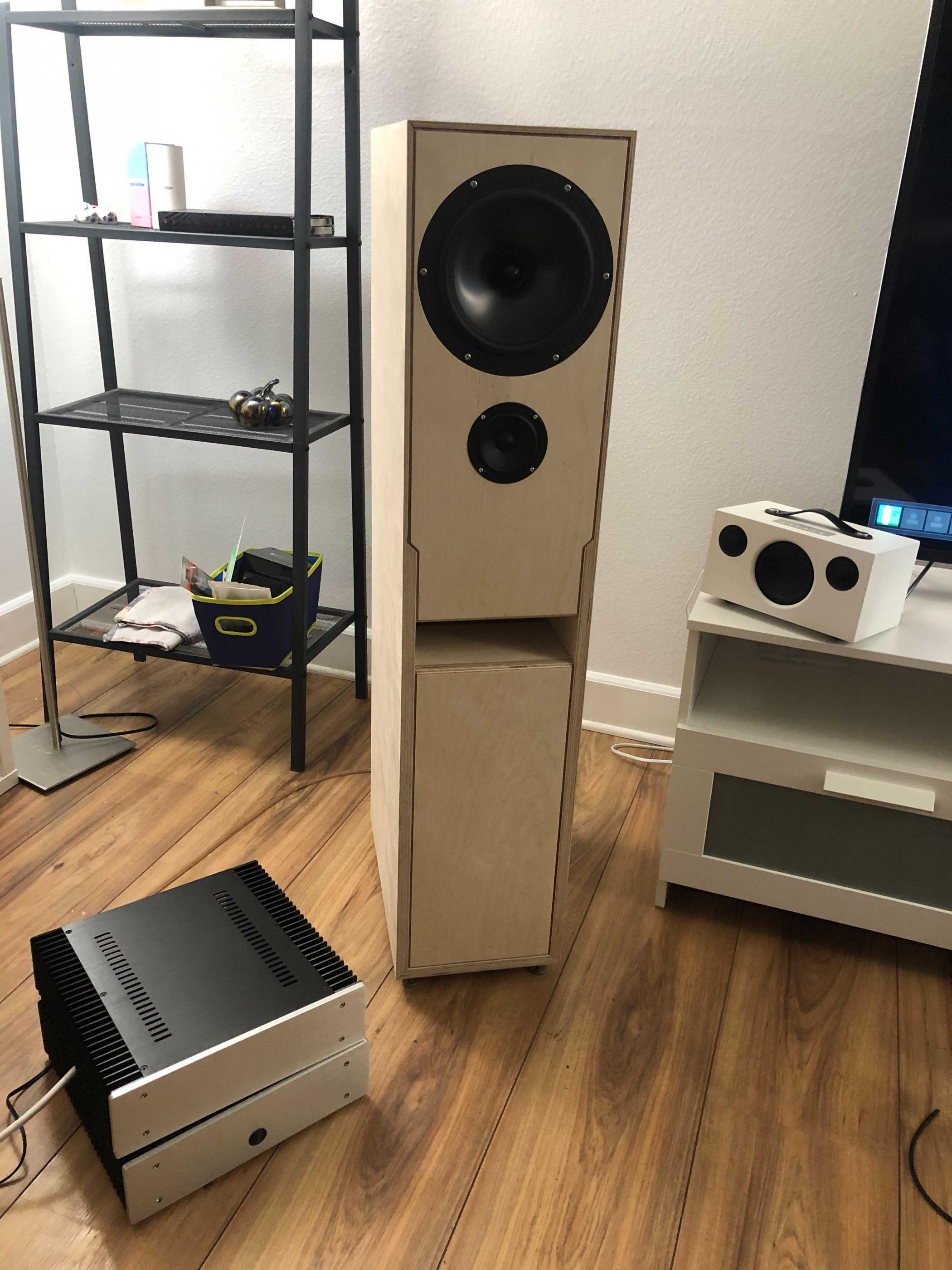

Got the second unit built/finished in satin poly. Sounds really incredible as a full set, will wait a few days for everything to be broken in before summarizing listening impressions. I'll also update the CAD and post that as there's a couple of minor changes if I was to build them again. (if anyone is looking to use the CAD, you should be comfortable using a chisel/planar to properly tolerance the pieces to compensate for CNC inaccuracies)

Congrats on completion of your stereo 10F/RS225 TL’s! They sound amazing don’t they? The woofers do settle in a bit more with some play time but are pretty good out of the box. The 10F needs no break in time as it doesn’t move much.
