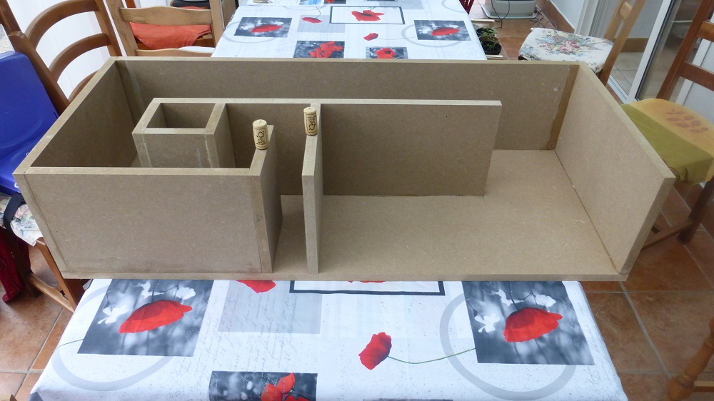

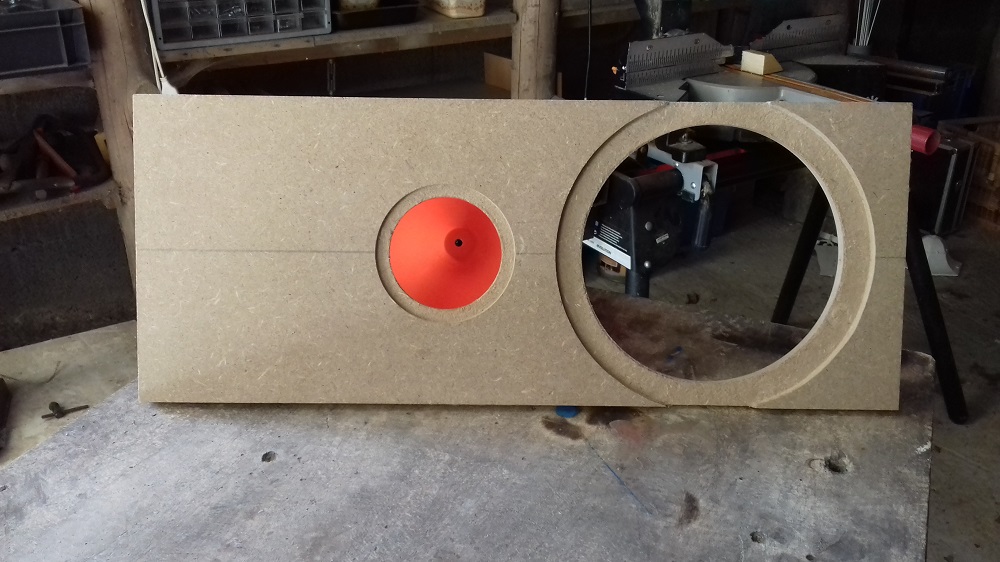

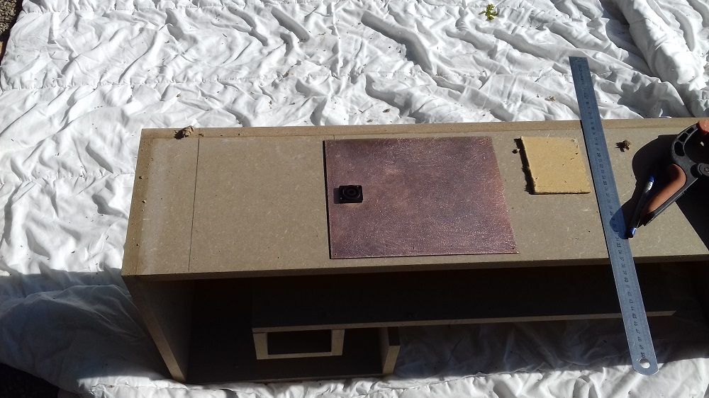

hi, i've working on the loudspeaker this week-end and i hope everything is going well. I use 18mm mdf, glue the cone and prepare the place for the crossover and put the speakon connector. Bye!! and thanks again.
ttan98,

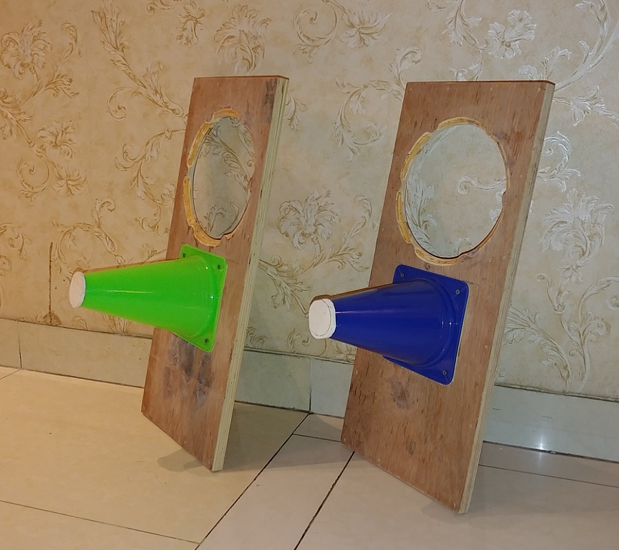

You are correct, the "orange funnel" (actually a sports cone) protects the wide-band (full-range) driver and acts as a separate cabinet for the driver. That way the woofer cannot inter-modulate the wide-band driver.
Also the tapering shape helps suck the driver back-wave, and the non-parallel surfaces reduce reflections coming back to the driver cone.

I suspect so thanks for a good explanation. The orange funnel is made from plastic does it need to have a certain dimension?
