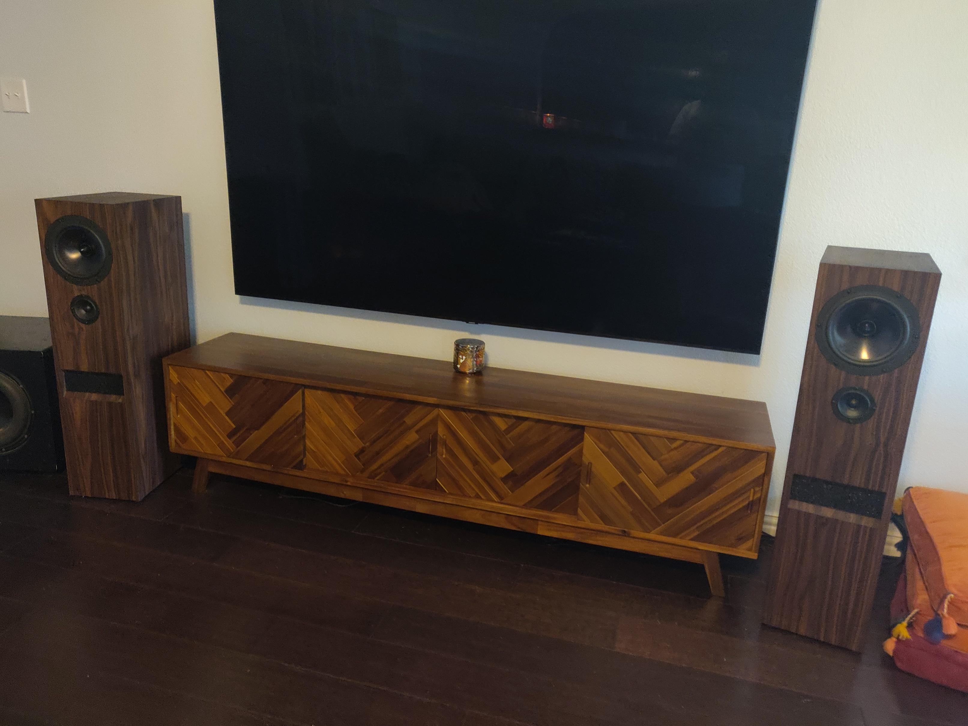

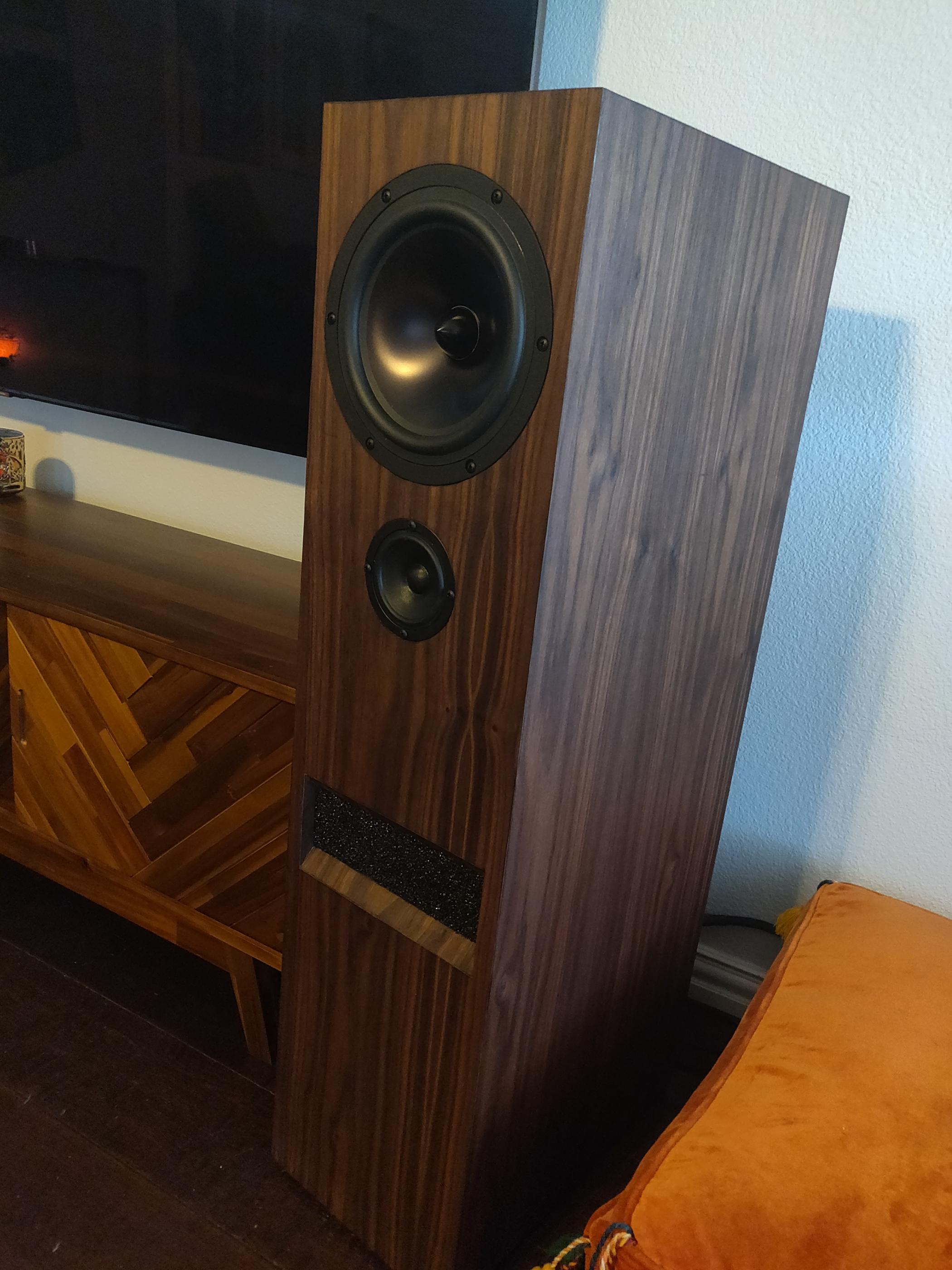

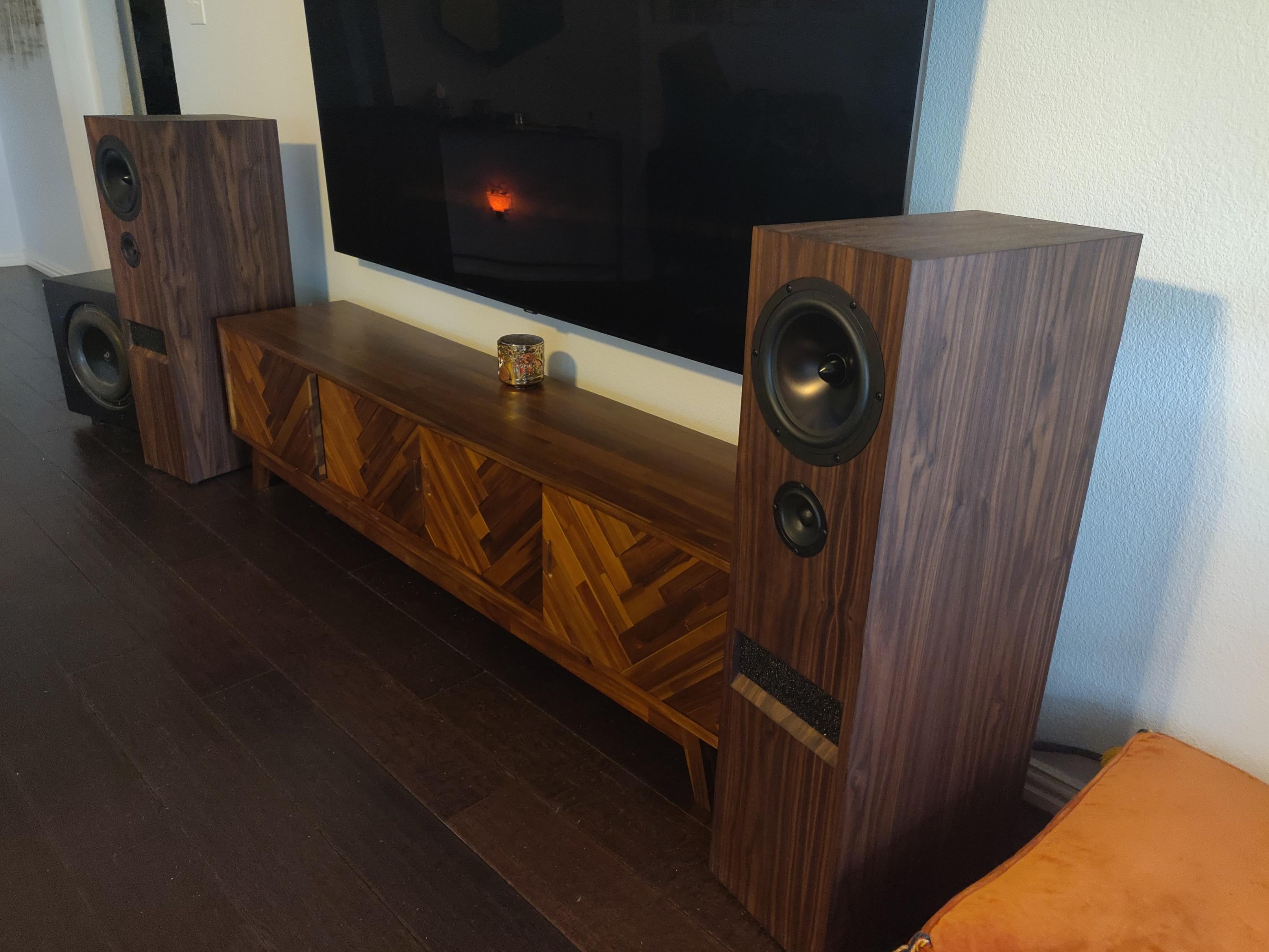

Here are my Finished Floorstander TL's. Built out of Baltic Birch and finished with Walnut Veneer and Tung Oil finish.
Holy Moly!! Your FAST TL's look incredible
![worship :worship: :worship:](https://files.diyaudio.com/forums/images/smilies/worship.gif)
Time to enjoy these beauties.

@Potstip - foam is to dampen the midrange from reflecting back into the cone and causing dips. Melamine foam works well too. Felt can work. I have not tried a towel, seems more difficult to install than sheets of foam and hot glue.
