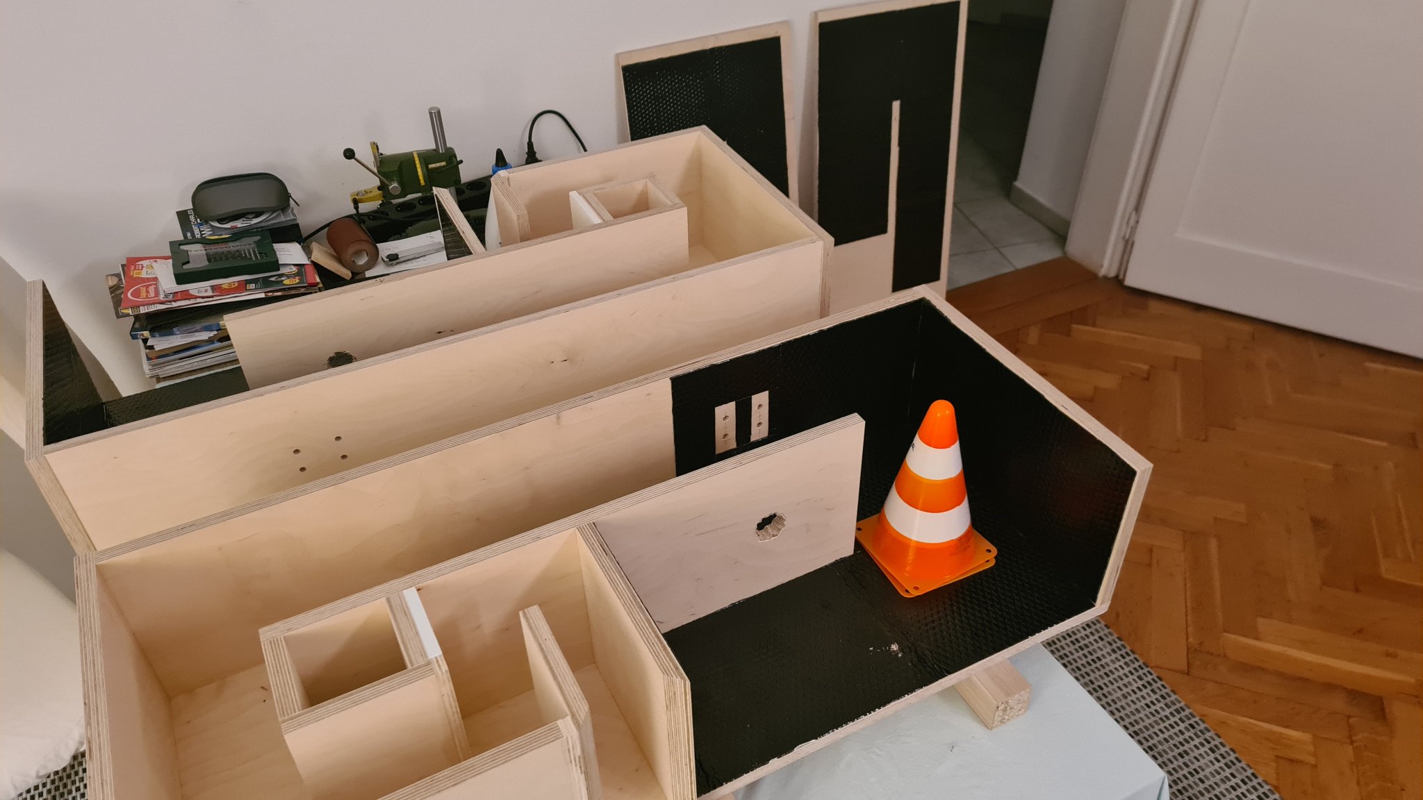

Hi kking, good that you have made a prototype - I think something went wrong. I recommend to to check it again.I started with a mixed cut list (never a good thing, as one had the sides tucked under the top and the other did not) and the prototype has a bunch of wrong sized panels, which is why I try to prototype before cutting expensive lumber... But now I can verify all my cuts and notice little things to fix and adjust. It also allowed my wife to look at the basic shape and size and give it the green light.
Quick question - I've seen radii listed for the routing and the holes for the front, but not for how deep the routing (at the edge) should be. Do we want the speakers flush with the wood? Or is there some other measurement to use for the depth of the routing for the outer ring?
I see at least two issues, one is the middle plate behind the speakers, it is way too short and should reach much higher, the other one is the bass opening under the speaker, it is too broad (or high), the TL should be the narrowest here, as it must have a decreasing cross-section, from the speaker to the output.

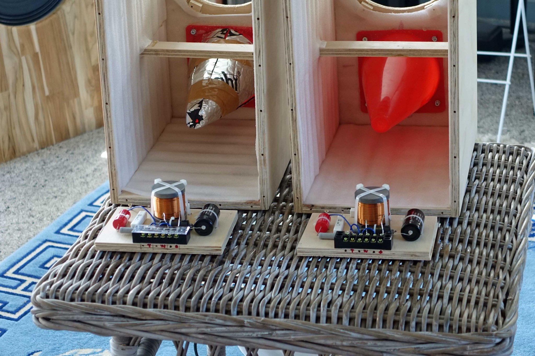

Looks great Tuba!Finished my sealed RS225/TC9FD. Because I'm cheap I used 3/4" subfloor material from all the construction in my neighborhood. Heavy and dense, maybe even heavier than MDF. So far sounding good. Kept standard tweeter attenuation even though TC9FD less efficient than 10F/8424 because brightness bothers me. Used a cheaper Dayton iron core 4 mh inductor and wondering if I should upgrade. Used it because I had it. What difference would I hear? Thanks to X for such a well documented project!!

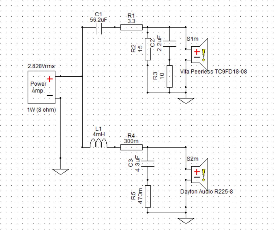

So to be sure I understand: Keep R1 at 4.7 and raise R2 to 6.8 for a little less attenuation on the TC9FD. I'm finding myself wanting a little more shimmer on cymbals, etc. I want to be sure before tearing into my XO. Thanks.10F and B80 are about equal and comes down to preference for glass vs paper cone sound. TC9FD is slightly less sensitive than 10F, so maybe 4.7R/6.8R resistor divider on the tweeter (6.8R to ground and 4.7R to the driver) in order to attenuate it less. You can adjust by ear to your liking.

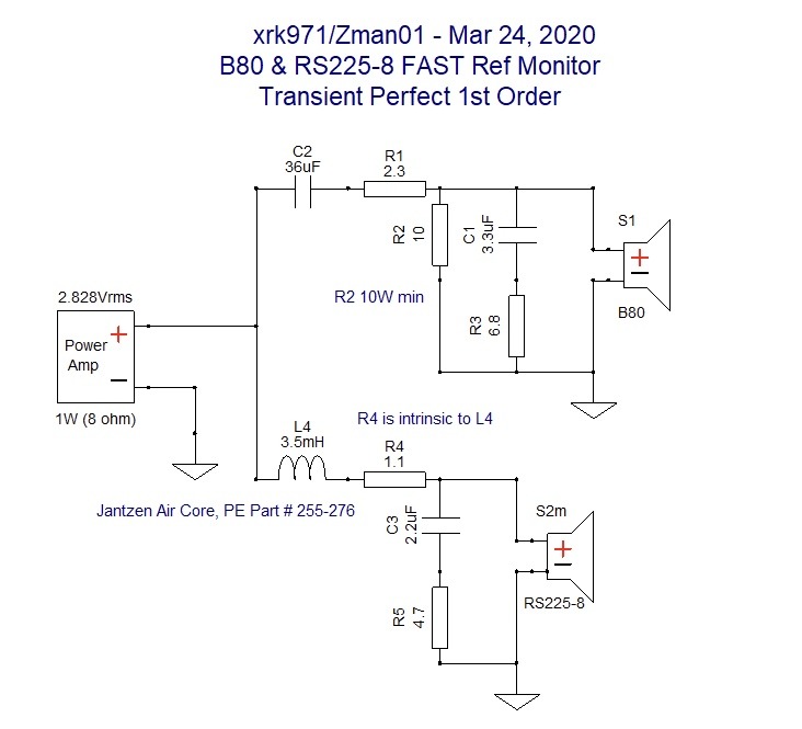

I'm seeing on the woofer there is a 3.5mh inductor instead of the usual 4mh. Is there a reason why it is different?
Nareshseep - X must have calculated that a slightly higher crossover point was warranted when using the B80. Note that he also suggests using a 36uF capacitor with the B80, instead of the 61uF designed for the 10F/8424; all part of the "dark arts" of crossover design - at least to me!I'm seeing on the woofer there is a 3.5mh inductor instead of the usual 4mh. Is there a reason why it is different?

Crossover design requires some experience, practical knowledge, and some of it is an “art” of course - but the work is very methodical and process oriented. The experience one acquires makes each successive design a bit better with the tools learned from earlier builds. With the advent of tools like Xsim by Bwaslo and REW by John Mulcahy, anyone can do it if you put the time into learning how. The learning curve can be steep and long though. Sort of like learning Akabak. The B80 could work in a standard 10F/RS225 XO with some resistor changes of course. But it was a special case where I was asked by Zman01 to optimize it for the best integration.

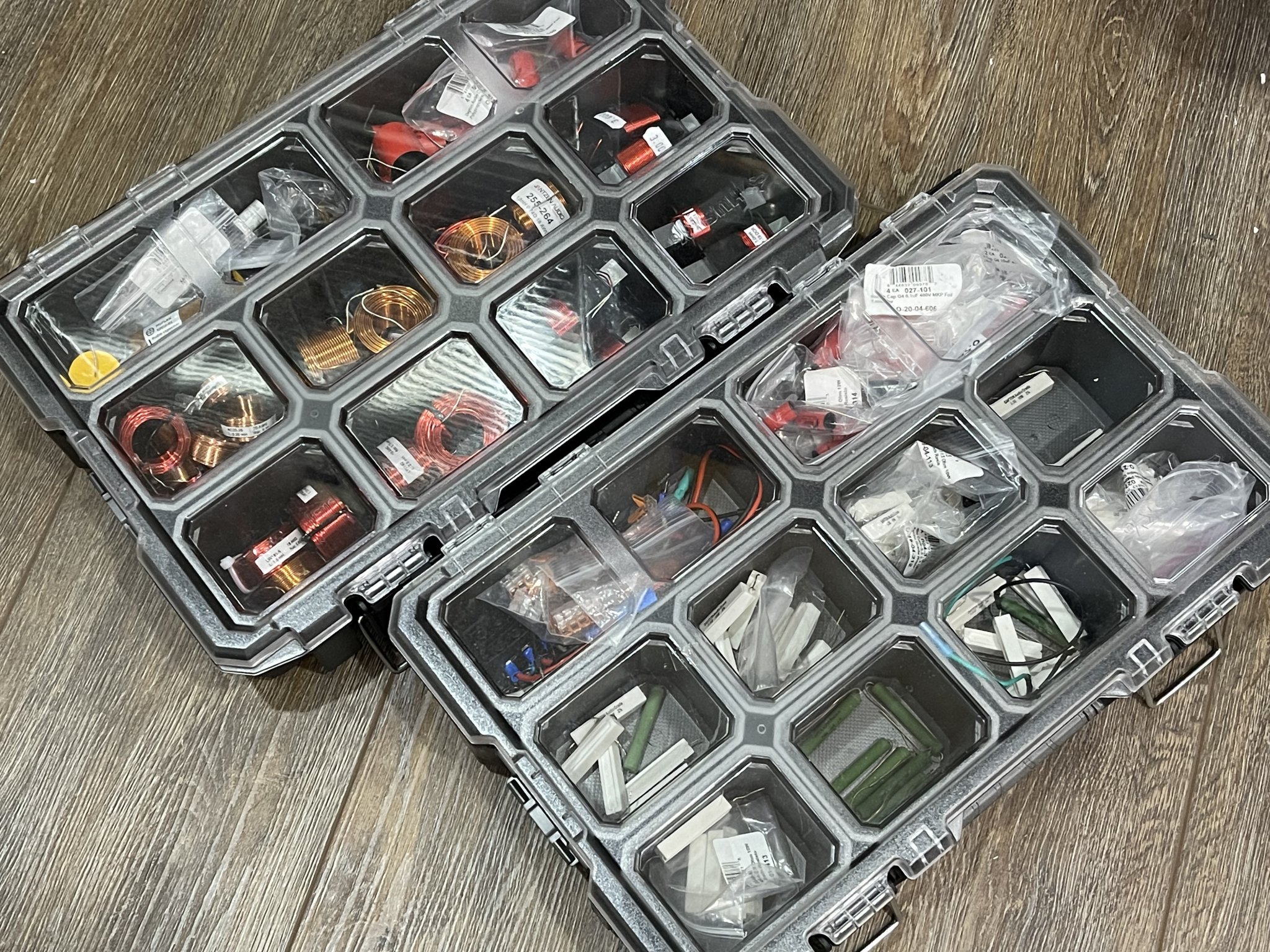

One of the best $200 I ever spent was to buy almost a complete set of typical inductors, capacitors, and resistors one could need for any crossover build. Have this development set on hand and you assemble any crossover that you come up with in Xsim in 10min and tweak with listening sessions in the same night. This has vastly improved my ability to make crossovers quickly and accurately.
Here is my crossover development kit. It’s grown a bit so maybe $300 worth of parts now. Bit that’s not needed to get started.

Big THANKS to X! I'm pretty chuffed - these turned out great. The low intrinsic resistance of the iron core inductor brings out a bit more bass. Pretty happy with my minor crossover adjustments. The sound quality is magnificent, with crisp powerful bass transitioning to the great highs that the TC9 can produce. Wow. So now I just need to apply a simple finish to the boxes, and package them up.
