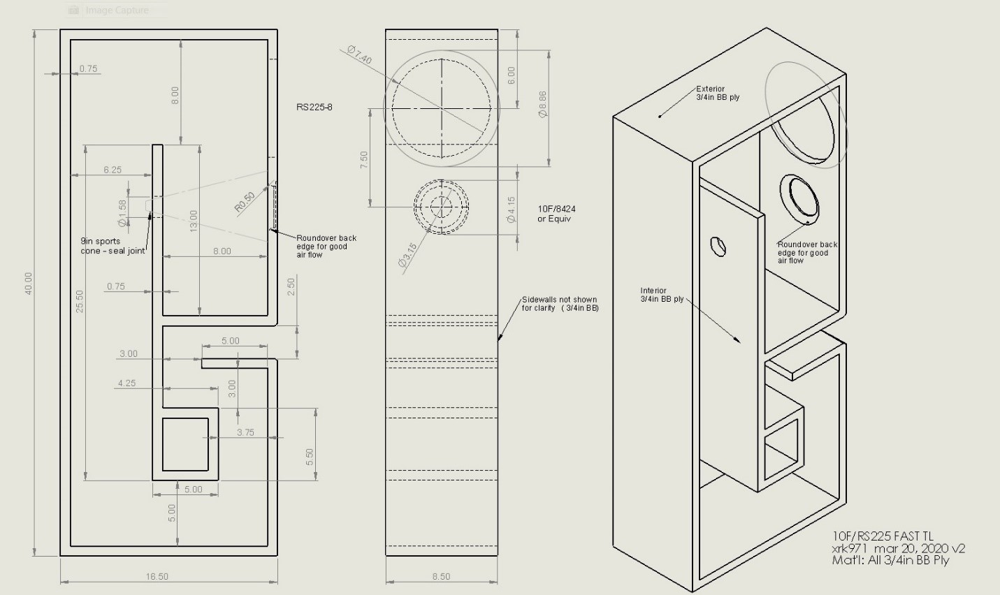

I bought my sheets of BB-3/4" ply. Before cutting I thought I would check the TL schematics and do a little calculating. I seem to add the height to 40.5" if I am correctly reading the schematic.
If builders are building to 40" height are they building from top to bottom and not worrying about the 1/2" lost as it is on the bottom. Or, am I totally out to lunch
Measurement from top to vent opening: 3/4" + 8" + 13" + 3/4" = 22.5"
Measurement of vent opening = 2-1/2"
Measurement from btm of vent to bottom: 3/4"+3"+6"+5"+3/4" = 15-1/2"
Total = 40-1/2"
Thanks,
MM
Extend the 8.5-inch width a bit, so that the woofer circumference can stay within the front baffle ply. It will make your circle routing and assembly a lot easier.

10F and B80 are about equal and comes down to preference for glass vs paper cone sound. TC9FD is slightly less sensitive than 10F, so maybe 4.7R/6.8R resistor divider on the tweeter (6.8R to ground and 4.7R to the driver) in order to attenuate it less. You can adjust by ear to your liking.

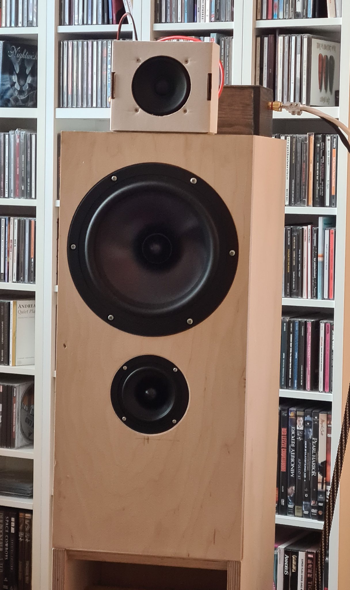

I was curious and as with my external xo it is an easy task, I tried the Peerless TC9FD18-08 instead of the Visaton B80, of course not built in, just in a cardboard "cabinet". I know, it's not how it should be, but it sounds really pretty good, even with the attenuation of the B80 in the xo, they have smooth higher mids. I think, they are worth trying.
Thanks X! I think I wouldn't like the GRS dipols, they have - according to the manufacturers diagram - an "intense" treble range, which don't meets my taste, even with the roll off when built in and angled.Nice trick, Plott! I have done this myself a couple times with “alternate” tweeters. A good one to look out for is the 8in dipole planar by GRS. Sweet sound.
try with TC9 in openbaffle.....Just one question, X. Is it possible to position the FR outside of the TL cabinet, above the bass driver (like my cardboard trial, but better), or is the positioning inside the cabinet a must, a required part of the acoustic design?
