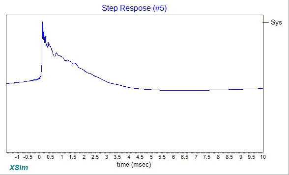

I'm betting high on a reflection from the box's back wall.
That's doubtful as there is 1in thick eggcrate foam inside and a big wad of fiberglass in the empty space.
Also a 280Hz reflection implies a 24in half-wave reflection cancellation distance. The mic is at 19in so 24in might be the reflection off the tripod stem 5in behind the mic.
Here is predicted Step Response with tweeter having a 0.75in setback:
Wait... you can place drivers on the baffle in XSim?
I didn't know that. I'll have to look it up!
An impedance plot would show if the problem comes from within the enclosure. That said, I never had any luck with that egg crate stuff.
Fiberglass insulation and wool felt absorb much much better.
While the tripod may be 24in away, it won't create a reflection at the mic at 24in, but at it's distance from the mic at 5in. It has to be something else.Also a 280Hz reflection implies a 24in half-wave reflection cancellation distance. The mic is at 19in so 24in might be the reflection off the tripod stem 5in behind the mic.
Something within 24in of the mic, perhaps...

Look at the simulation BYRRT posted a few pages ago, it's almost an exact prediction of your measured response. Don't merely look at the distances to the cone, that's not what's causing the dip/peak combinations, it is the difference in distance of different sound paths at the microphone that counts, not to the driver itself.
That's why you cannot fix diffraction with EQ, for each angle and distance the differences of the sound paths (direct sound vs diffracted sound) will change. Diffraction is better battled by trying to avoid it.
Put in that gasket to check it, it won't fix the 3.7 ripple. It might tidy up the response a little higher up in frequency.
Actually I don’t agree that Byrtt’s prediction worked. It predicted a dip at the squiggle and the centered baffle measurement was a peak there. The use of 1/2 wave distances usually gives some insight to the cause because after all, the inverse of the frequency corresponds to a real distance - somewhere. The trick is where.
Just try it, you'll see
The plot from BYRTT showed the exact same pattern, maybe not entirely at the same spot.
That would depend on the actual measurement distance, nothing more, nothing less.
Look at this post:
http://www.diyaudio.com/forums/full-range/242171-towers-25-driver-range-line-array-409.html#post5320774
See how things change at different distances? Despite the fact that the distance between the speakers does not change? See your enclosure edge as a separate radiating source, that comb pattern is going to move too, with a different measurement distance.
Your rule of thumb is flawed once we start to look at different distances to the enclosure. It's only valid for the measurement taken with that exact distance between the speaker and microphone. Change one variable and the dip/peak is going to move.
Look at this post:
