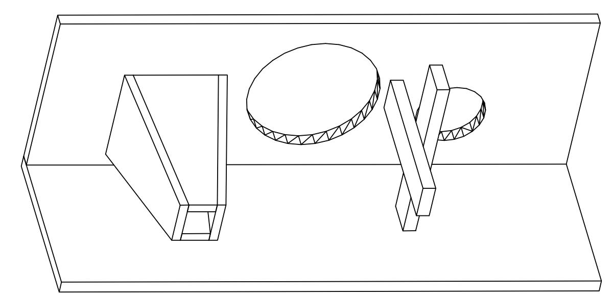

In my case the dagger reinforces the enclosure from the front to rear. Opening in the rear wall makes the dagger vented on the rear end, see the view of the opened box. Second reinforcement between left and right side walls is missing in the pic, glued perpendicular to dagger side.Not clear to me, is the small end of the "dagger" sealed or open? Also is it sealed around the driver?
David

I had a few questions on an alternative design based on this speaker.
Basically an omni on the bass driver with the FR as open baffle to get a cardioid pattern. something similar to lxmini in approach, but hopefully in a bookshelf size.
in Lxmini, the upward firing woofer as i understand overcomes the need to handle baffle step on the listening axi. But i think the small size of the woofer and baffle are also essential to the design.
How would an Satori MW16 in a sonotube work with 10F FR in open baffle.
Can the crossover still be kept passive? Or the corrections needed become complex enough for DSP.

You just have to build it and measure to see how complex the passive XO will be. I know that the 10F in an open baffle is a snap as it is smooth and do what I did for the XO. The Satori is a great driver but I don't know what that looks like in a Sonotube. You could model all this in Akabak (upward firing sonotube and horiz 10F in OB). It will get you very close to what the ideal response could be.

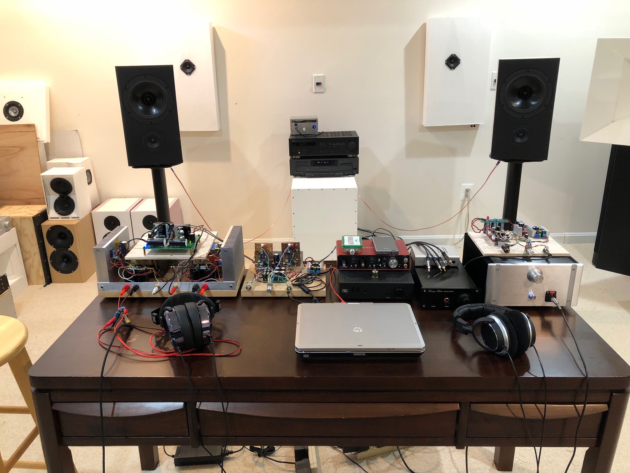

I am setting up another headphone amp comparison and put the headphone comparing station in the same spot as the listening position as the 10F/RS225 FAST speakers. It's neat to be able to compare sound from headphone to sound in room through speakers. A new thread for a blind virtual audition of the headphone amps will come out as soon as take the data. At least the workstation is setup now.
